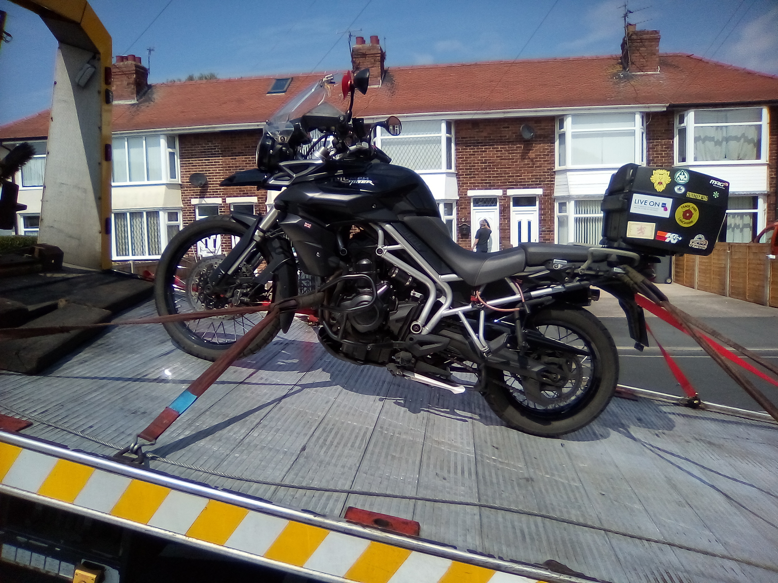

    Well , looks its fooked . Bike wont start at all . 12 . 65 v in battery . Sluggish turn over , do realy think the starter motor is at fault . Dont want to spend any more money on this bike so I may just scrap it and cut my losses !
