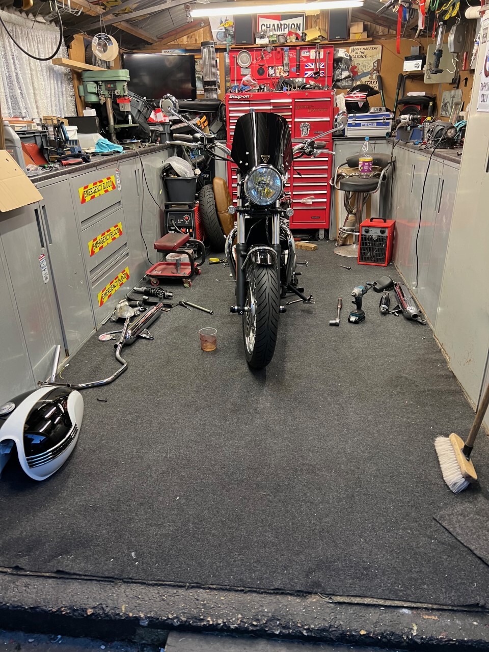

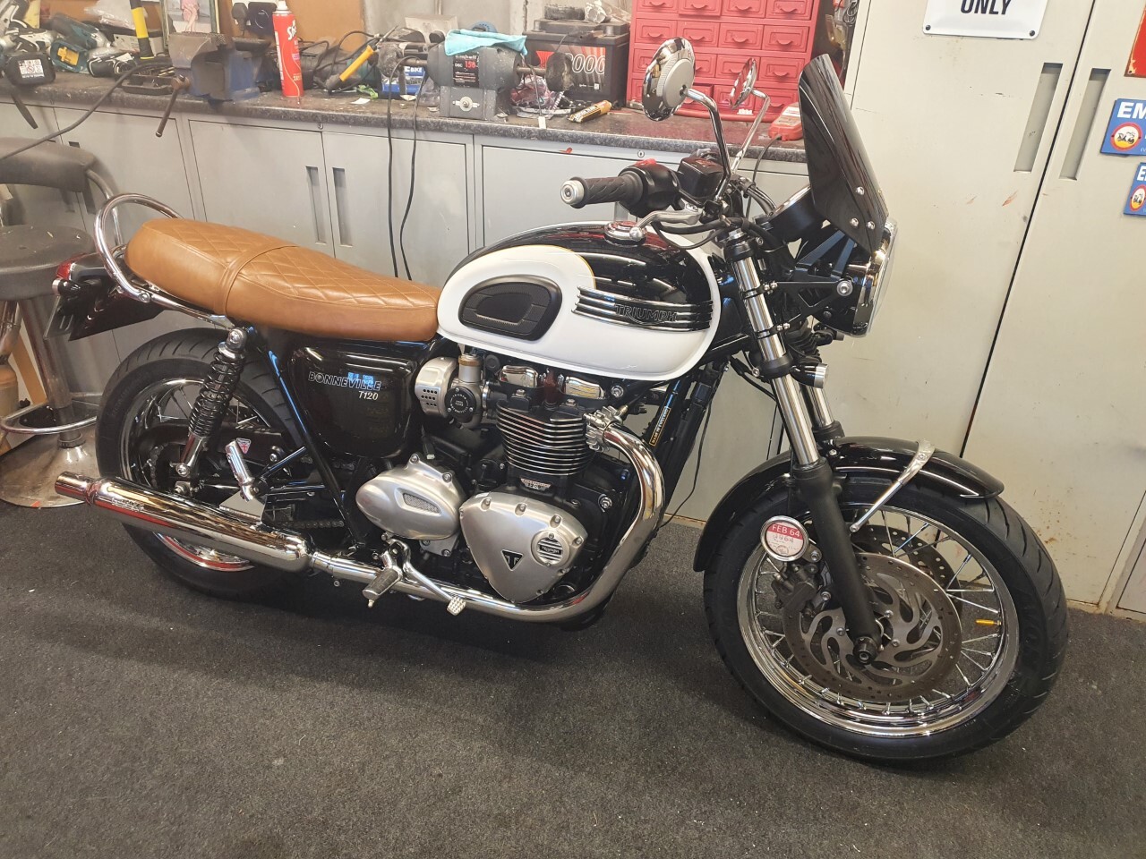

    Ok progress for today, the seat cover arrived today and although I wasnt going to fit it untill the bodywork was removed ready for paint I thought, why not so I fitted it
    also I removed the rubber knee pads on the tank as they wont be going back on the bike once its finished
    hard to work out if I prefer the bike without them or not !!

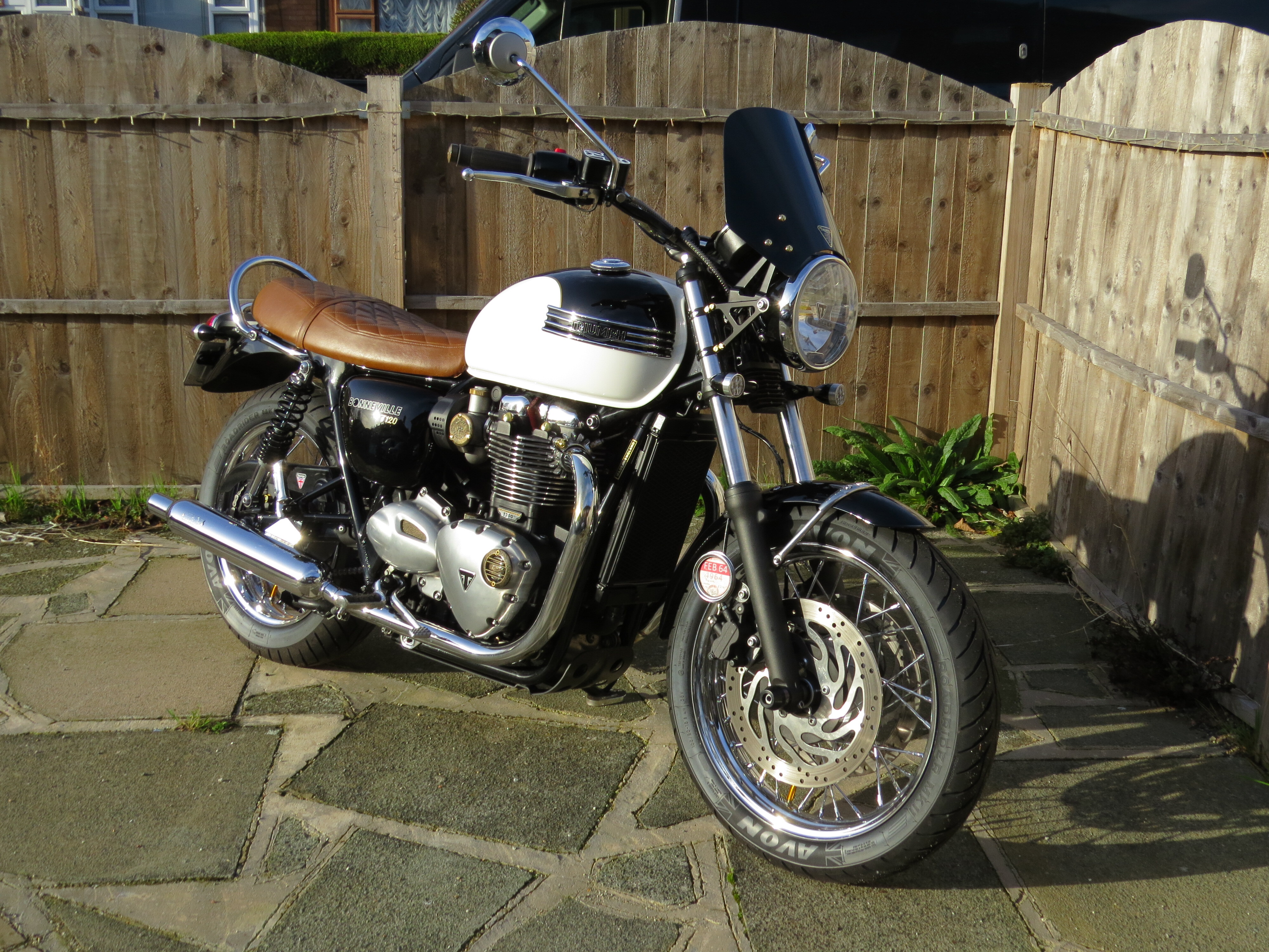

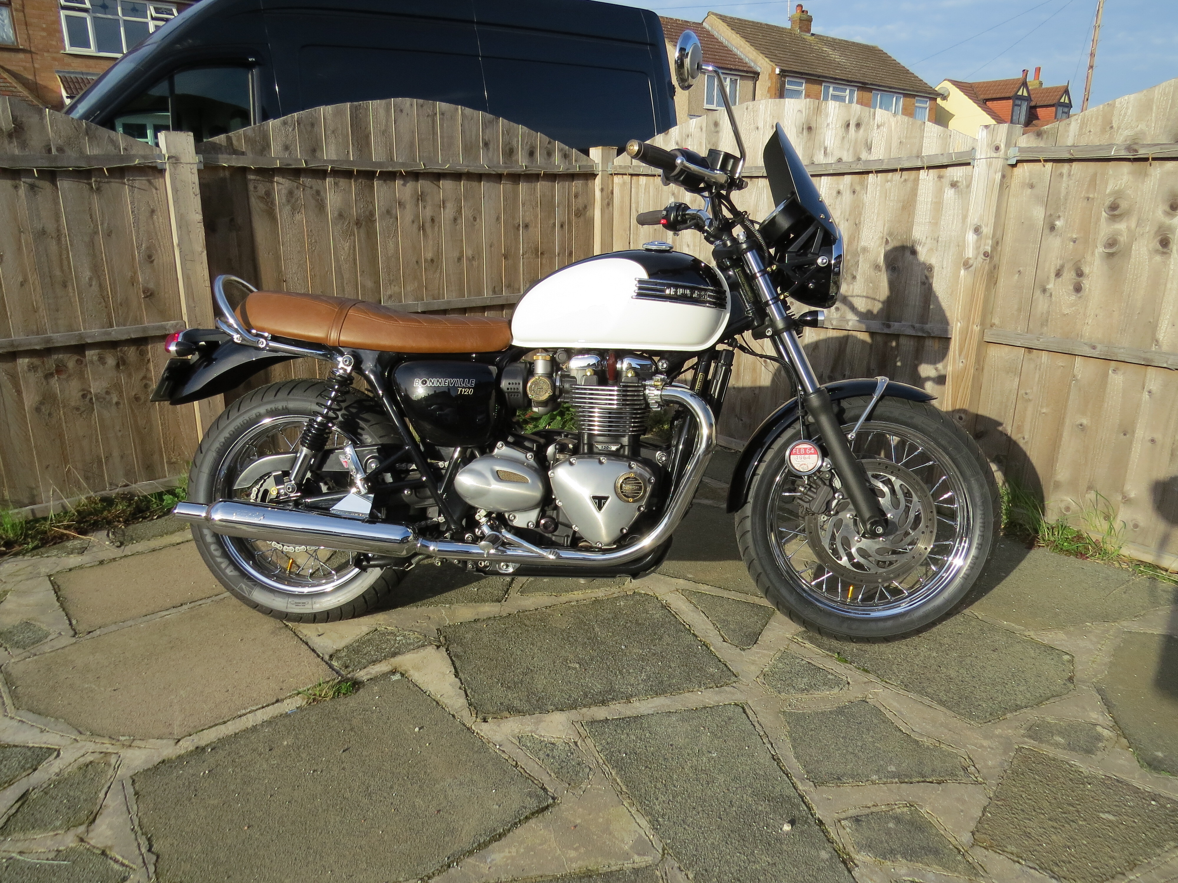

    Well no comments so i think ill end this and just show a piccie of the bike when finally painted but rhe bars went on the bike yesterday and yes it really was a faf heres a few pics, the bars are a lot nicer and exactly what I wanted

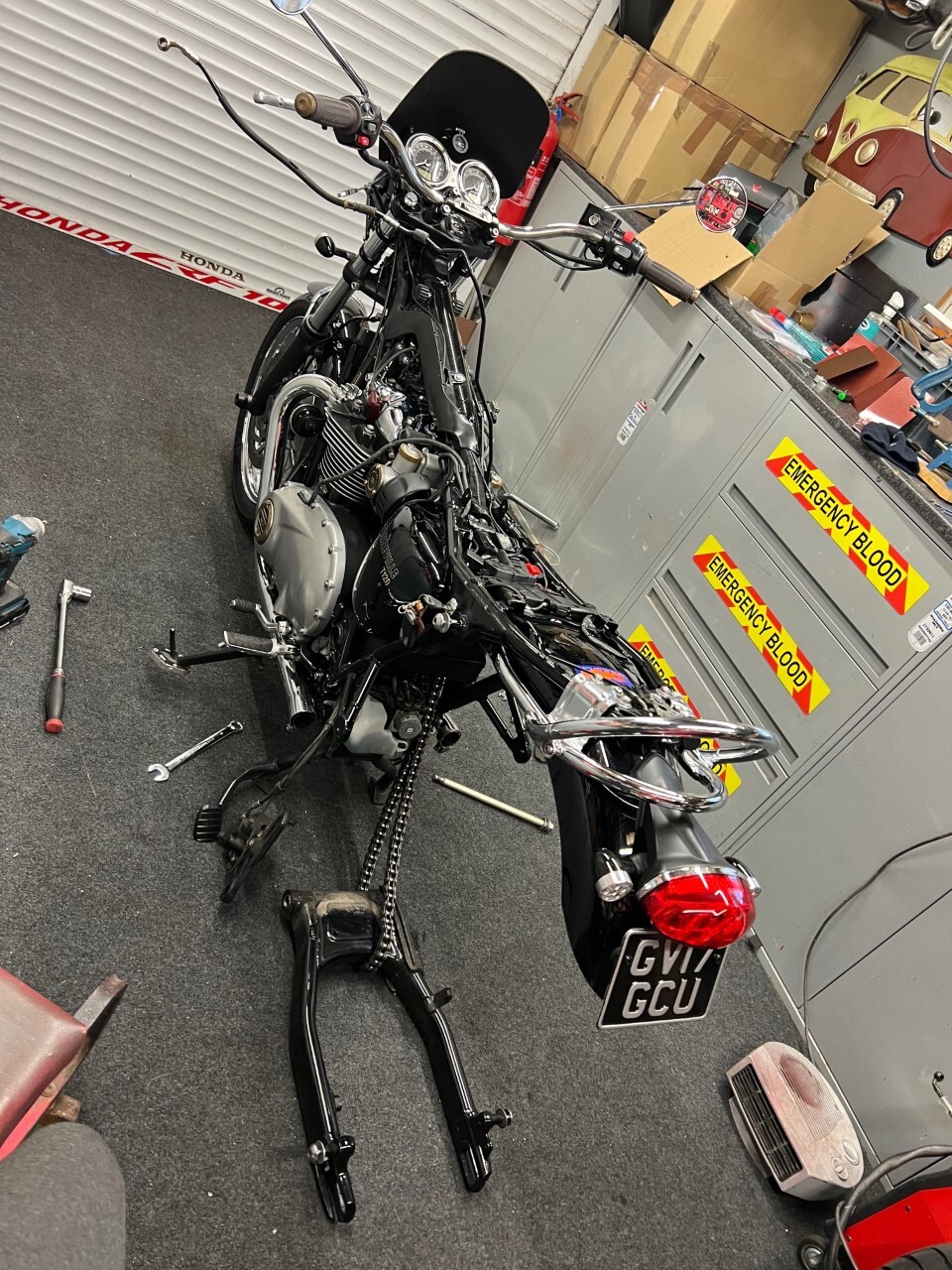

    Rob. why did you have to remove the swingarm?

    To replace the front barke pipe that goes to the ABS pump,

    Excellent job mate :) Out of interest did you have to modify the wiring to the switchgear? I was really interested in getting a Street Twin or a Bonneville when they first came out but found the stock bars too low and narrow but our local Triumph dealer told me it was impossible to change them due to the wiring not having any slack in it.
  8. Adventure Boy
    Adventure Boy Well-Known Member
    Nov 22, 2021
    74
    No He was not telling the truith im afraid
    the bars ive fitted are wey bigger and the only things that needed extending was the Clutch cable and the front brake pipe the cables were fine and I was worried as mine is fly by wire
    ive got a spare set of bars, spare longer clutch cable and front brake pipe to do the job if anyone is interested
    the whole lot comes to about £150
    I can also do the complete job if needed it took me about 5 hours id say
