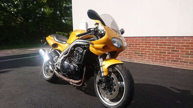

  8. Riceburner
    Riceburner New Member
    Hmmm, got it all together, valves are good, coolant, oil and filter, air filter, fuel filter, new qd, etc etc, and it seems to running well. ☺
    However. I'm now getting the engine warning light constantly on.
    Voltage at the battery is 13.something when ignition off, and 14.4v when engine running, so i think the alternator and reg/rec are ok.
    I'm worried that i may have missed a connector, but presumably the bike wouldn't run if i had?
    Interestingly, if i flick the full beam on, the engine revs drop by 50 or so (enough to be audible). This would indicate to me that the alternator was working correctly as it is noticing the extra current draw?
  9. Nige H
    Nige H New Member
    May 1, 2017
    17
    Cardiff
    The light is doing what it's supposed to.
    You need to run it through 3 heat cycles, from cold to fan running and the light will extinguish.
