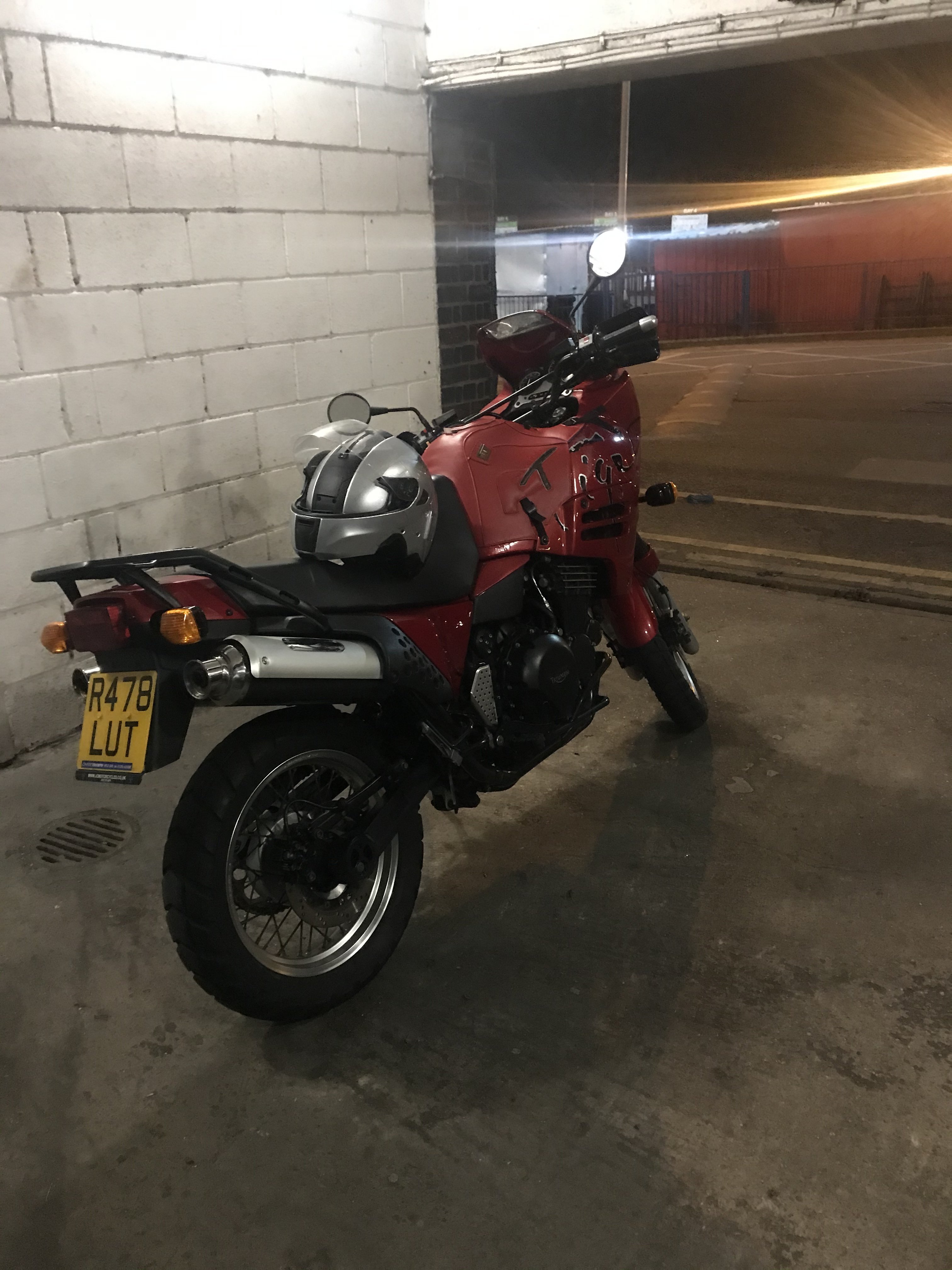

  19. Reevo
    Reevo Active Member
    Sep 14, 2019
    132
    Birmingham
    Couldn’t help posting a couple of pics
    Sorry
