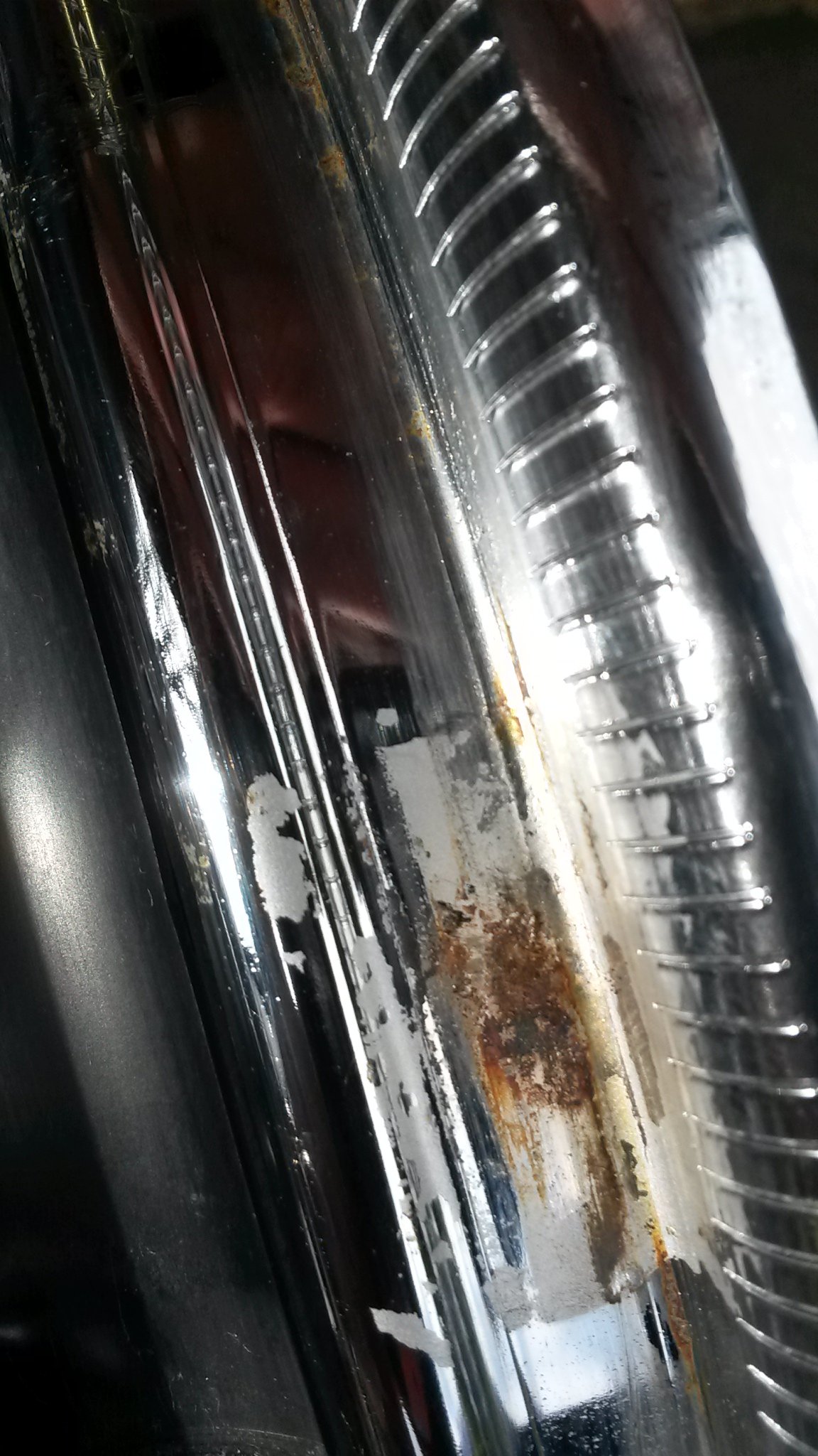

    Just as a matter of interest old git, what was the rim like after you removed the tyre last night ?
    If your bike is very much like showroom condition, it cant be that bad surely, although I appreciate you are having to protect and clean it more than you would like.

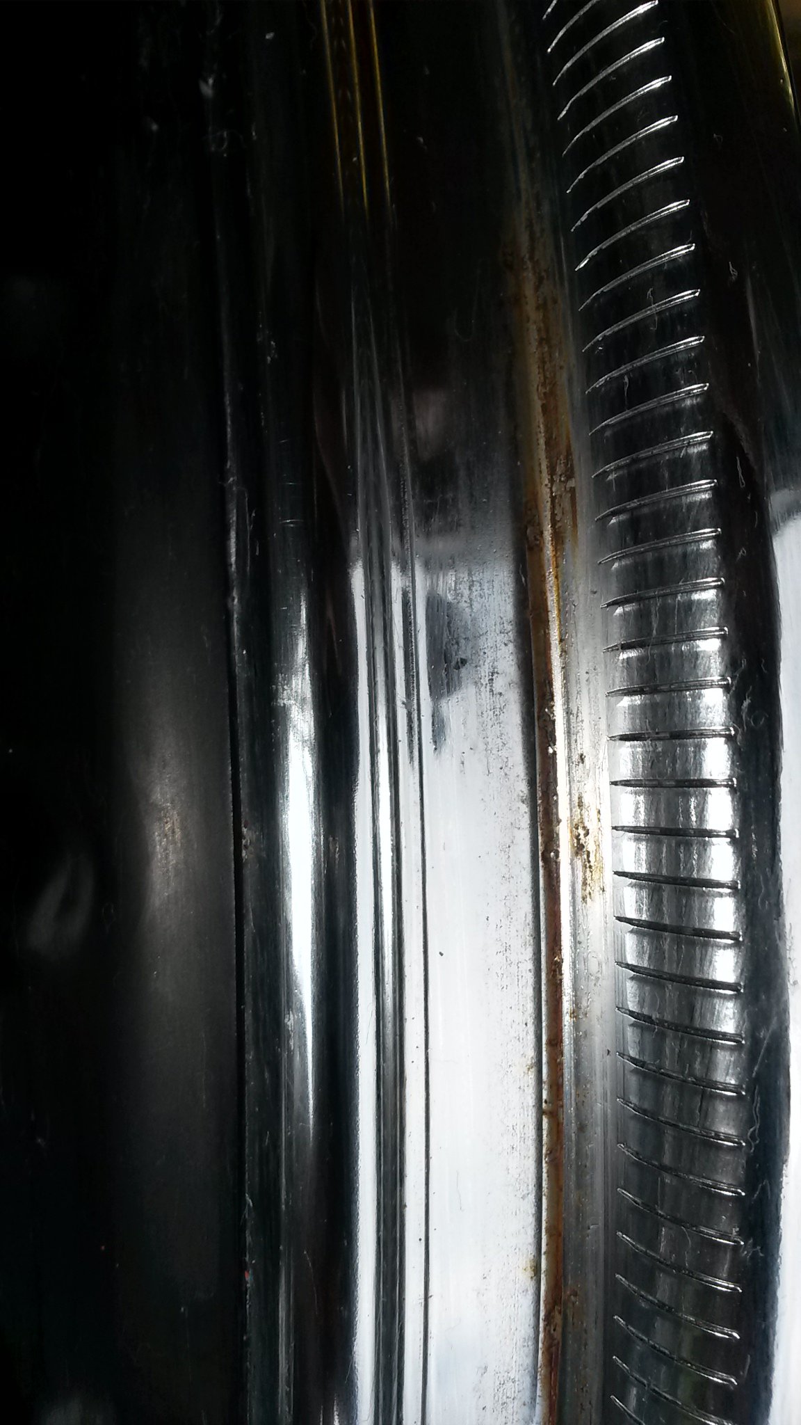

    The rust on the inside of the rim is the same as it was before but the bit that really concerned me was all the spoke recesses. Thankfully the rim tape and I presume the pressure of the tyre looks like it's stopped the acf50 from spinning out. Unbeknown to me my son took photos of the rear rim after I'd originally cleaned it up but before I looked under the tape. Note rust concentrated on what seems to be a white film - possibly a sticky label for ID purposes? 20170305_121803.jpg 20170305_121747.jpg

    The high humidity in Thailand makes all untreated steels rust overnight, and I mean red rust.
    This could very well be the issue with some of the corrosion we are seeing.
    If products are not pre-treated correctly and plating is applied on rust, it will quickly break through the plating.
