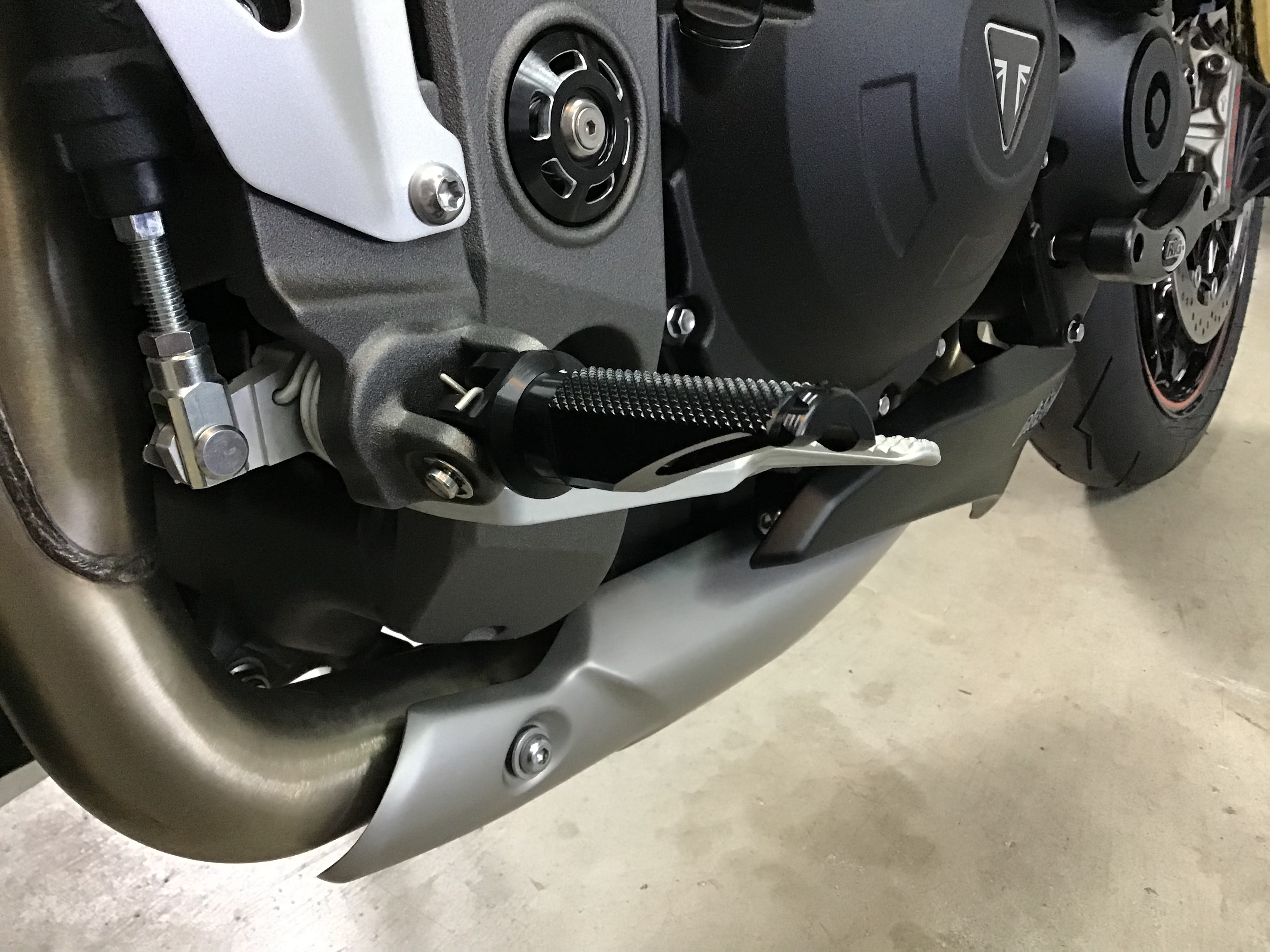

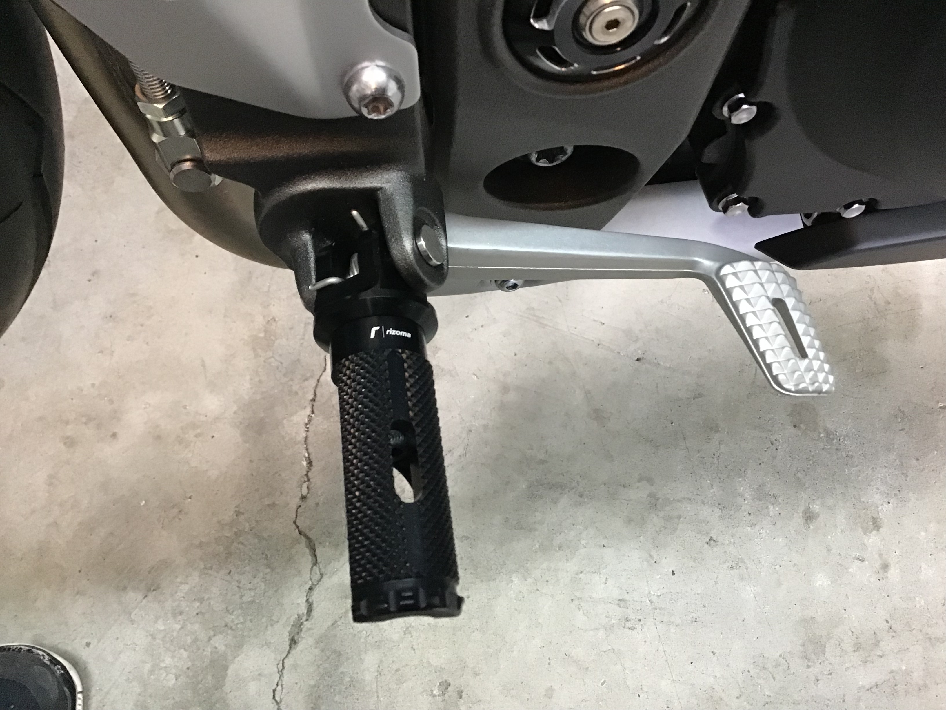

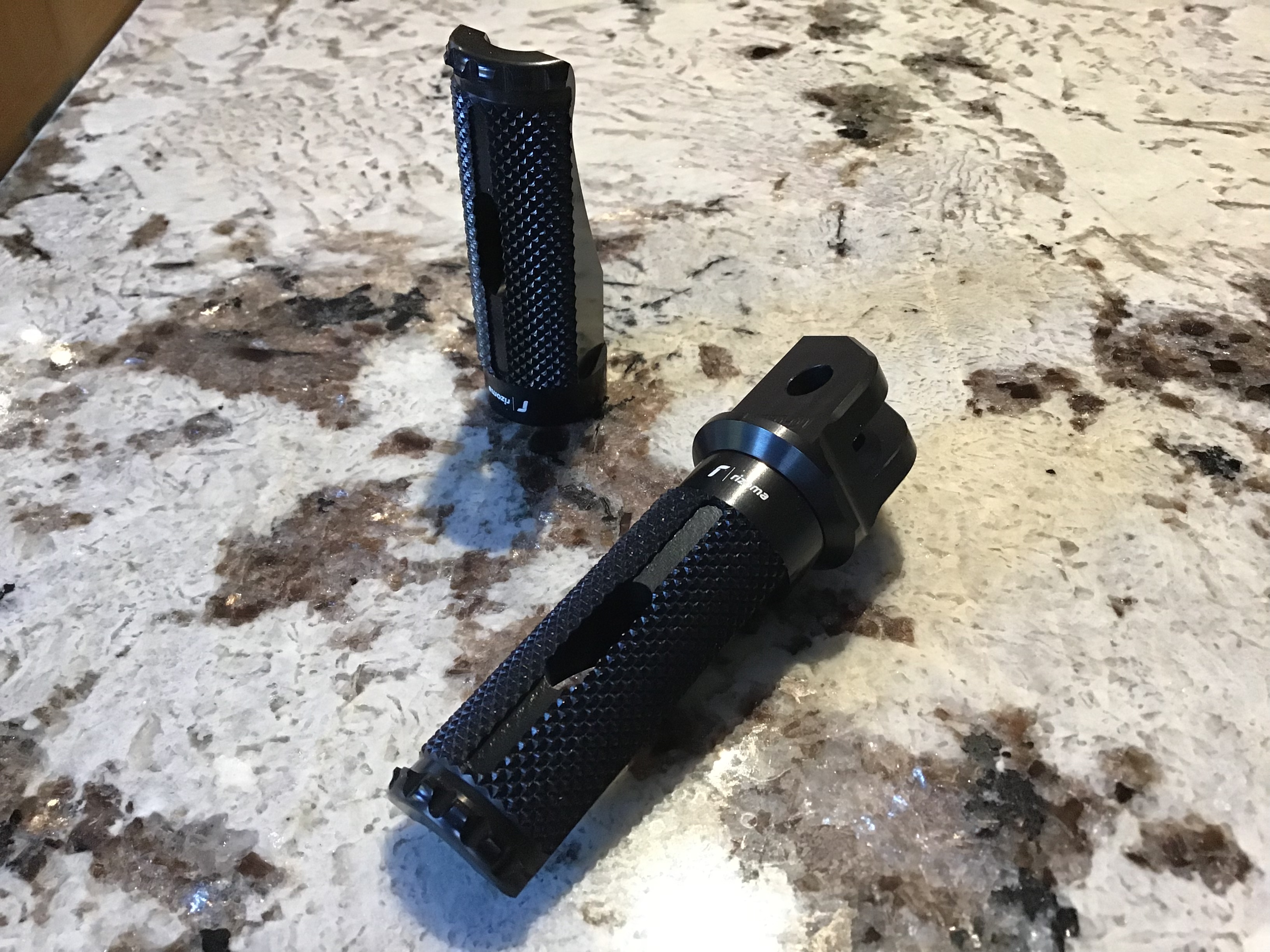

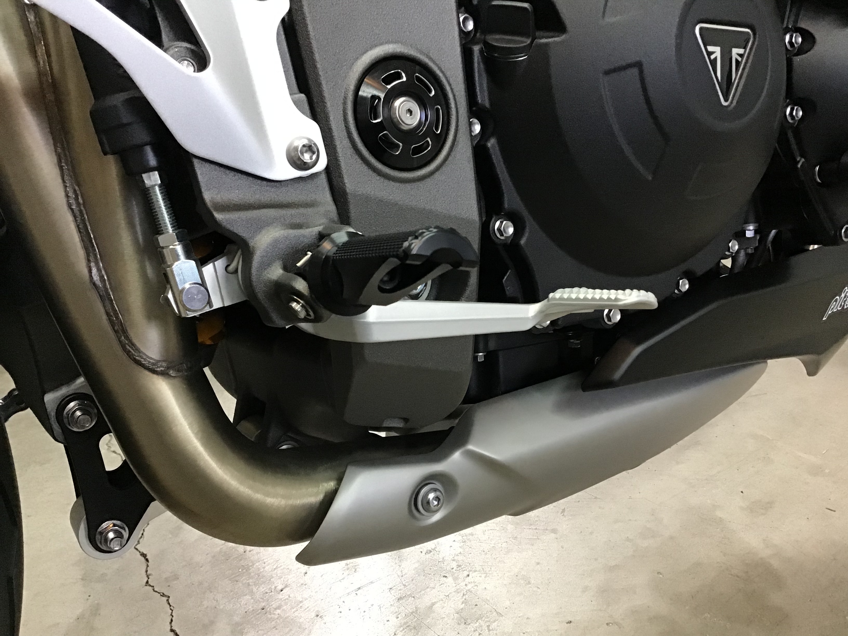

  15. SteveRS
    SteveRS First Class Member
    Jan 12, 2019
    862
    British Columbia
    Relatively yes. The mufflers and exhaust pipe need to be removed to access the foot peg hanger bolts. You need to remove the cat cover to access the bolts to the pipe as well. All in all about a half hour or so job. Also, I didn’t bolt the pipe hanger back on either, as it seemed unnecessary as the pipe was very secure without it. The pipe hanger is bolted to the shifter side muffler hanger bolts. Anyway it was pretty easy to do, but I must admit I quite enjoy removing parts and working on my bike. I find it very therapeutic.
  16. SteveRS
    Jan 12, 2019
    862
    British Columbia
    Rizoma pegs on :).

  18. Sideburn
    Sideburn Well-Known Member
    Nov 27, 2018
    134
    Colorado
    Interesting. They look accessible without having to remove that stuff, but I've not tried.
  19. SteveRS
    Jan 12, 2019
    862
    British Columbia
    Nice!
  20. SteveRS
    Jan 12, 2019
    862
    British Columbia
    One bolt is and the other is not unfortunately. At least not with the tools I have anyway. There might be something that’ll fit in there I just don’t have it.
