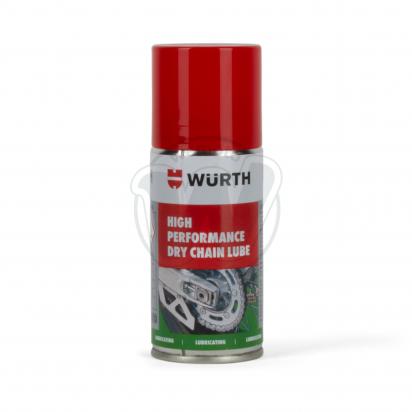

    I always have my eye out looking for a TINY can of lube. The big old can of lube is tough to carry around. I would gladly put out some cash for a spray container that was much more compact, say the size of um, ahh, uhh the size of a computer mouse, good for a half donzen lubes.

    Available in 150ml cans (as opposed to more usual 500ml)

    This is the tiniest can I've found and I've used it quite a lot on tours. It's motorex 622 strong chain lube in a size 56ml, but the best thing is it's refillable from the big can of 622. https://www.touratech-uk.co.uk/motorex-chainlube-622-strong-refillable-mini-can.html. So you never throw it away, just keep refilling it. I've still got a can from the 90's that I still use. Although last summer I moved to the wurth stuff and have the 150ml can now. Only reason is because the 622 is a bit mucky and gets flung off onto the back wheel, bodywork and panniers. Plus it's a bugger to clean off, which I suppose speaks well of it's protective nature...
