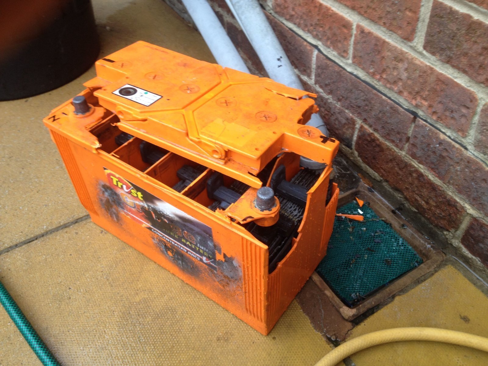

    When litium batteries overheat they generate a mix of flammable toxic gases and oxygen, hence the difficulty extinguishing them.
    As most will know, LA batteries generate explosive hydrogen when charging, a fact I forgot a few years back while working in the garage. Battery on charge at one end of the bench and me deciding to use an angle grinder on some metal in the vice 3 feet away. Flash BANG!! Thankfully it was the back of the battery facing the wall that blew out flooding the bench with sulphuric acid. Phew!...I should have bought a lottery ticket that day. What a w****r!:mad:

    Gosh a lucky escape Pegscraper and glad you did not get hurt. Back to lithium batteries, if they are the holy grail so to speak then why don't more manufacturers fit them as standard, and it is nothing to do with the extra cost. Now here is a factual piece of information, a not insignificant amount of electric vehicles have recently caught fire, mostly on motorways, initially these have been dealt with by the emergency services (fire brigade), then they had been recovered and put in a storage yard awaiting an insurance disposal, however a lot have subsequently re ignited, not only causing a fully burned out vehicle but surrounding vehicle damage, what happens now is a specialist recovery vehicle attends with a container full of water (a skip like steel open container), the electric vehicle is then craned off into the water container and transported to the salvage yard, there it remains until it is deemed safe, there are added complex complications in the unfortunate event of a fatality. Electric bicycle's are another fire hazard, they usually ignite whilst charging, and these bicycle's are not always of dare I say it, cheap Chinese origin with little in the way of recognised safety standards. Ride safe all from an ageing Rocker.
