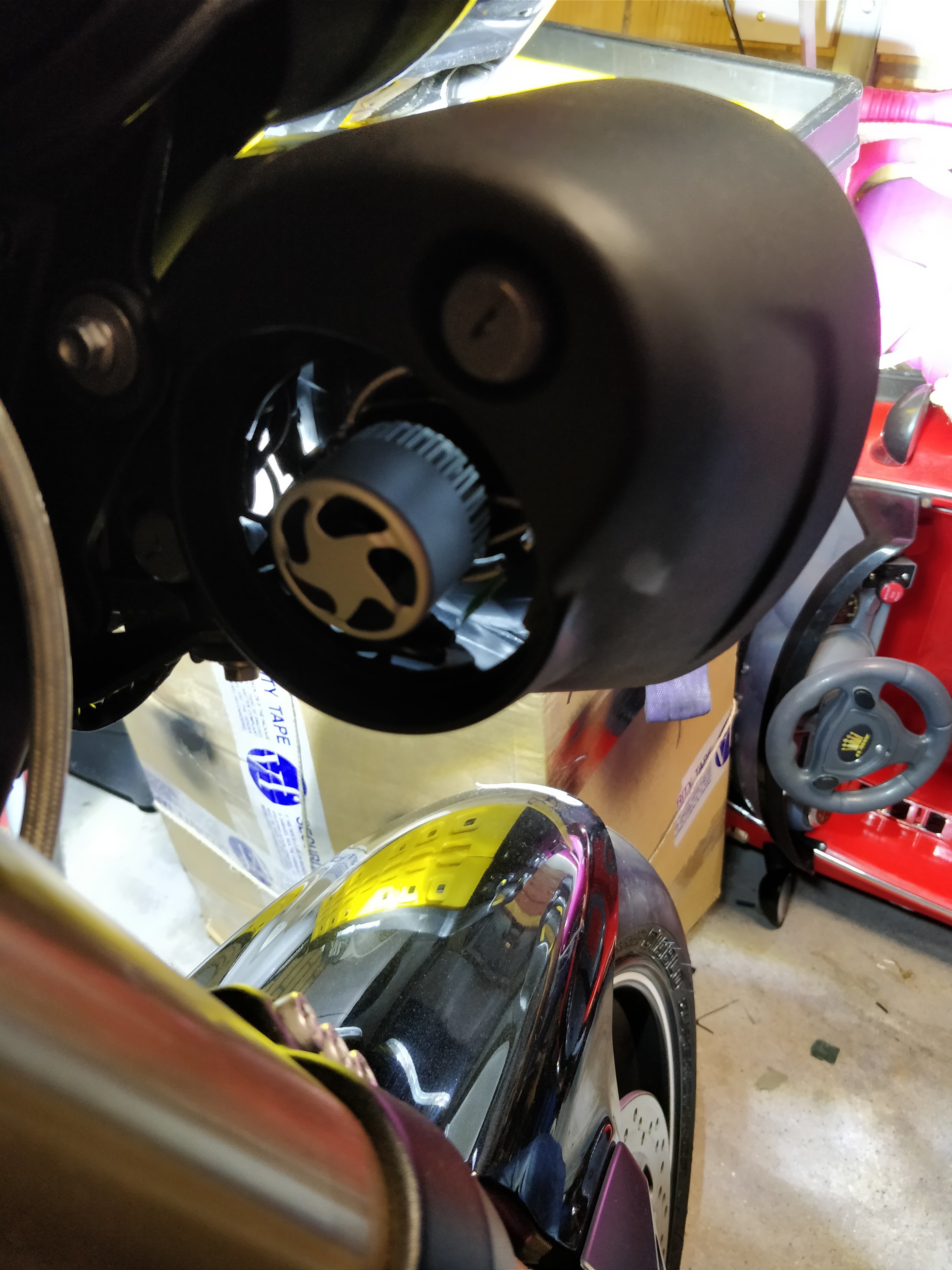

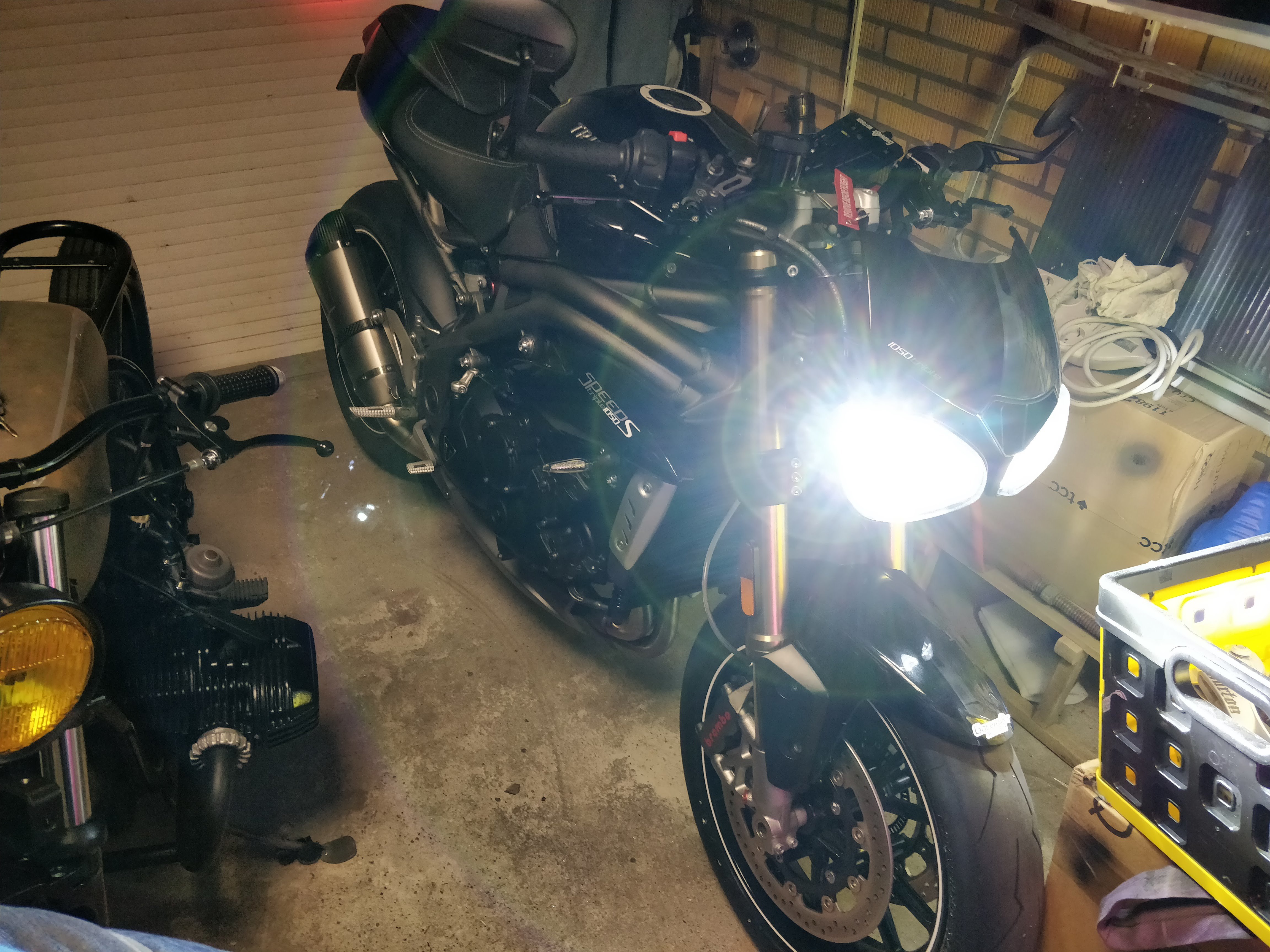

  14. Aaron van Twist
    Aaron van Twist New Member
    Feb 13, 2018
    6
    I have installed a set of ebay 20€ leds in my 2017 S3.
    Its a bit of a struggle , bit it fits and works perfectly.
  15. Red Thunder
    Red Thunder Crème de la Crème
    Dec 2, 2014
    2,034
    High Wycombe
    Oh Aaron, you do realise that teasing us with this information and not providing pictures is a cardinal sin here;)
    Pics or it didn't happen:)
  16. Aaron van Twist
    Feb 13, 2018
    6
    Here you go ;)
    • Thanks Thanks x 2
  17. Aaron van Twist
    Feb 13, 2018
    6
    its a bit of a struggle to place the connectors into the housing. Best way is to take of the mounting clip and put the lamp and cables into the housing and then to put the cli back to secure and hold the lamp.
