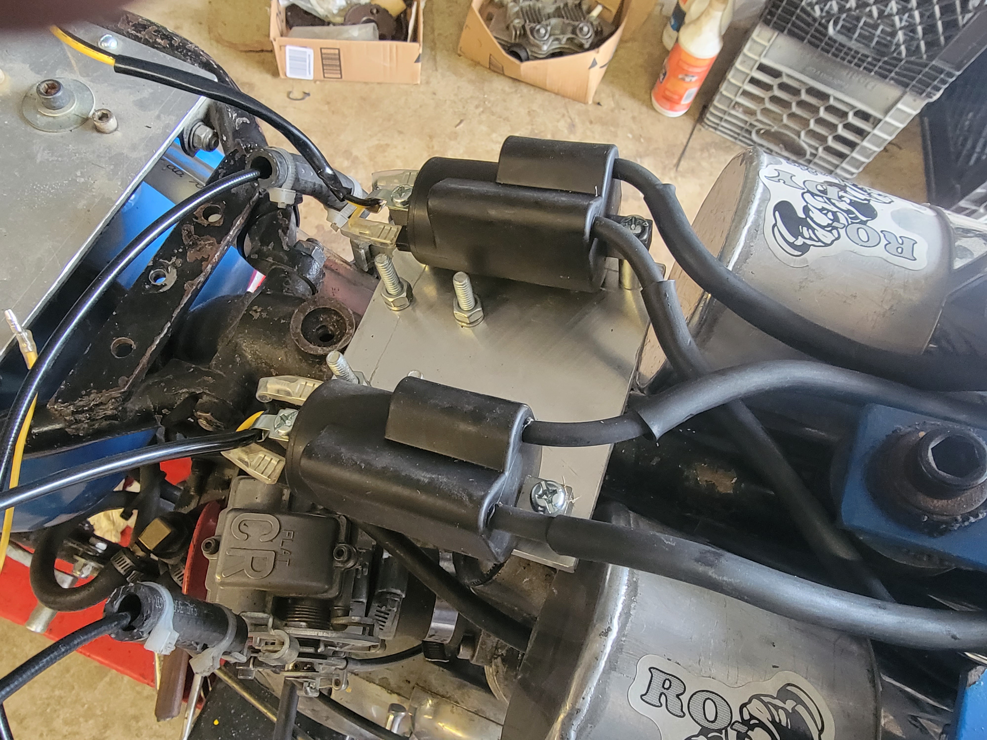

    coil mounting is a problem as im using the fairly heavy emgo standard twin lead 12volt coils, instead of the little micro things that came with the pazon. not a lot of places on a stripped machine to put them, but i have just ordered a 12 x 12-inch piece of 5000-alloy aluminum (i think this might be the old duralumin stuff) quarter in chick. i can cut a 4 by 6 piece of this out and then fasten it to the spine of the frame behind the tanks, with U bolts, then mount the coils on top on either side.
    that gets them close enough to the plugs that th emolded-in plug wires reach, and puts them in a place that i wont break them off lying down on the tanks.
    after that all i have to do is mount the transistor box and we ll see where we are.

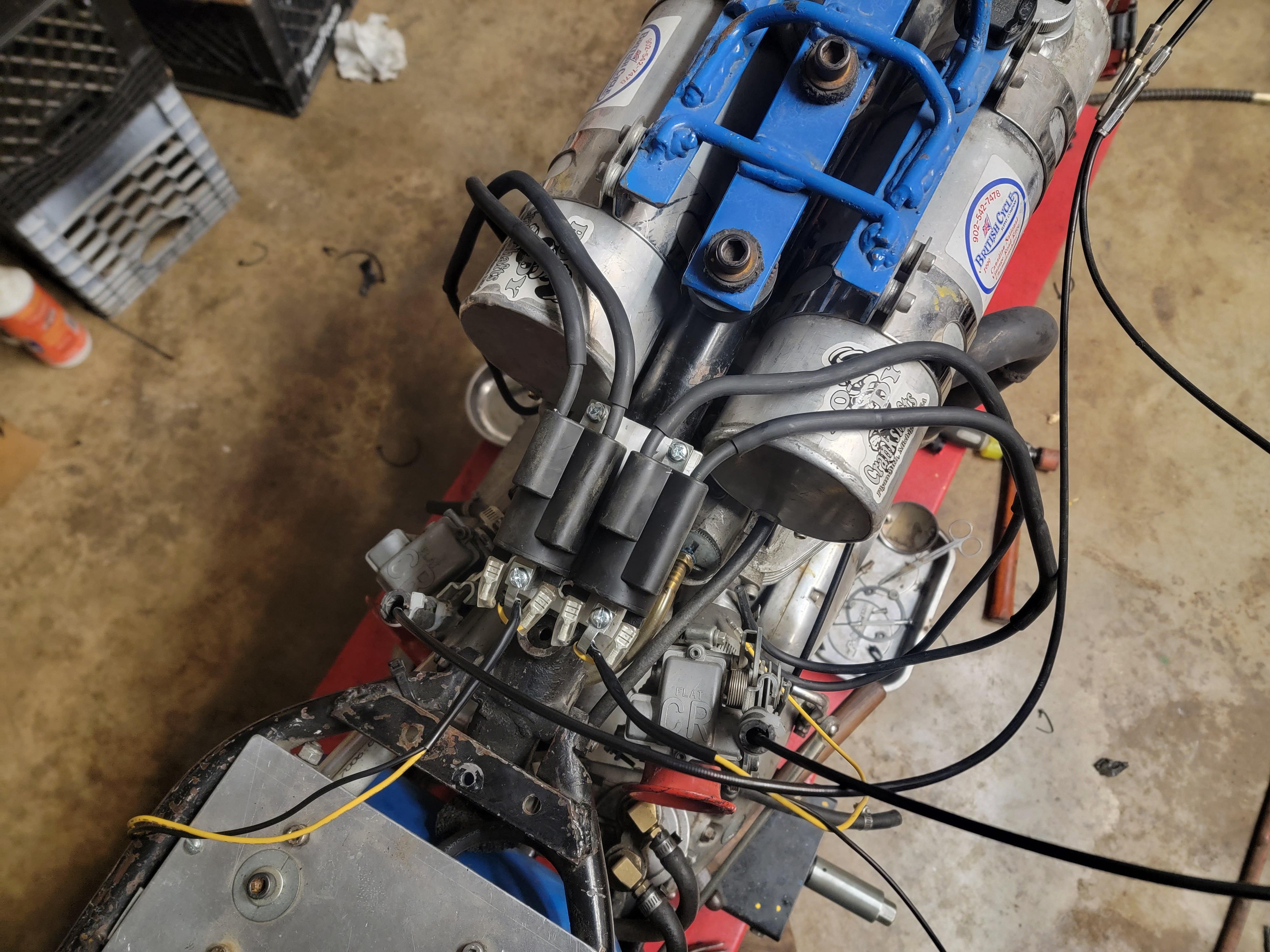

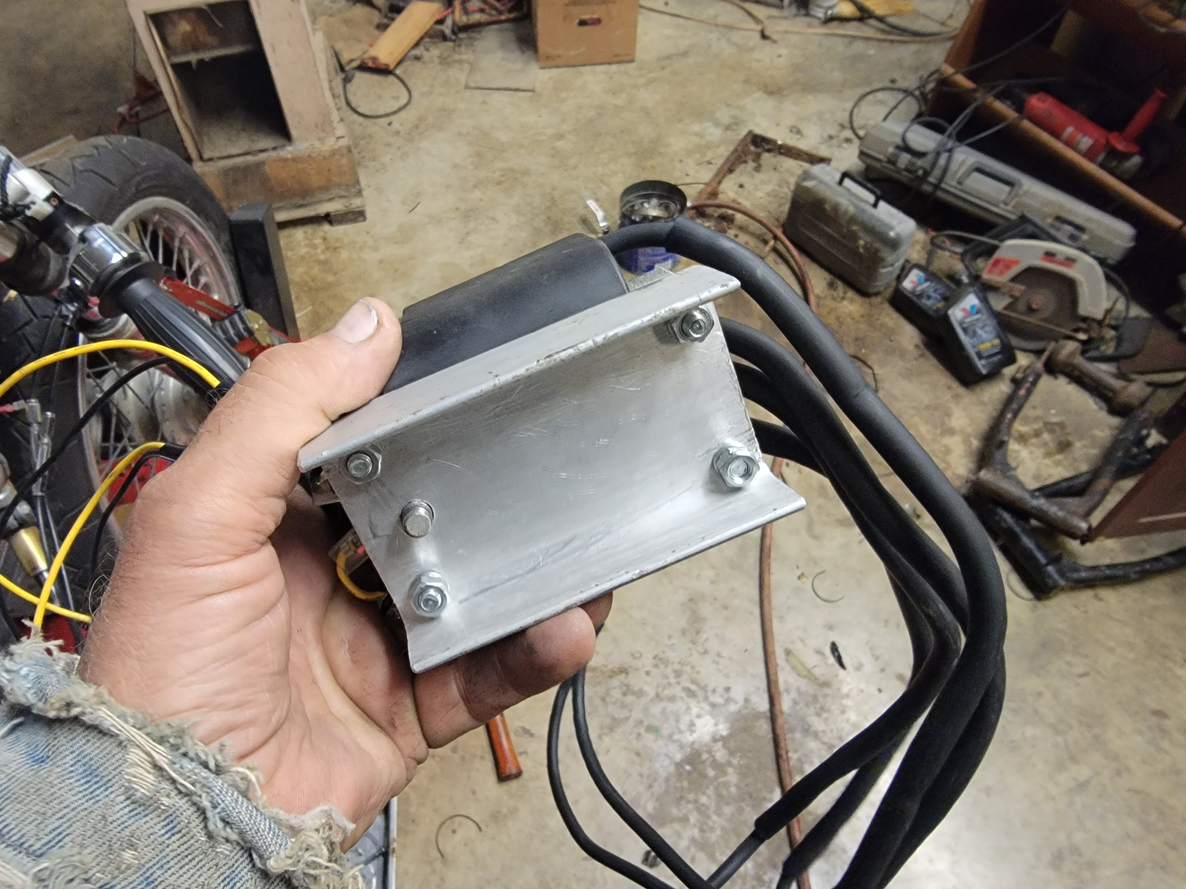

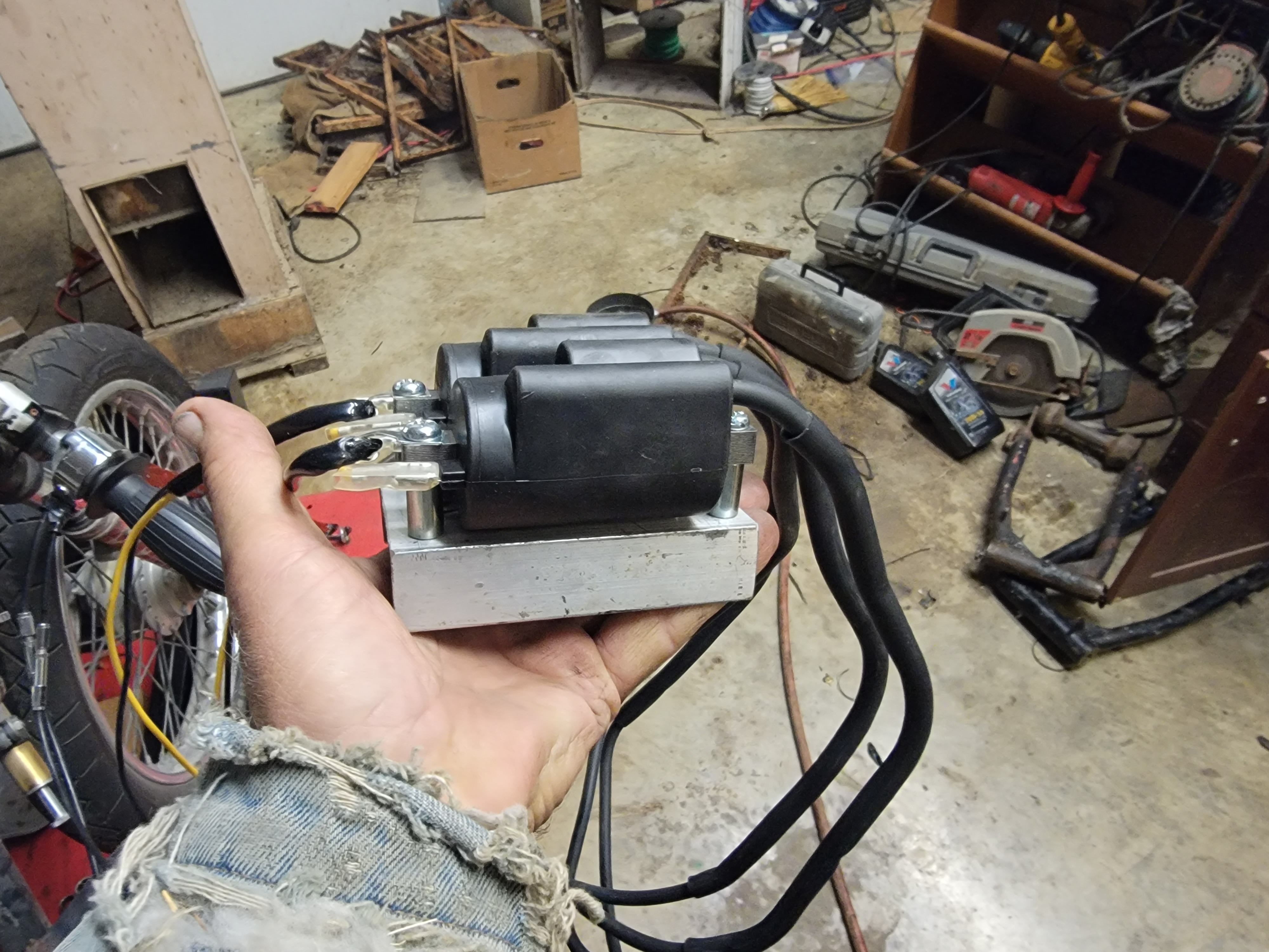

    in the meantime im trying to get a coil mount together. not so easy as it sounds, as there arent many places to attach them-- everything is squeezed tight to be as small as possible. no room under the tanks or up front, no easy spaces along the frame. im trying to place them behind the tanks, bolted to a bracket attached to the frame tube
    i scrou ged a piece of aluminum channel from the junk piles where i work that looked promising, but mounting it has issues. its not wide enough to separate the coils enough to allow mounting fasteners under it, and the single allen bolt to the rear that could have gone into the rear tank mount isnt long enough. on this 1965 frame, its a british thread form and american SAE screws wont go in. i dont have any CEI/whitworth/whatever bolts that would fit.
    so attaching the bracket has to be done with U-bolts, which means i have to have a larger bracket than this. i have some 5000-series aluminum plate coming in the mail-- nobody here sells quarter inch plate, and i need a piece about four by six inches.
    i looked all through my scrap pile but apparently my industrious sons made off with all my scrap for projects. who would have though building a simple bracket would take so long.
    metal is super expensive these days. a 12 x 12 x 1/4-inch piece of mild aluminum eas US$84. 6061 in the same size was close to a hundred.
    ignore tbese last duplicate photos. the forum software wont allow me to delete them.

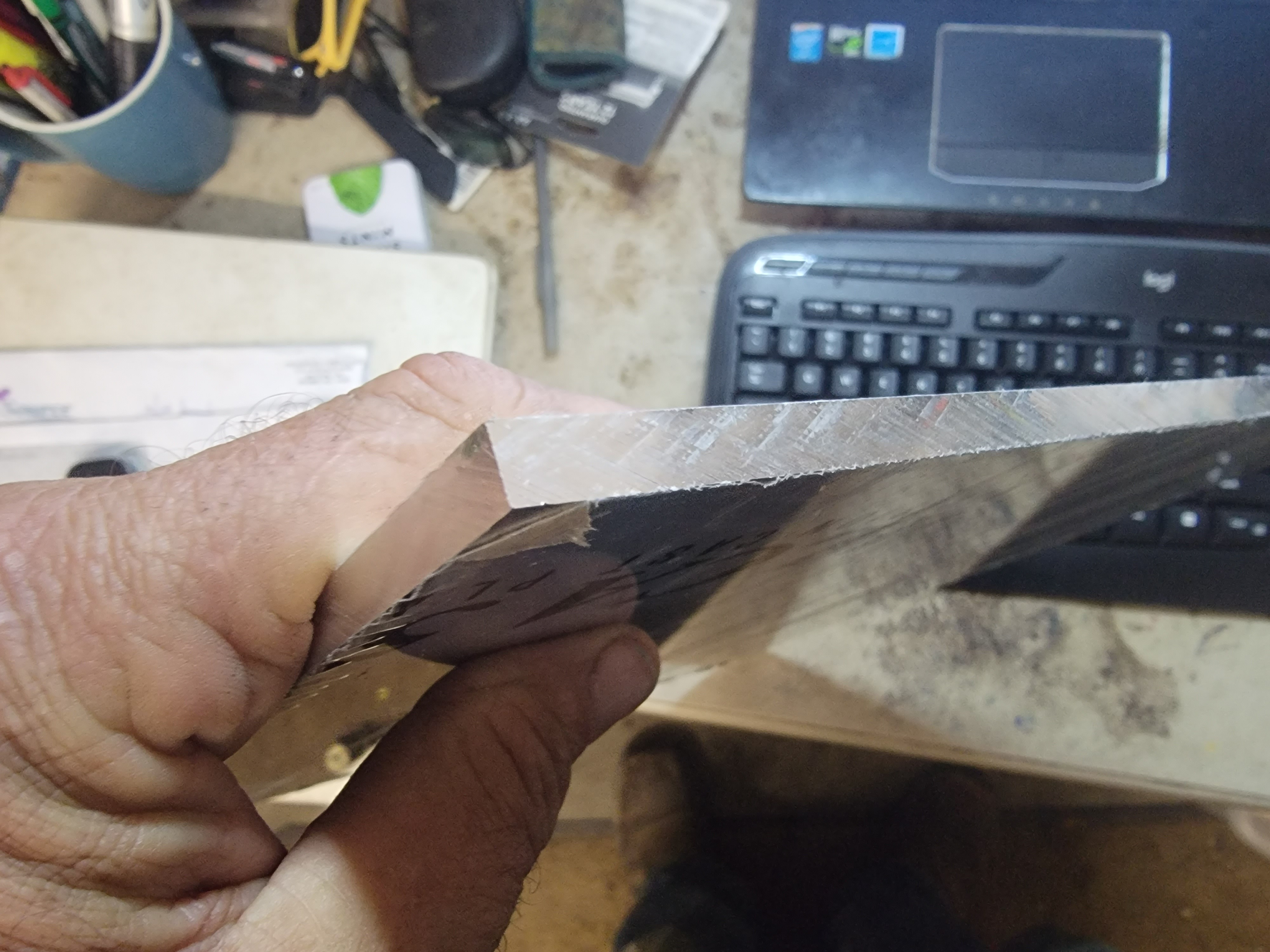

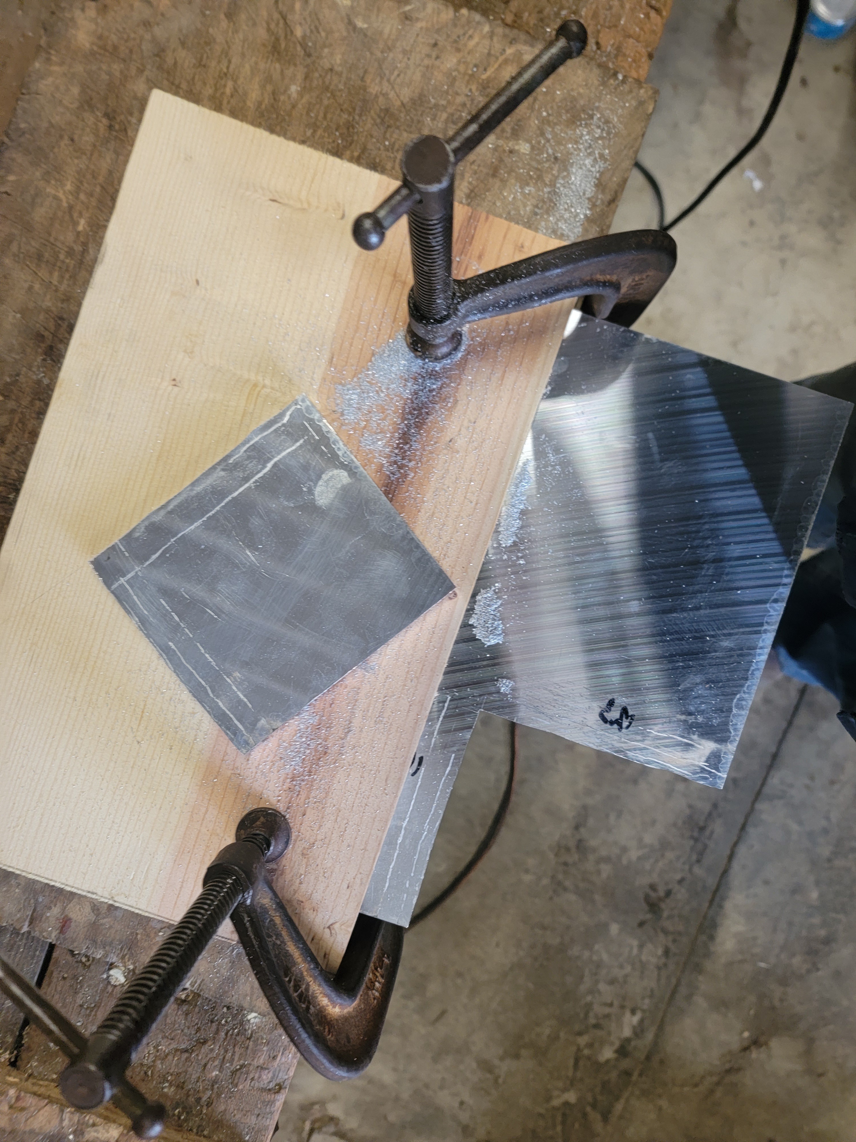

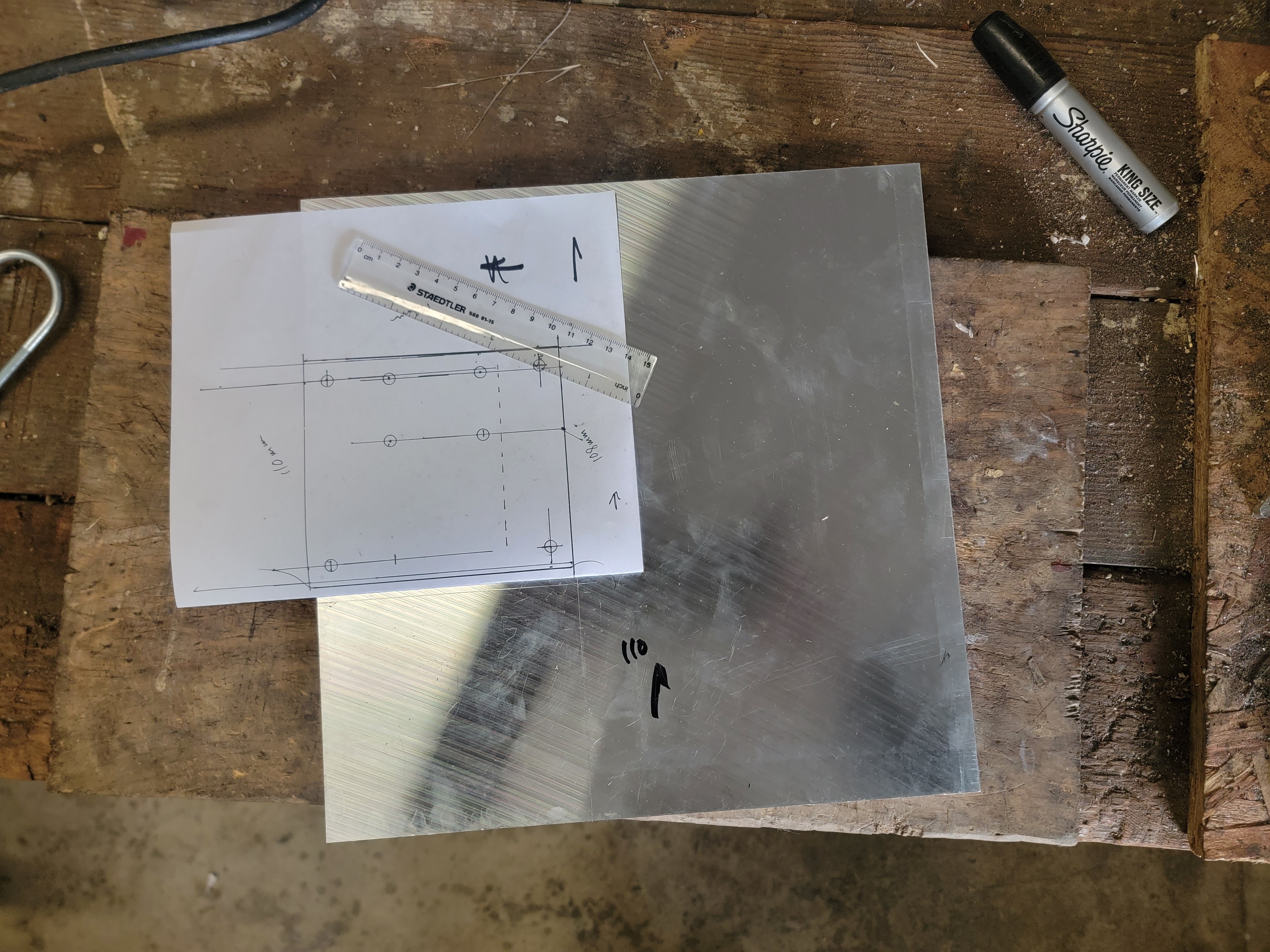

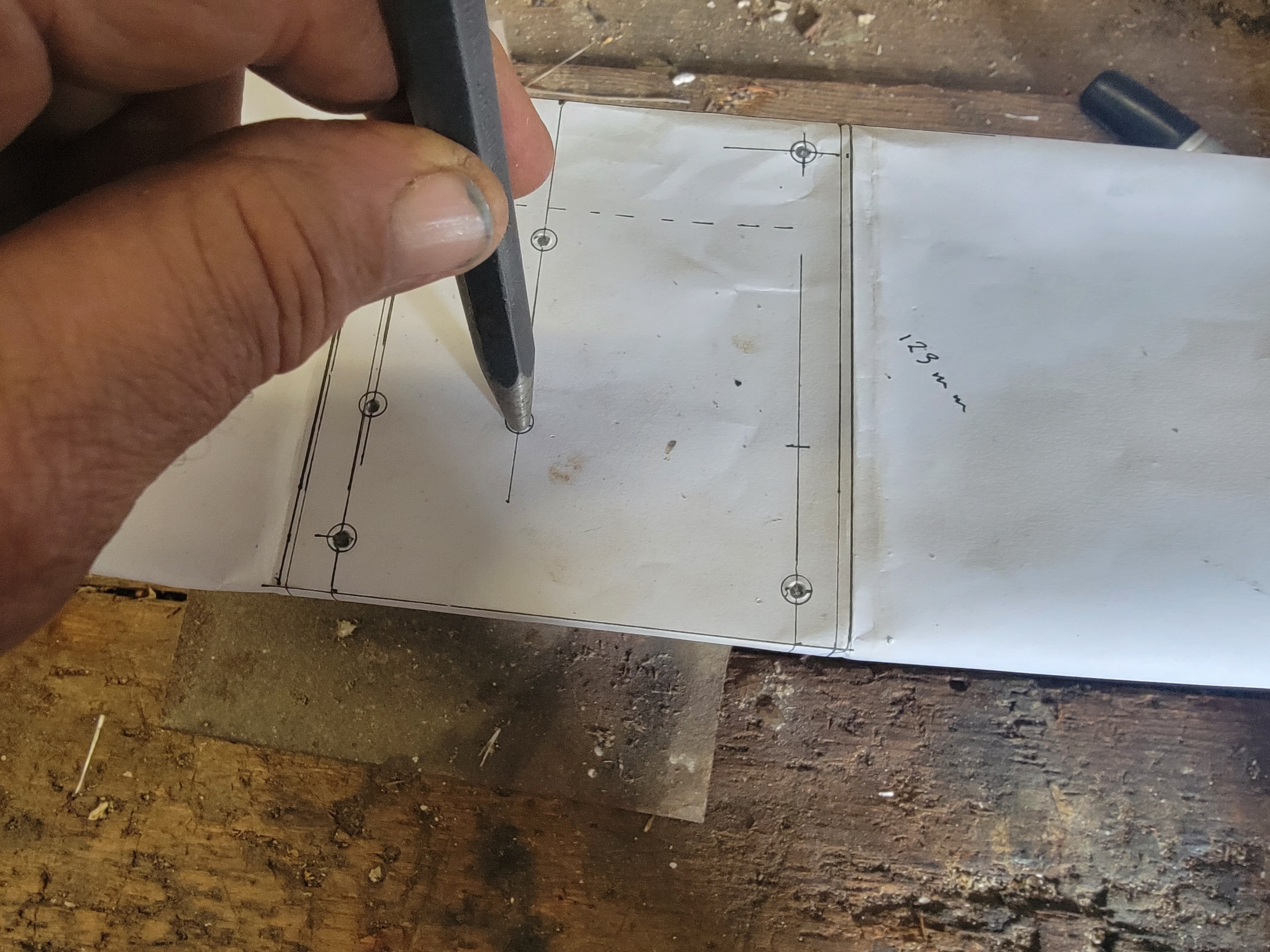

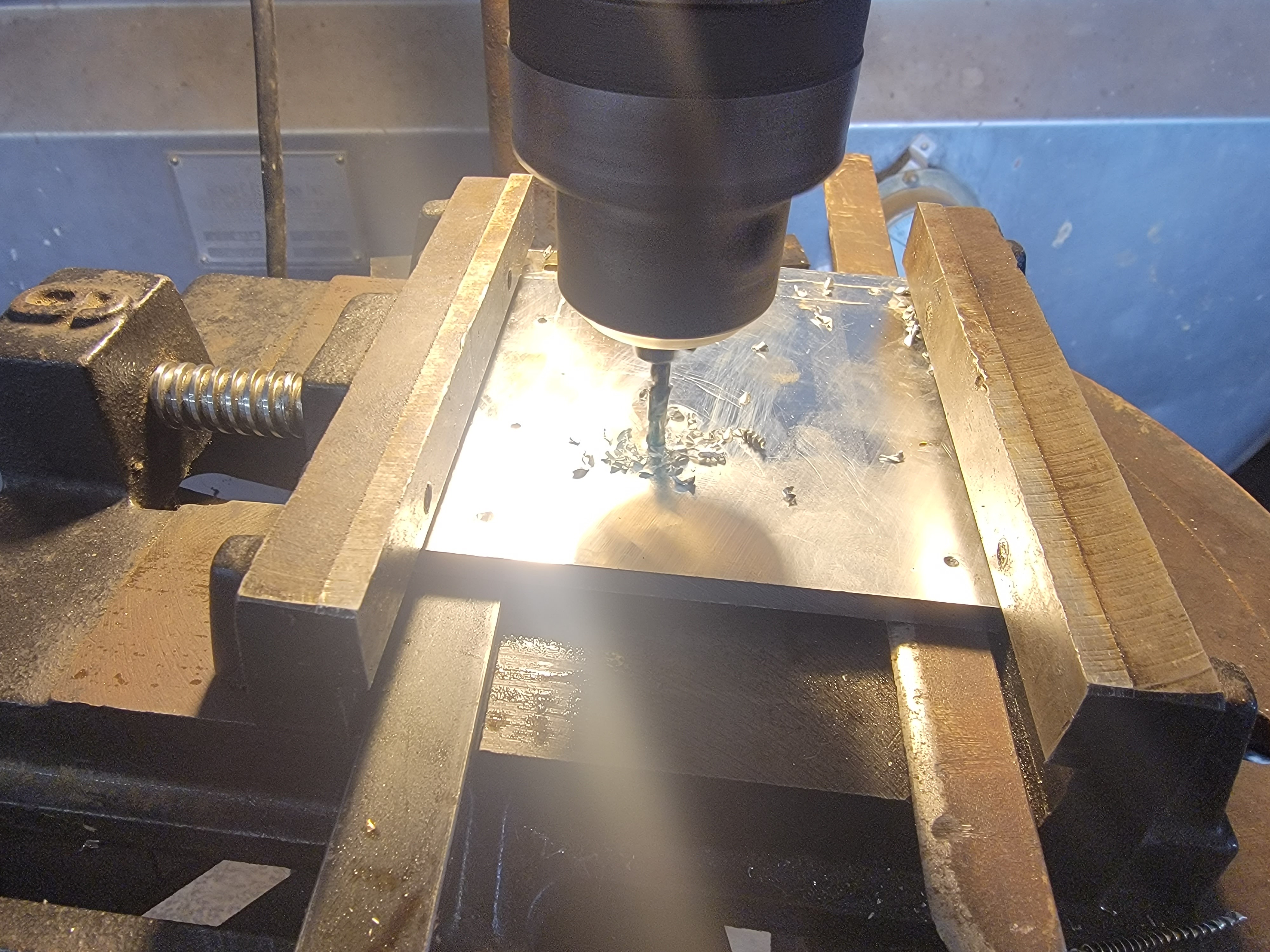

    well, the aluminum finally arrived. 12 x 12 x 0.25-inches. thicker than it needs to be, as 3/16 would have worked. the alloy is 5083, a medium strength metal that is good enough for me but not so hard to cut as 6061.
    i puzzled over the coil mount for several hours yesterday, trying to figure out something that would work. there simply arent a lot of good choices for something that should be so easy. in the end, i think a simple tablet U-bolted to the spine is best. i may separate the coils far enough to put the transistor box there too, else it can fit easily under the seat.

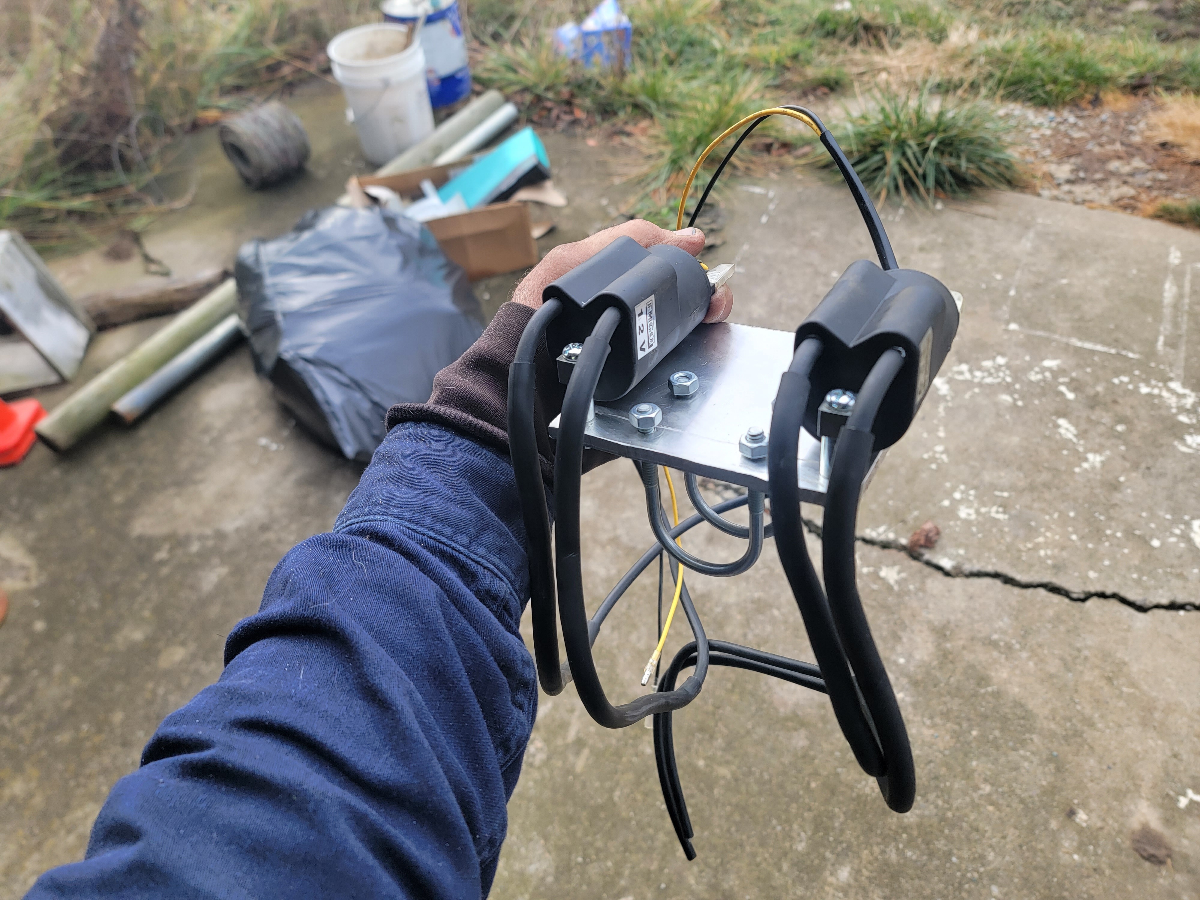

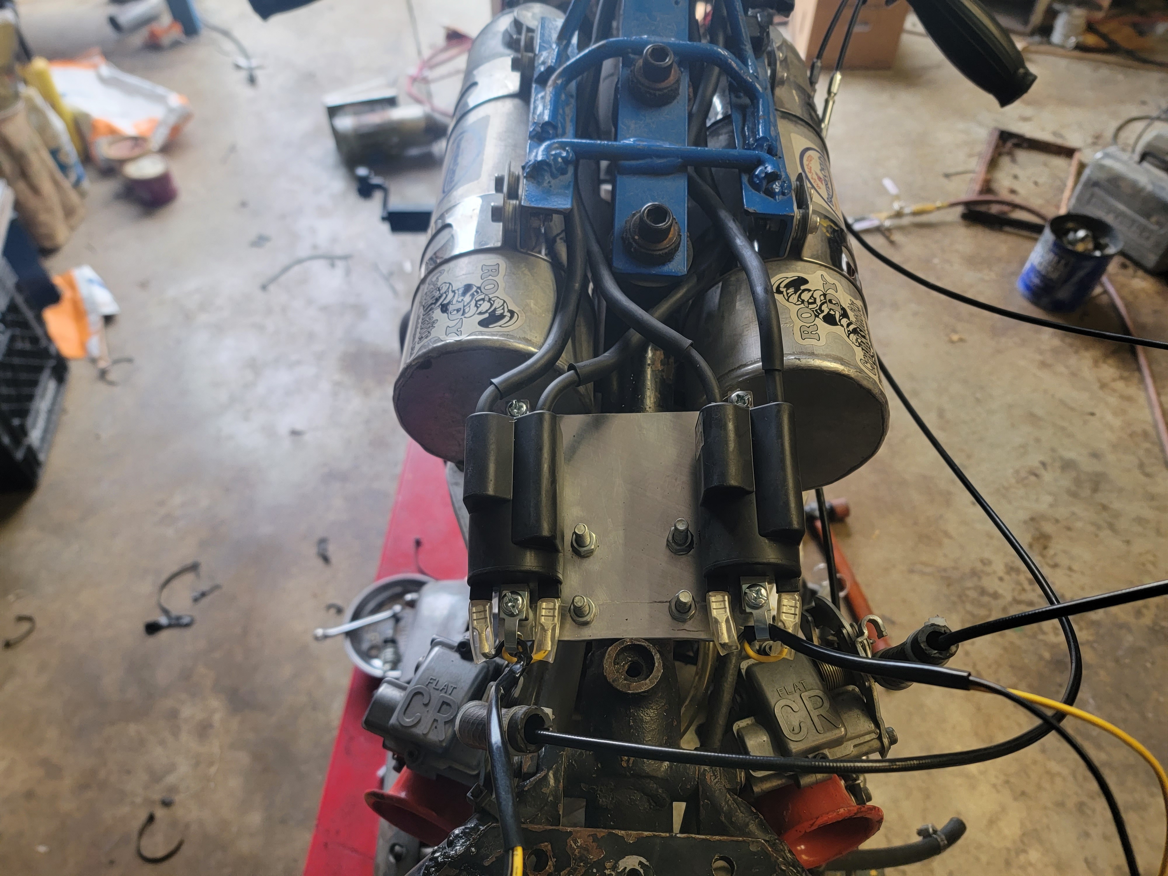

    but today its 60, and the warehouse door is open, and ive mounted the coils.
    my hellishly expensive piece of 5083 aluminum: 20231202_140610.jpg 20231202_135228.jpg
