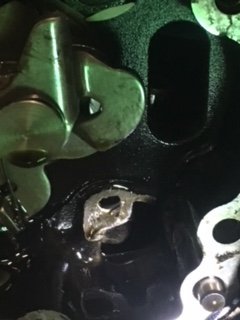

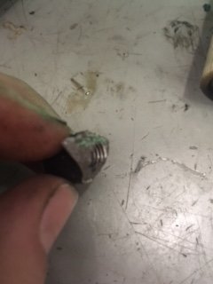

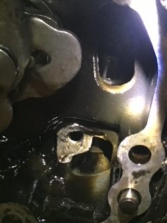

    It looks from the photo as though you might have a couple of threads left in the main casting. If you use the right size bolt (not the original it must be too short) you can clamp up the broken portion to the main casting. You can then look to drill one or two holes through the fat part of the stump into the main casting. You may conclude e.g. 1x 4mm hole is easiest. The alloy is fairly soft. Carefully collect and remove all swarf and avoid going right through.
    Then, when you come to epoxy the broken stud, you can use a high tensile bolt (e.g. the suggested 4mm right length with its head removed) to provide added strength to the repair and resist the ‘lever off’ action of the detent and spring. Chances are, the epoxy will intrude into the hole the detent stud occupies so clean its threads with a tap before attempting re-assembly. Again, engineering hygiene........to collect all/any swarf.

    I've been trying to piece together a lot of this. Would the longer bolt stay in permanently or is that just to clamp it while drilling? Where exactly should the drilled hole go, entirely through the broken off piece around the outside edge of the threaded hole (ie the stump, broken off base part?) and down into the casing (but not through)? I think then when the drilling is done, you mean to say clean up, remove the longer 'clamp' bolt, epoxy and clamp (with a dowel), retap, and then use the original bolt? Or should the longer bolt be used to add strength as well?
    I hope you don't mind giving further details. Still sorting out with machinists if a skilled weld, an epoxy w dowel, or some combination is the best solution. I wonder about the side-loading from the spring should a weld alone be used.

    212
    San Rafael
    tig weld if possible. epoxy will never hold and just leave you stranded. stuff happens

    The long bolt is a temporary means of clamping the parts together while the epoxy cures.....provided you have a couple of threads it can grip in the main casing. Lightly grease the bolt as a release agent or you will struggle to remove it!
    A separate hole/dowel arrangement in the thickest part of the casting 7 o’clock of the bolthole will strengthen the overall repair.
    However, a properly executed weld is undoubtedly the best and strongest solution. You are melting the aluminium back together and adding fresh aluminium (shielded by inert gas to prevent weakening oxidation) to create a ‘good as new’ joint. Again, clamping the workpieces is essential to a strong, properly aligned repair.
    Just make sure any repair shop sees/understands the job required. They will tell you if they can do it without dismantling the engine and gearbox and you will need to get the immediate area free from oil and any risk of ignition!
    Epoxy may be ‘good enough’ but I cannot gauge the force the spring/detente creates from here.......

    Local machinist can’t do it without the engine being apart. My buddy is going to run down and see it and check if his buddy who is a good fabricator can do it while still in the bike. Otherwise he has the know-how to help me get the engine out and apart so it can be worked on, then back together again. Probably done for the season after one ride but we shall see. He can’t help me until the winter.
