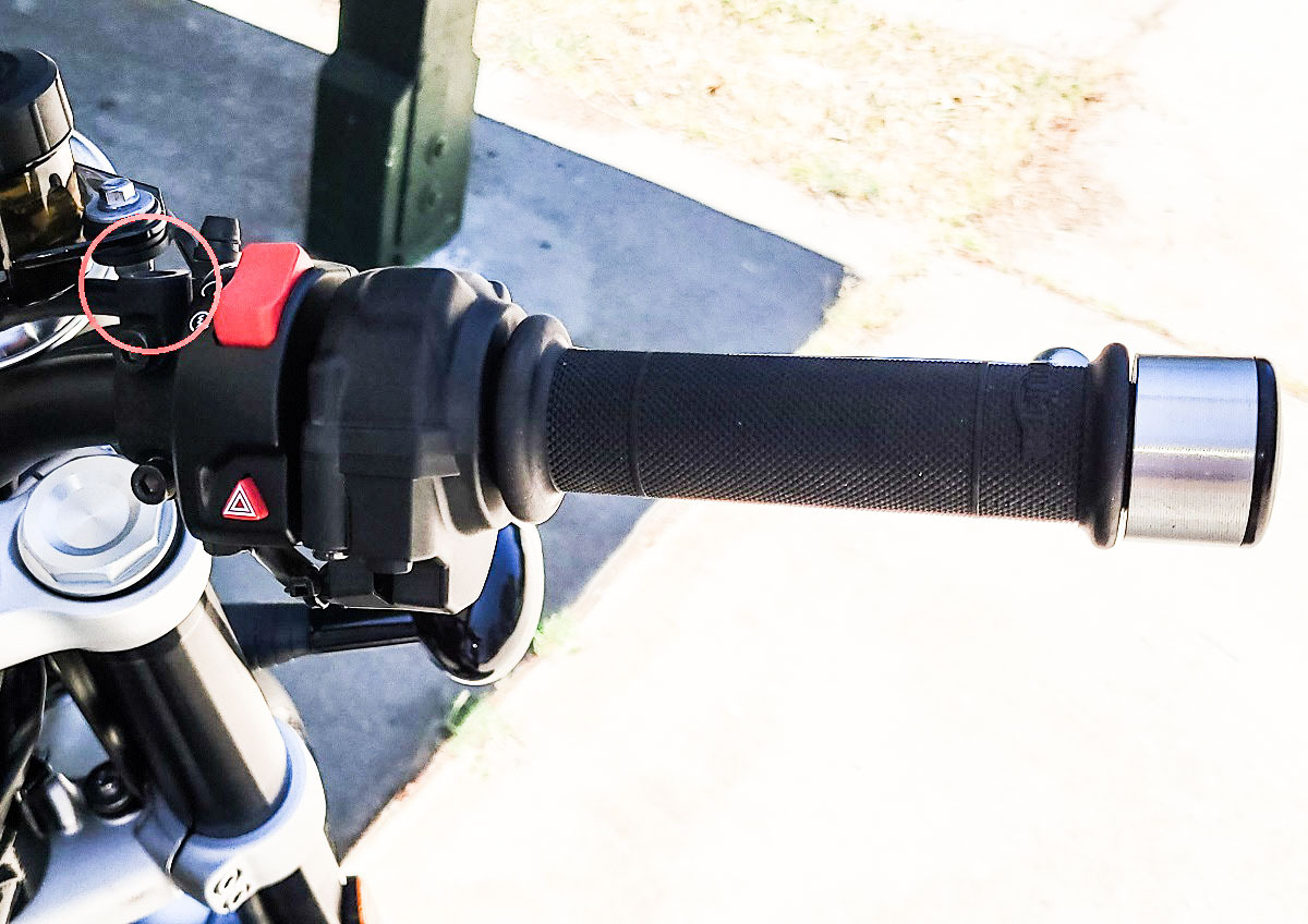

    Breitling weight and Bar end conversion to regular mirrors.
    I left the mirrors at home, so not seen in the picture.
    Mounts were brembo half clamps with 10 mm fine thread.
    These replaced the stock clamps on the clutch and F brake Master C.
