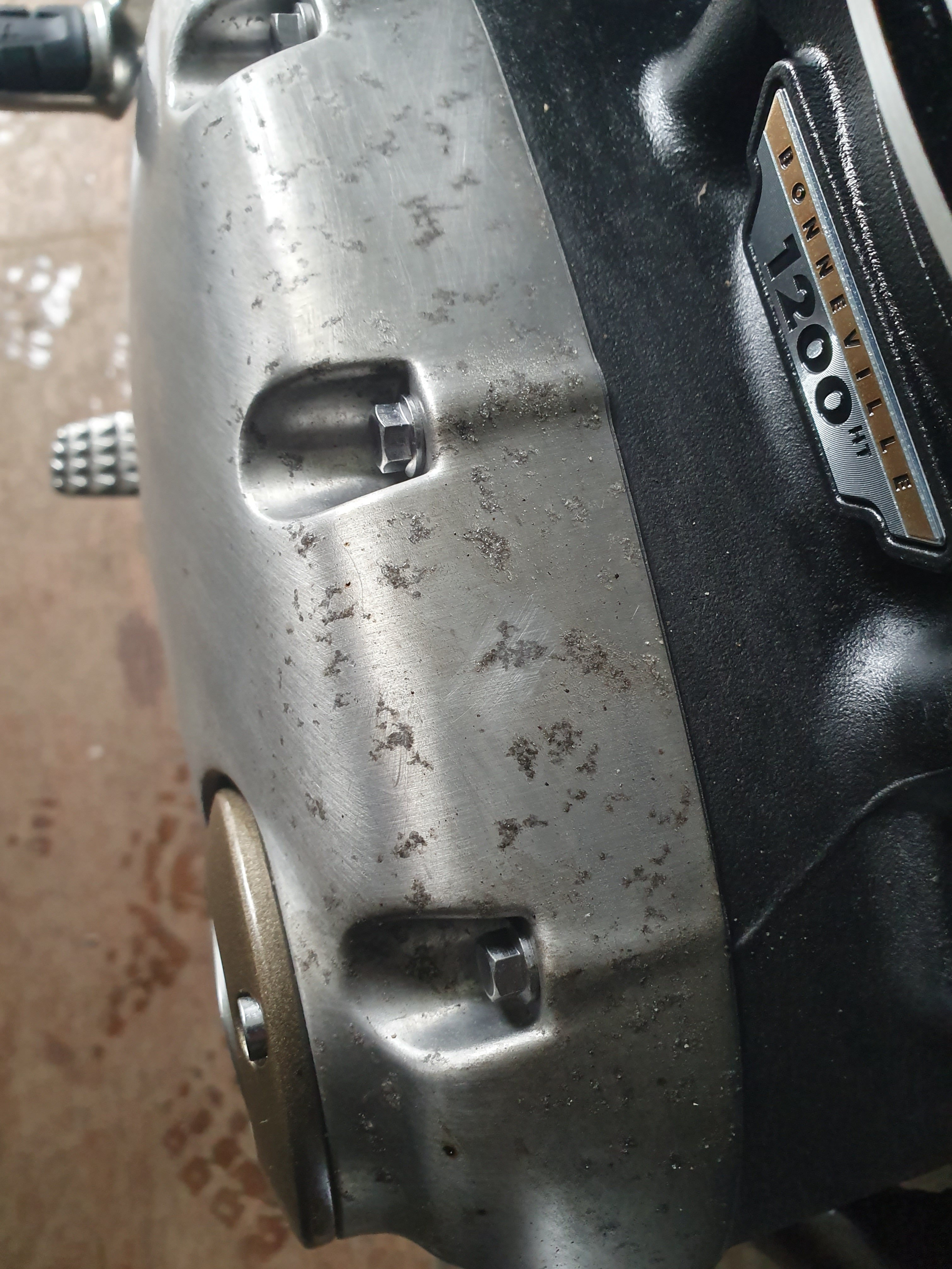

    Totally understand your disappointment .I found the same problem though caught it early on. Am fortunate enough to have the time to clean it regularly.
    I remember the dealer saying make sure you ACF it !
    Taking the bike in for a service tomorrow and it will be in over the weekend ,maybe a bit longer (apparently snow coming), so probably ask if the dealer he will wash it before the service rather than after.
    I like the bike so am just hopeful that I can deal with the issue .

    I absolutely feel your pain, OP, because I've had precisely the same issue with my Thruxton (which was bought pre-loved so no warranty comeback for me). In my experience it doesn't make any difference whether or not it's had an ACF-50 treatment, and it seems that the only way it can be prevented is to thoroughly clean the bike after each ride.
    Knowing that scenario was more than a little unlikely, and after giving it much thought, I've bitten the bullet and gone for a black engine conversion that includes the two engine cases, the sprocket cover and the two air intake covers (I already had aftermarket throttle body covers fitted that match the new look). That just leaves the heel guards, which Triumph don't make in black - I'll either leave them as-is or have them powder coated at some point in the future.
    The whole job was far from cheap, and I have to say that I'm pretty annoyed about the fact that the alloy used by Triumph has so little resilience... it'll certainly impact future bike selection decisions, anyway. Luckily I really like the black look (pretty much the way the new Thruxton RS leaves the factory) so I can live with the unplanned expenditure on the basis that I got some added value from it.

    Had same prob only much worse. Polished it out by hand with Solvol Autosol now I can see my face in the covers. I keep a bucket of water in garage and just give cases a very quick wash after every ride in winter ,works just fine and only takes couple of minutes.

    I just cant believe that making a requirement that a motorcycle is washed and dried EVERY use in bad weather is nothing more than a excuse to reject warranty claims. Im taking advise of if this statement makes the motorcycle fit for purpose for use in the UK. In fact with this attitude wonder what would happen if something else went wrong.
    The dealer is sorting out but has said that unless the washing and drying is done it will just go like this again.
    Watch this space, ill post what legal feedback I get.
