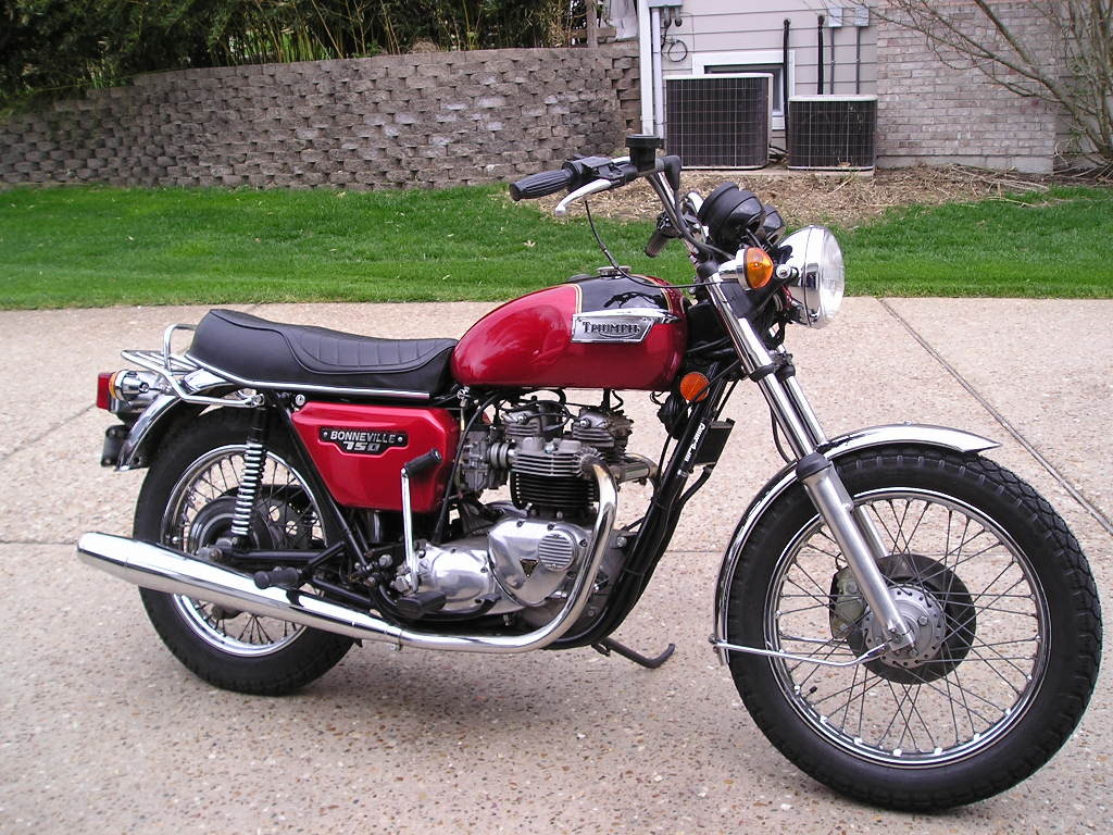

    Is the bike complete enough to get it running now? One thought, and something I've learned the hard way, is to get it running first... then tear it down and restore it to the condition you want. That way you know it runs and you won't be scratching or damaging fresh paint while you are taking things off and on while trying to get it running.
    Just a thought for consideration. Either way, you will have a good time working on the bike and learning as you go. Here is a photo of a '79 that I restored recently.

    Thanks for the tips by the way that looks a beauty

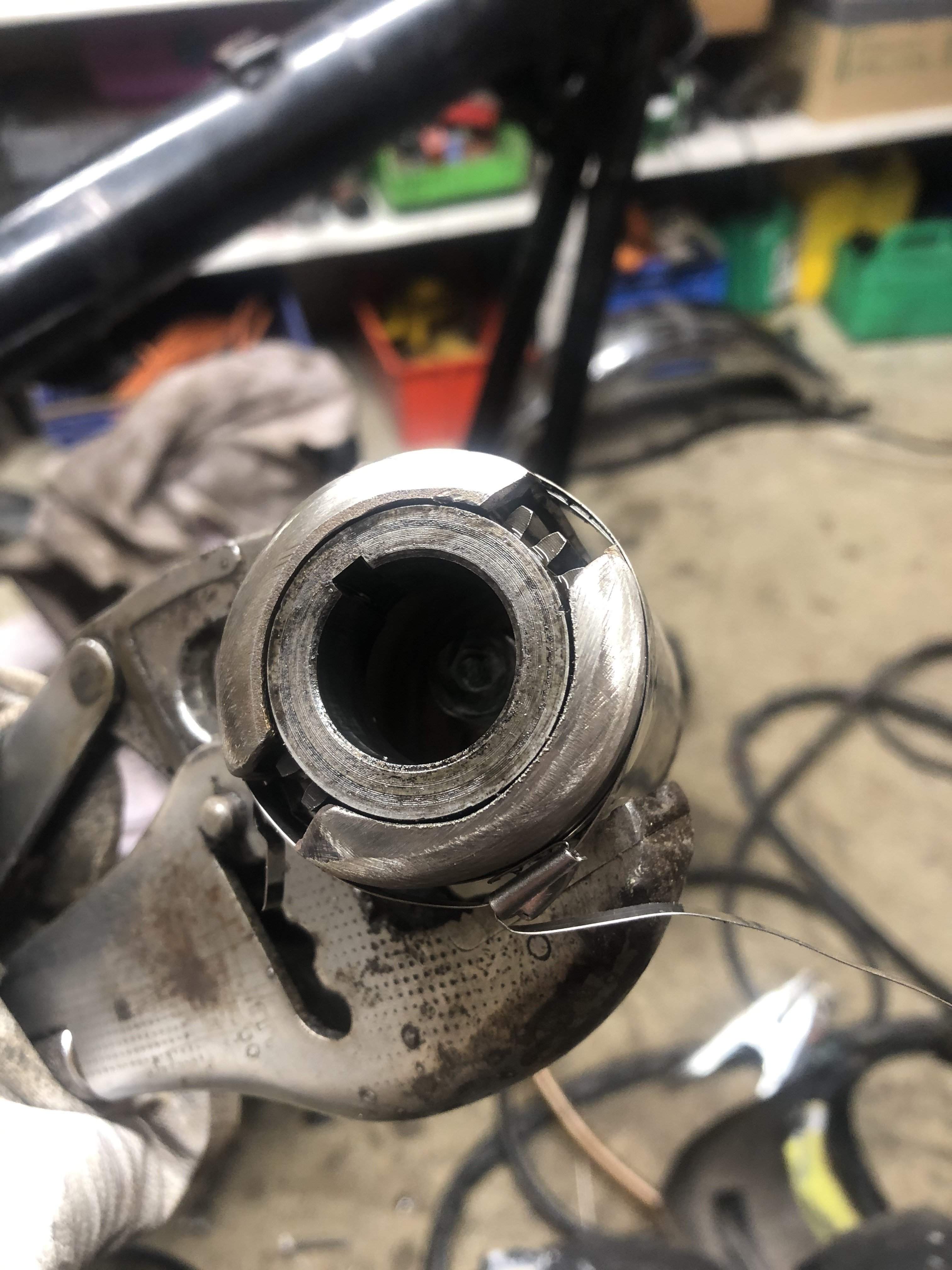

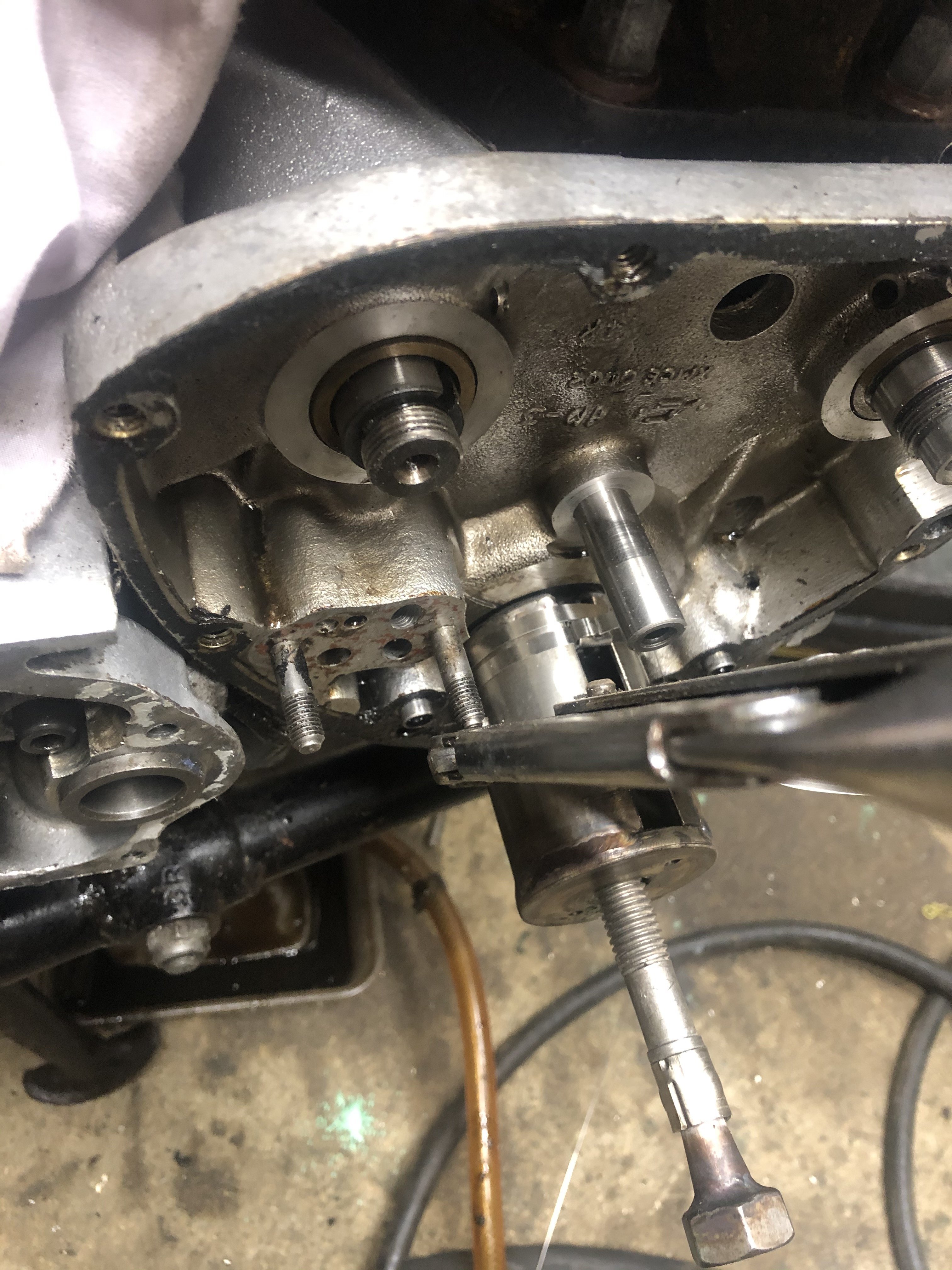

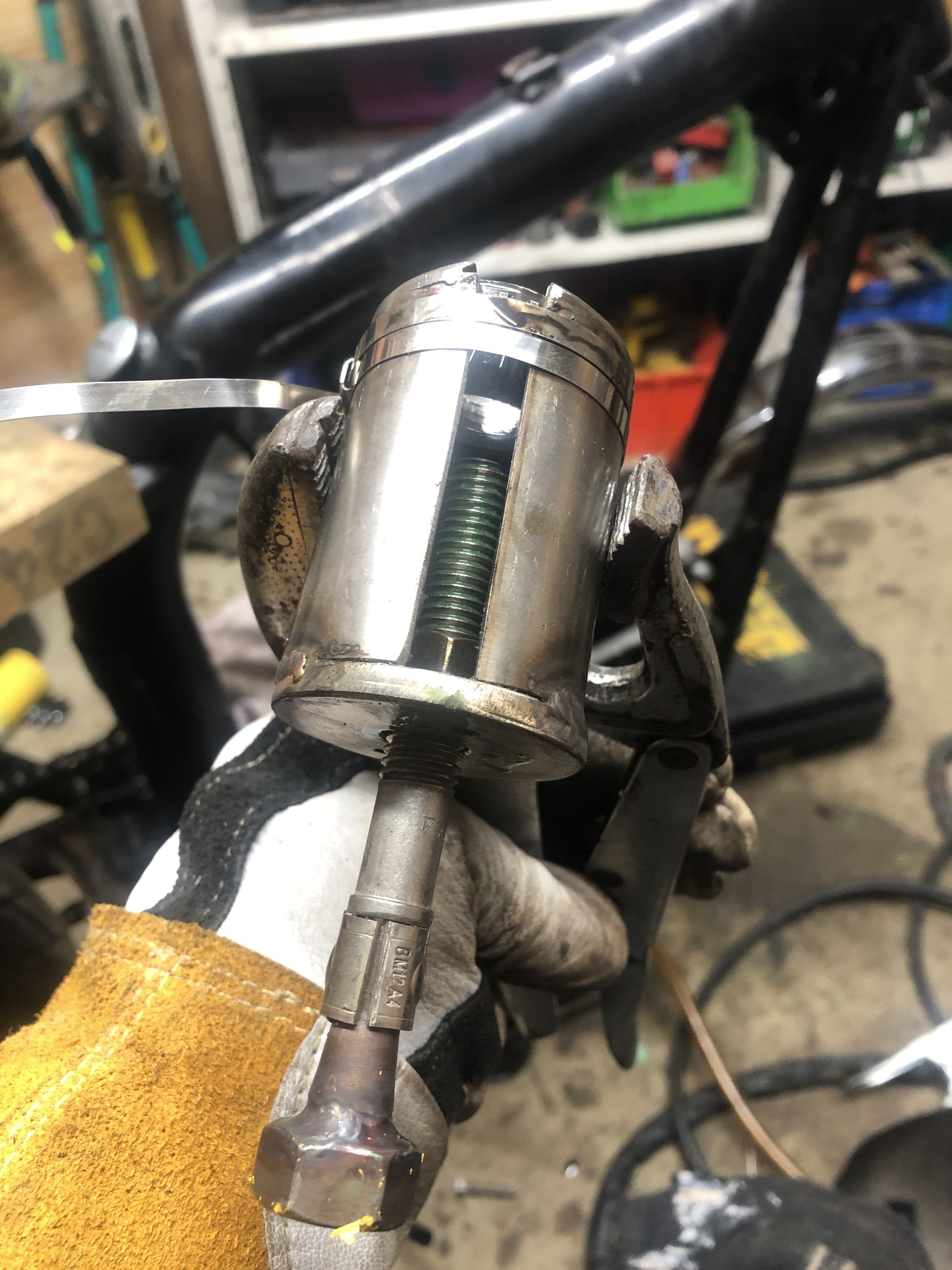

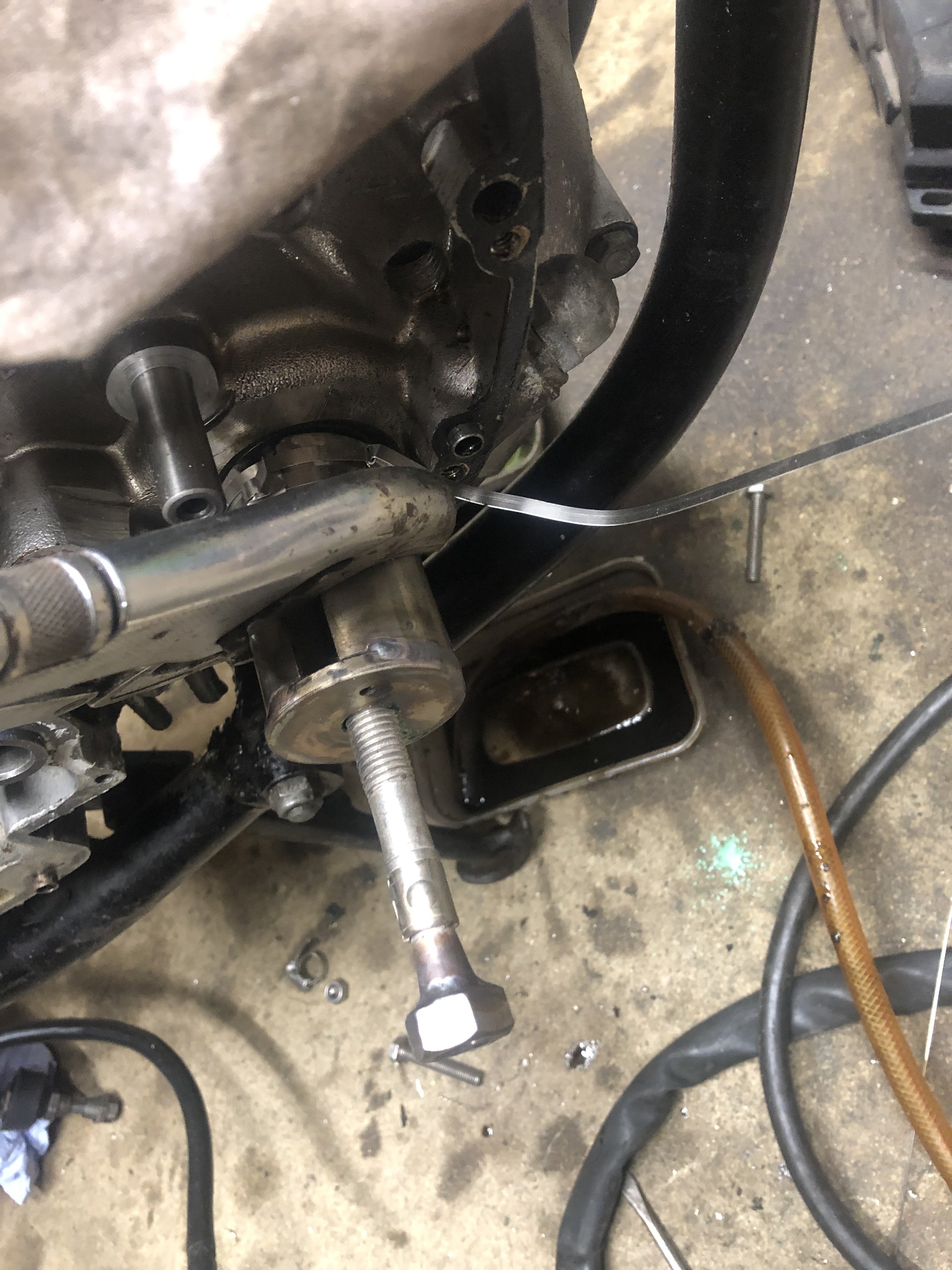

    Final piece of the jigsaw off the crank shaft pinion save myself £60 I made my own pinion puller out of what I had laying around a bit of hole sawing and a bit of welding and it’s off. I can split the crank cases now.

    I’ve finally removed the crankshaft pinion. I was trying to borrow one of the removal tools to save me £60 for one go but in the end I made my own, a bit of scrap a couple of hole saws and a bit of welding and the jobs done. I can split the crank case now
