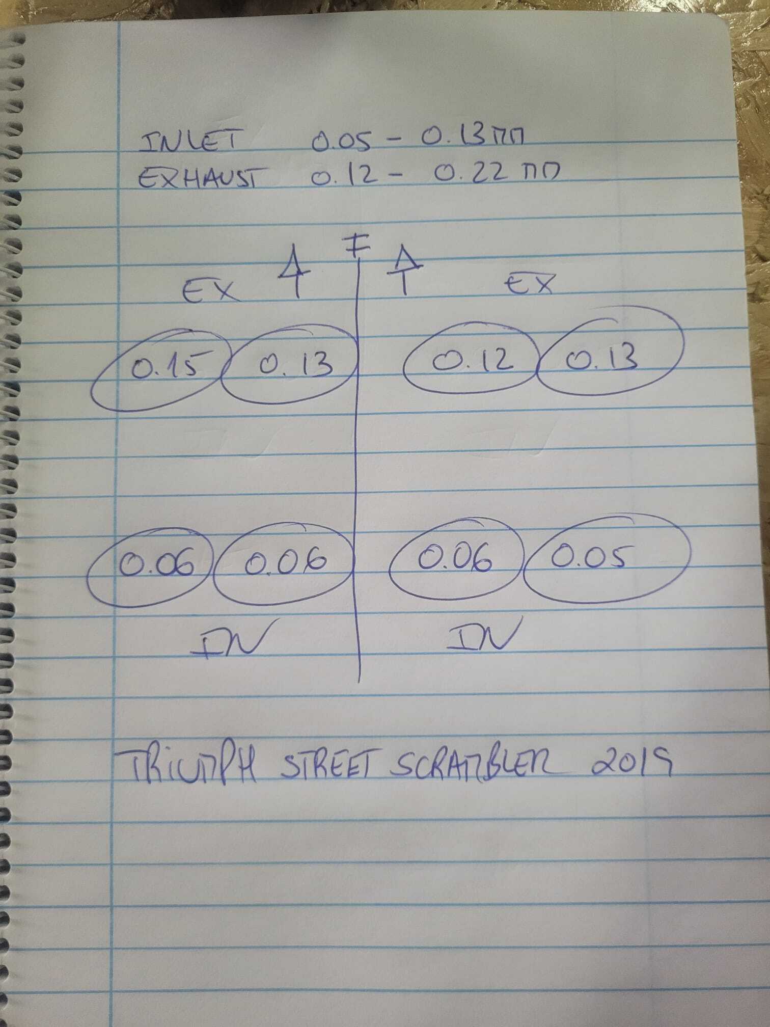

    Fabio the noise in your 2 videos sound different on each video.....one I hear is a regular steady tick tick tick about 1 per second.....very slow for an engine noise....does it increase with RPM?
    The other sound I hear which is a sort of irregular tapping sounds exactly the same as my tapping and the same as the taping PT was having.
    His tapping like mine was due to to big a valve clearance....only just fitted new valve shims over the last few days.....
    All of my 4 exhaust valves were right on the upper limit....in fact 1 was slightly over limit.
    I was not confident it was what was causing my noise.....but indeed my noise has gone.
    I know your mechanic says the valve gaps are ok on your bike....but can you trust them that they have indeed looked.....its quite an involved job.
    Mainly due the stuff that has to be removed to get the rocker cover off.
    If new shims are required....a lot of careful arithmetic is req.
    My noise would disappear as the engine started to warm up....usually around 2 minutes after cold start.

    My T100 has been back to the dealers 3 times.....none of them knew what it was....2 said balance shaft adjustment but as it soon disappeared as the engine warmed....they said to ignore it....to me thats a very very poor attitude.....I feel I have been fed a line.
    I had the balance shaft adjustment checked twice.....it was fine.
    The third time it was the Triumph Factory Engineer.....she said she could not even hears it.....maybe the battery in her hearing aids needed changing.
    My valve clearances have been checked and adjusted.....as I expected that made no difference.
    My present thinking is it could be the valve rocker arms jiggling back and until the alloy head warms and expands.....I say this as when the valve gaps were being checked the mechanic showed me the side to side play in the rocker arms....the sound the make contacting the support post sounds exactly like the tapping noise I hear on cold start.
    I to am thinking it could be the very thin when cold 10/40 fully synthetic engine oil....as I did not hear this noise untill after the first oil change at 500 miles.
    The factory running in oil is SAE 30 I was told.
    My next oil change is due soon.....I am thinking of buying some SAE30 oil to put in the engine for a very short time just to see how it is during cold starts.
    I wont ride the bike with this oil in it.....just try some cold starts over a few days to see how it sounds.
