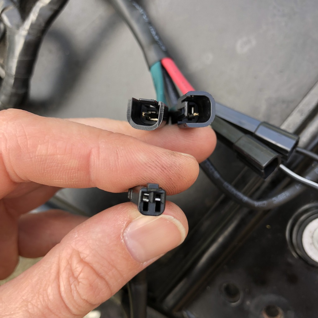

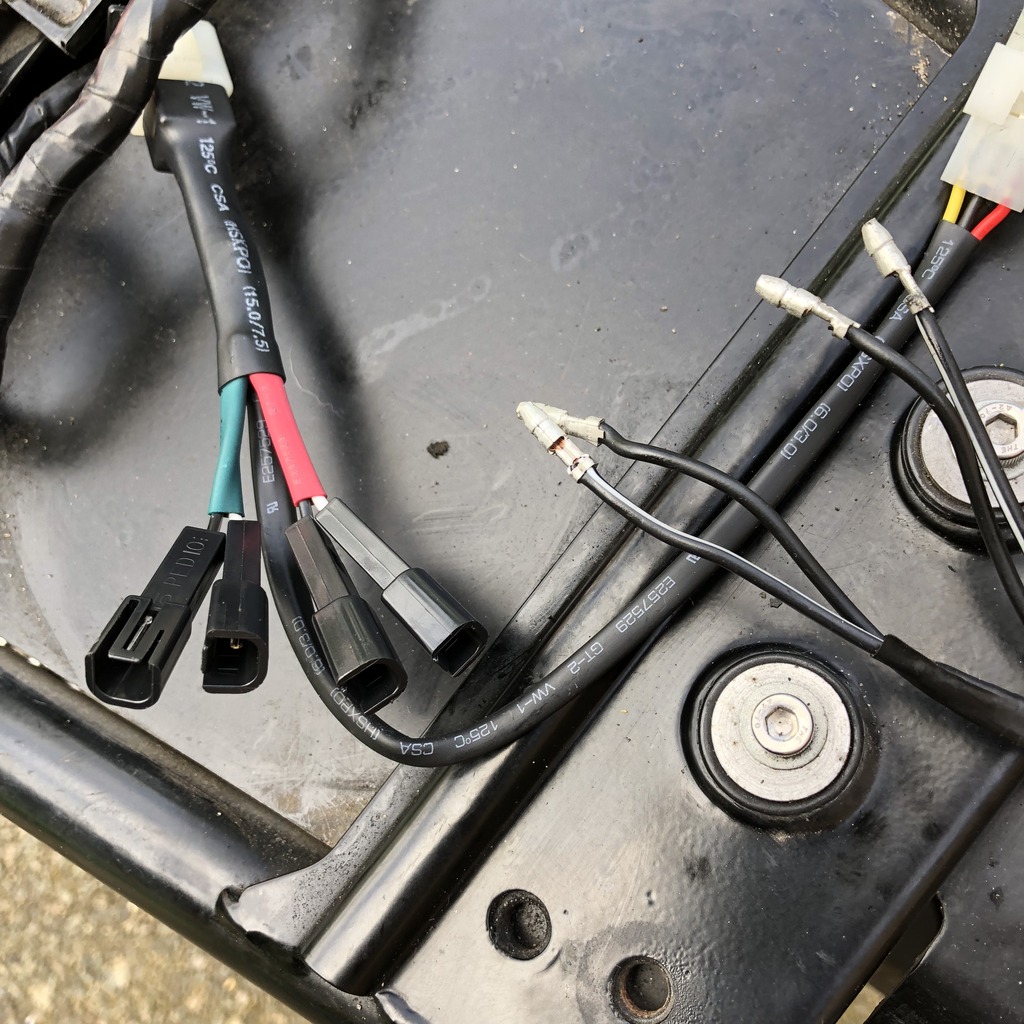

    LED tail/brake light turns up so thought I'd fit it, the connector for the light fits no problem however the connections for the indicators do not.
    Thought I had some interconnects for the turn signals somehwere so dug them out but they were for an old bike and don't fit either, go figure : unamused:
    Anyway picked up what I hope are the correct connectors from square deals just now.
  17. Thruccy Sean
    Thruccy Sean Well-Known Member
    Mar 14, 2017
    301
    Wallington, Surrey
    Well the indicator connectors arrived from squaredeals and fitted perrfectly. However it doesn't seem to matter what combinaton I use the tail light flashes when the indicators are on?
    It lessens somewhat when the bikes running but I know it's not right so what am I doing wrong?
    I don't think it's an issue with running an LED tail light/standard indicator combo as @crispey has the same set-up on his bike.
    Thanks,
    Sean.

    Hmmm, that’s a weird one, have you tried with just one side wired up then the other to narrow down anything, I’m away from home at the moment so can’t check my wiring

    Yep tried that and it was the same. In fact I just tried without the rear indicators conencted at all (so just the front ones in which I haven't touched) and the tail light STILL flashed in time with the indicators when they were on! :(

    I notice the LED tail light doesn't have an earth wire (don't know if it should or not) the standard/previous tail light did have an earth wire?
