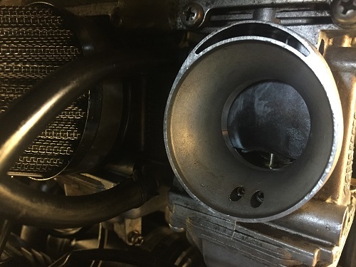

    Chris , do you know by any chance the outer diameter size of the carb where the filter fits

    No but I'll pop one off tomorrow and measure it for you

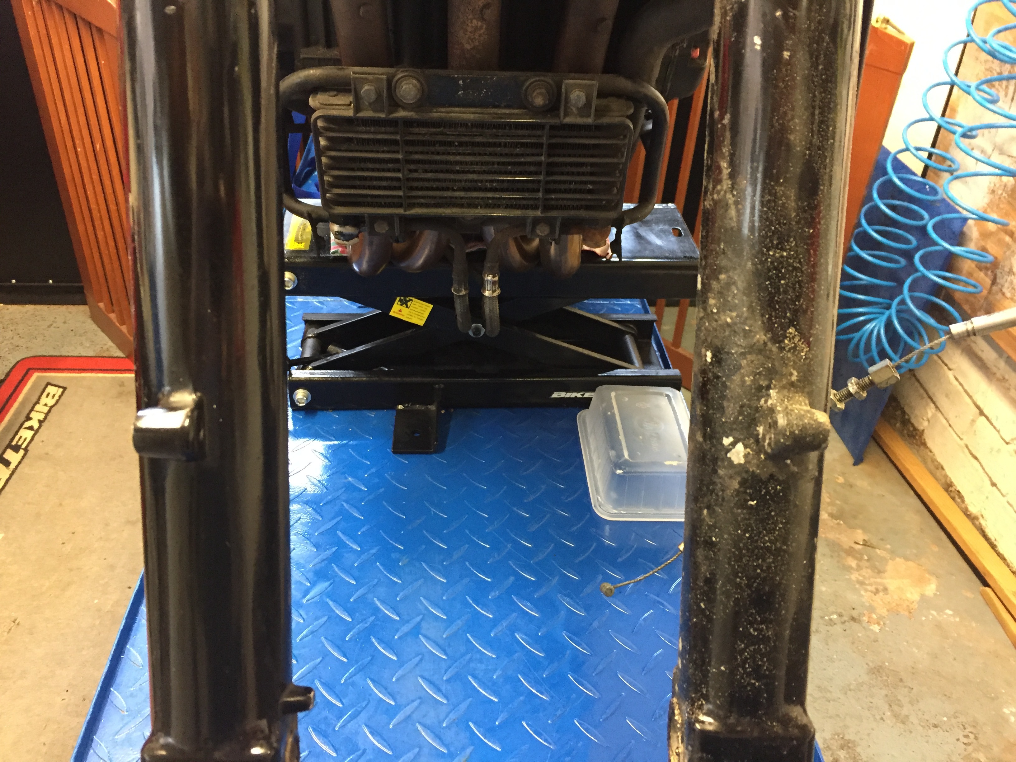

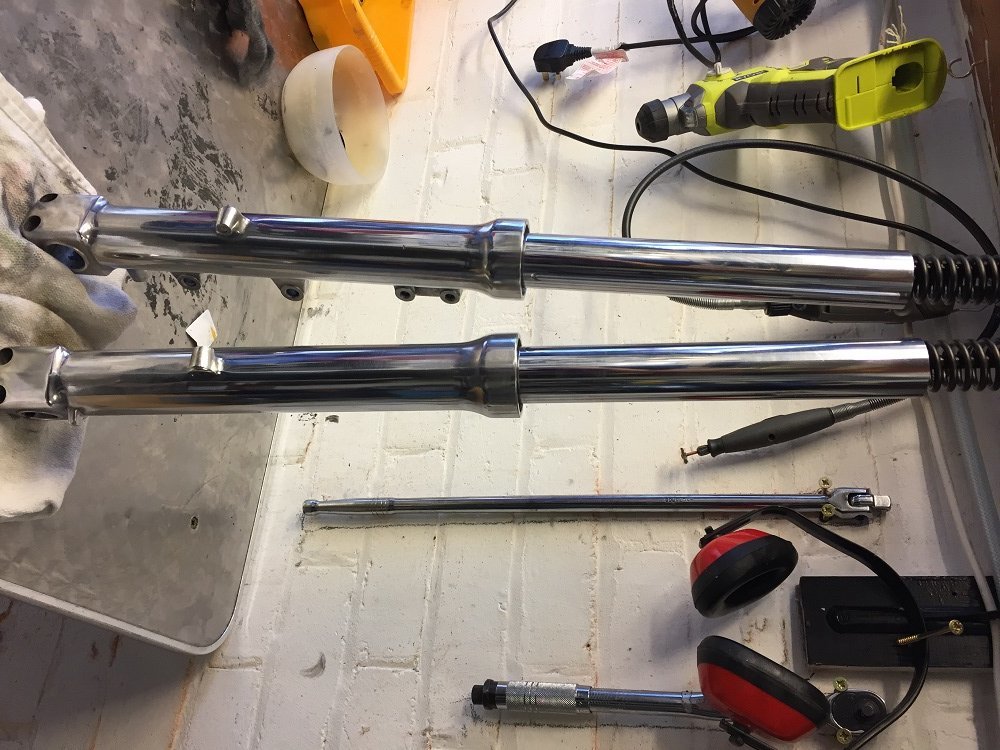

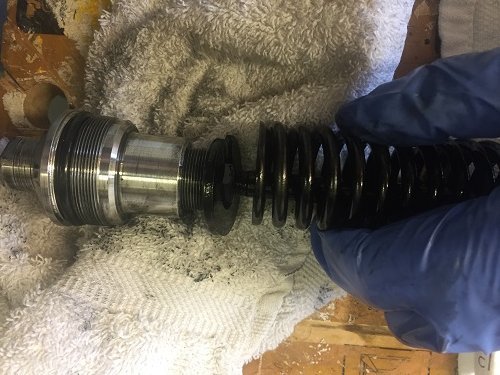

    I was guessing, but by the state of other bits on the bike the fork oil had never been changed. Never serviced forks before so scanned quite a bit of info on how to tackle it. Also the paint on the forks was in poor condition in some places, and I was hoping to move to a polished finish instead. Was'nt sure how this was going to turn out but worth a try
    As you can see they're not in the best of shape, no leaks though.

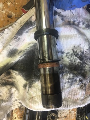

    Popped out the bolts a the bottom holding the damper mechanism in, held the body in a workbench, dust seal and spring clip out, then yanked at the inner fork until the top bush popped out.
    I don't know f this is normal but the oil that came out was pitch black, and absolutely stunk. Must have been the original oil
    I've used Nitromors in the past for getting old paint off and it did the job on the forks
    The nitromors did most of the work but they needed a good graded polish
    I used an orbital sander and a Dremel to clean the forks up, and started with 500 grade to 1500 and finished up using some "Mothers Mag & Aluminium Polish" (never used this before but sore a guy on YouTube using it and his results were good
    I spent about an hour on each fork, they were far from perfect but they were going back on a bike that had a few scars during it's life

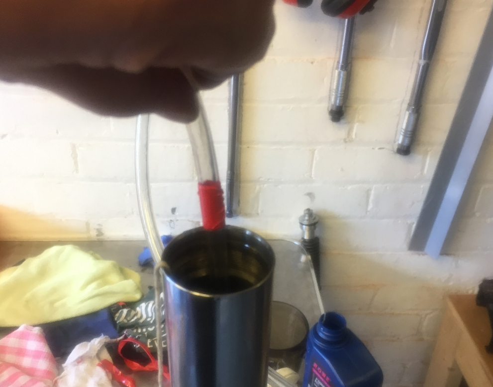

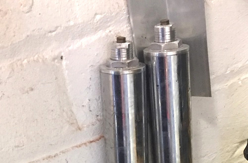

    New fork seals, i'd love to take the credit for this DIY seal replacement but a guy on YouTube used electrical tape wound round the tube (a couple of mm) and used the action of the fork to drive in the seal and bush. This worked an absolute treat thumbs up to that Guy
    Replacing the oil was straight forward, springs and damper adjust removed from the top and oil replaced to the specified height. Used a bit of tube set at the correct depth to remove any access
    Then remove air from damper mechanism
    Top back on and they feel nice

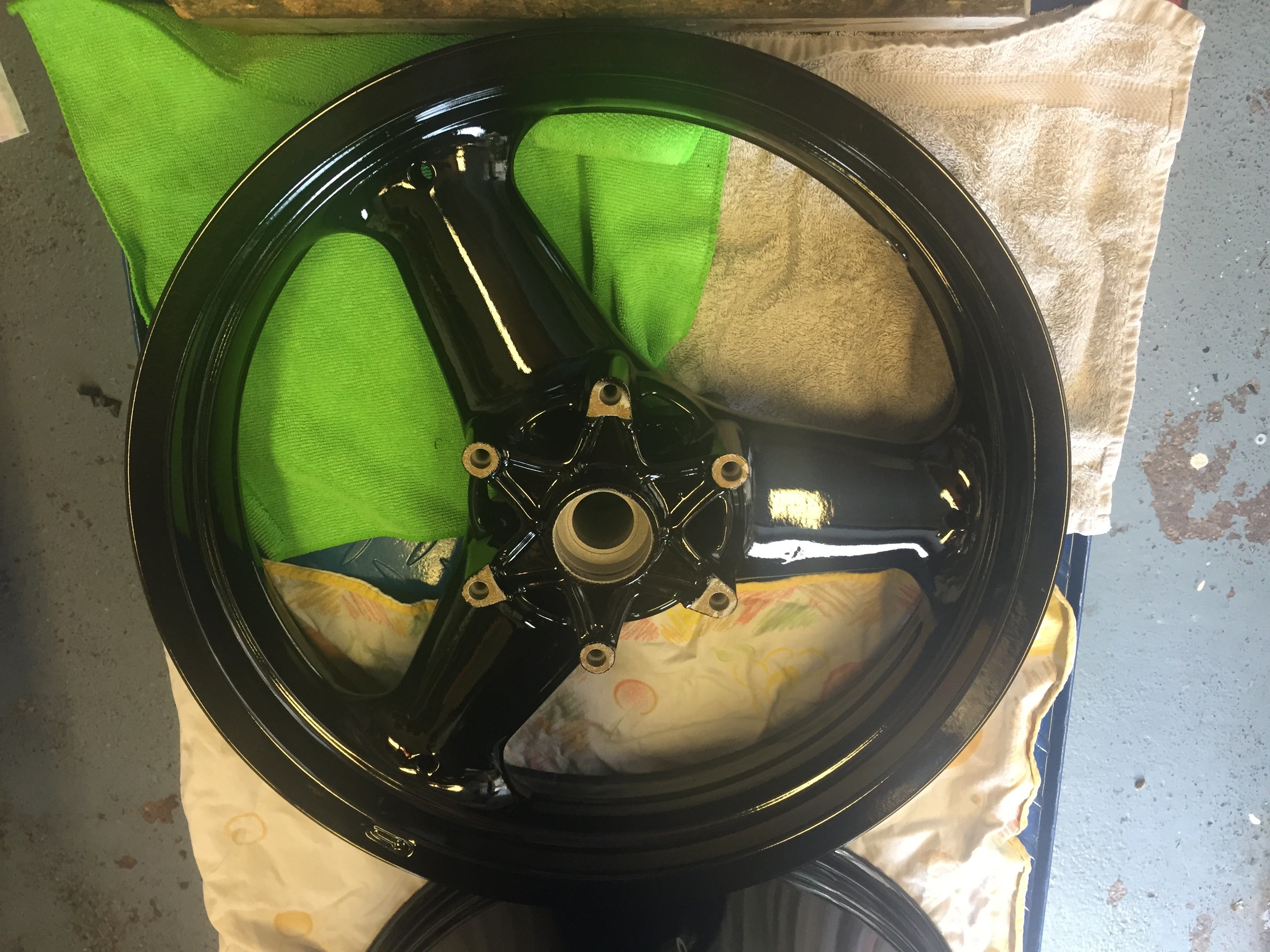

    Thanks Dave for your reply, should get it all back together again by Friday. I'm having the wheels powder coated gloss black as we speak, it's all a matter of taste but i thought the gold wheels looked a bit tooooooo blingey with the red. Also they needed doing as they had started to chip. Looks like they were painted with standard can spray.

    Hi, As you can see it's elliptical, 63mm high and 58mm wide
  12. Havit
    9,677
    Thanks Chris. Appreciate the info.

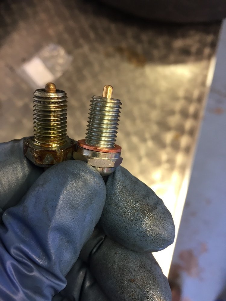

    Just been doing some cosmetic changes, at some point some red engine casing bolts were use to replace the original steel one's. I'm not a fan of these aluminium pins as they tend to break, sees, or chew up. I had to drill out both pins out of the forks, nasty things.
    Better me thinks

    Happy with the look to date, just waiting for the wheels to be painted
