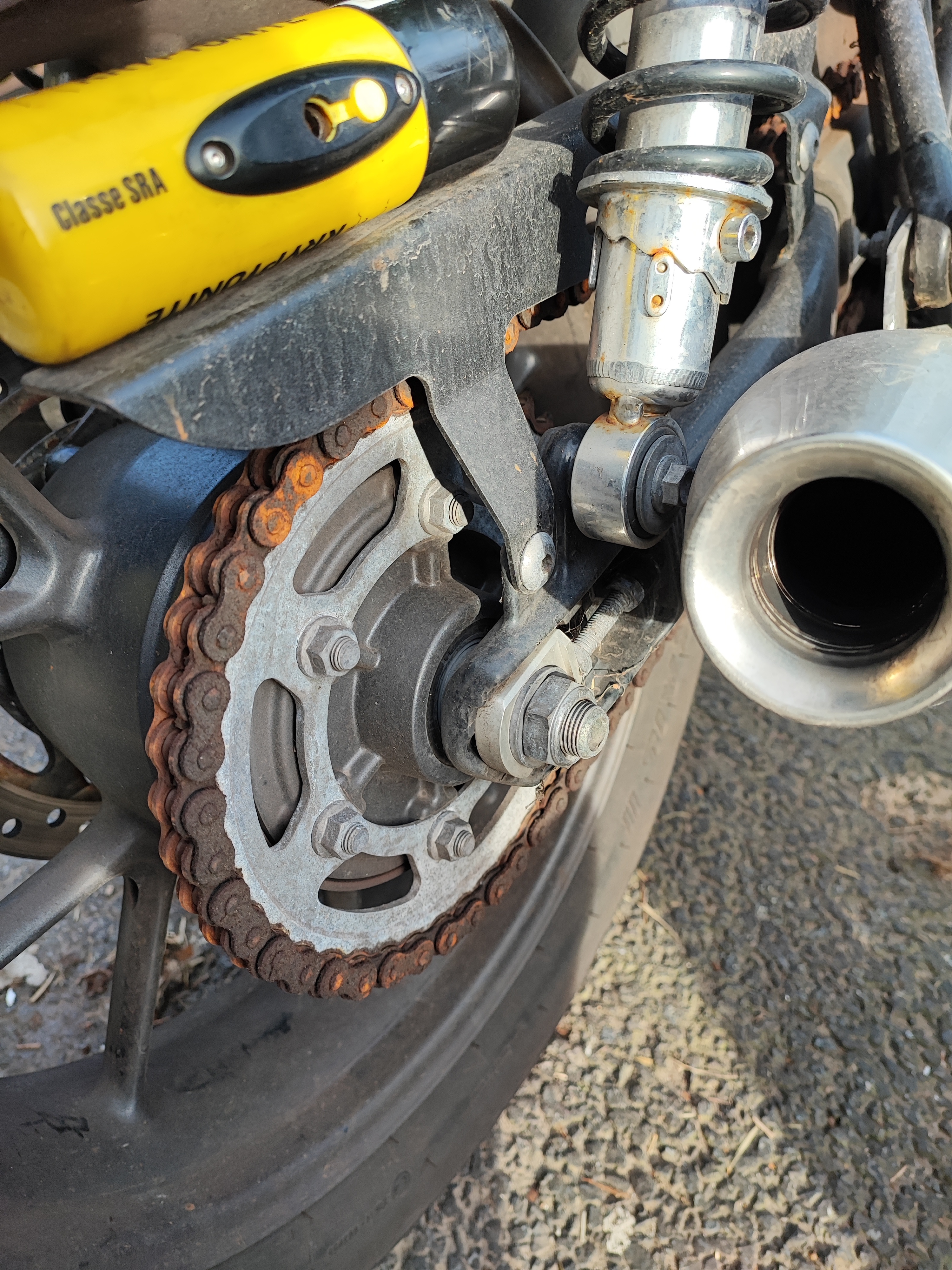

    My turn to ask a chain lubing question. I am parking my bike outside on the street. I hadn't used the bike for a month and of course this happened. See attached pic from yesterday.
    Rusty chain and rust gathering on some parts. Never lubed / greased / cleaned the chain. Could I please ask how do I fix it? Also, how do I clean the rest of the parts showing in the pic as gathering rust?

    IMO, that chain is beyond help. You could lube it up with gear oil but the O rings (it looks like an O ring chain) have probably suffered and removing the rust mechanically, with a wire brush for instance, will damage them further. Rust on the side plates merely looks bad, it's the rust on the rollers and pins that kills a chain. Give the bike a good clean and then use something like ACF 50 or XP90 sparingly to avoid further corrosion, just keep it away from the brakes and tyres.

    The poor bike looks like nobody loves it. The chain is in awful condition, can't believe anyone would let it get so dry that rust forms. I would say the chain is scrap, no matter how much you oil it there could be tight links or general damage that could be dangerous and/or costly.
    You can clean the rust from suspension etc with chrome cleaner or even wd40 and some good rubbing, then spray with something like ACF 50 to protect. all the metal parts from rust.
    I am also assuming the bike was not covered fully. Neglect will kill the bike.

    I would personally replace the chain because it looks too far gone in the photo. However, it could be superficial and be cleaned up and lubed without any issues. Have you considered taking it off for a thorough clean and bath?
    The other superficial rust marks on the shocks should hopefully come off with some Autosol metal polish.

    Bike needs a bloody good wash and then treating with ACF50 or similar, like Scotoiler FS365 or even WD40. Check YouTube if you're unfamiliar with them, there'll be a bloke somewhere testing products.
    Chrome cleaner or polish will sort out the shock - kitchen foil rubbed on the part and water is an excellent and cheap rust remover.
    Replace the chain, looks too far gone, then regularly clean, adjust and lube the new one. Bikes don't look after themselves :cool:

    The important lubricant on a chain is already locked in by the O or X rings so all the lube you put on a chain is mainly about cosmetics, preventing flash rusting and cleanliness. Regular WD40 cleaning followed by an anti fling treatment that could be gear oil or one of the proprietary chain lubes.
    I would bin the chain in the photo above. It should never have been allowed to get in that state in the first place.

    The rollers still need to be kept lubed or they'll seize on their bushings. The seals are only for keeping the factory lube between the bushings and the pins.

    Agreed. I did say important lubrication. The rollers are there entirely for chain/sprocket contact and play no part in the articulation between inner and outer links.

    Chain look's fine ! If that's only surface rust !! The important area's are inside the tube's between the plates! If those pin's rust then wear becomes rapid !! Give it a good lube , ride it for at least half an hour, longer is better... Relube after the ride ... Check for hard and fast kinks in the chain regularly from now on ! If just one link becomes really stiff .. then the chain is naff ! One buggered link means more are likely to follow soon.

    It looks like the inner plates have rusted down to the O rings which won't do them any good when they start moving. I've had 15 road bikes from new and looking back I never kept any of them long enough renew a chain with the exception of the current ZZR which reached it"s wear limit at just over 30k despite good maintenance and continual (auto chain luber) from new. Heavy bikes like that with big power and torque are hard on chains and they're flippin' expensive! The only things harder are dirt bikes, even a good O ring chain is knackered after 2-3K.
