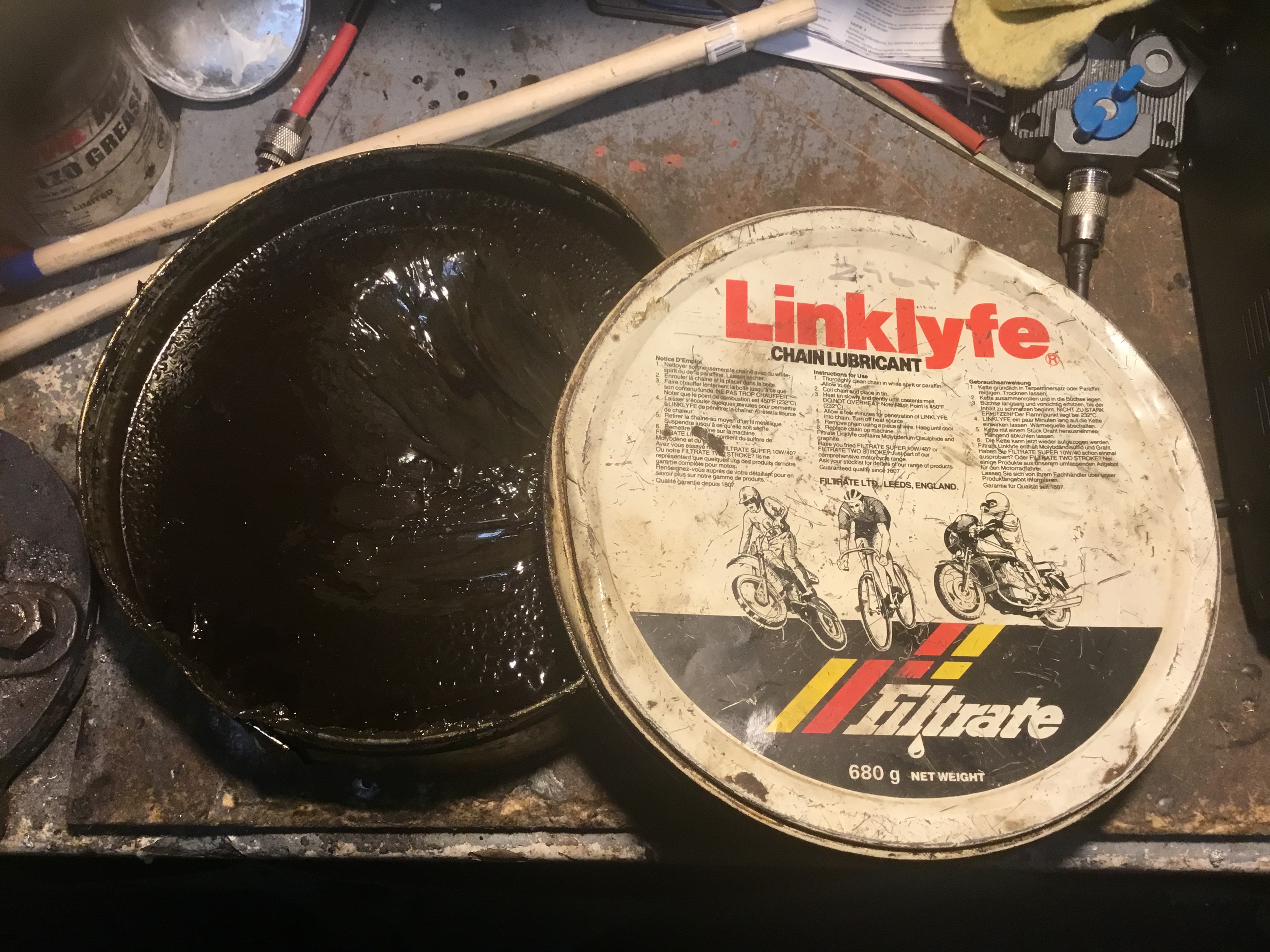

    Anyone remember LinkLyfe? Back in the day when non O ring chains were the norm, particularly on off road machines, I used to remove the chain, wash it in a petrol/diesel bath and when dry, immerse it in LinkLyfe heated on a camping stove in the garage. Probably the best chain lube ever made but the heat required is obviously no good for O rings. I still have a tin in the garage somewhere, must be nearly 40 years old.
    The first time I used it I heated it on the hob in the kitchen but the stink quickly got me relegated to the garage.:joy:
    Edit.........found it. Notice the price on the lid, £2.76 + VAT! :eek::joy:

    Yep. I used to hang it on Mum’s washing line to drip off when I lifted it out of the tin. Brilliant stuff.

    Ah the good old days when I used to boil the chain in grease on top of the stove and bake my freshly painted cylinders in the oven. Great way to learn cooking skills.
