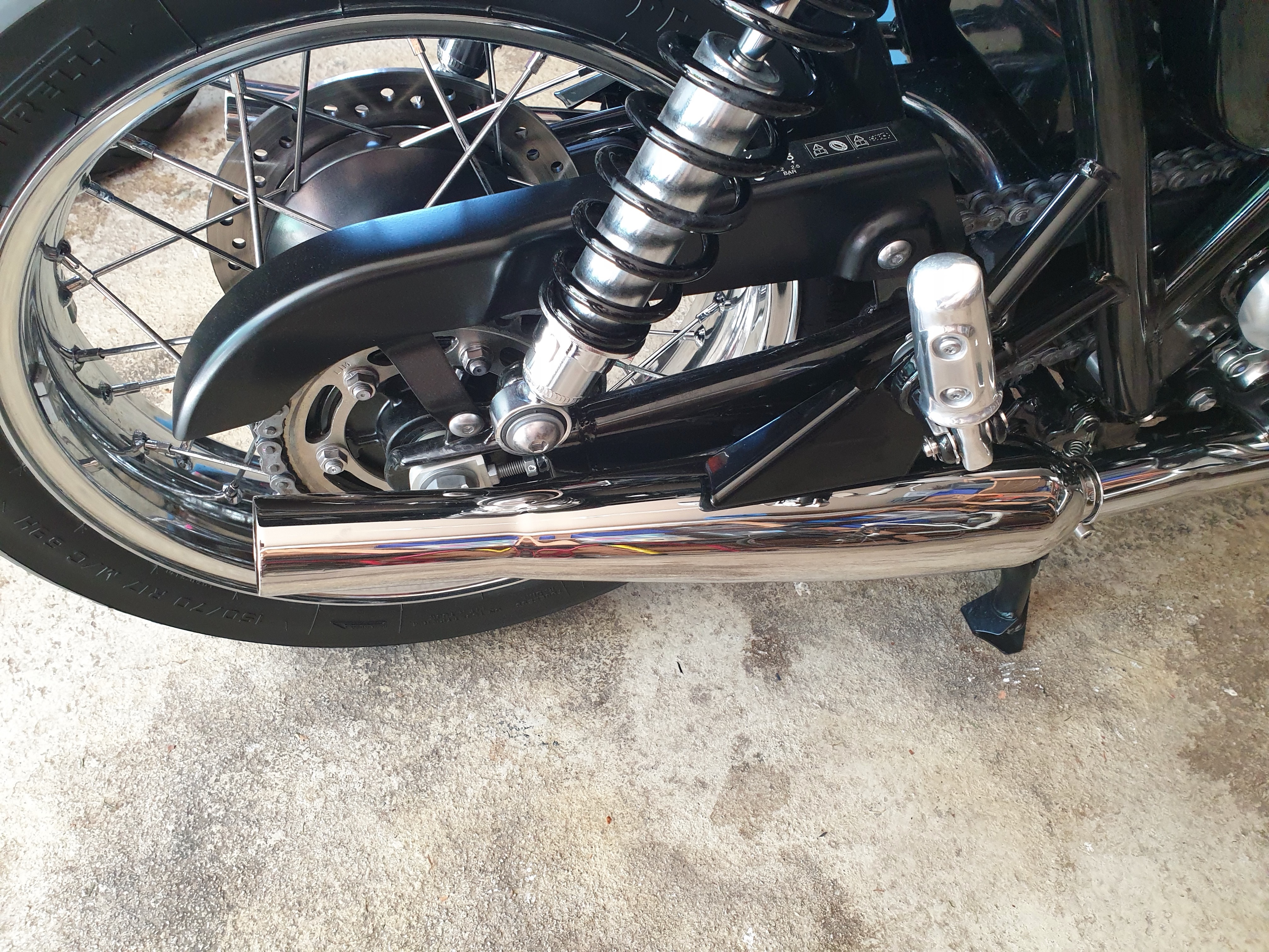

    Further to my previous posts I bit the bullet on the 2020 Bonneville and purchased the British Customs Sleeper Pros and the Weslake X Pipe DeCat. Spent the rest of the day following the instructions, loosening all the relevant nuts and bolts and removing the catalytic converter and pea shooter exhausts. It took a few hours of fiddling, bending and checking stuff but I didnt have any real problems.
    Started the bike up and let it run until the fan kicked in. Definitely noisier but a much richer, sweeter sound. I havent really been able to confirm performance etc as I have only done 600km on the bike so still running in. To be honest I dont know if there is a huge amount of difference. Time will tell when I can get out and run it properly. Bit of popping and noise on the overrun but nothing bad. I dont think the sound is too loud considering.
    However and I will throw this out to the community. I have a couple of concerns.
    1. It isn´t possible on the x-pipe to fit the heat shield. Don´t think this is a problem though.
    2. Secondly and potentially a bigger problem is the exhausts. They are very close to the swing arm, especially on the left hand side where the exhaust is touching the swing arm. Sitting on the bike obviously depresses the suspension a bit then the exhausts have more space. But, getting off the bike then the left hand exhaust is touching the swing arm. I have tried taking the whole damn thing apart again, checking the installation but it all looks ok. I can use a little bit force and bend the exhaust out slightly but it eventually moves back again. I can only think that the problem may be with the x-pipe and that it is forcing that side of the exhaust system to bend slightly.
    The next step is to put the original catalytic converter back on and see if this is still a problem. I mean the exhausts are made for T120 2017 onwards and I do not think there has been any major changes made to frame,exhausts etc that would cause this problem.
    Have posted some photos and would welcome any input here.
