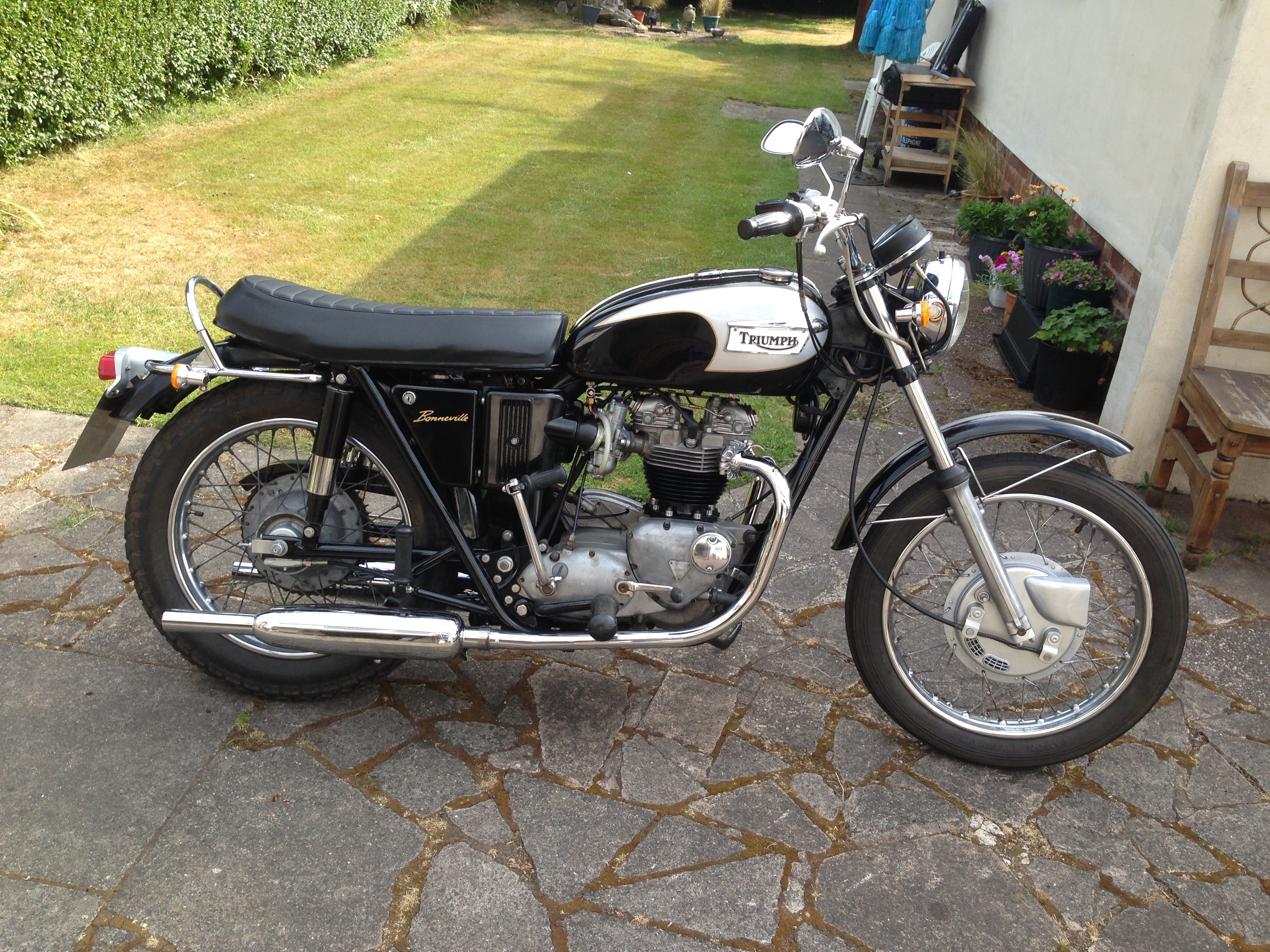

    Looks great Danny, I hope mine comes out that good. Got the lower end buttoned up and waiting for the jugs to get .20 rebore. Rebuilt the master cylinders today and assembled the front brakes...moving along. I like your tank; did it come like that or did you have to re-do?

    Hi Dennis no the bike was rough and if you do a search on the bike they were all gold and black and the paint layout were all the same, so I own a 2011 Triumph America the one in my logo or whatever it’s called and like the paint job much more than the Bonny original.
    So I gave the tank my own paint job everyone who has seen it likes it so job done well so far.

    The mudguard is on back to front and the bracket on the fork is upside down :)

    Not sure about the bracket. But shouldn't the stays be on the top of the guard rather than below. Were on my BSA Firebird. Also if you look at the first picture it shows the bike with the traditional mudguard as fitted to Triumph.

    The back to front is right just checked on line photos I was in a rush to get away Thanks
  12. darkman
    7,633
    Pre 71 was on top Joe :)

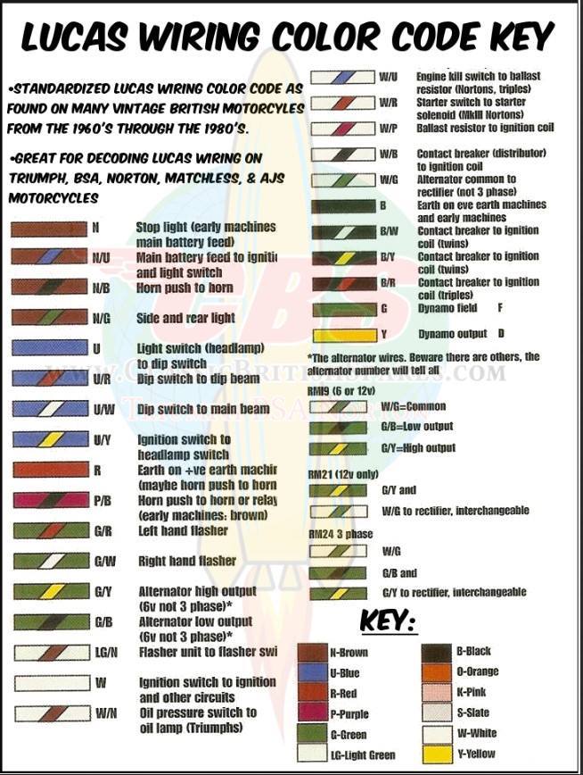

    help! rebuild coming along and thinking about electricity. Came across this negative or positive ground thing. I believe this bike (1976 T 140) was originally Positive ground. I am totally rewiring it. I'm from America and grew up on red-pos, black-neg. Can I get a new harness for this model that is neg ground; or am I required to go positive or reverse red ground wires, witch will hurt my small brain. I also will be installing electric ignition (Pazon) and a Tympanium regulator/rectifier. Is there a easy way out ? Dennis
  16. darkman
    7,633
    Yes there is an easy way out, just leave it as is :) one colour is positive and the other neg, does it matter if it's red or black.
  17. Dennis Schermerhorn
    Dennis Schermerhorn Well-Known Member
    Nov 26, 2018
    83
    Connecticut
    Ok, your right, I guess I was over thinking it. So if red is - what color is +...
  18. darkman
    7,633
    Brown with blue trace, this pic will help :) wiring code.jpg
