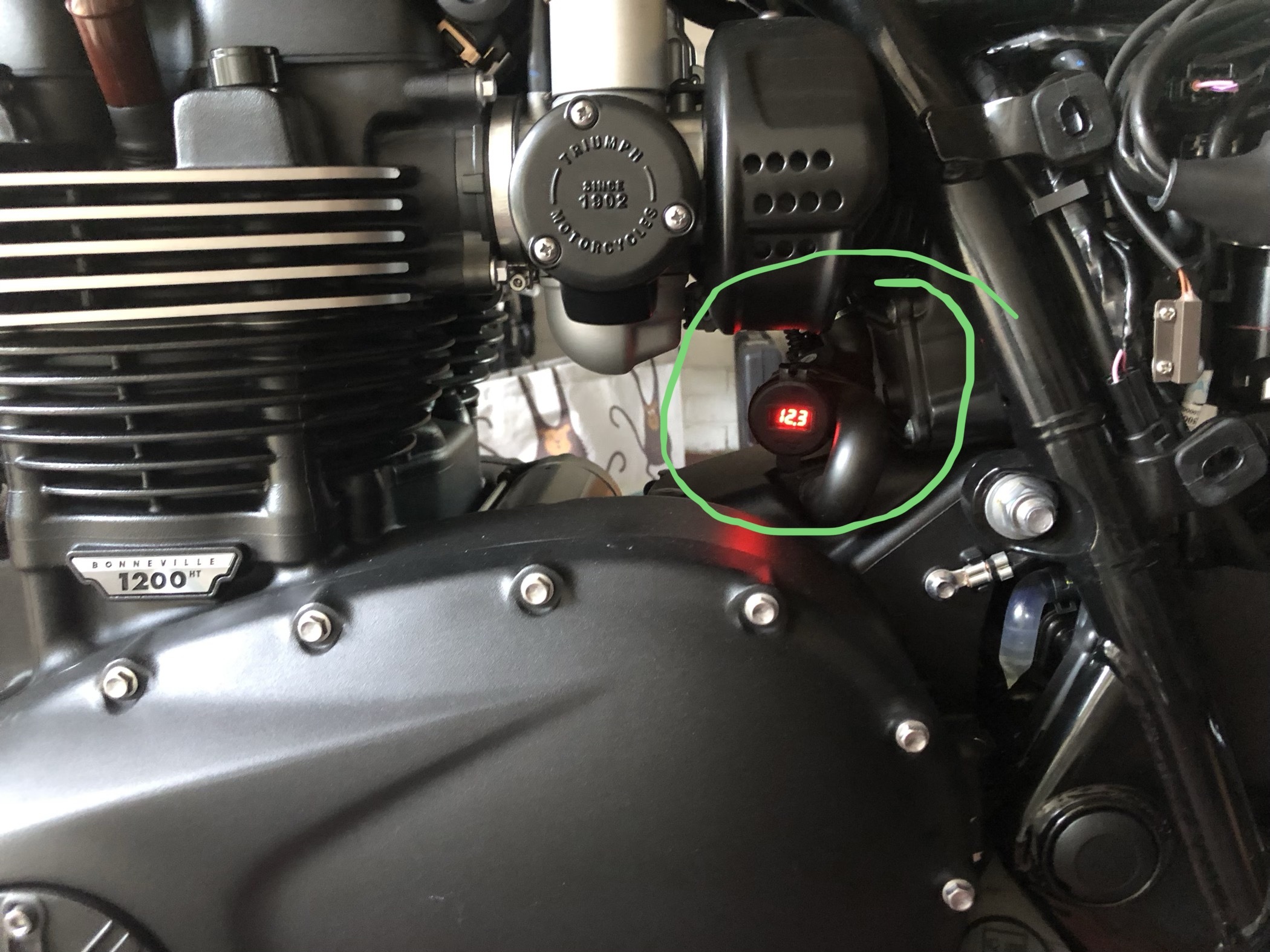

  6. Bonnie1980
    Bonnie1980 Bonneville T120 Black
    Aug 6, 2019
    92
    South East England
    I wanted to add a socket for the same purposes as yours but did not go the Triumph auxillary socket route as it was always live. I used an auxillary live connection from the Motone indicator harness which I had to add LED indicators, connected it to the USB socket off Amazon (see pic below), fixed it next to the air filter and ran the charger cable from under the tank all the way up to the handlebar. It is hardly visible to naked eye and best of all, comes on only when the bike is alive.
    The USB socket has 2 slots, I use one for satnav and the other one to charge the helmet cam on longish journeys. Works fine.

    Liking you work. Are you able to give me any further in formation about the sub loom you used etc?
  9. Bonnie1980
    Aug 6, 2019
    92
    South East England
    This is the harness I used.
    https://www.motone.co.uk/motorcycle...play-wiring-harness-adapter-lc-triumphs-p2013
    I already had it to connect LED indicators at the rear and all I did was connect the USB socket to the auxiliary line on the harness, and fix the socket. See pics below. Ask if you want more information.
