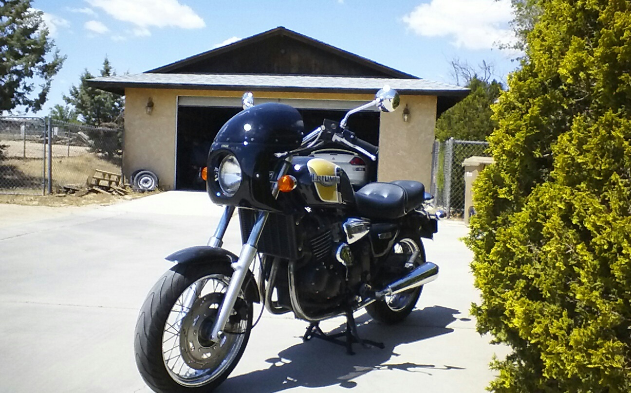

    Emgo fairing on 2000 Legend TT.jpg REEVO: Good to hear you are up and running. I need to sort through both my T-3's this winter. I have had them both in storage this year. I plan to try something different with "Cedric", my old 900 Legend. It has Keihin's on it. Instead of spacing up the stock needles with washers, I am going to try needles from an air cooled Thruxton. I think the carburetors are about the same [just 3, instead of 2]. It is now waiting for me to find the time to put the new starter in it, and bring it back on line. It is a great old ride that I rescued from neglect a few years back. I missed it this year, but I just had "too much on my plate" to get to it. ...J.D.
  14. Reevo
    Reevo Active Member
    Sep 14, 2019
    132
    Birmingham
    Nice looking bike
    Mine was stored for 11 years hence my issues
    Before I brought my tiger I wanted a thunderbird sport
    I love the old worldly look of them
    May get one eventually
    Keep me up to date on your carb experiment
