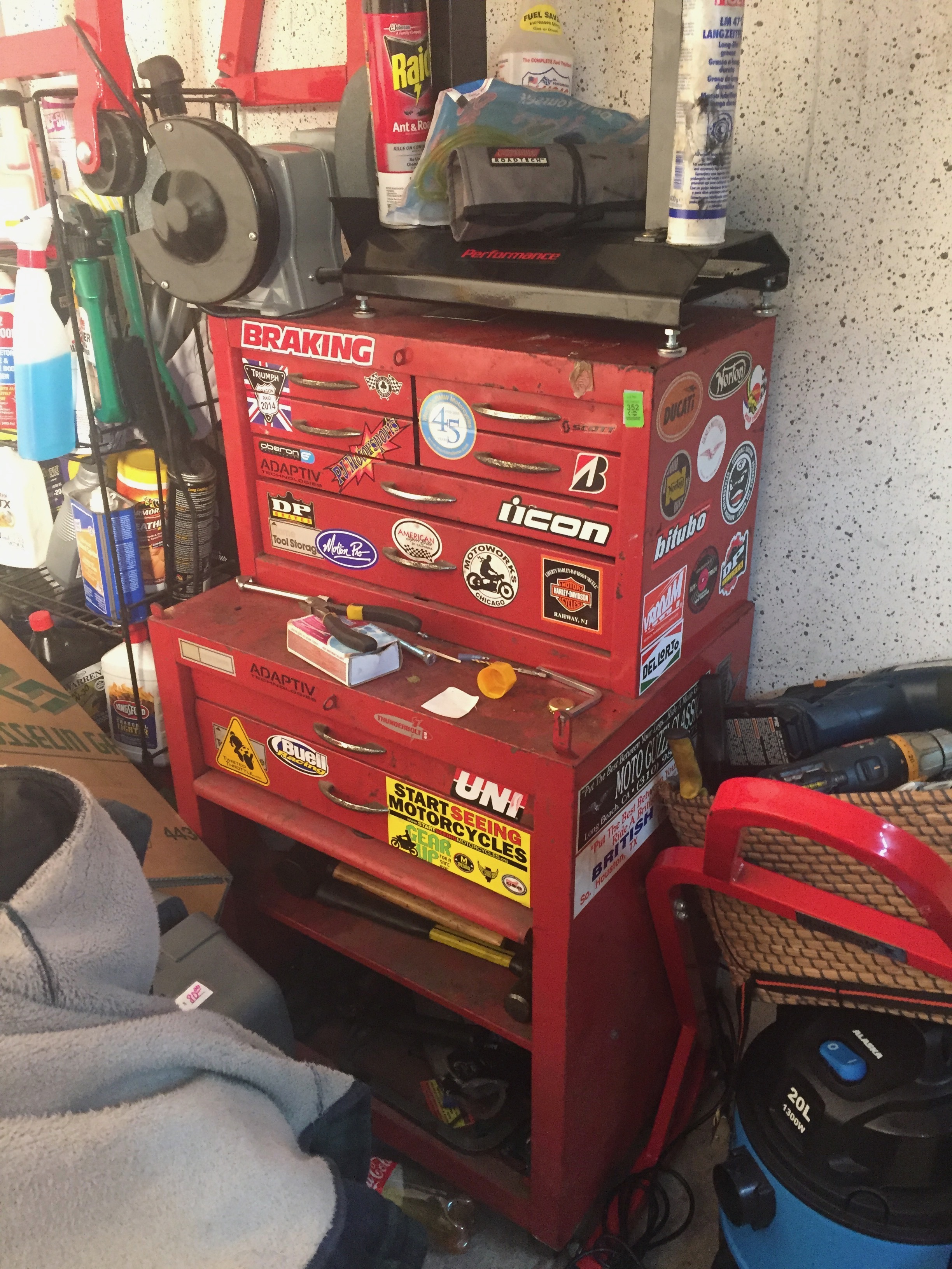

    Like I said...everyday I need to do something. I spoke with CRK and my parts are about 3 weeks out so I need to finish clean up and complete rolling chassis in anticipation of assembly.
    today I cleaned up the shop again and cut down my motor mounts to ditch the centre stand lugs. I also took some stock and added to my parts order.

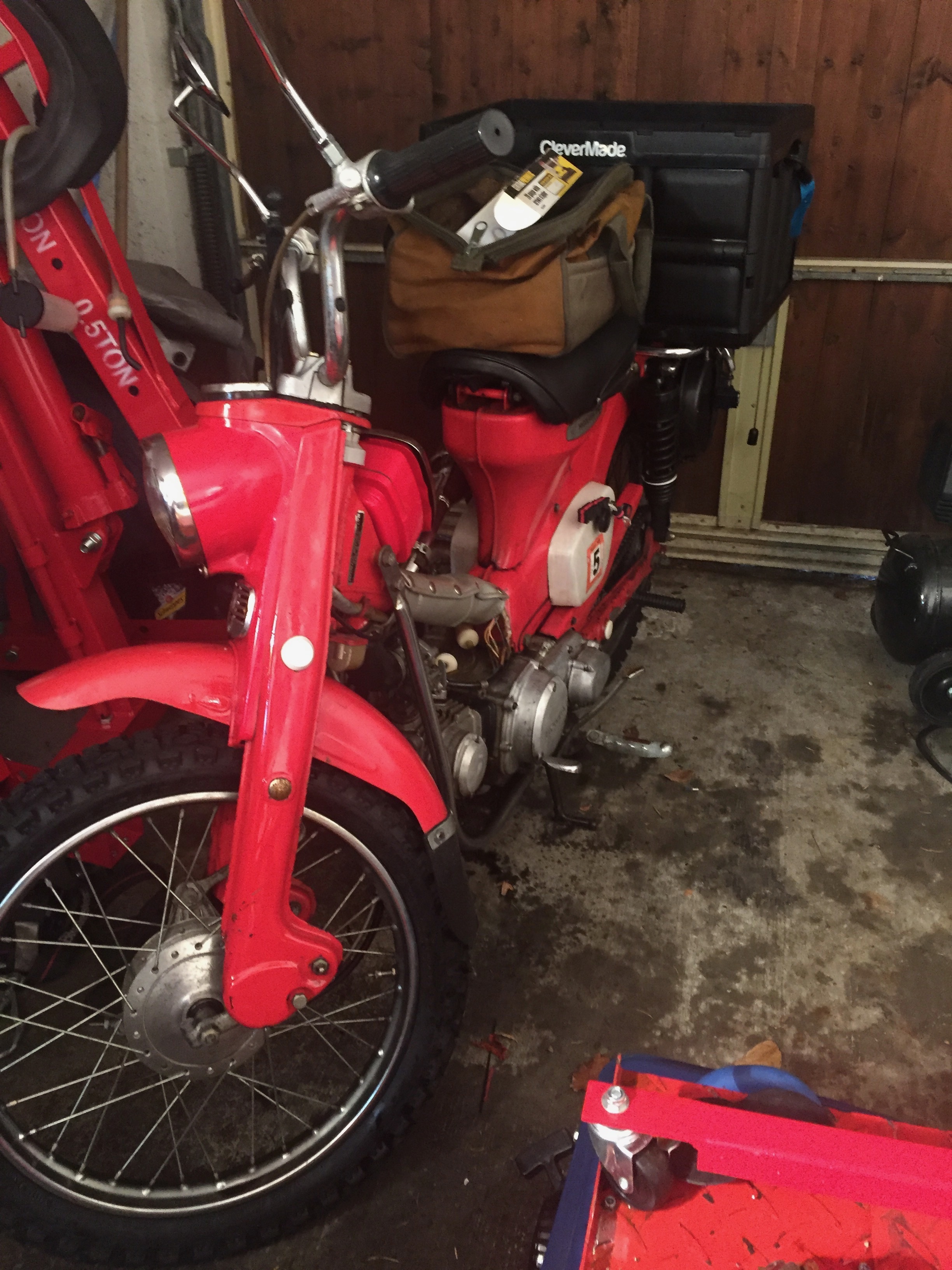

    I also rode my Honda CT90

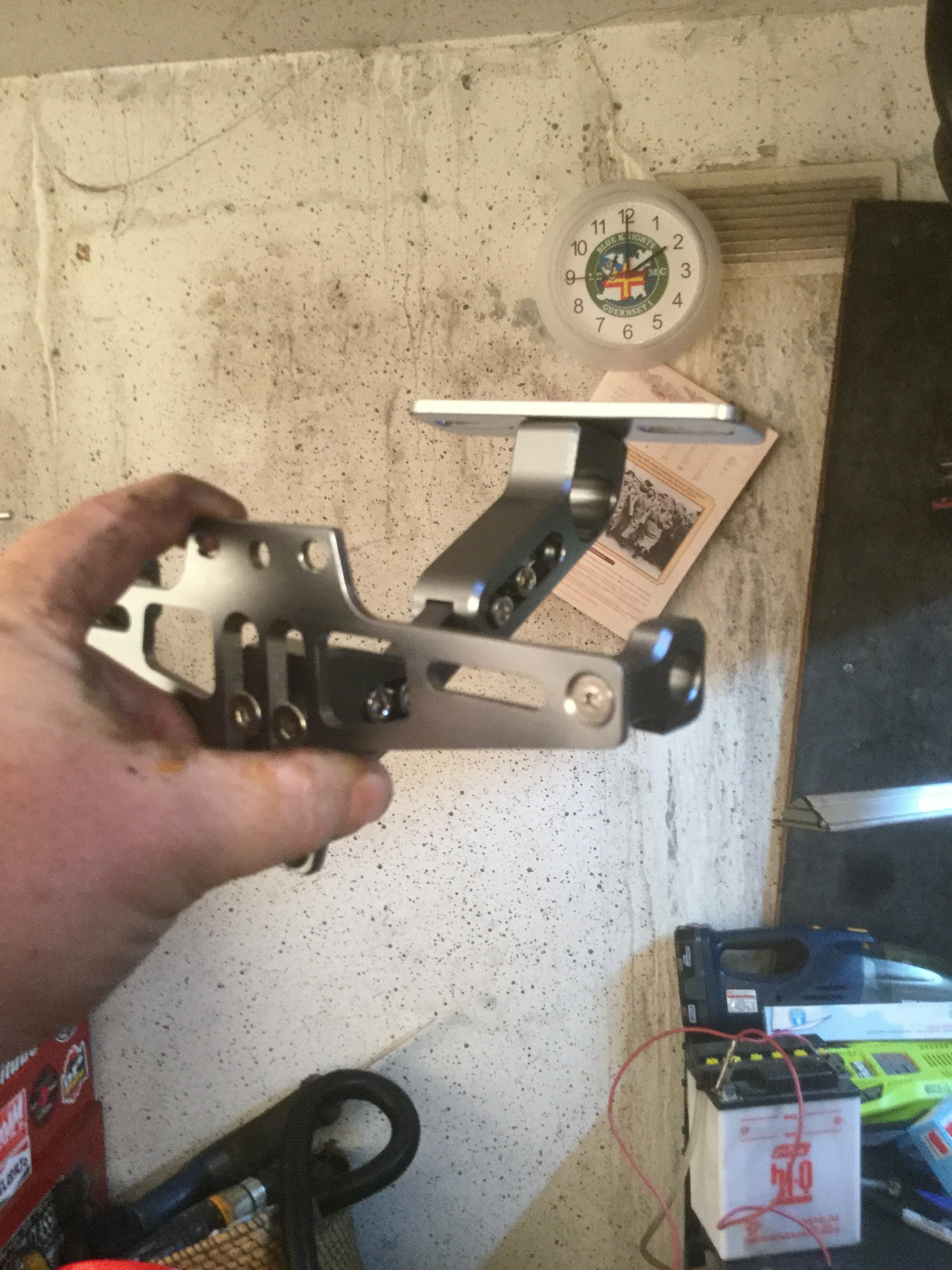

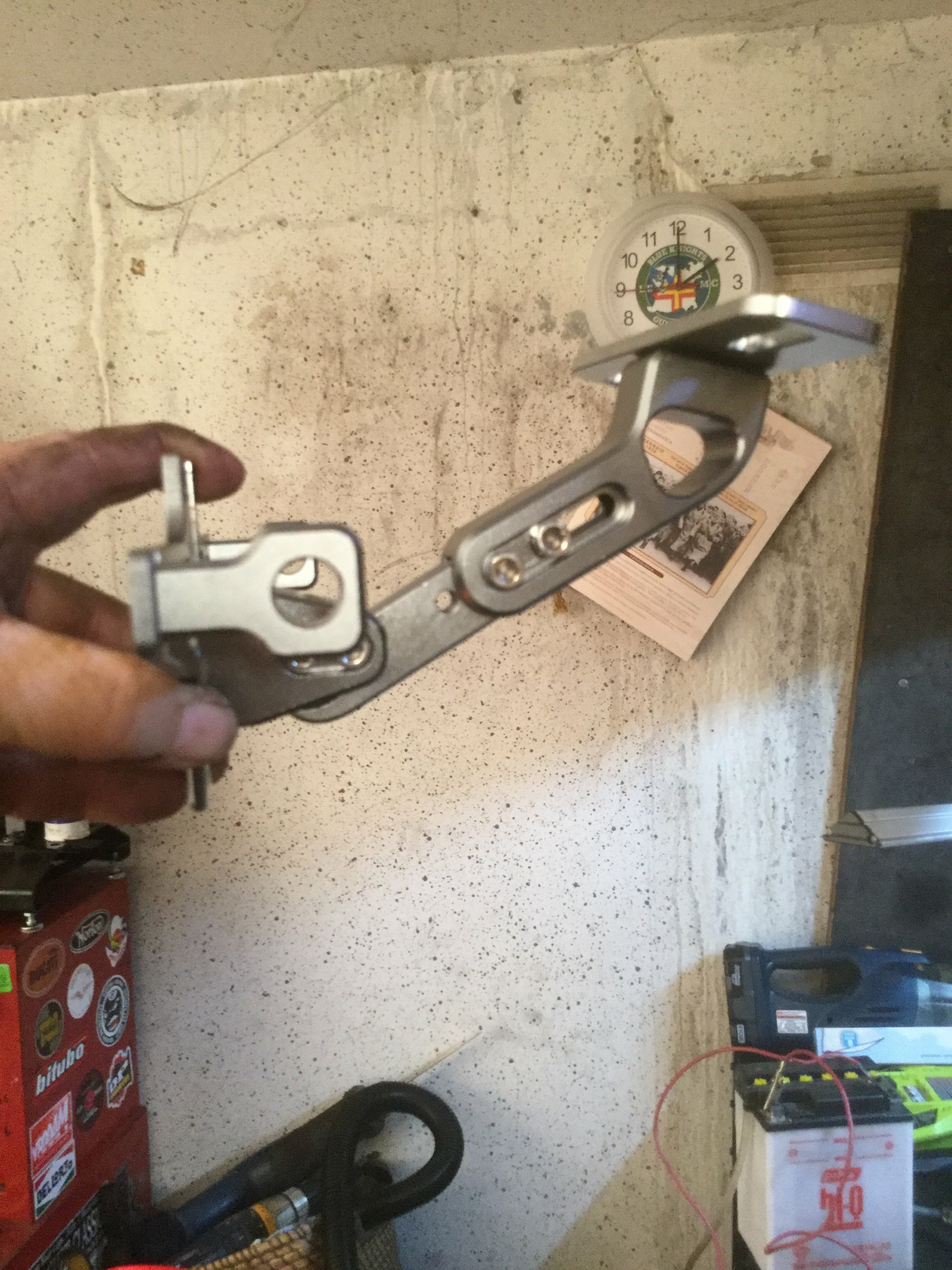

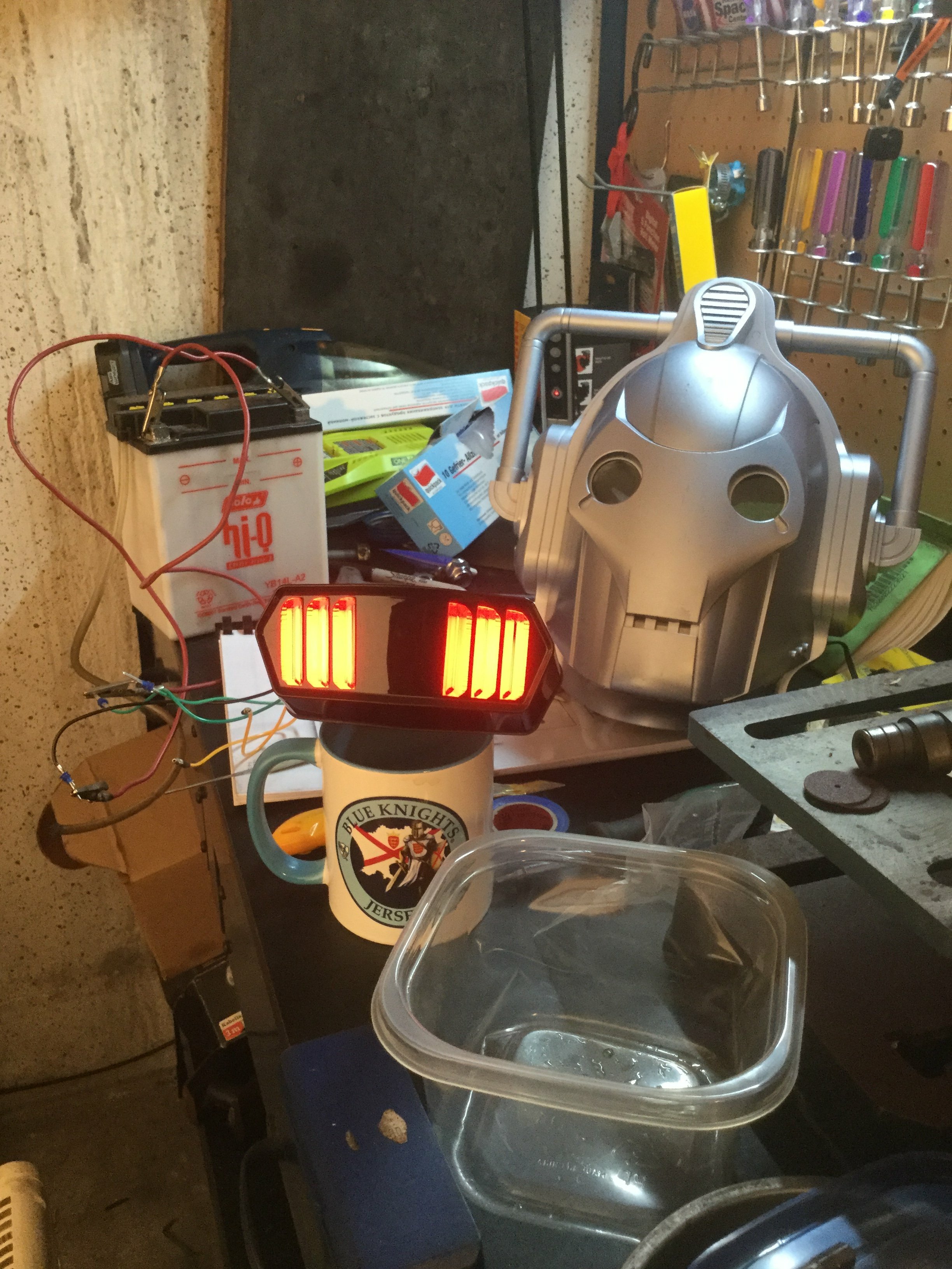

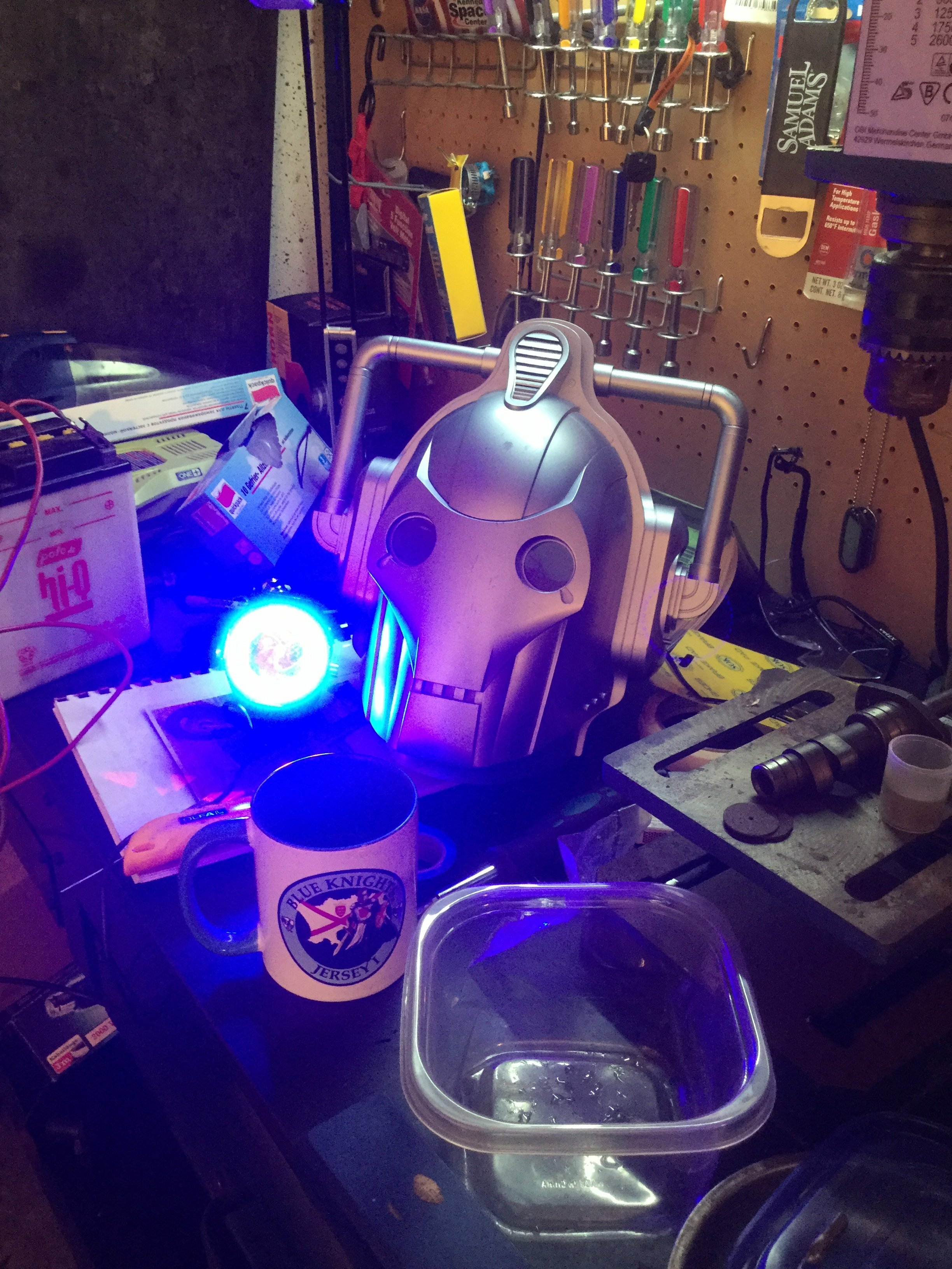

    Its hard to do something everyday, but I have managed to do something no matter how small. Today I unboxed a bunch of cool stuff (see pics) and I cleaned and polished the fork legs in anticipation of replacing seals tomorrow. I am also working on my lighting helmet idea, worst case scenario I use the CRK 7" unit. Oh yes...check out this tail light and tail light bracket I found on Amazon (china) for only $20

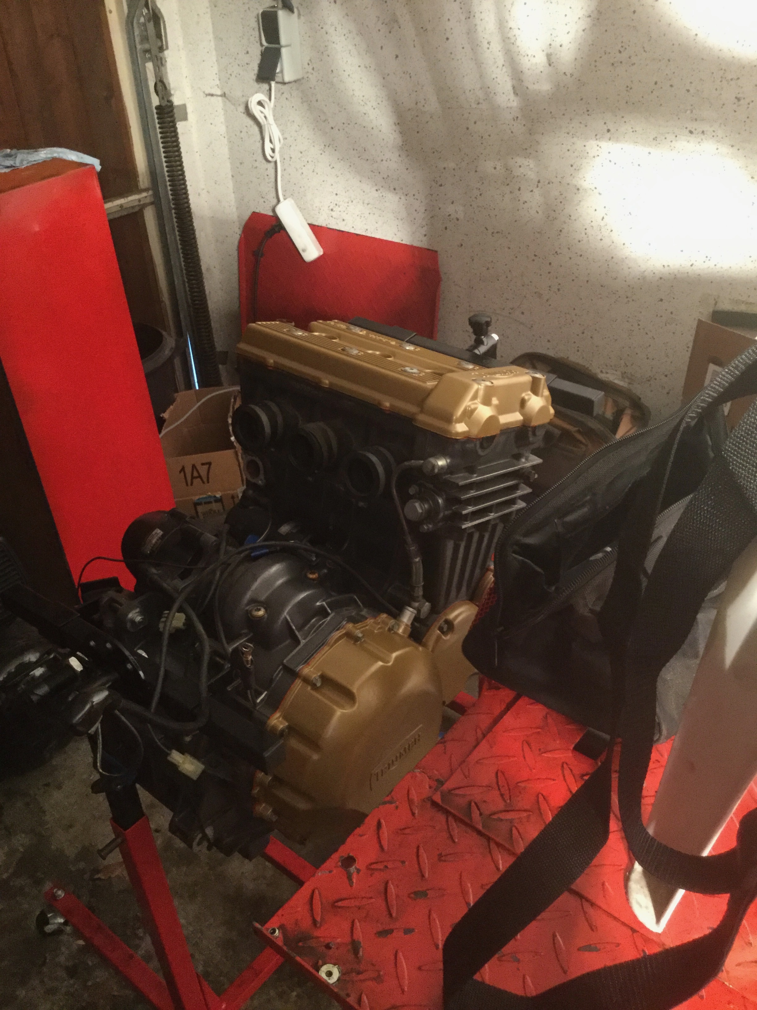

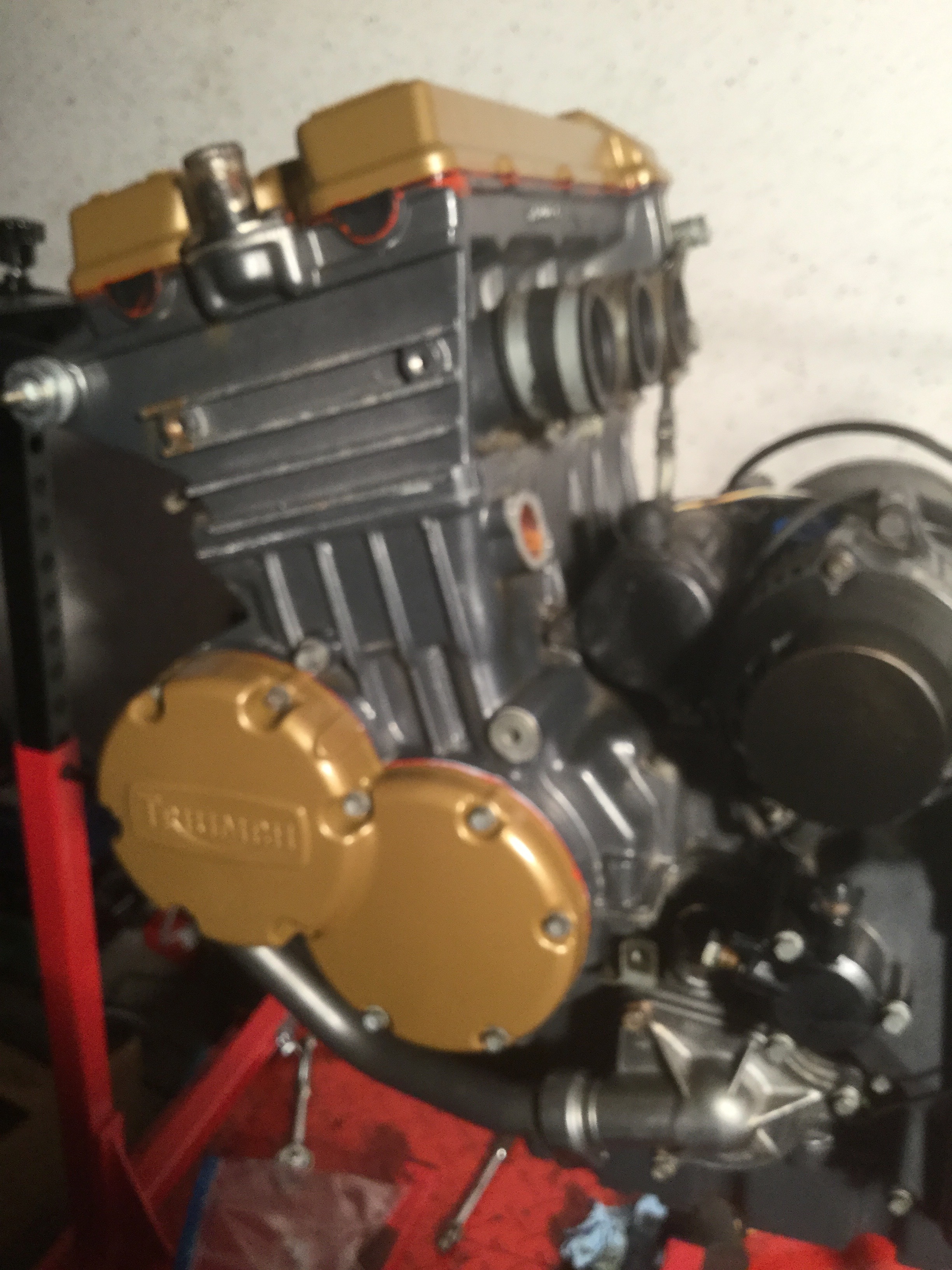

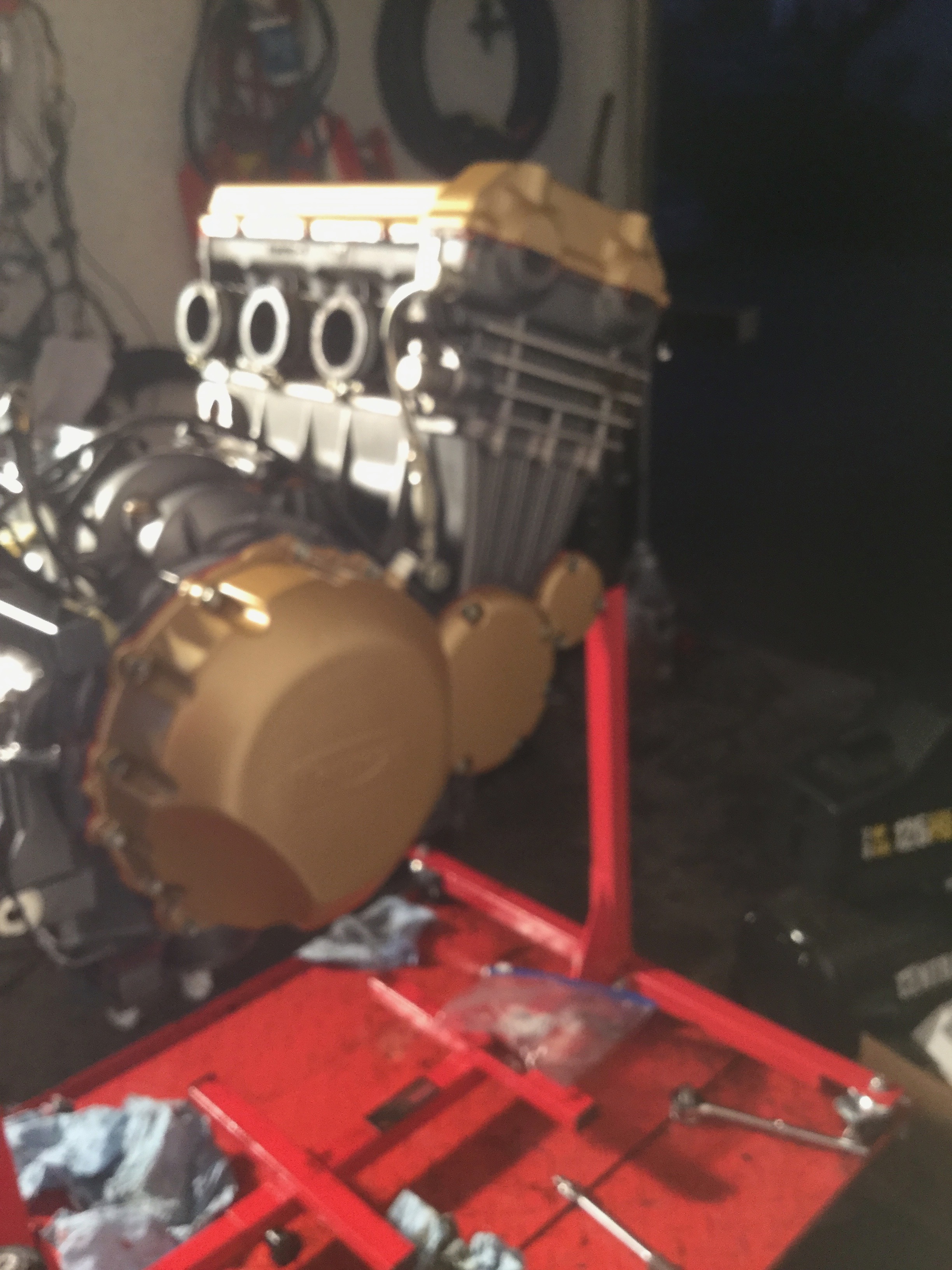

    enough about me. Im doing better now so I picked up my gold pieces from the powdercoater, they look better in daylight, not sure about a dark garage. Yes that is red silicone squeezed out from the mating surfaces, I assure you it is not very much and I will remove with a razor tomorrow after it cures so no nasty red rubber lumps on my bike.

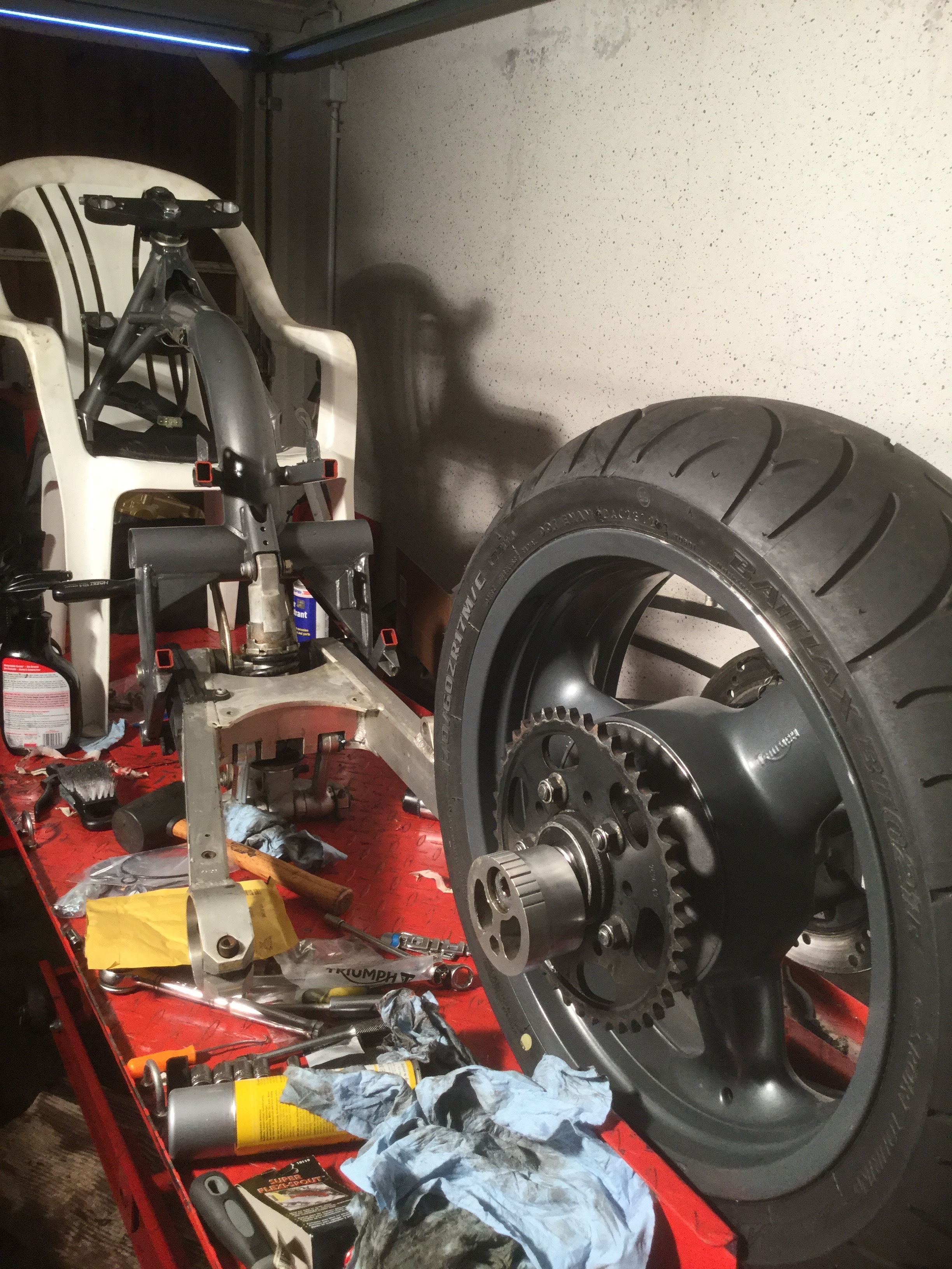

    it looks worse than it is. Attached swing arm and cleaned wheel in anticipation of engine install...Im not sure about that gold, time will tell, mistakes may have been made.

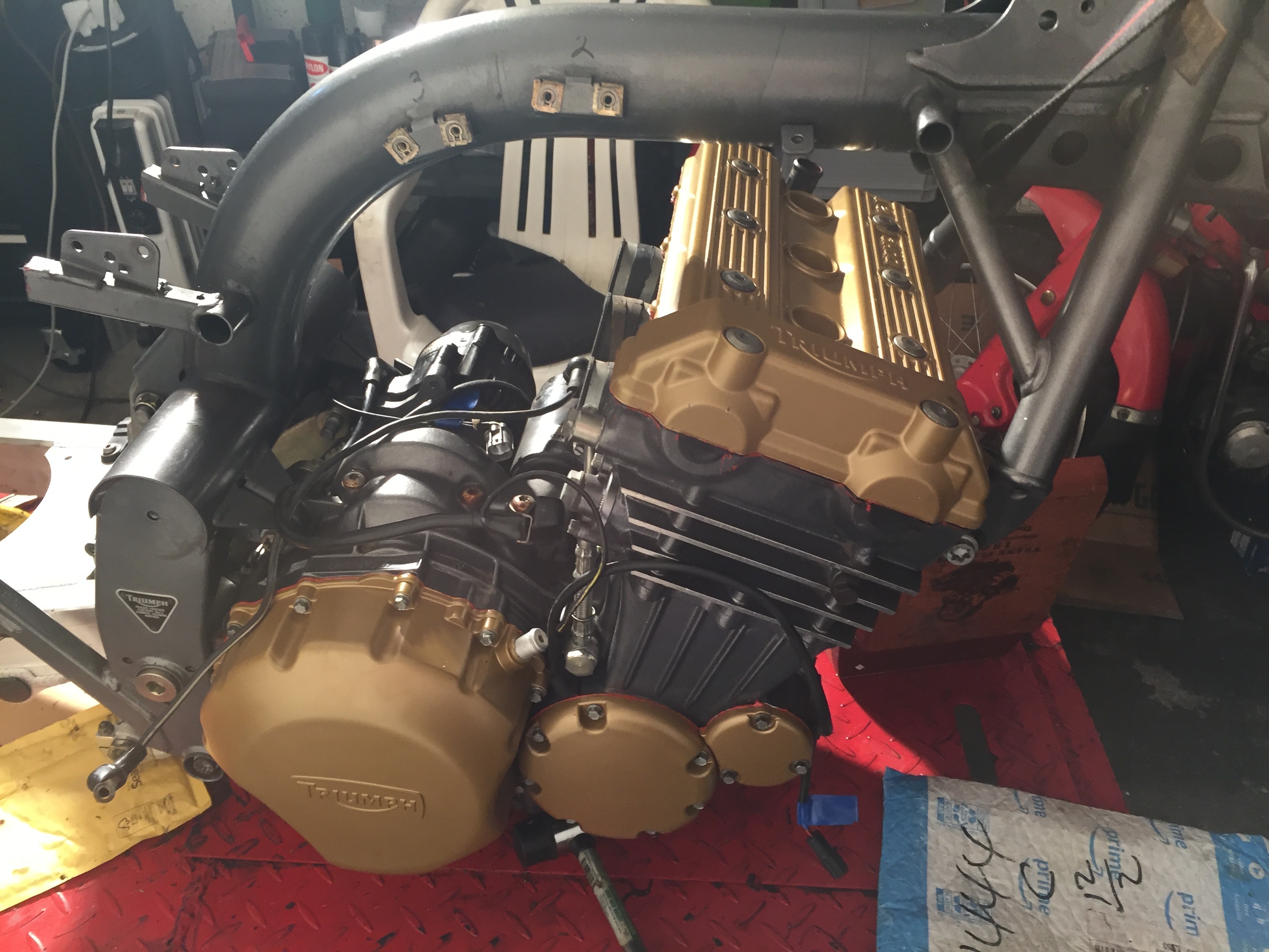

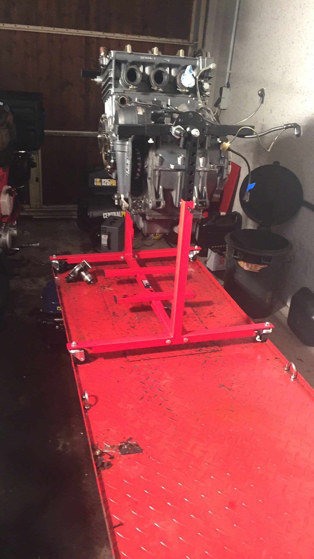

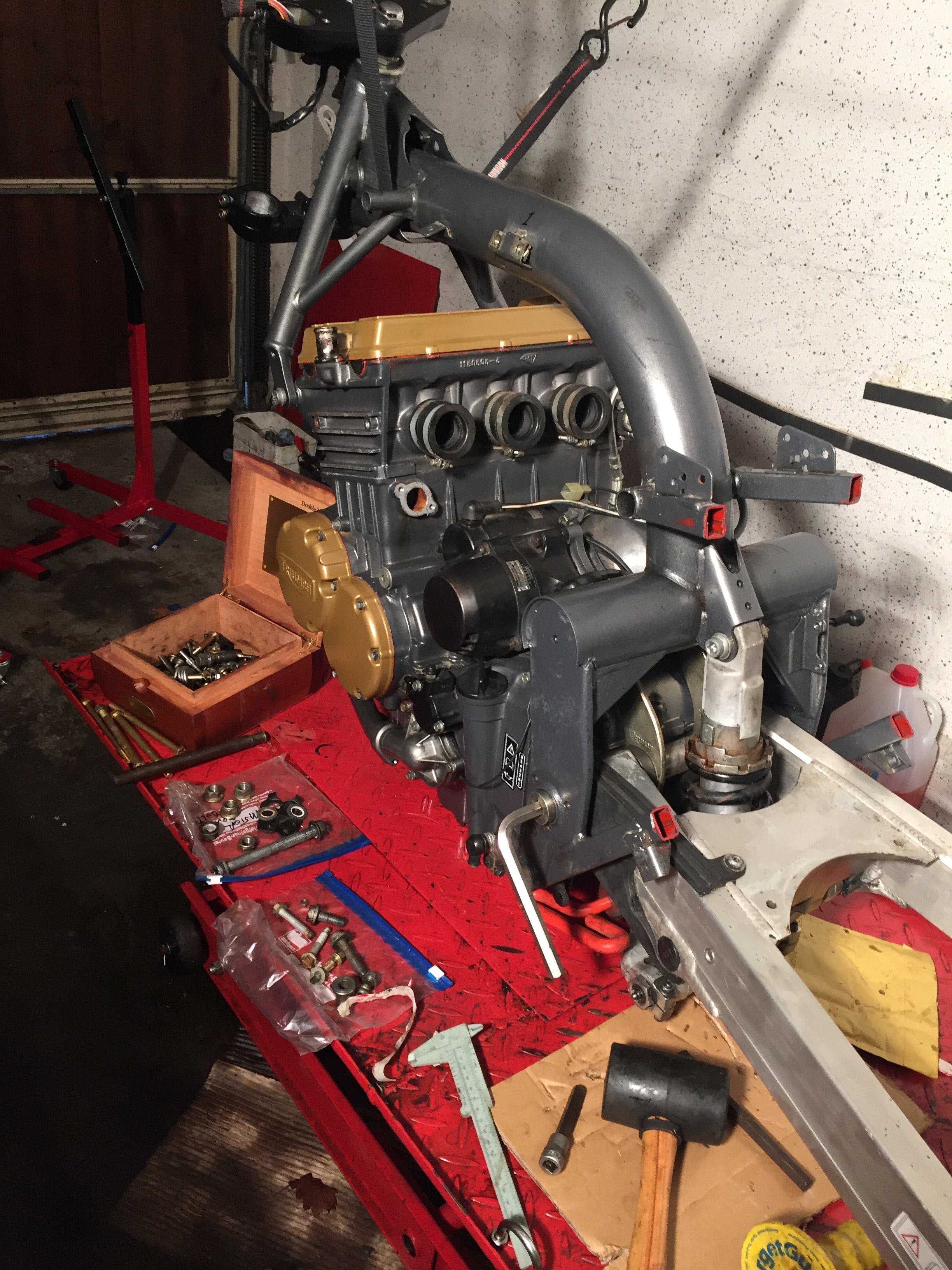

    Today I managed to get my engine back in the frame. Not an easy job by yourself. My package of parts is due tomorrow so I should begin initial assembly of the KIT and start to hit snags by monday.
