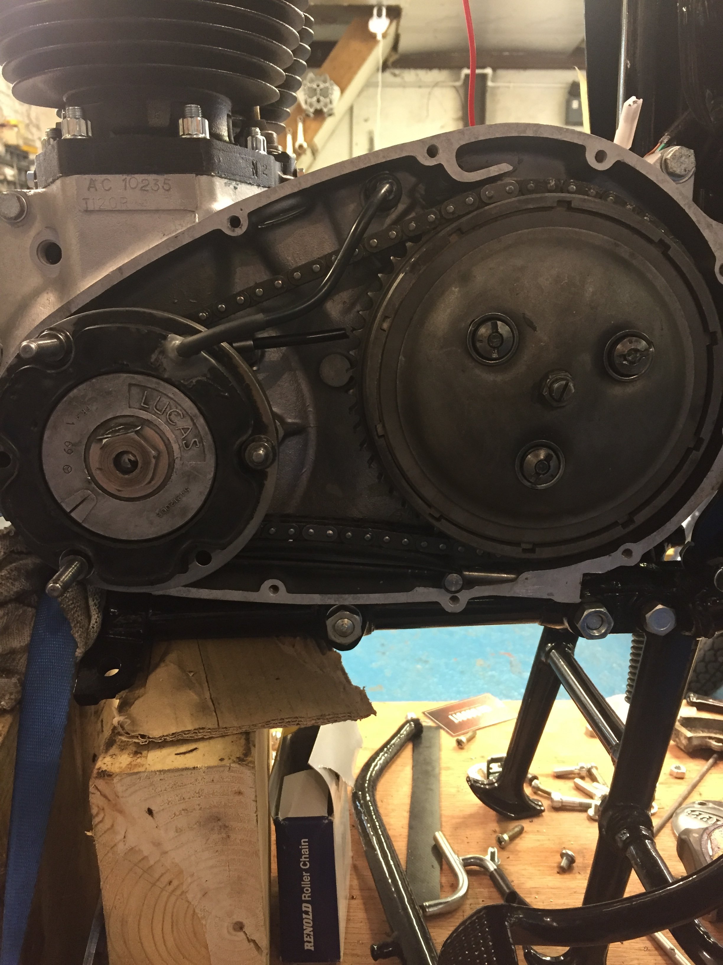

    A few hours on the bike today , I did manage to get the clutch back together and fitted the stator , only a small repair in the end but seems good to go .

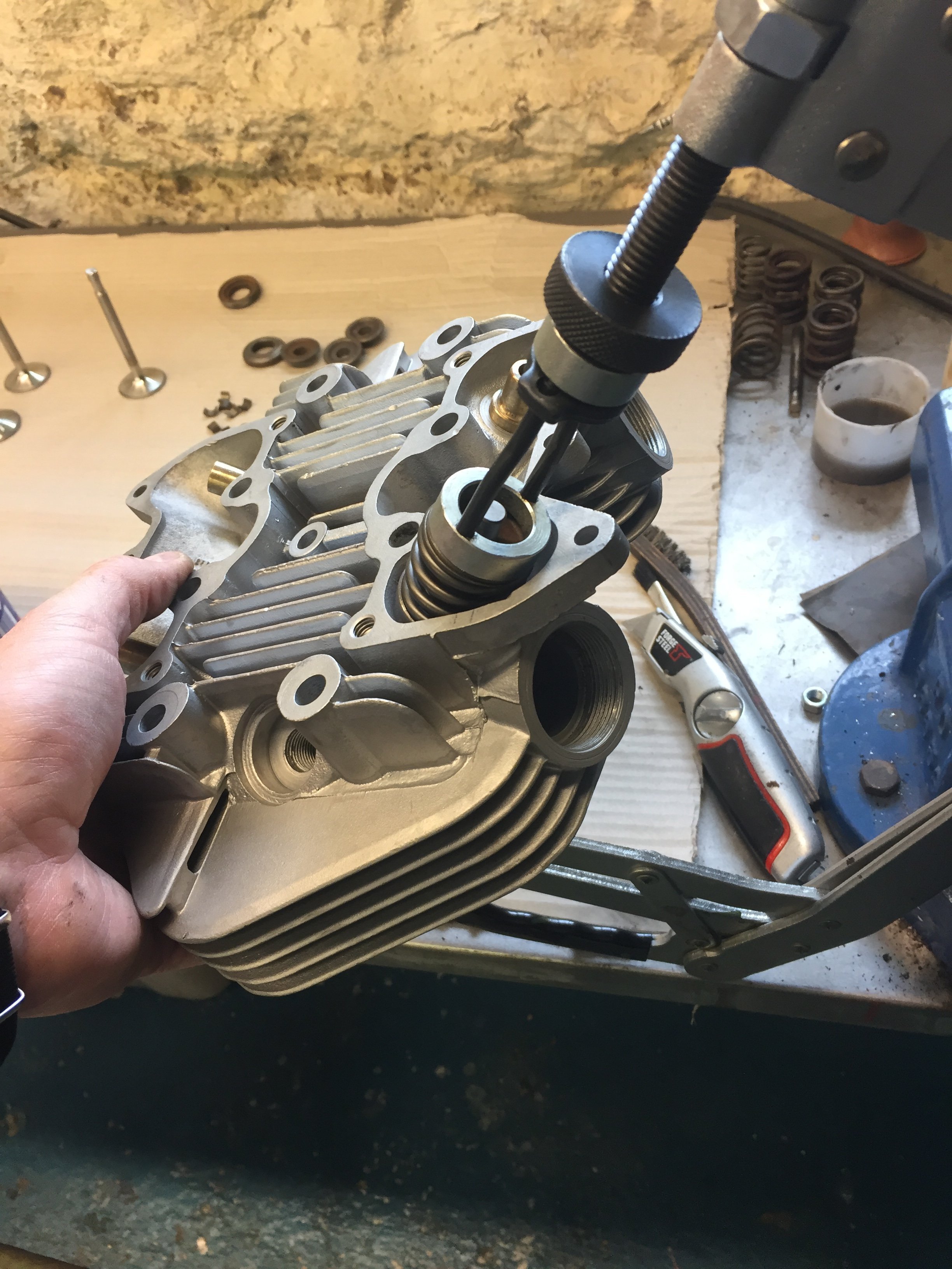

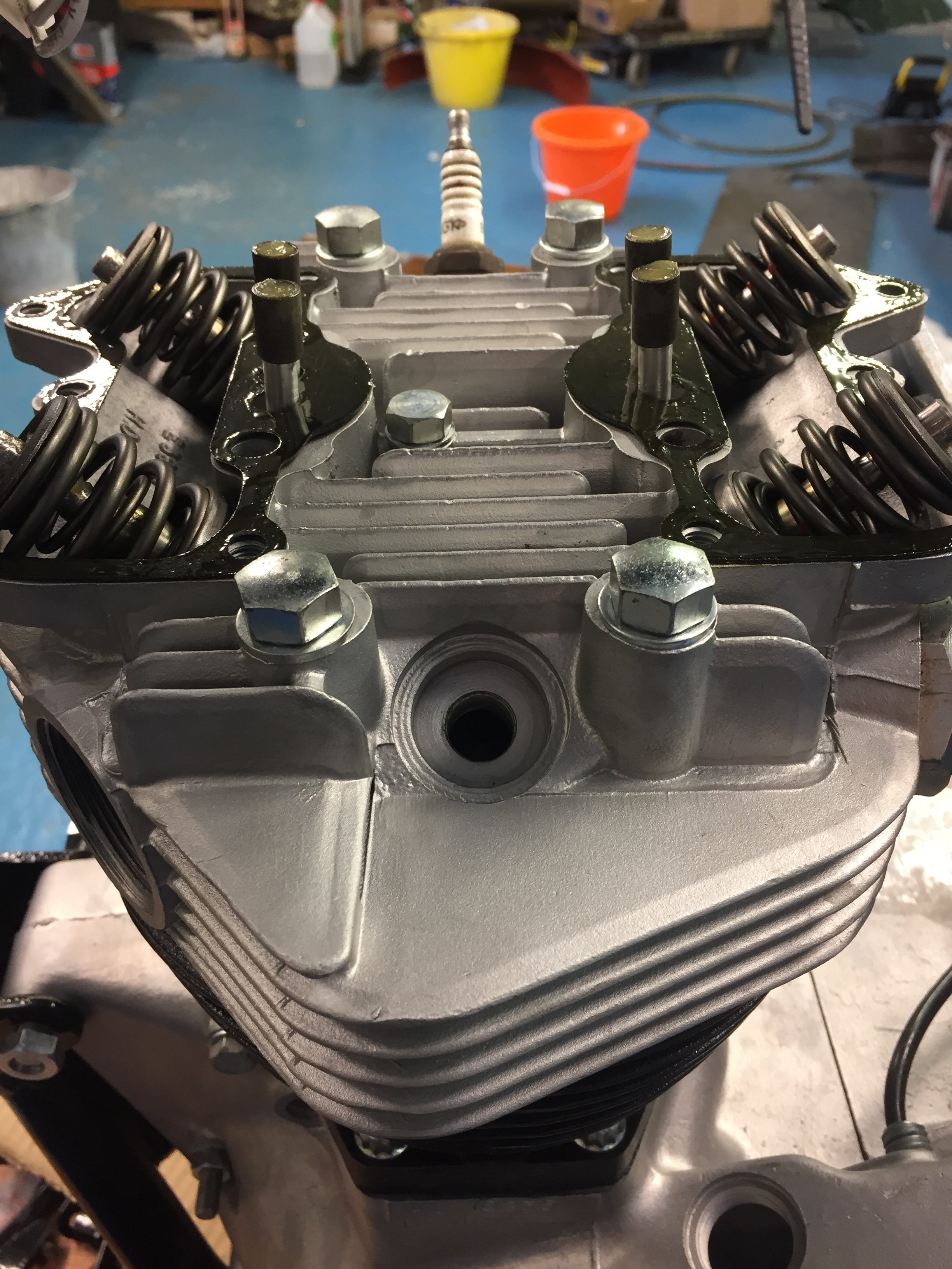

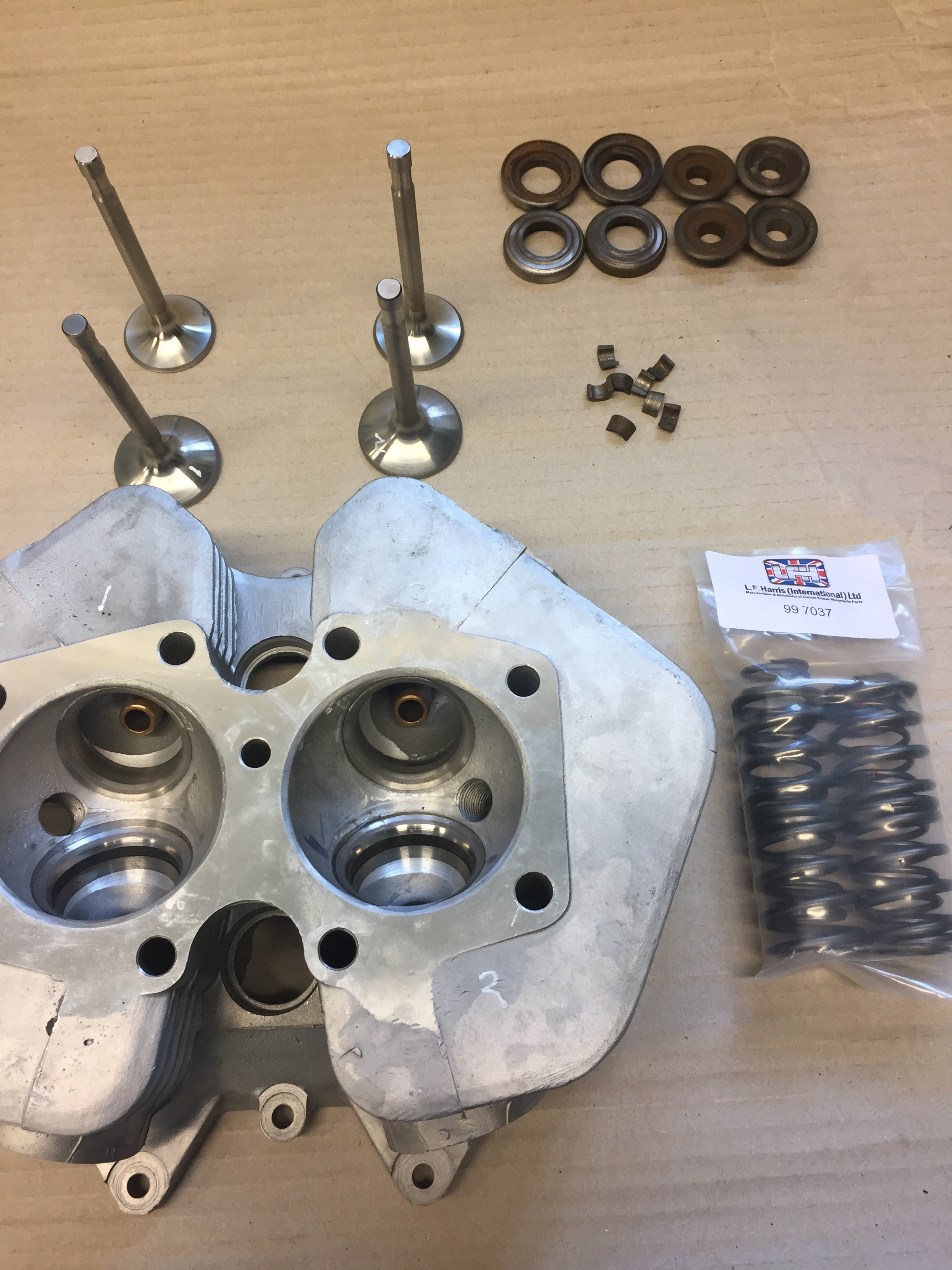

    Cylinder head built back up having had new seats and guides , fitted and ready for rocker boxes.

    One thing I am not sure on as think I am on a change over year is the primary oiler tube has mine been chewed by the chain ? where is the right hand end suposed to go . I am thinking I should have a metal capture plate with a pipe outlet ? is this correct and is it important as defo wasn't there before :confused:
  8. darkman
    7,634
    oil is captured in the c shaped part of the inner primary casing above the clutch.
  9. Tibster
    Tibster Well-Known Member
    Feb 10, 2019
    270
    Witney
    I will have to have another look tomorrow , I know the bit you mean but on mine there is no outlet to connect a pipe to just a blank casting unless I am mistaken . Will report back :) thanks
  10. darkman
    7,634
    If you look under the alt wires there is a obvious part of the inner case that you can see coming down at an angle from the c shaped part :)
  11. Tibster
    Feb 10, 2019
    270
    Witney
    Yes I see that now ! it was hidden by the chain , I was too comfy sat on my stool and a bit too high to see it , my knees are a bit buggered from a lifetime of building work so too lazy to bend down , there is just a hole no spigot ,so assume the pipe just pushes into it . A new pipe is on order , thanks darkman
  12. darkman
    7,634
    Lol, easy to miss especially if it's not there in the first place, i have just done a bit more on Su's T100 and hope to polish the outer covers next so i can button up the bottom end as i should be doing the paint next week :)

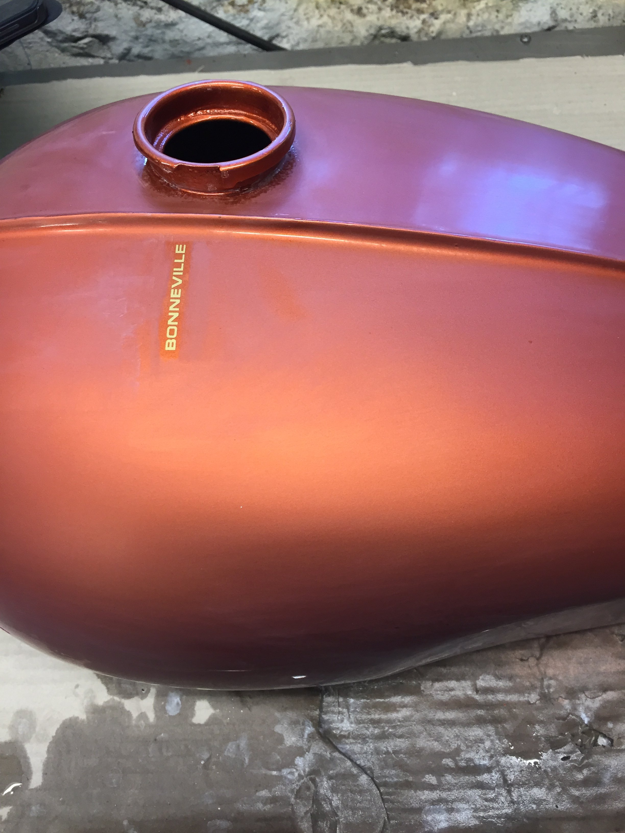

    Going to mask and spray the silver torch shape tomorrow on the tank . I am going to try and lacquer over decal which could well be risky but will have fingers crossed so it doesn’t pickle .
    Thinking I might pin stripe on top .
  19. darkman
    7,634
    Don't forget to remove the paint from the filler neck on top and inside or it will be pickle city :-(
