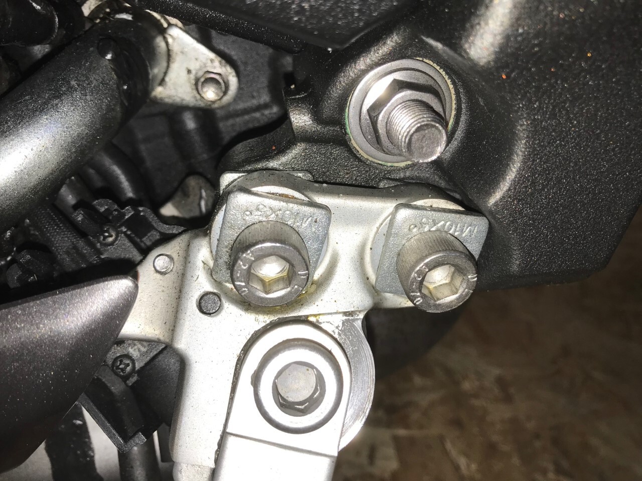

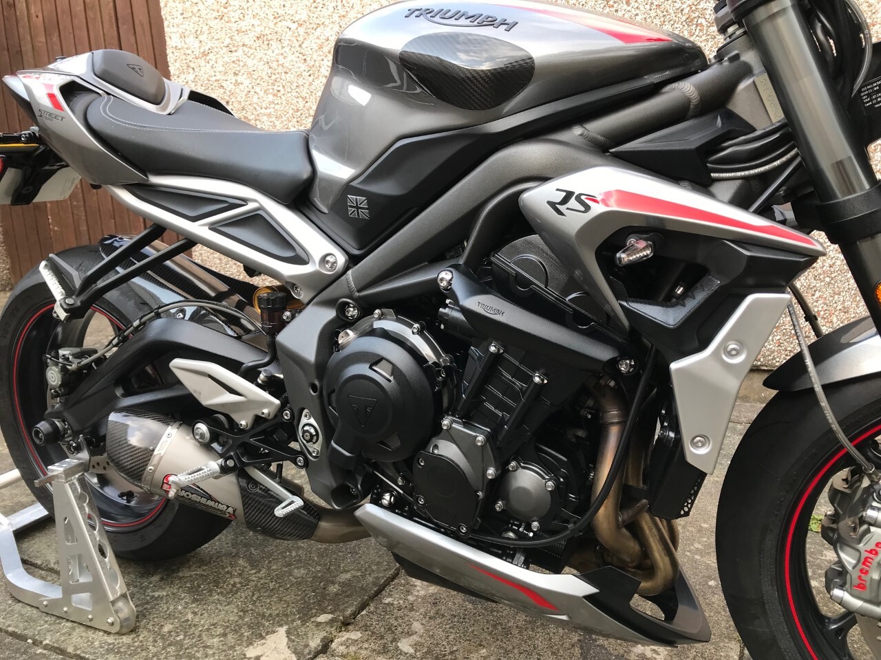

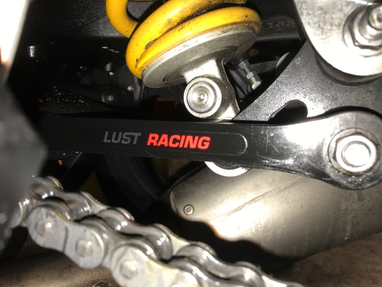

    Sorry for the late post, here are a few photos of the Lust Racing lowering links and sidestand kit, the 4 spacers for the sidestand and 2 new fasteners puts the sidestand at the right height, if the sidestand was left as standard it would risk the machine falling over. Machine cleaned after first 2 photos taken.

    Lust have two kits, one to lower and one to lift. I've always fitted the 'lift' kit to my Street Triples and as Iceman states they are simple to fit. From memory they either lower or raise by 25mm.
    Lowering will make it steer slower but be more stable at high speeds, raising will do the opposite but you will need to have skills far higher than I've got to notice these minor changes.

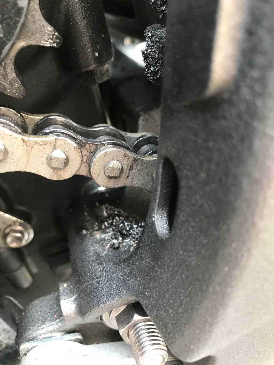

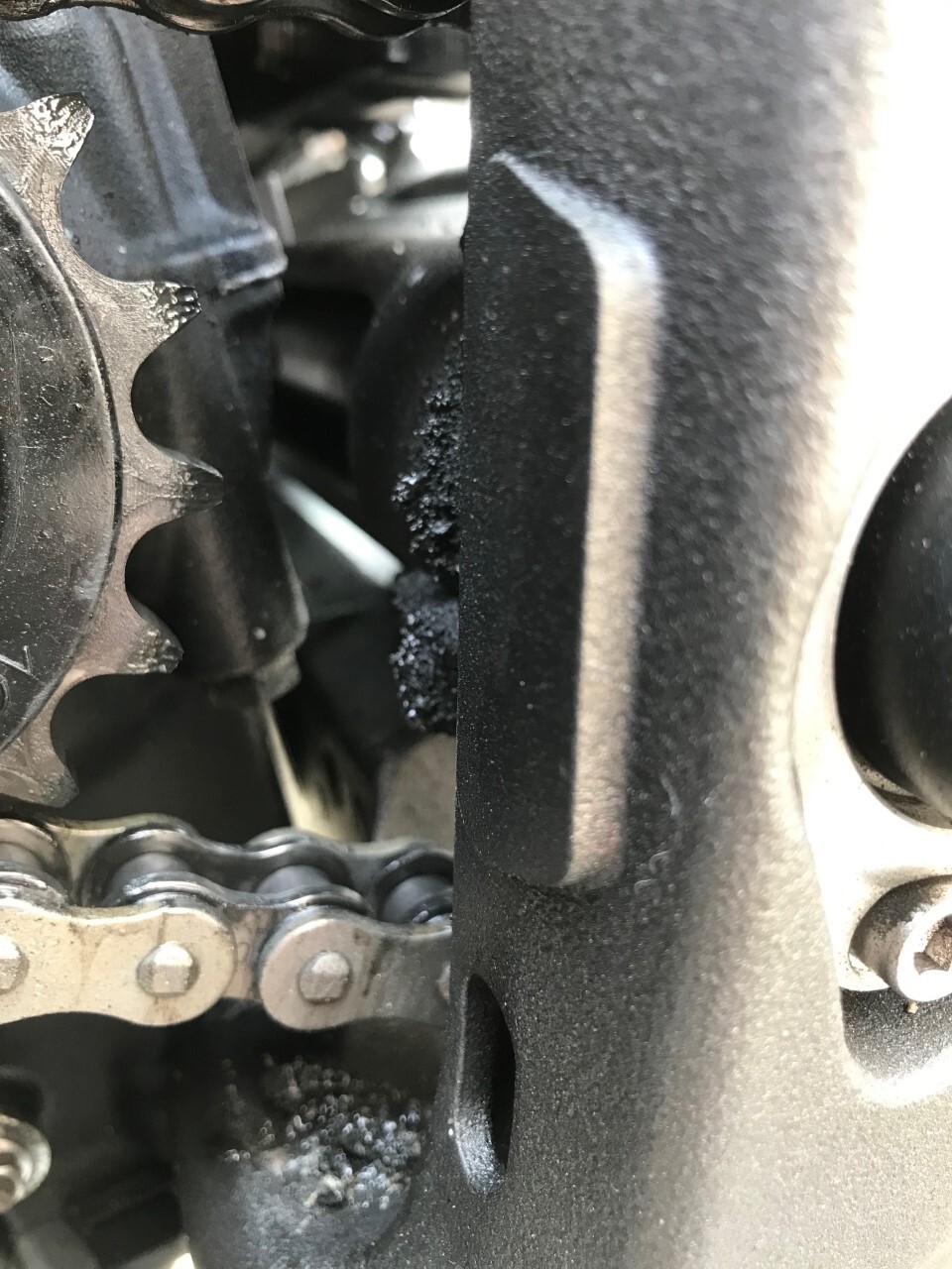

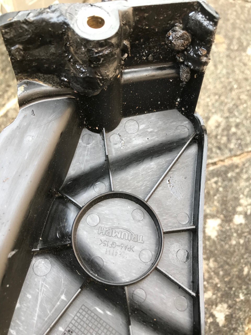

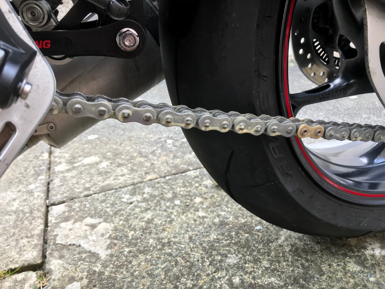

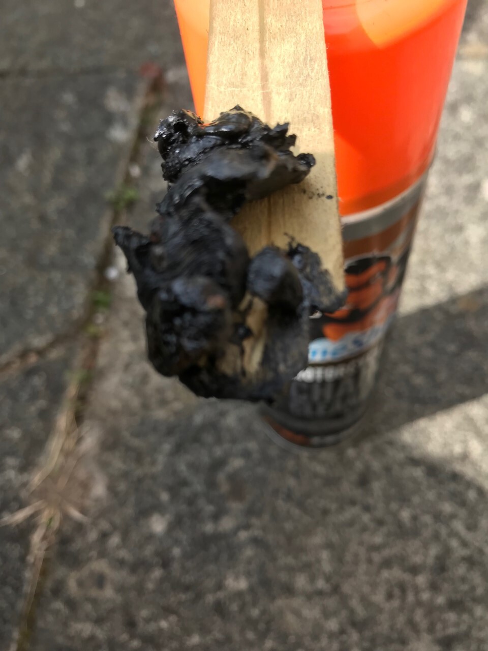

    I gave my STRS a deep clean including taking the sprocket cover off, many don't bother taking this off when cleaning and lubing the chain, you would be surprised by the amount of grit and stone that lodges behind the cover, small gravel stones often wedge themselves behind the front sprocket causing wear to both chain and sprocket, I remove and clean the area thoroughly on a regular basis, as you have to remove the quickshifter/blipper this allows you to re grease the pivots and makes a huge difference to slicker gear changes. After many years trying different chain cleaners and lubes I have settled on Banana Slip Chain Lube and Chain Cleaner, and Muc Off for bike cleaning, we all have our favourites, some use Paraffin or Diesel Etc Etc, however modern O Rings in chains can be destroyed by certain cleaning methods and products, the same is true for chain lubing, people use gear oil or engine oil, whatever we use it attracts stone and grit like bees to flowers, a spirited ride when the chain gets hot and the lube gets really sticky road grit and small stones act in an extremely abrasive manner, personally I deep clean and re lube very regular and obtain big mileages before chain and sprockets need replacing.

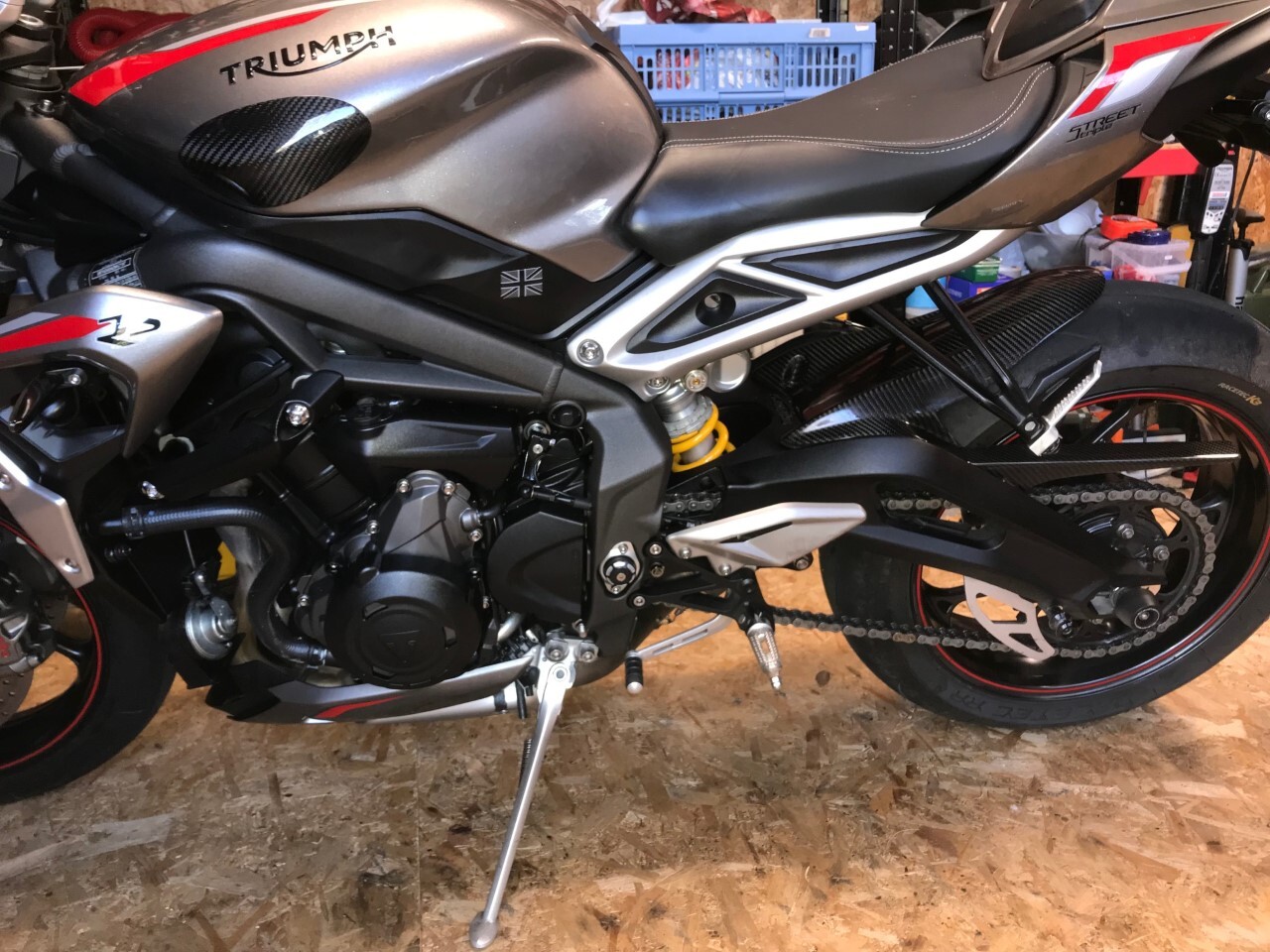

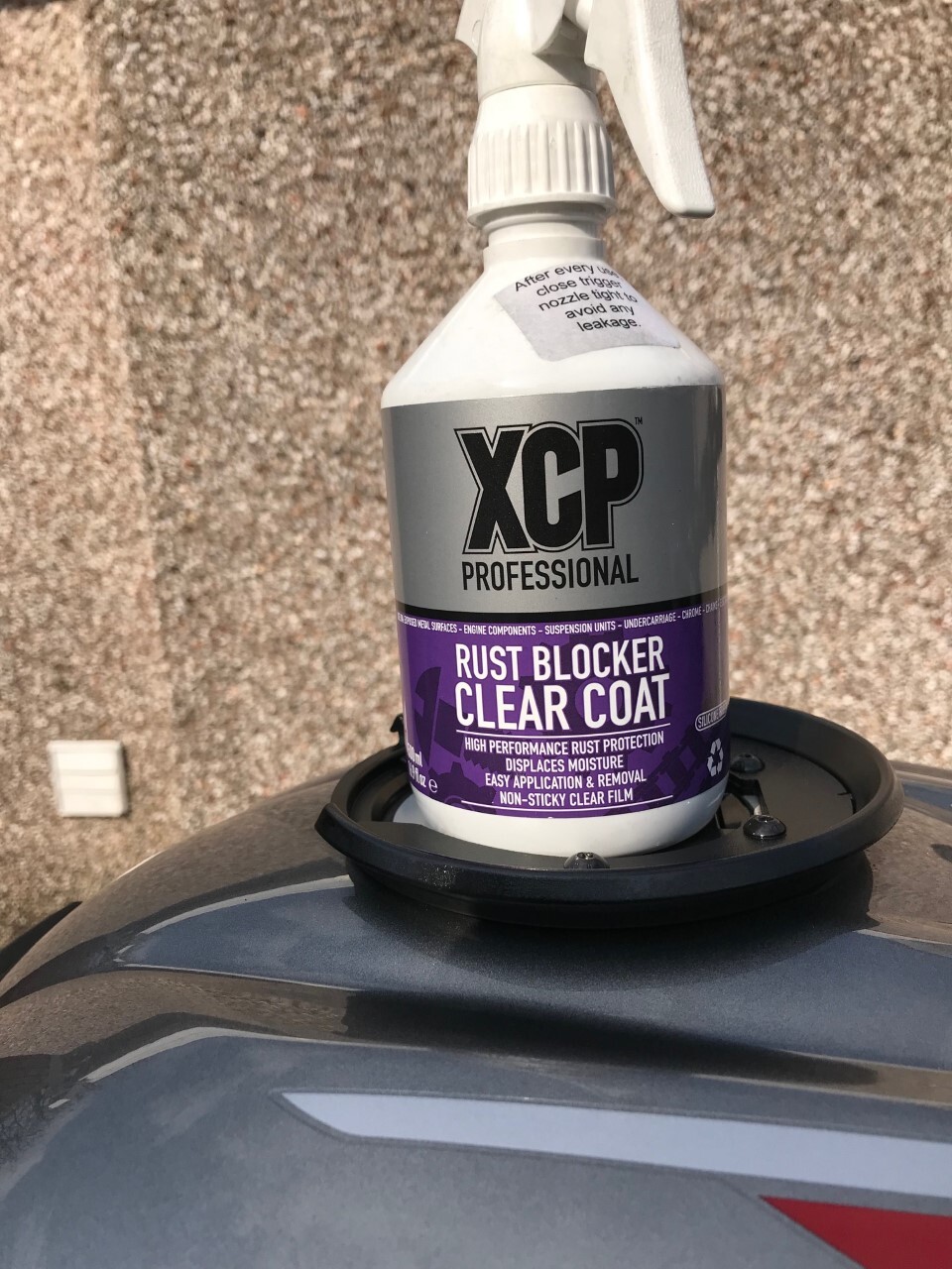

    All cleaned and lubed, also re treated with XCP Clear Rust Blocker.
