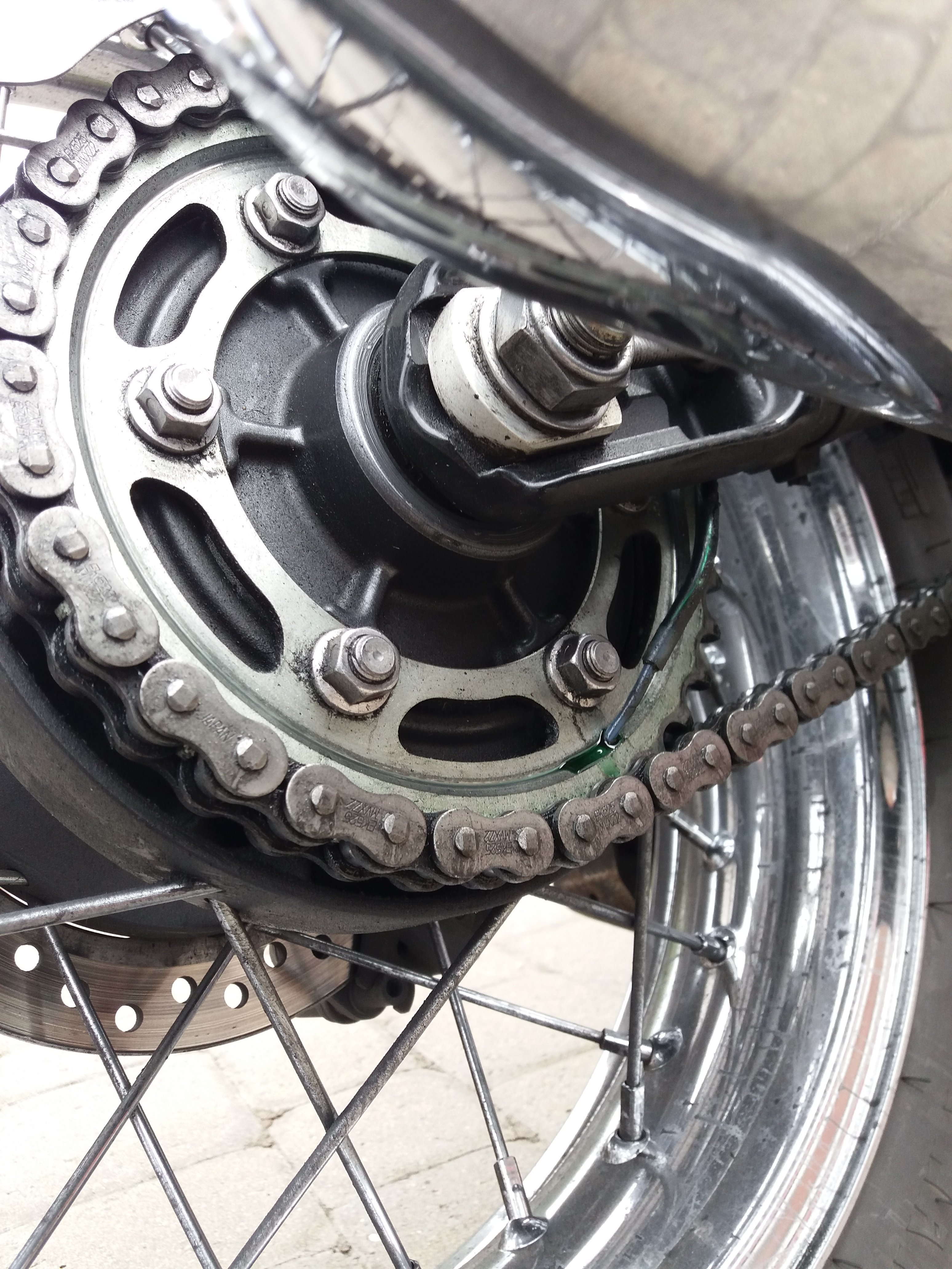

  3. macamxthe1st
    macamxthe1st Well-Known Member
    Just received this from Triumph. Bloody ridiculous. Next bike for me, back to Honda.
    UK Aftersales Cases
    17:05 (11 minutes ago)
    to me
    Dear Mr McManus.
    Thank you for your enquiry.
    I can confirm that the chain adjustment that is available on your model, should be sufficient to last for the expected service life of the final drive chain, Triumph would expect that to be 10 - 12 thousand miles.
    If you have any further concern regarding this matter, please contact your local Triumph dealer.
    Best regards
    Pete
    Triumph GB.
    Geoff.

  7. Alectron
    Alectron Well-Known Member
    Apr 26, 2018
    112
    Northumerland
    Company's called Bike Torque Racing.
    Look for the DID Gold x ring chain and AHF sprocket set for the T120.
    It cost me about £90 inc delivery in uk and took just 2 days.
    Hope that helps

  10. Glyn Phillips
    Glyn Phillips Old’N’Slow
    Jun 21, 2018
    967
    The picture shows an EK chain,they’re not a cheap brand.
    If you have no luck with Triumph approach them directly, you’ve got nothing to lose

  13. bruno_c
    bruno_c New Member
    Oct 19, 2018
    16
    France
    I think that Triumph uses the same chain lenght for spped twins,T100s, T120s Thruxtons etc.
    With some arrangements of front and rear sprokets, the chain is too long and leaves too little space for adjustment.
    I would consider removing a pair of links or fitting a rear sproket with one or two more teeth.
    Bruno

  15. Alectron
    Apr 26, 2018
    112
    Northumerland
    Quite right , I fitted a new chain and sprockets. Two new chain links removed, now as it should have been!
    Safe riding and cheers.
  16. Alectron
    Apr 26, 2018
    112
    Northumerland
    After the first service there was only one marker left for the chain adjust, but T dealer said this was normal. More fool me I guess!
    Without giving misleading and unqualified advice, I would say give it a try.
    After fitting my new Gold and Black chain and sprockets then removing extra 2 links everything is good.

  18. Alectron
    Apr 26, 2018
    112
    Northumerland
    Yes indeed I now have about three markers to go or about 2/3 of the wheel stud left for adjustment. Not easy to see though. Give it a go!
  19. Servodyne
    Servodyne New Member
    Jan 29, 2018
    4
    Preston
    Just a bit of an update since I put a bigger sprocket on the rear wheel at 8800 miles (37T to 40T. I've now done just short of 16000 miles and have still lots of adjustment left on the original chain. The chain is still perfectly serviceable when checked by trying to pull it off the sprocket mid way around the sprocket. I would have to conclude that there's nothing wrong with the quality of the original chain, it's just down to a poor choice of sprockets or chain length by the factory.
