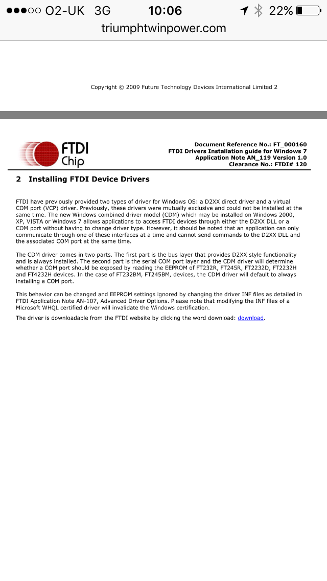

    What I'm having a headache with is downloading the software. The information on what I need in the way of drivers and what the actual software is shit.
    The process looks well documented and straight forward but finding the drivers for Windows 7 and the actual software is very poor!?
    Could anyone who has done this shed some light?
    Thanks guys

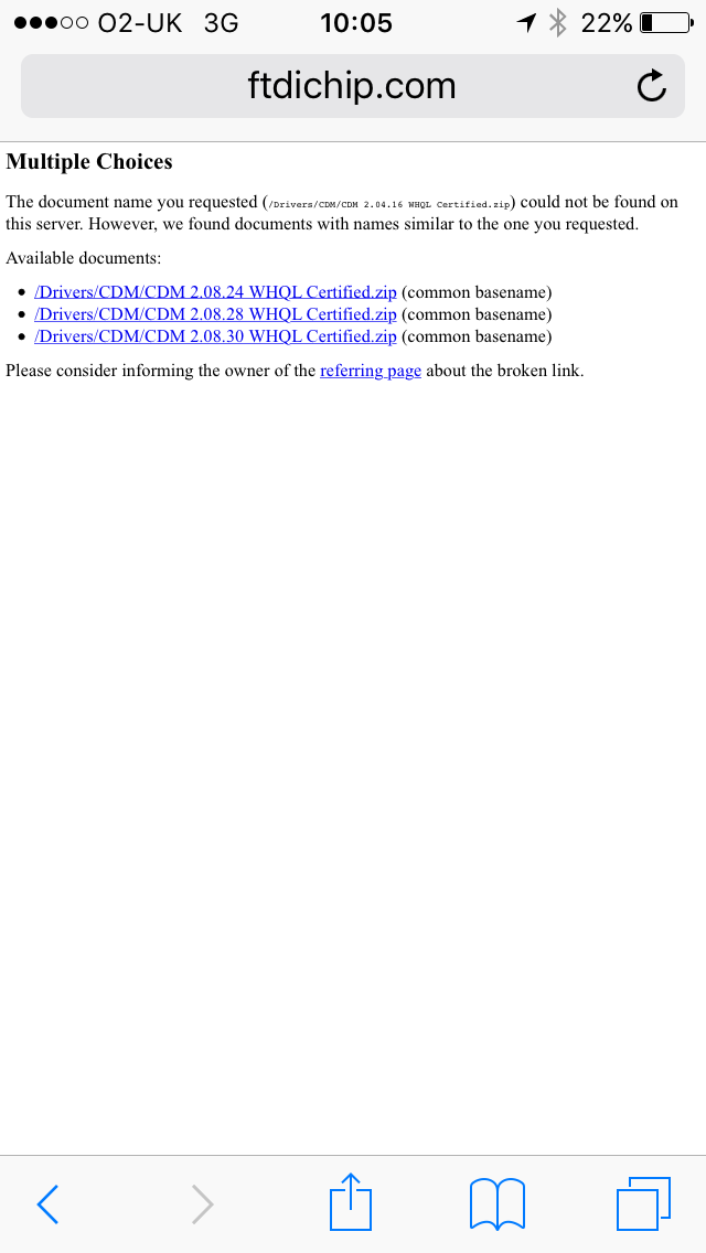

    Hi,
    Thanks for the feedback. I'm not crap with computers but I don't get it.
    I have purchased the 2-1 stage 2. Gone to the site.
    Entered the code.
    Downloaded the file.
    It then sends me a zip file with 4 or 5 documents, 1 being a PDF with a guide on.
    On the guide it says I need 2 drivers.
    Cable and uploader.
    There is an guide for Windows 7 on the site.
    I Click on the link where it says download in blue.
    This then comes up.
    Do I need all 3 drivers? This is where it gets confusing!?
    How did you guys go about getting the correct file (s)?
    How many drivers did you download?
    Where did you get the files from?
    Have you got any links to the Windows 7 drivers or screen shots of the files I should download?

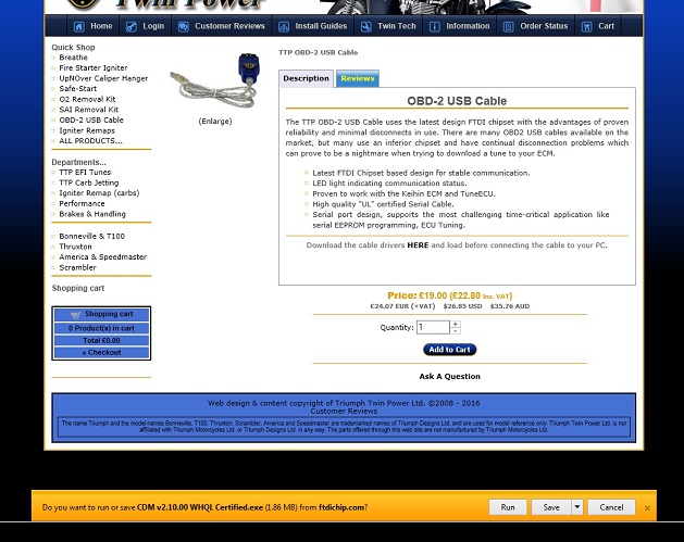

  14. crispey
    7,245
    forgot it was easter! For the cable, the driver I downloaded from their website was OBDUSBCDM v2.10.00WHQL note where it says "HERE" just above the price of the cable
    I just tried it again, it said it had to be elevated then when I tried extracting it again it worked. use save and download or save as, cant remember which then save it to a folder of your choice. make sure the cable isn't connected. then try and open it, I click on it and a window comes up saying FTDI CDM Drivers and a button that says extract I click that, I then get a window asking me to let programme dp inst-amd64.exe to make changes to my computer, I click allow and get the driver installation wizard up. and from there on it installs.
    as I said it all worked for me by clicking on the link. if it works for you , don't forget when you plug the cable in to the computer for the first time don't be connected to the internet , don't let the cable install any of its own drivers click on the one that you've downloaded from TTP site. I can't remember downloading any other ones unless when you open the map it downloads a driver. Really sorry but that's all Ive got, if it doesn't work at least they'll be open tomorrow.
