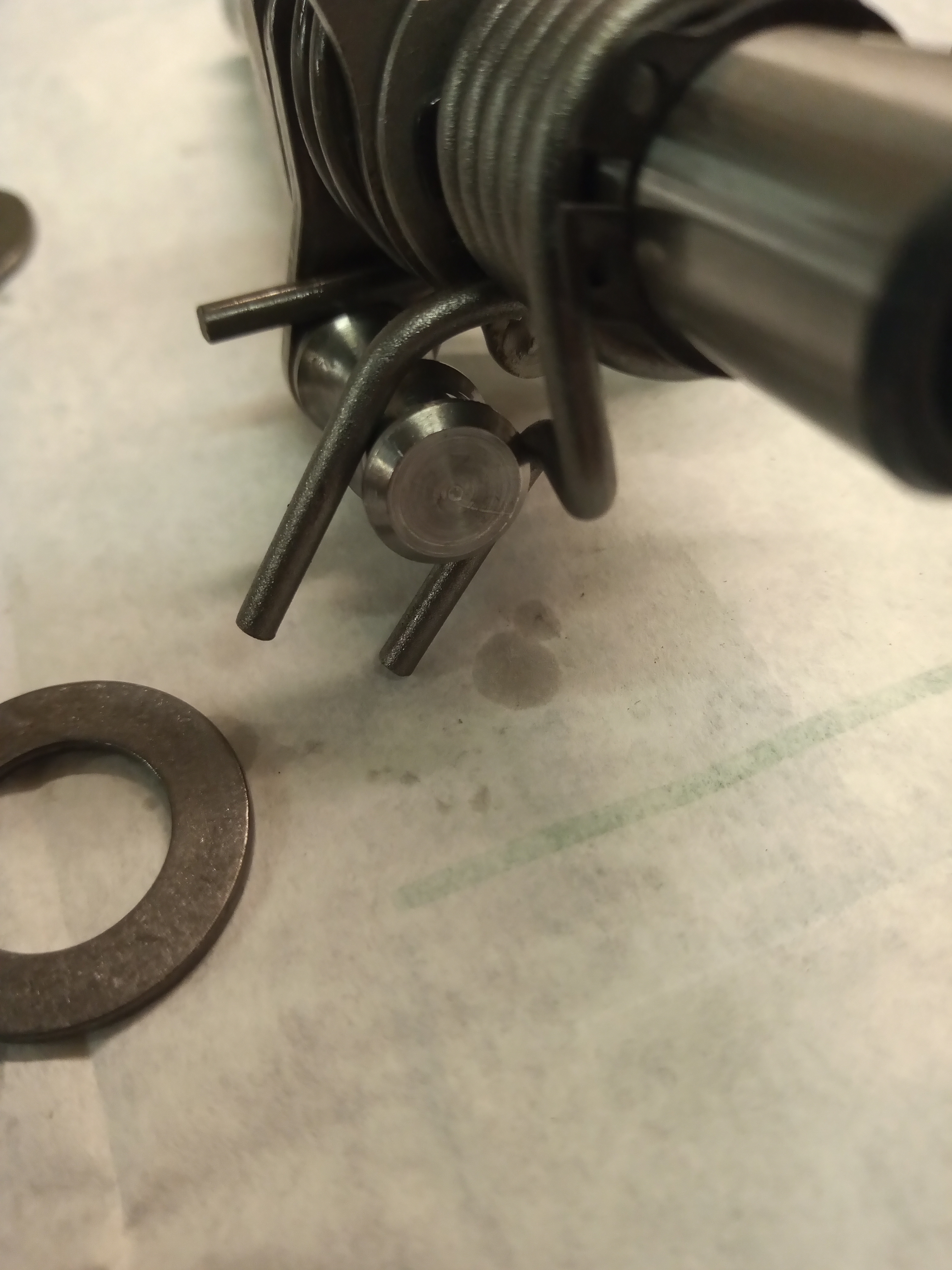

    A quick footnote, when assembling the shaft, the end spring needs to cross over to be tensioned.
