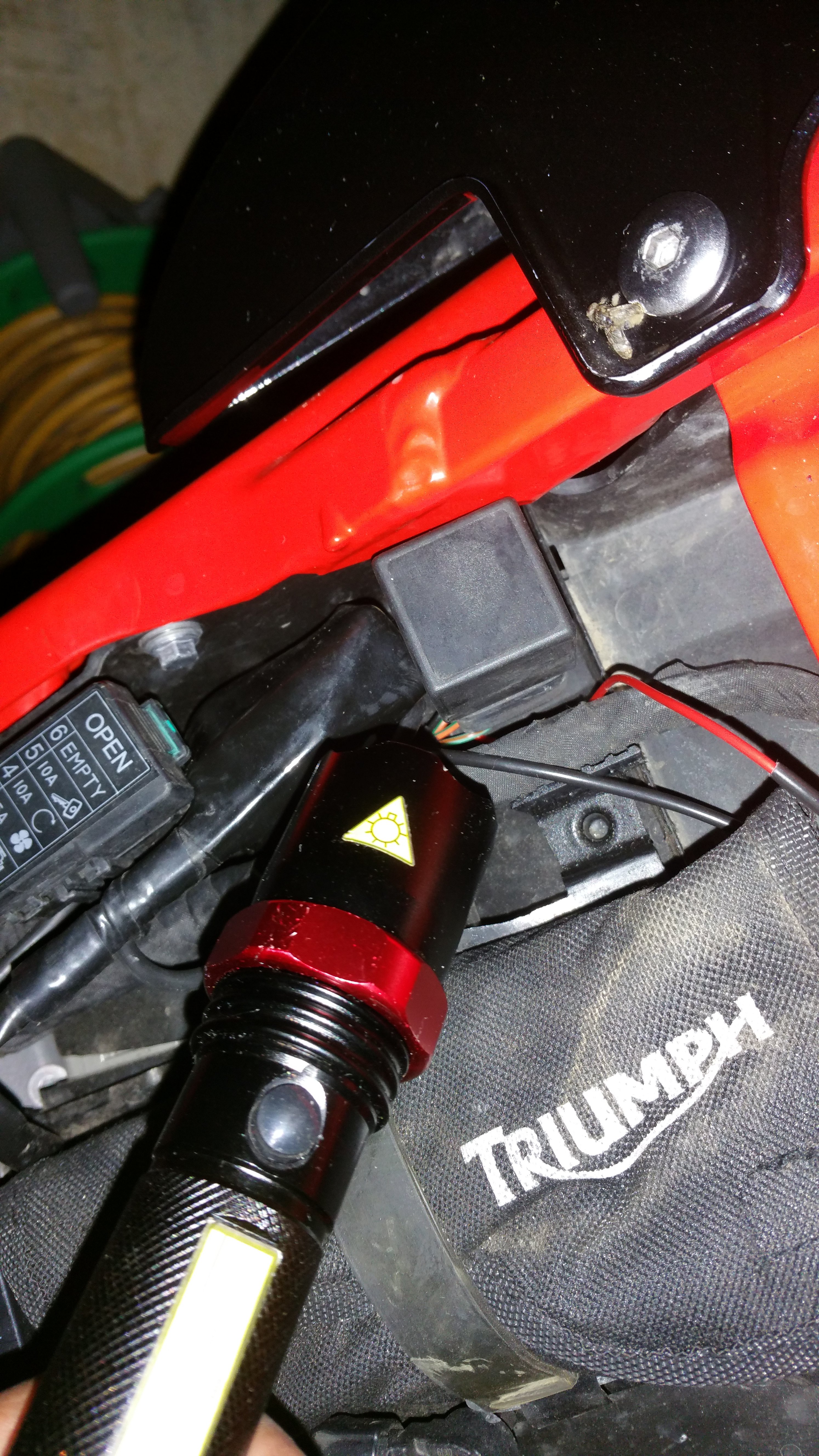

    Is this the relay I need to swap with triumph new led relay. Thank you

    Yes that's the relay. On some models (with only 2 wires) an additional earth wire is needed but I would think yours will already be wired in to the connector.

    Thank you Col
    I am petrified when it comes to electrics :-(
    I just hope it's a plug n play n I don't have to mess about splicing anything

    Ok here we go people. ...got my indicators in today :)
    I need to drill number plate bracket hole a little bigger to feed the wire n connector through.
    As for the relay I thought it was meant to be a plug and play BUT I'm looking at connectors n wires. Beginning of my headache.

    I haven't a clue. Let me check the instructions. ..I think that would be helpful; -)
    I will 1st start off with drilling the hole to ensure I can the wire through the number plate bracket. Then I shall look into the relay :)
  11. darkman
    7,634
    Extra wire in kit is for earth it you have a 2 pin on your bike as new relay has 3 :D

    If you've got standard number plate hanger shouldn't need to do any drilling. Can feed each connector through staggered one at a time.

    I have an aftermarket one (tail tidy). I tested the indicators with relay n all good :). Im soooooo chuffed
