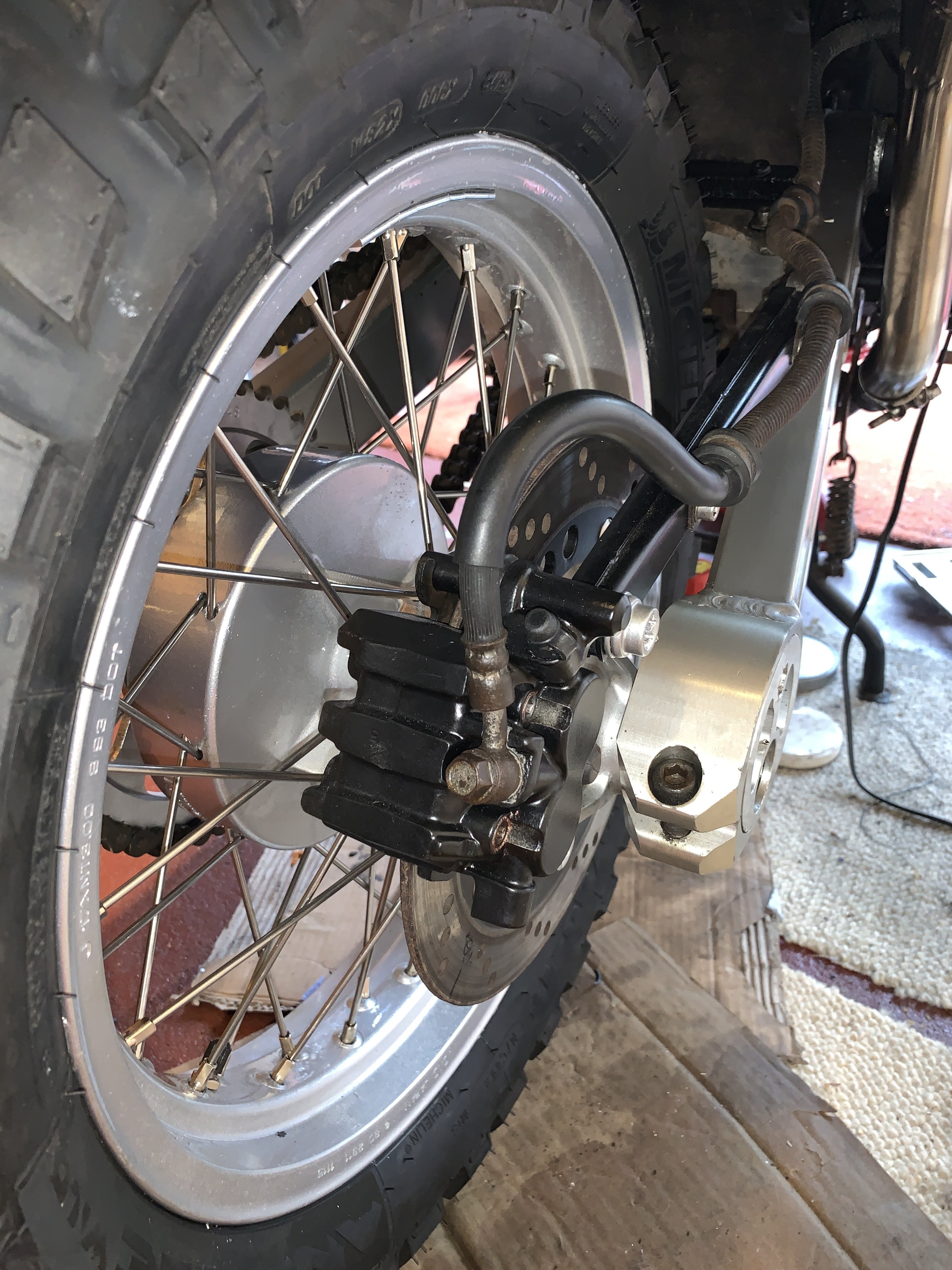

    So the wheels are coming back very soon cleaned, blasted, powder coated and new spoke...... just needs seals, bearings and new tyres.

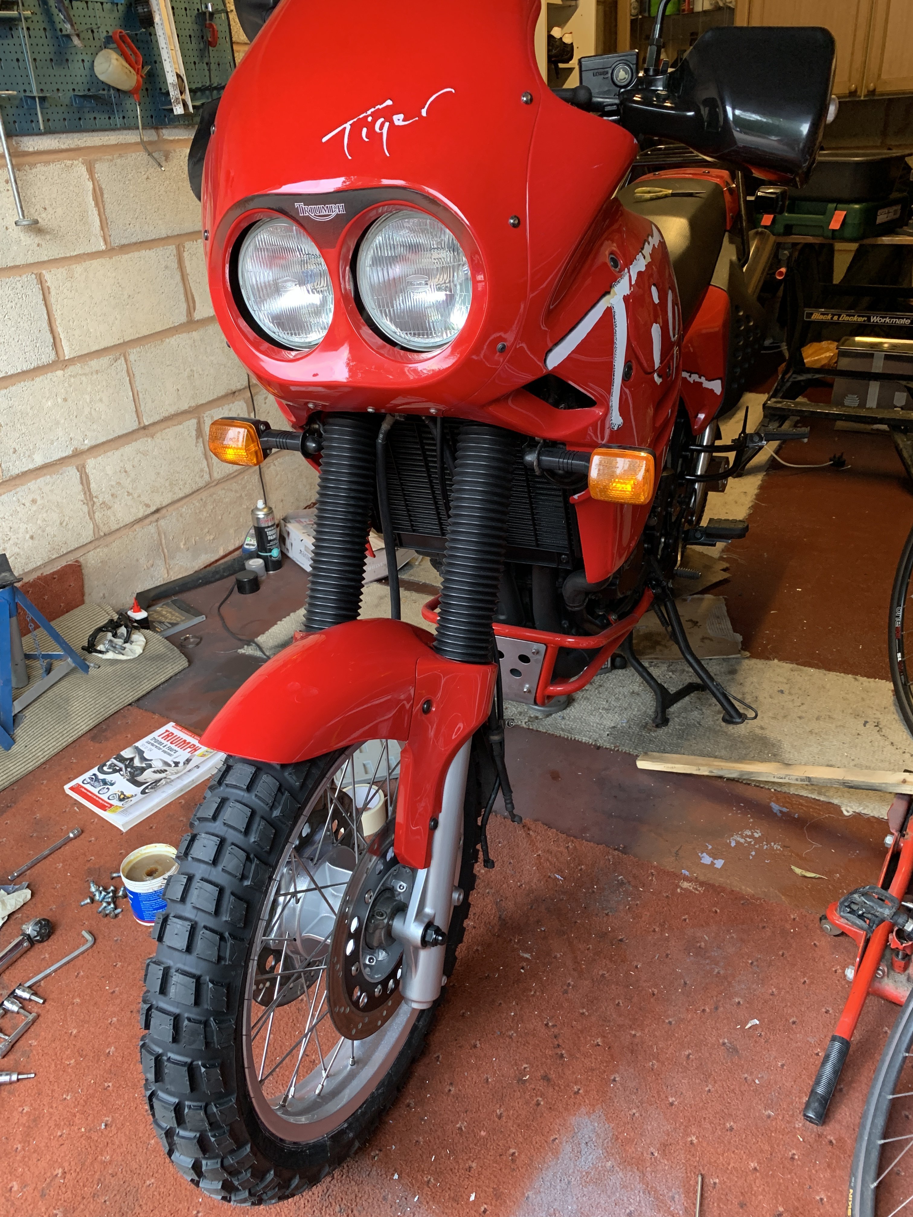

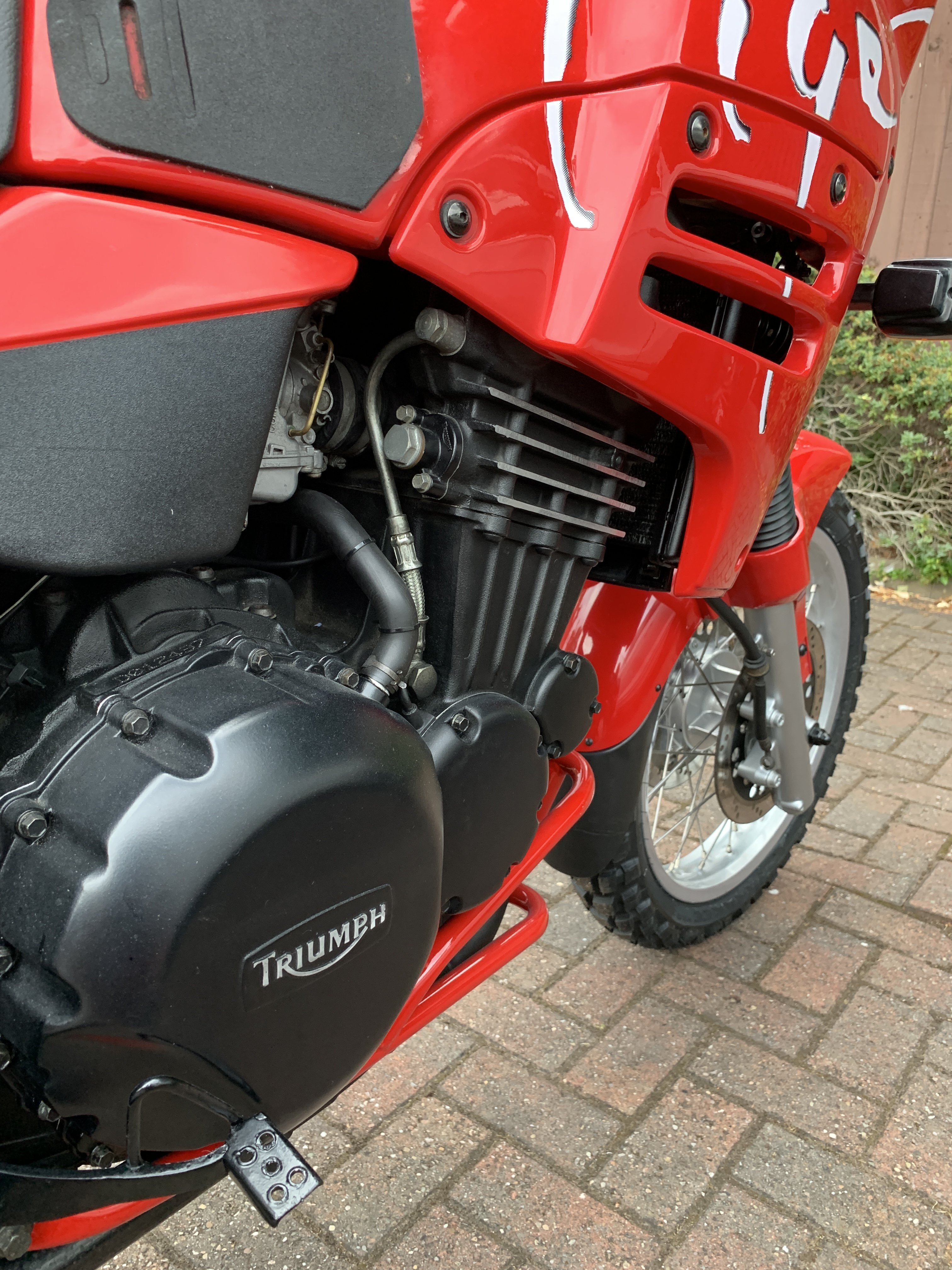

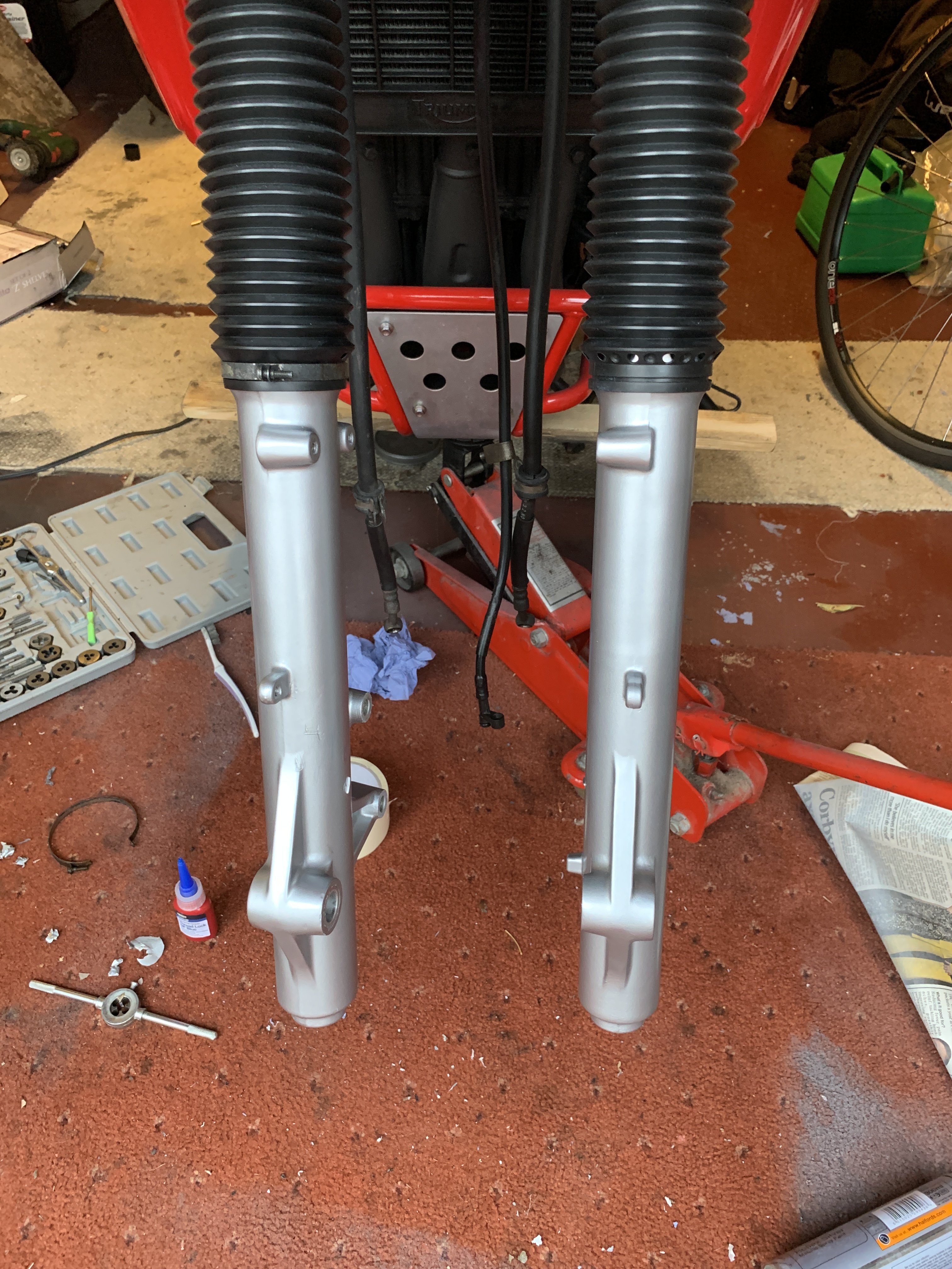

    So below is the list of jobs completed so far. Still to do plugs, check valve gaps, new air filter and carb rebuild but carbs will be over the winter. I might "seal" the tank as well but its not bubbling so will leave well alone for the time being.
    • New fairing bolts all round
    • Headlight fairing resprayed. Deep scratch through the decal. Amazing job by the paint shop. Looks like new
    • Sump guard stripped and repainted
    • All engine casings stripped and repainted
    • New engine casing gaskets all round
    • Alternator cover stripped and repainted
    • Water pump hose cover stripped and repainted
    • Radiator and water pipe stripped and repainted
    • Tank filler cap stripped and repainted
    • Exhaust down pipe blasted and VHT paint applied
    • Rear brake pedal stripped and resprayed.
    • Rear brake torque bar stripped and repainted
    • New bolts and captive nuts front mudguard (fender)
    • New fork gaiters
    • New fork seals and oil
    • Forks resprayed
    • New tank fuel valve
    • New clutch master cylinder - mirror recess hole cross threaded
    • New LH mirror - see above
    • New knuckle guards RH/LH
    • Pillion mounts stripped and repainted, New bolts and bolt caps
    • New pillion foot pegs front LH/RH
    • Front/rear break stripped, resprayed, new seals , new pads
    • Front rear wheels stripped, blasted, powder coated, repoked, new seal, bearing and tyres
    • New front wheel (two disc bolts would not come out) :(
    • New disc bolts all round
    • New cush drive captive nuts
    • New horns - old ones were a bit rusty
    • Oil and filter
    • New brake and clutch fluid
    • New Triumph “oat” coolant.
    • New air filter
    • Valves checked and re-shimmed. Good job as inlet on number 3 was only just about closing
    • Original exhausts fitted
    • New clutch master cylinder piston and seals
    • Carb strip, ultrasound clean and rebuild
    • New gear change lever rubber and bush
    • New fuel level sensor
    • Repair and fuel proof tank

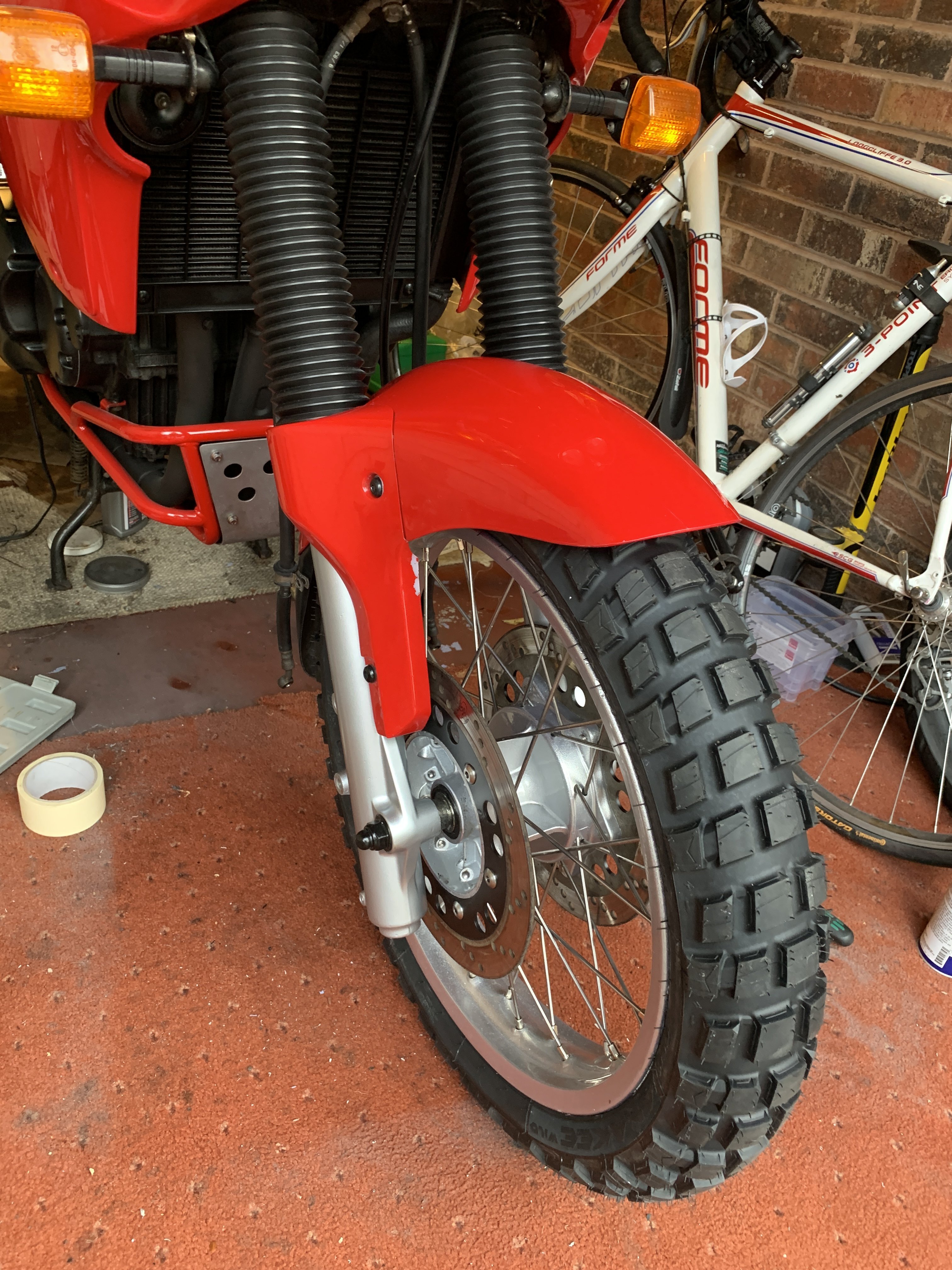

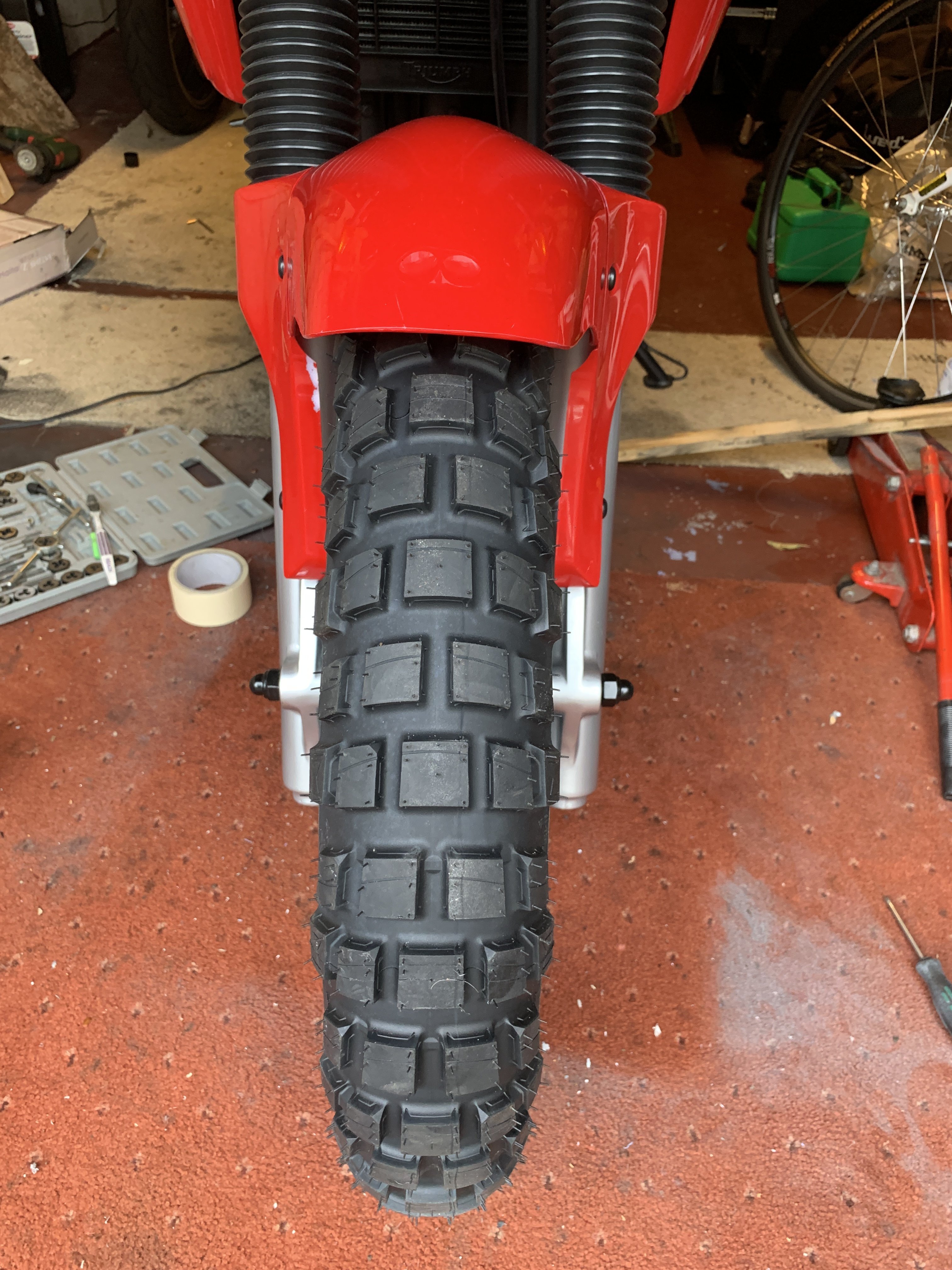

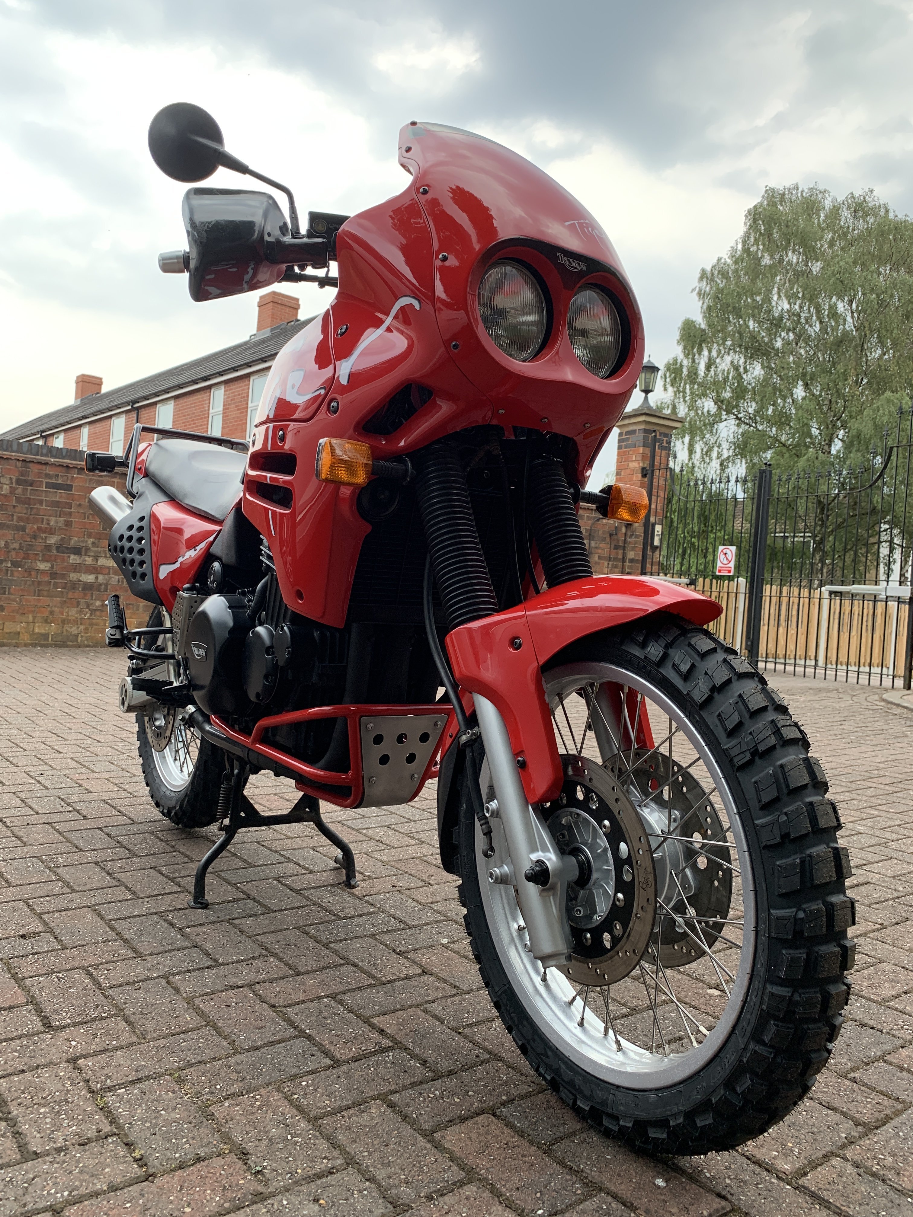

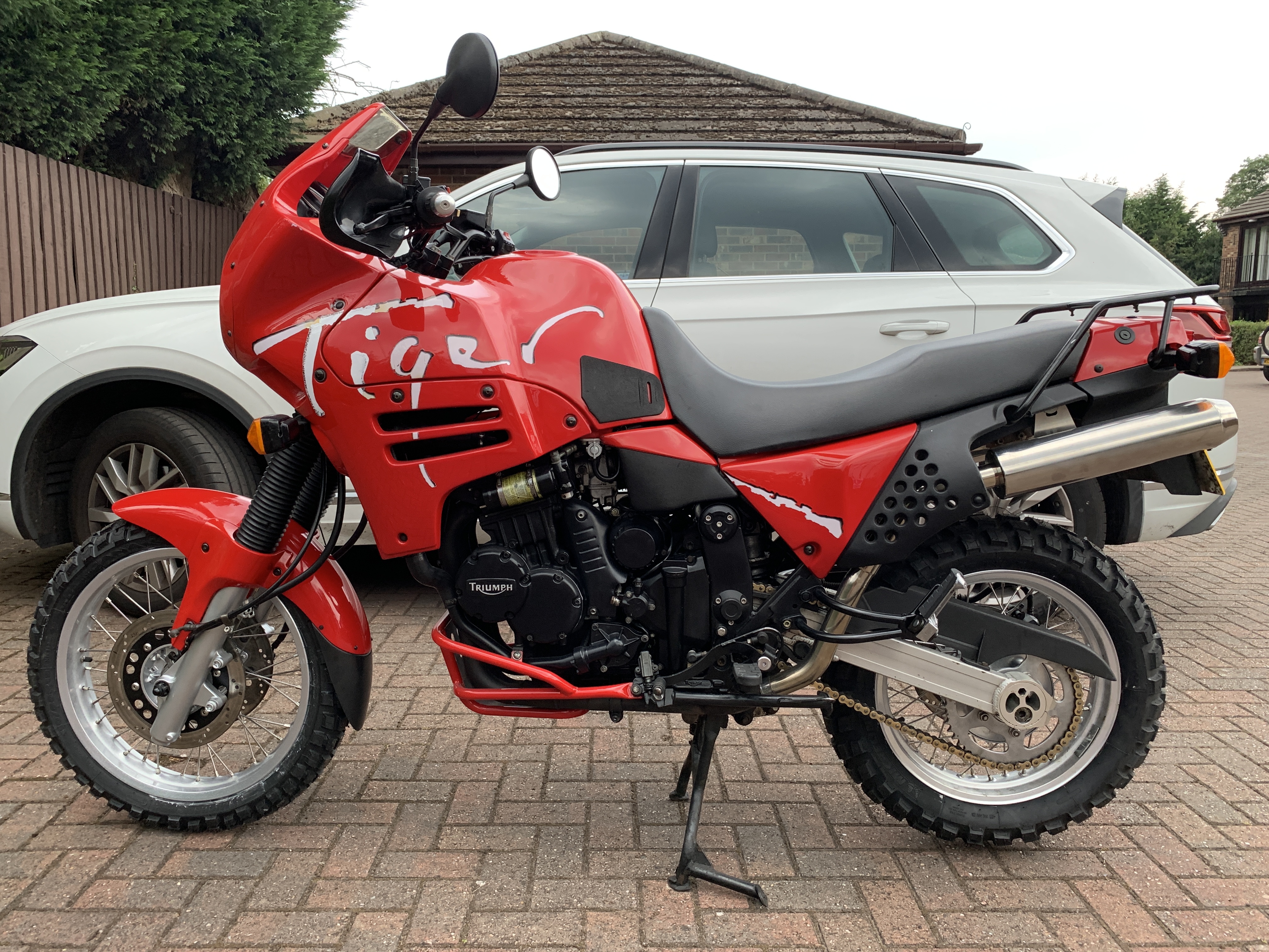

    OK so after much effort the beast lives again......and now with a set Anakee Wilds
  7. Simon Logan
    Simon Logan Active Member
    Jun 13, 2020
    138
    33
    Sutton Coldfield - UK
    Found some original exhaust cans to replace the after markets which the previous owner fitted. Will put her away for the winter now in contemplation of a carb overhaul

    YOU FOUND ORGINAL CANS???? Where? Do they have any more?
    p.s. looking GREAT! Nice work. :D
  9. Simon Logan
    Jun 13, 2020
    138
    33
    Hi Adie, new cans for sale in the UK on ebay but £800 plus and I think that is just the exhaust. Heat shields and Triumph badges on top. I found these second hand on ebay for £25. Not perfect but with a little TLC should be ok for many miles. Thanks. I'm really pleased with the end result.

    Nice work Simon! Those Anakee Wilds look the business; they might be my next purchase....if not TKC80s. The reviews comment that the rears wear quickly but good tarmac grip. The usual trade-off, I guess.

    You will laugh..I'm a girly sports bike rider so I hate those tyres. I bought them as my mate wanted to go "off road" but they are hard work and it feels like I'm coaxing a boat around the corners compared to my Zx12 with Pirelli Diablos. They do seem to hold the road well . So far I have done about 3 miles of green laning on the Anakees but they were very helpful getting across a flooded/boggy camp site.
