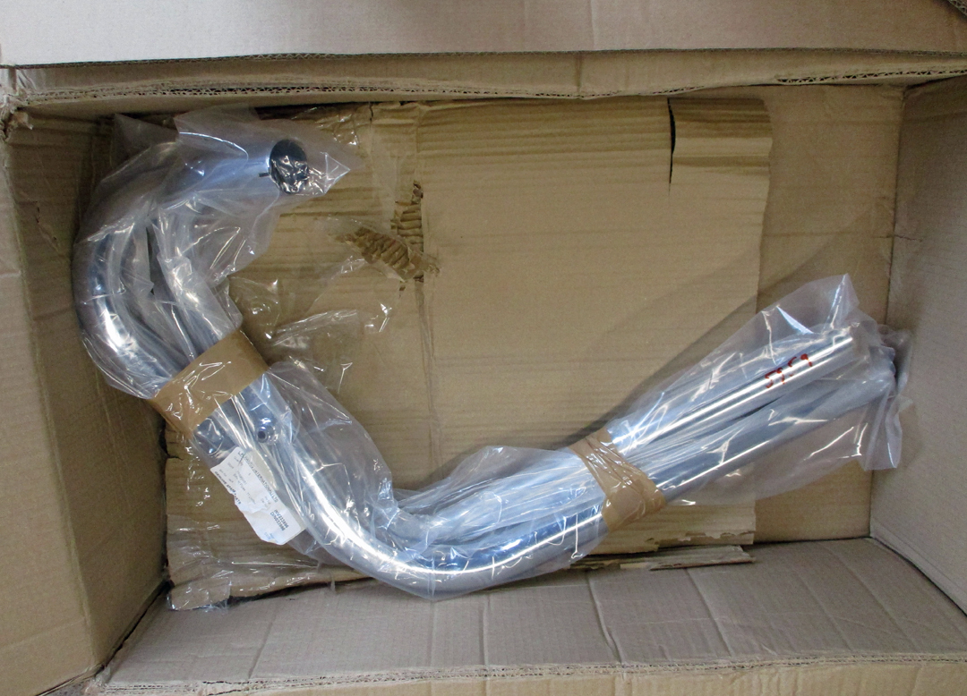

  11. Iron
    Iron Elite Member
    Dec 29, 2021
    2,741
    943
    Bob Ross Studios

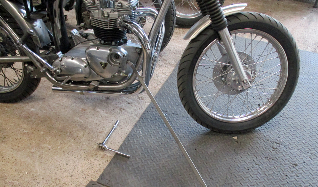

    Oh no, some more boxes came today :cool:
    Mr Harris' zorsts, luvly, shiny :dizzy:
    And his OIF tank, luvly, oily :dizzy:

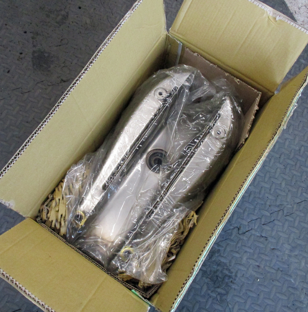

  12. Octoberon
    Octoberon Crème de la Crème
    Jul 2, 2020
    2,250
    Peak District, Yorkshire
    The Ark of the Covenant.
  13. Octoberon
    Jul 2, 2020
    2,250
    And the lid.

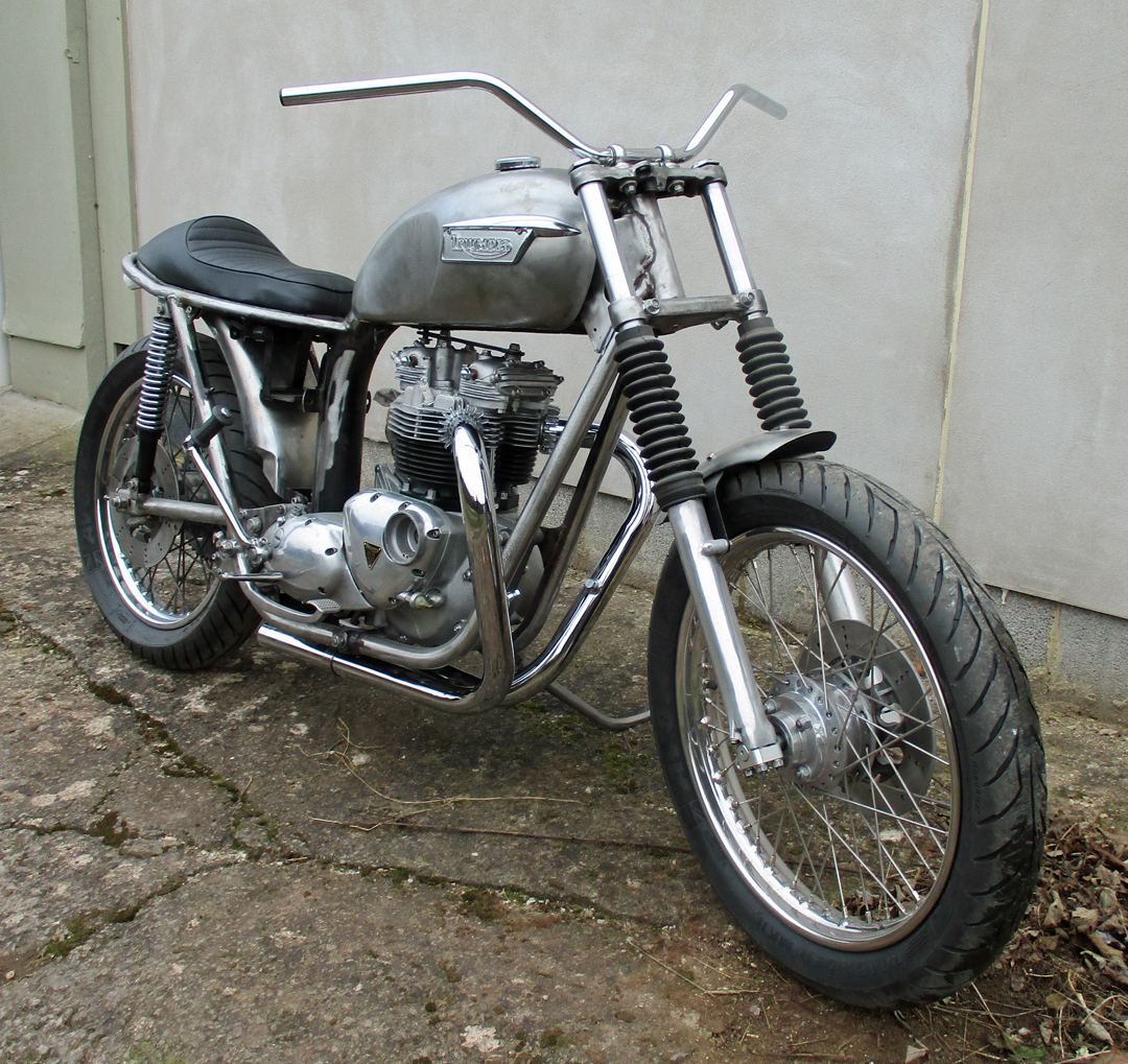

  14. Iron
    Iron Elite Member
    Dec 29, 2021
    2,741
    943
    Bob Ross Studios
    Already had some zorsts clips for the underslinging and will make some front brackets out of stainless. Coolness coming along methinks
    I actually sat on it making "brrrrrrrrming" noises. And turned the radio off so I could hear me doing it :rolleyes:

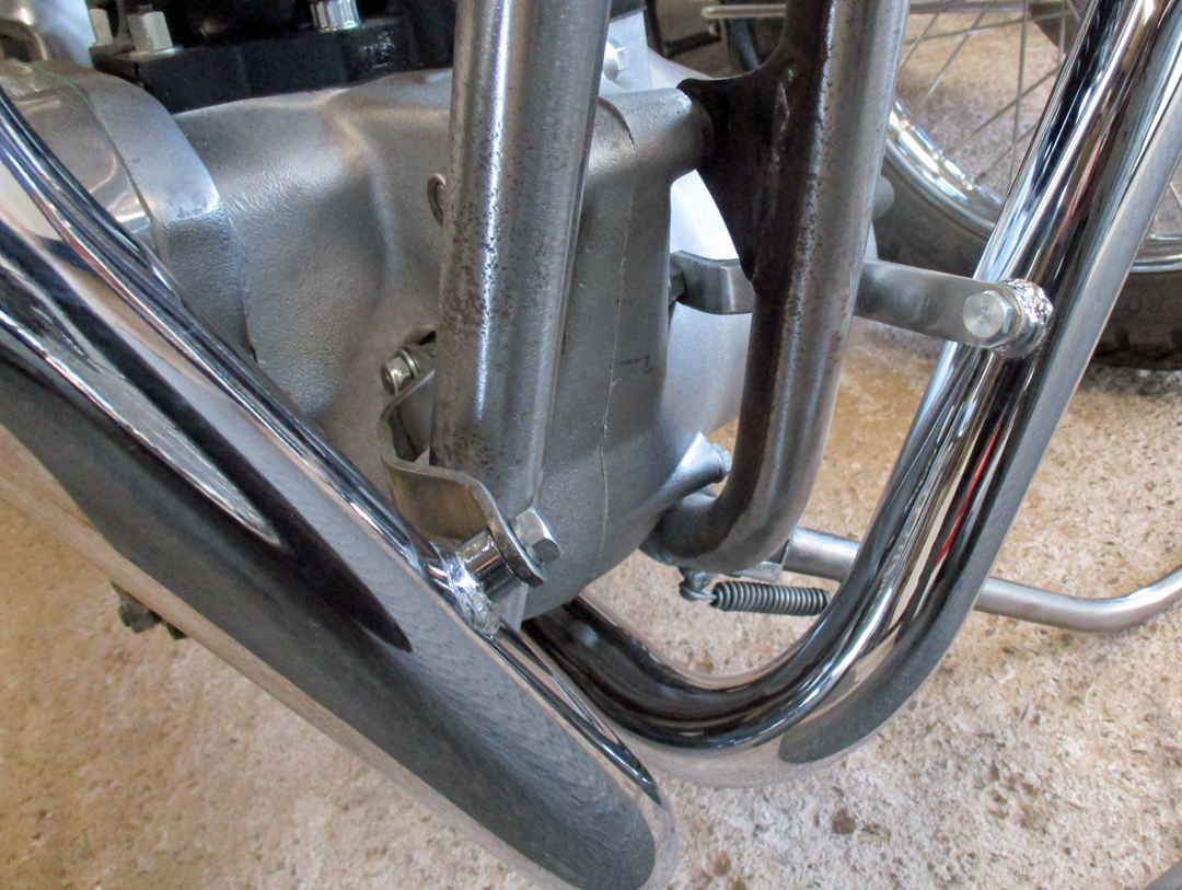

    943
    Bob Ross Studios
    #220 Iron, Feb 5, 2022

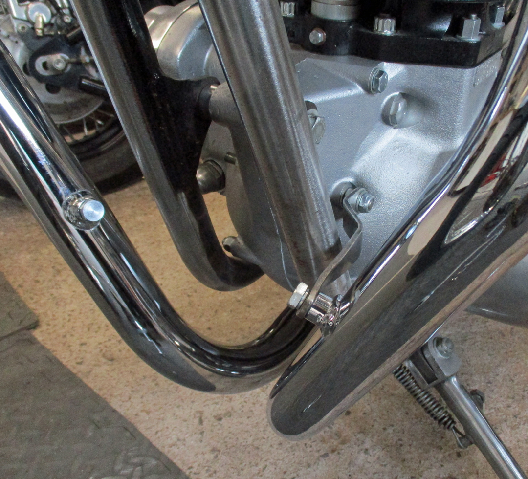

    So, zorsts look good and by golly they do you good. (As long as they aren't too loud.....too loud really gets on my nerves after a while - I have sensitive nerves)
    I wondered if, being for a 'taller' engined bike they'd be hanging down but they are really nice.
    Needed to sort some brackets - didn't know if the standard T120 TT brackets would fit but I didn't want black ones so opted to make my own out of stainless.
    Out with the 20x4 flat bar then
    Looks pretty simple. Cut it a bit shorter give it a bend in both directions and...
    Stick it in the vice, use the big adjustable to give it a twist or seven and...
    The right hand side was a bit more of a bugger though. I thought I'd just make a mirror of the right hand one - nope. The engines sit a bit further to the left due to the spacers so had to bend this one a few thousands times more to ensure it keeps away from the downtube yet bolts in nicely. Glad I used the 4mm bar but really hard to get the bends.
    Just give them a polish and looking good. :cool:
