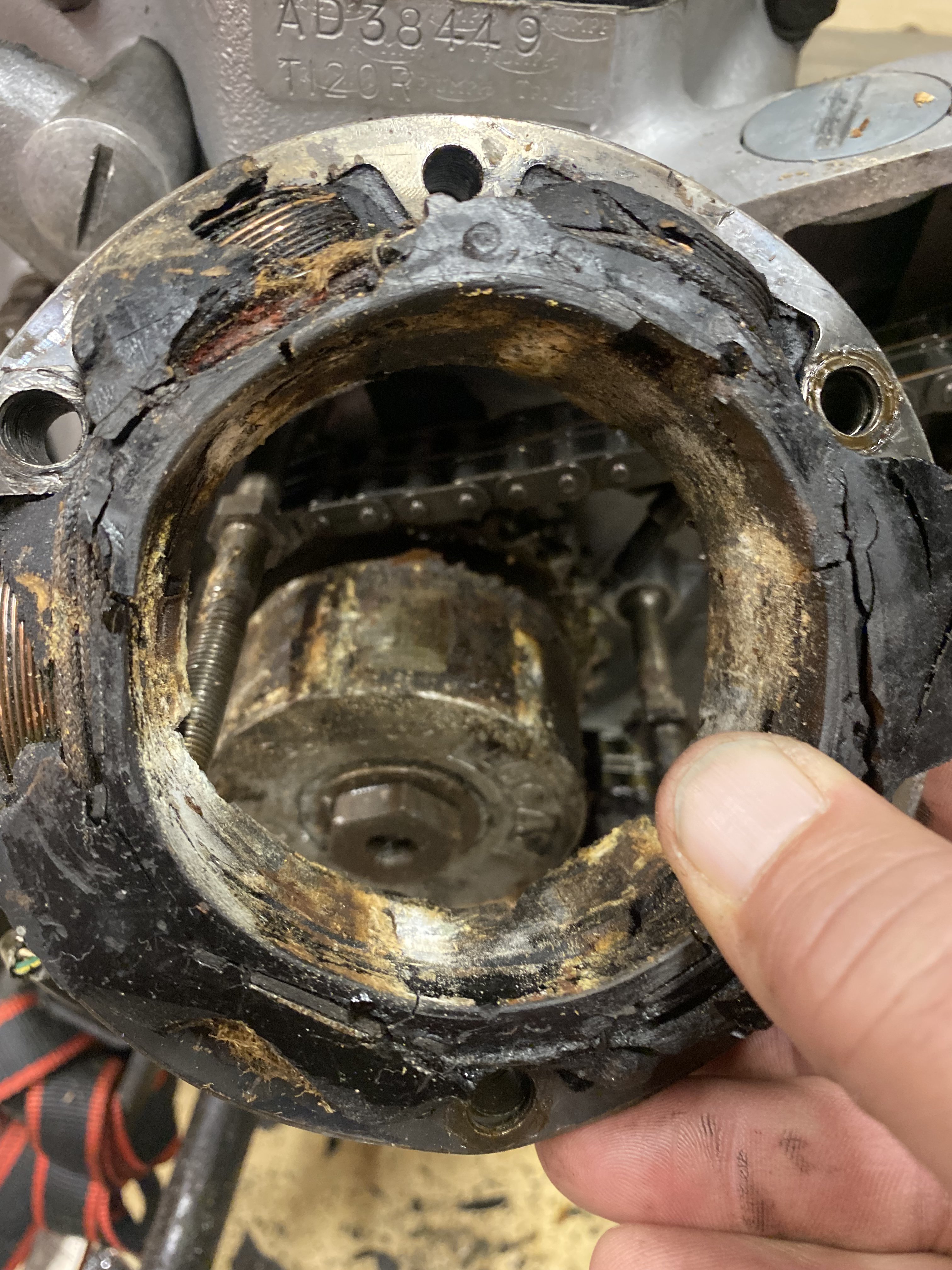

    D9E2B9C6-5448-4B60-B035-25FA74816519.jpeg Finally getting some time to work on the 70 Bonnie. Looks like water damage ruined the stator and alternator.
    I’ve been hoarding parts over the past couple of months, looking forward to working on this over the winter. Will post updates.
  4. darkman
    7,634
    That's nasty.

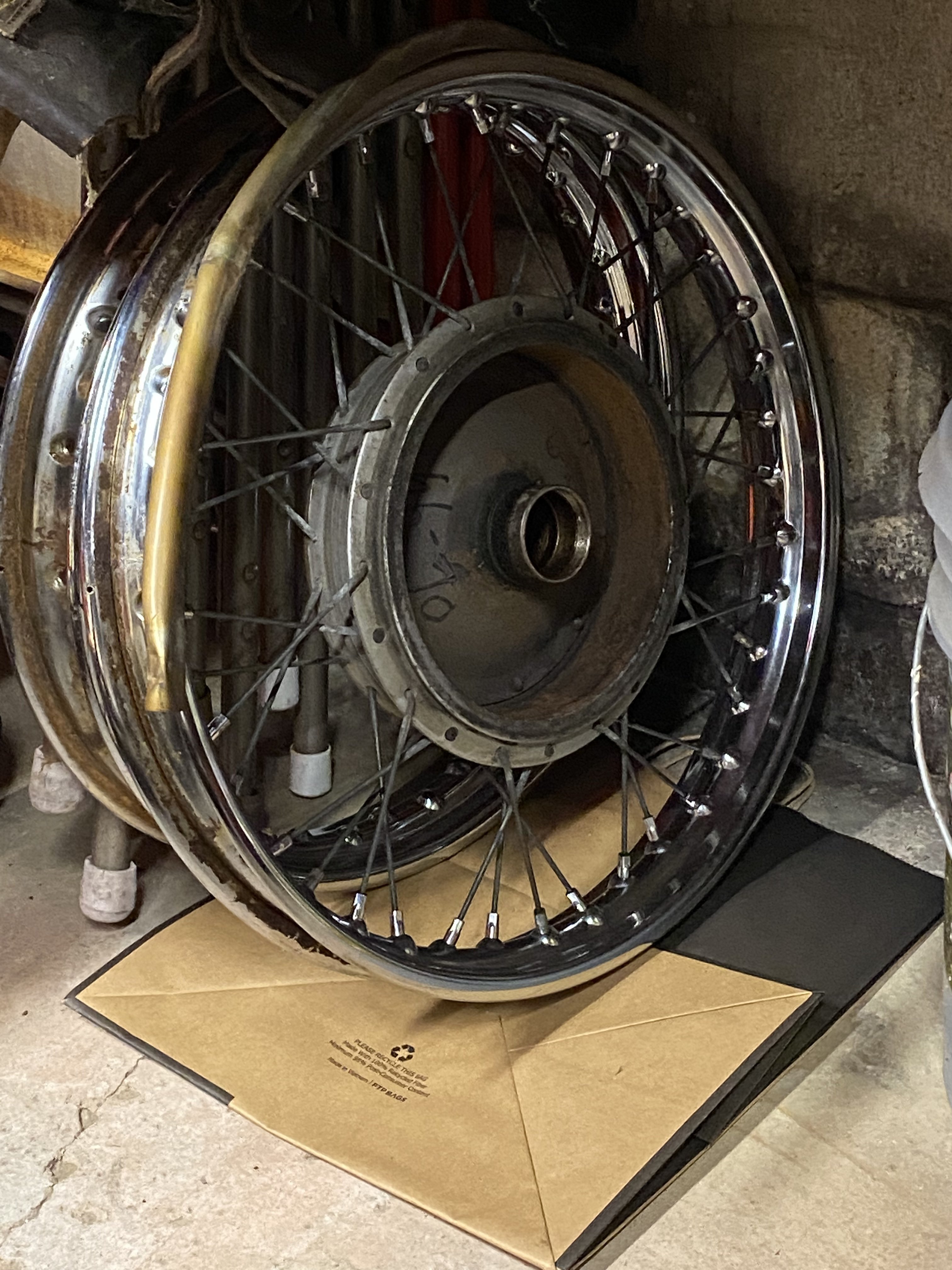

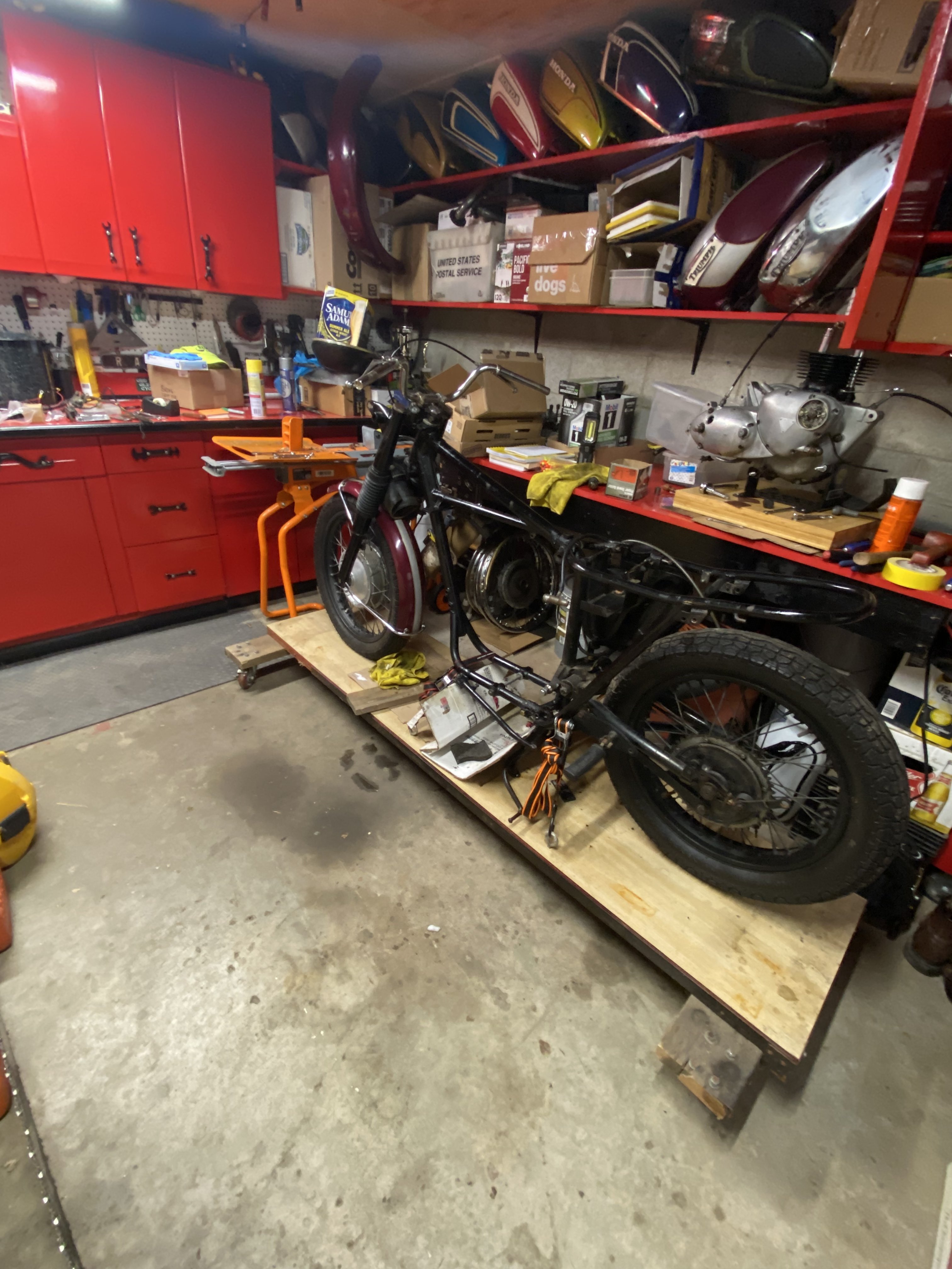

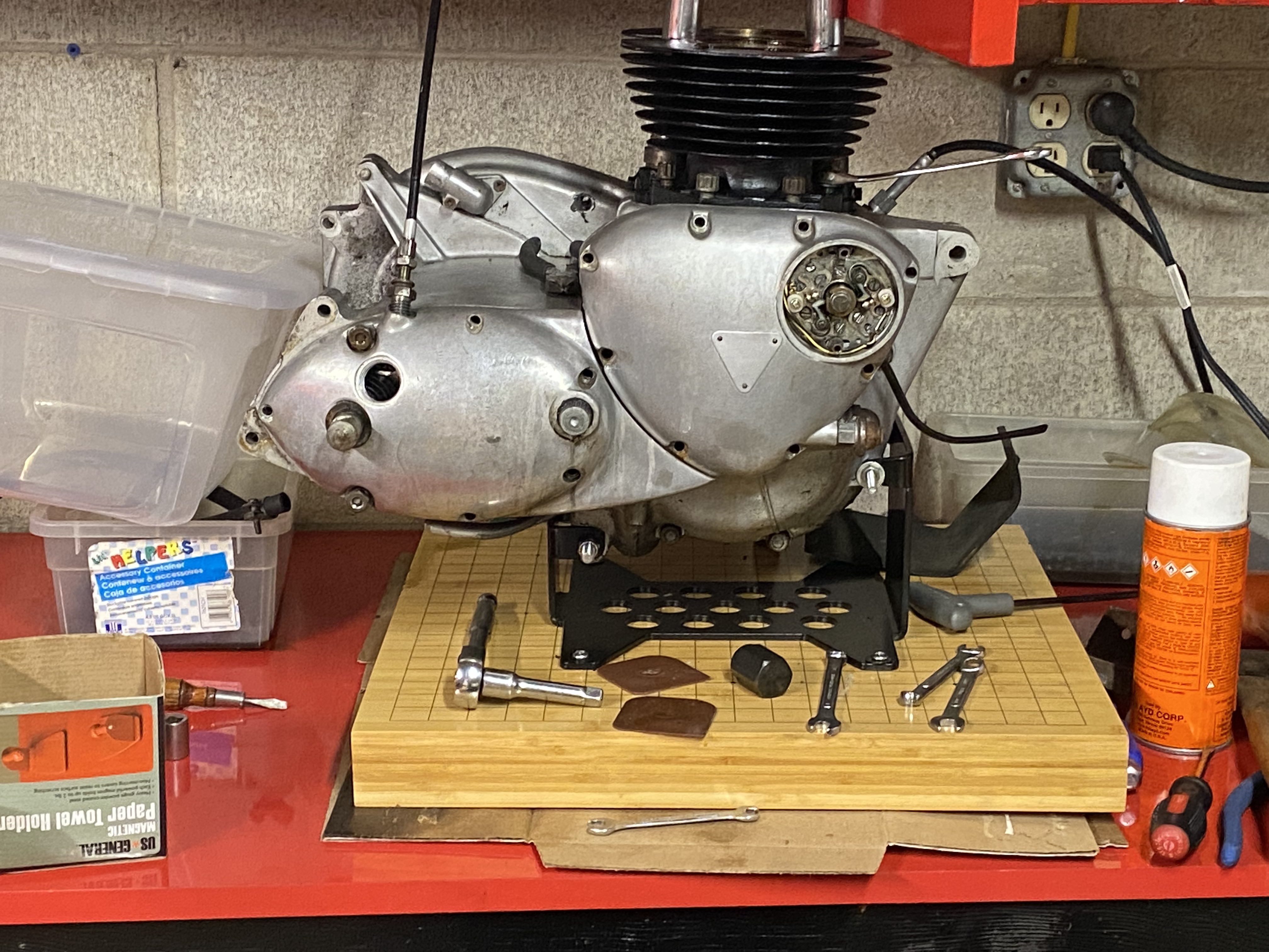

    Update on the 70 Bonneville. Engine out, wiring harness etc. off, will bag and tag tomorrow. Still leaning towards refurbish over restore. New wiring harness, I don’t think Triumph used lamp wire on the original lol. I do have proper rims, used but in better shape than the ones on it. Not sure about that yet. Scouring eBay for nuts and bolts/hardware to replace rusted with “used”. I want it to look used, not neglected. FEE28A98-BF20-4371-9201-84D01F9A846E.jpeg 3551A050-1D55-43D1-A689-3FAC8A8AA7B6.jpeg BA20EDDE-1872-4BBB-BB08-1E30C2B31BA3.jpeg 71EF8D0E-A021-4859-B98A-247FC084C188.jpeg 1A21E206-04B3-4FE7-9298-3966B71F1C06.jpeg BE736C21-5702-4DB0-BAB8-FAEFEC01BA0D.jpeg

    the 1970 will use standard SAE nits and bolts. if you want the original UNF O-O marks youll have to look harder, but sizes and thread forms are esy to match.

    I do have a question. I couldn’t get the motor to turn over to check compression because the stator and rotor were rusted together. It looks like a top end was done previously. The pistons are +.40 the cylinders are really nice. Can I just get new rings? I’m planning on full tear down to do bearings and sludge trap, would be nice to save some money if I could. THX
