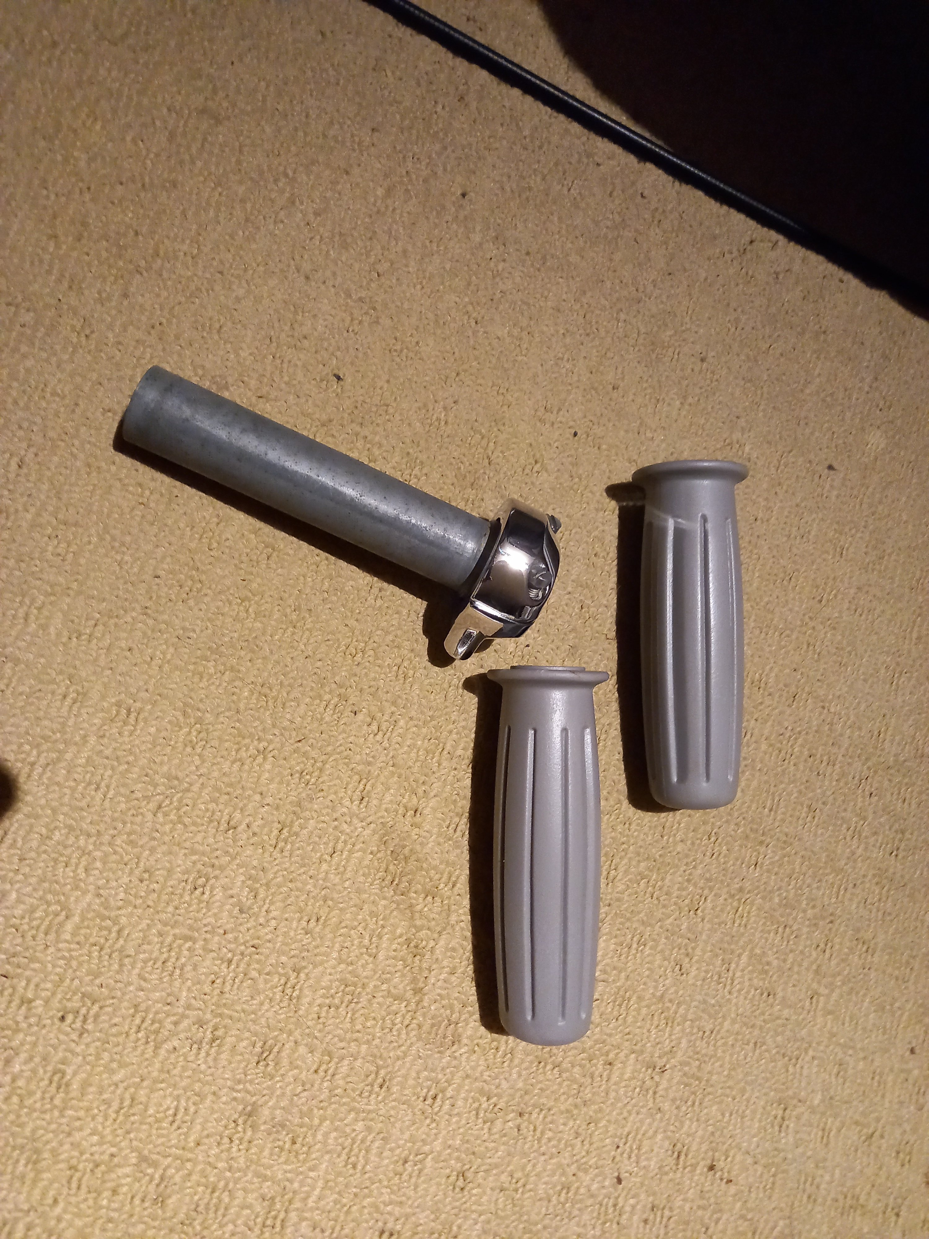

    Back on the TR6C now i have sorted a few other jobs, i found an old gen throttle in my bins and i had the housings re chromed along with some other parts, cleaned up the tube and sorted out some grips.

    I've always like those old school barrel grips, darkman. It's that "retro" thing....
  9. darkman
    7,639
    The grips are a copy of the original Amal grips fitted in 66 on Triumphs, i managed to find some original NOS Amals for my TT but have not managed to find another set so pattern will have to do until an original set turn up lol.

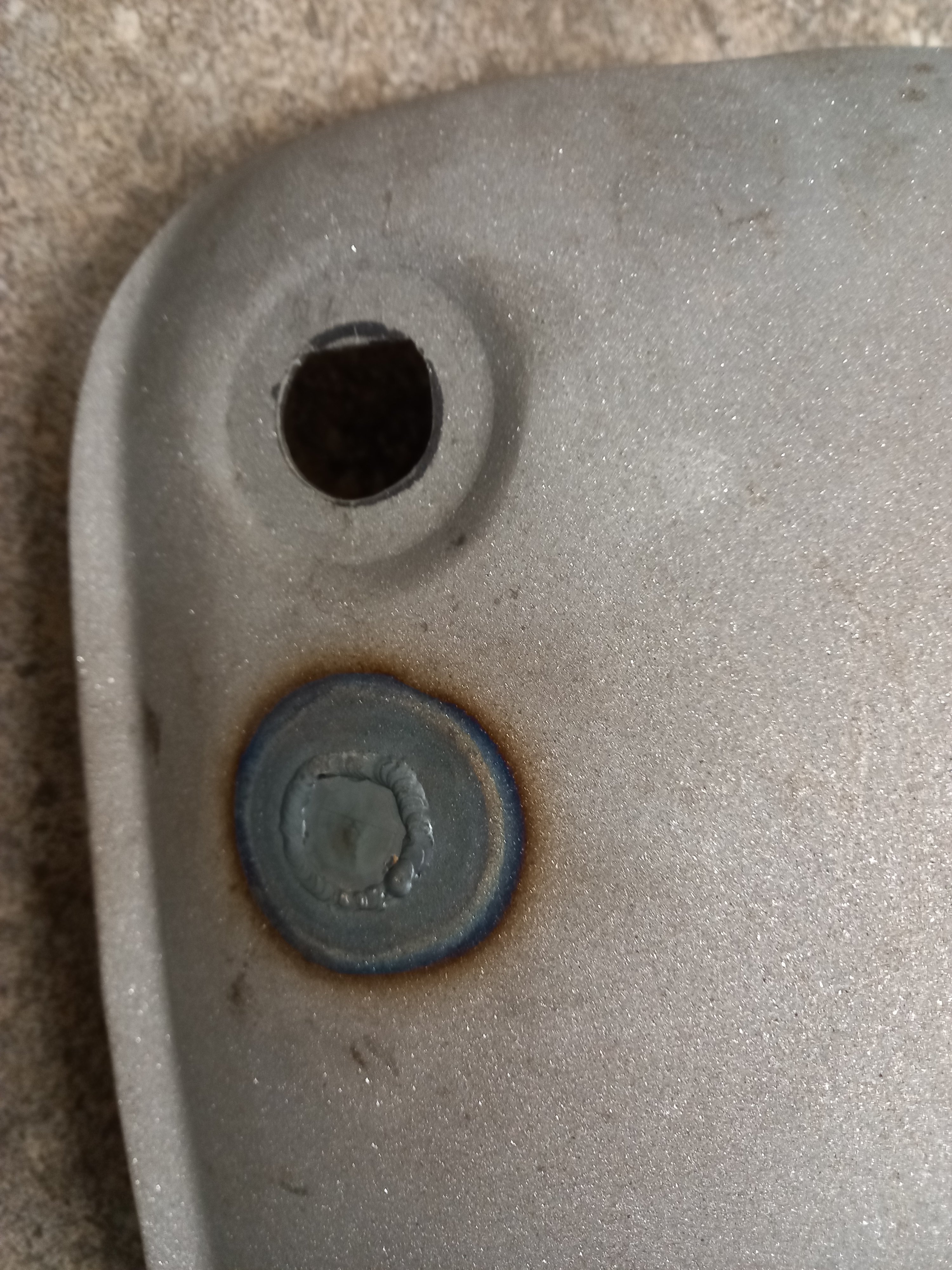

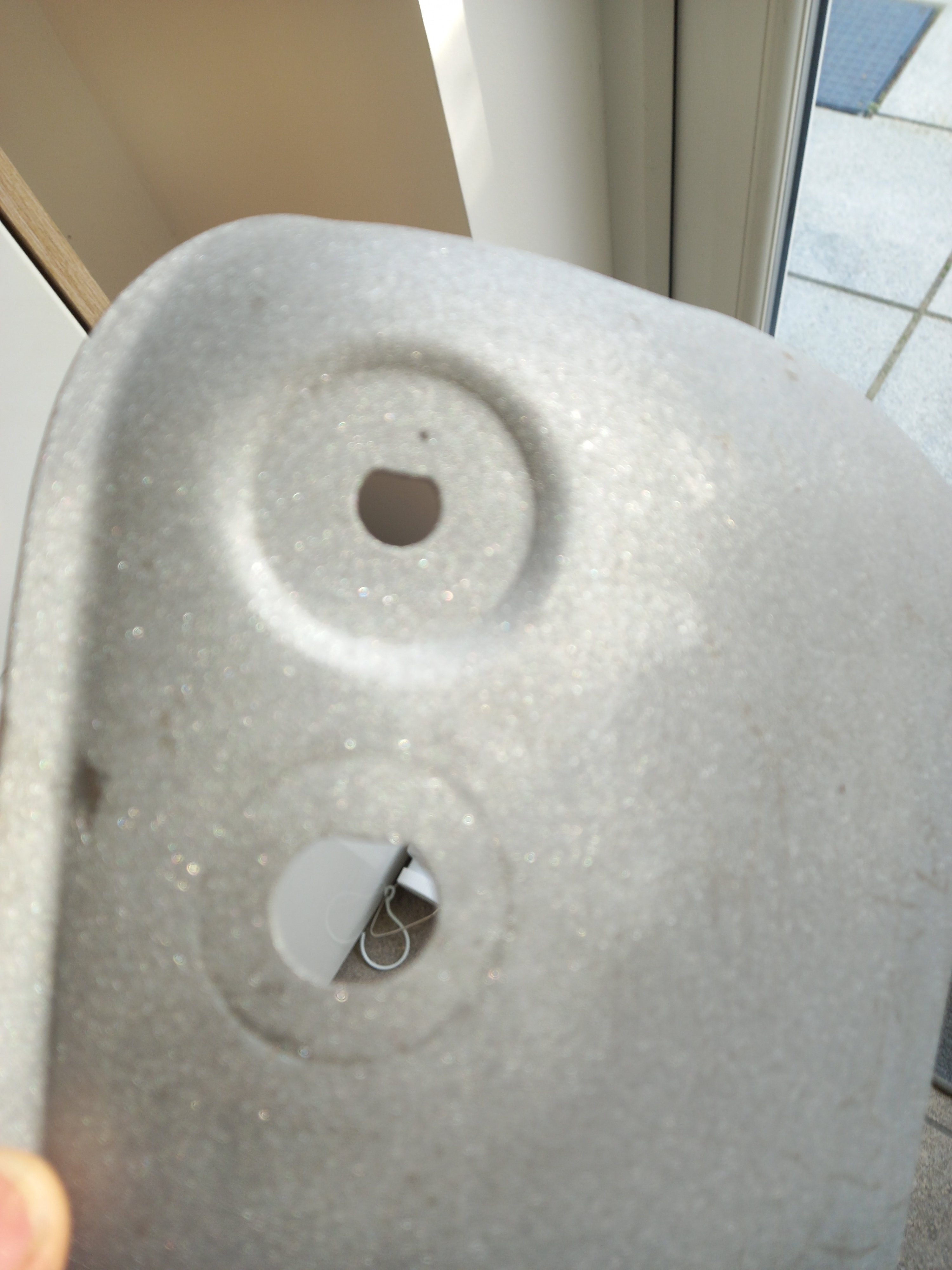

    After looking high and low i couldn't find the correct side cover for a TR6C with just the one ignition switch, so i dressed out the lower ignition switch pressing from an TR6R side cover and cut a new larger hole in the top pressing originally for the light switch so as the ignition switch will now fit, had the hole welded up in the lower part and its ready for paint :)

    Sad to see I am not the only one who has to deal with other peoples mess they make of their motorcycle, I have no idea why some one would take a thing of beauty and start cutting it up. Keep up the good work.

    If only my welding was so pretty. I'd leave it without grinding down to show how great I was :)

    heavens yes
    i was looking at that saying, if i tried that id weld that hole three times larger in seconds
