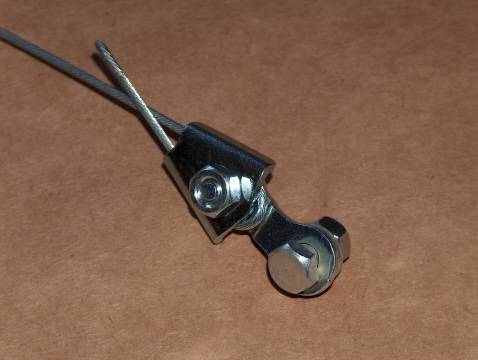

    The internal cable/protrusion length is the critical length , too much and you can't apply the brakes , you need to make a spacer to take up the slack or a new cable with the correct protrusion length
