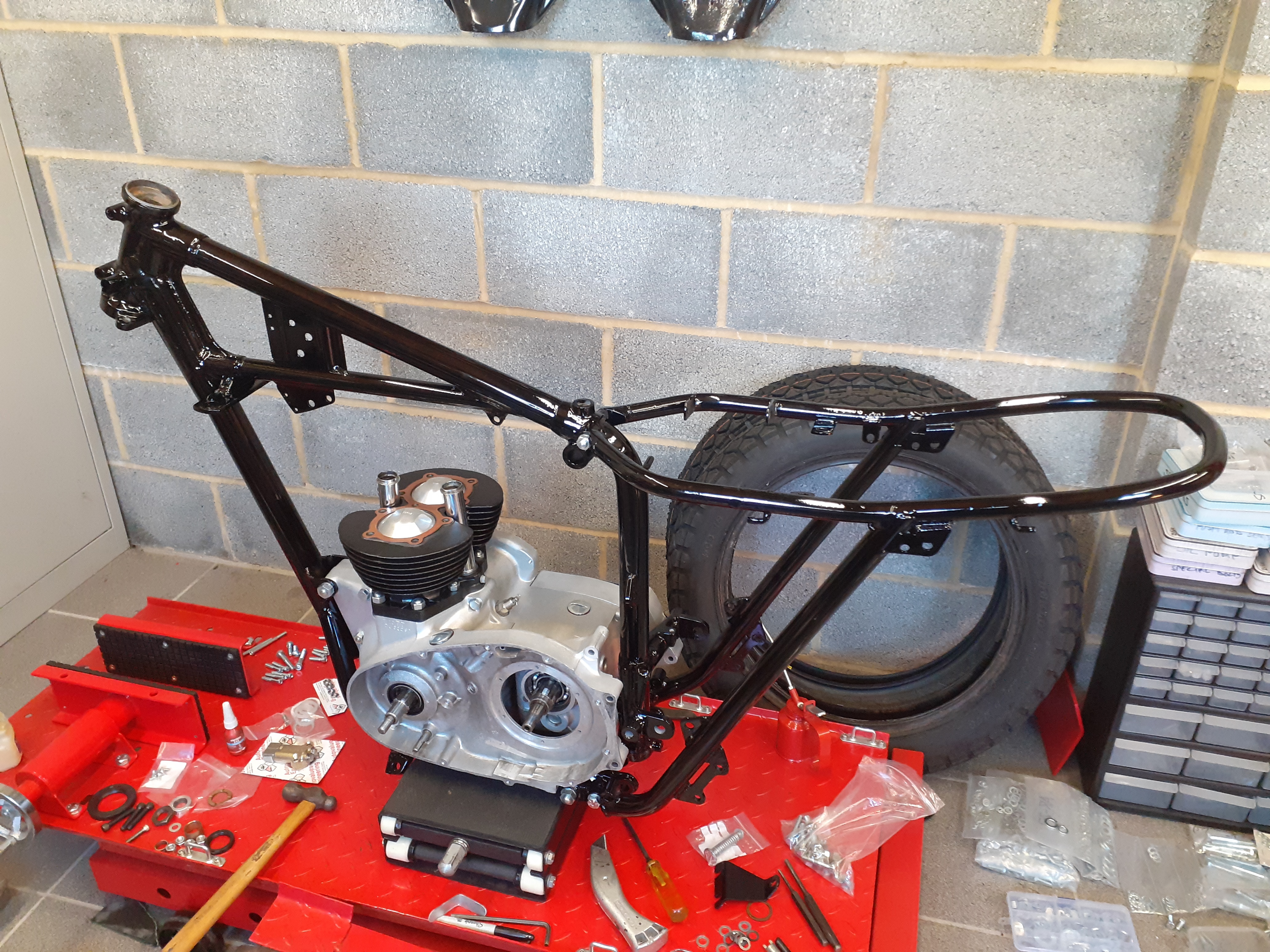

    Another step forward with fitting the painted frame together and getting the bottom end back in and on the bench ready for final assembly.

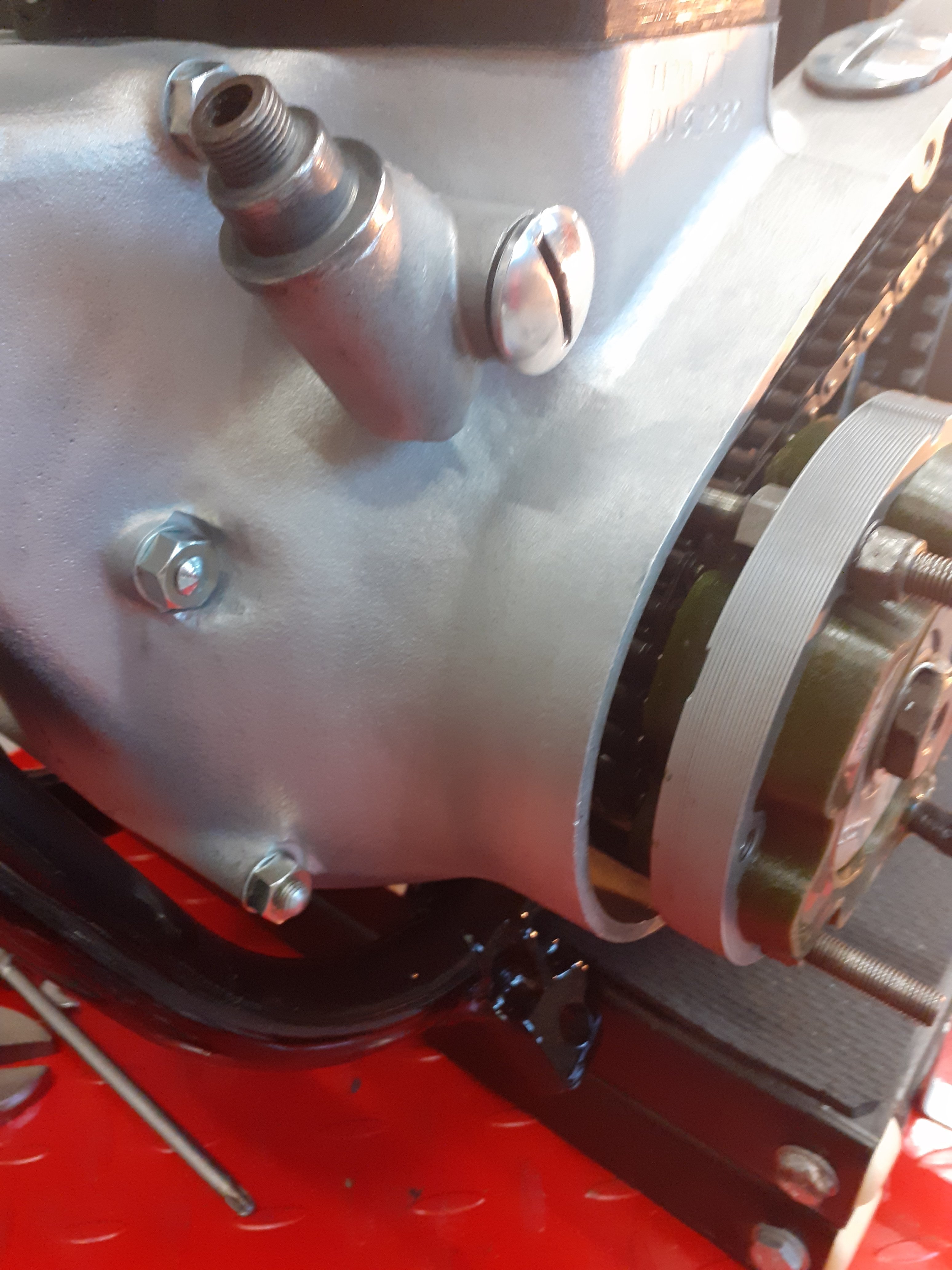

  3. darkman
    7,639

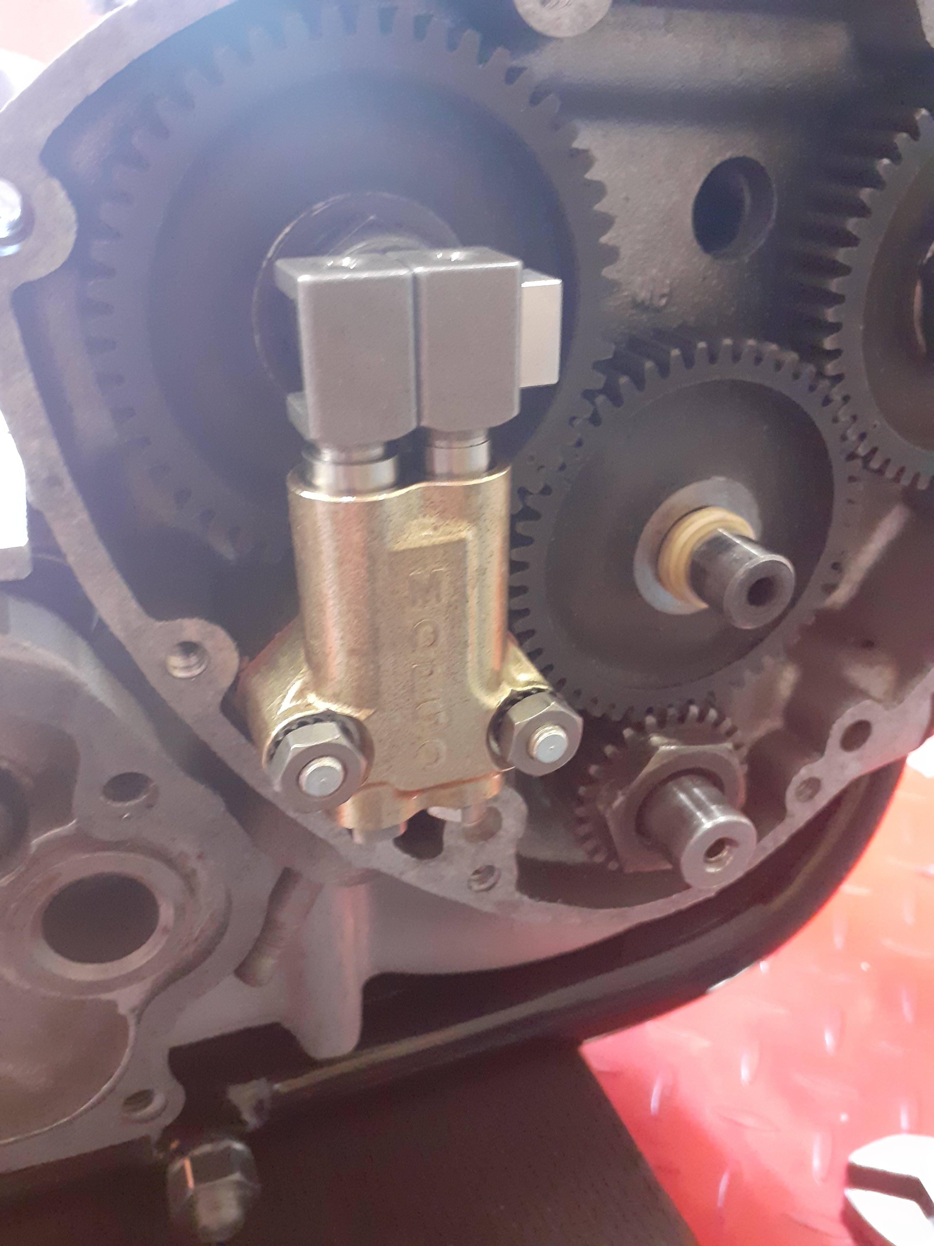

    New oil pump fitted along with new seals n gasket and found a right hand thread screw for the rev drive so i could fit that as well and finish off the fitting of the new clutch n primary chain.

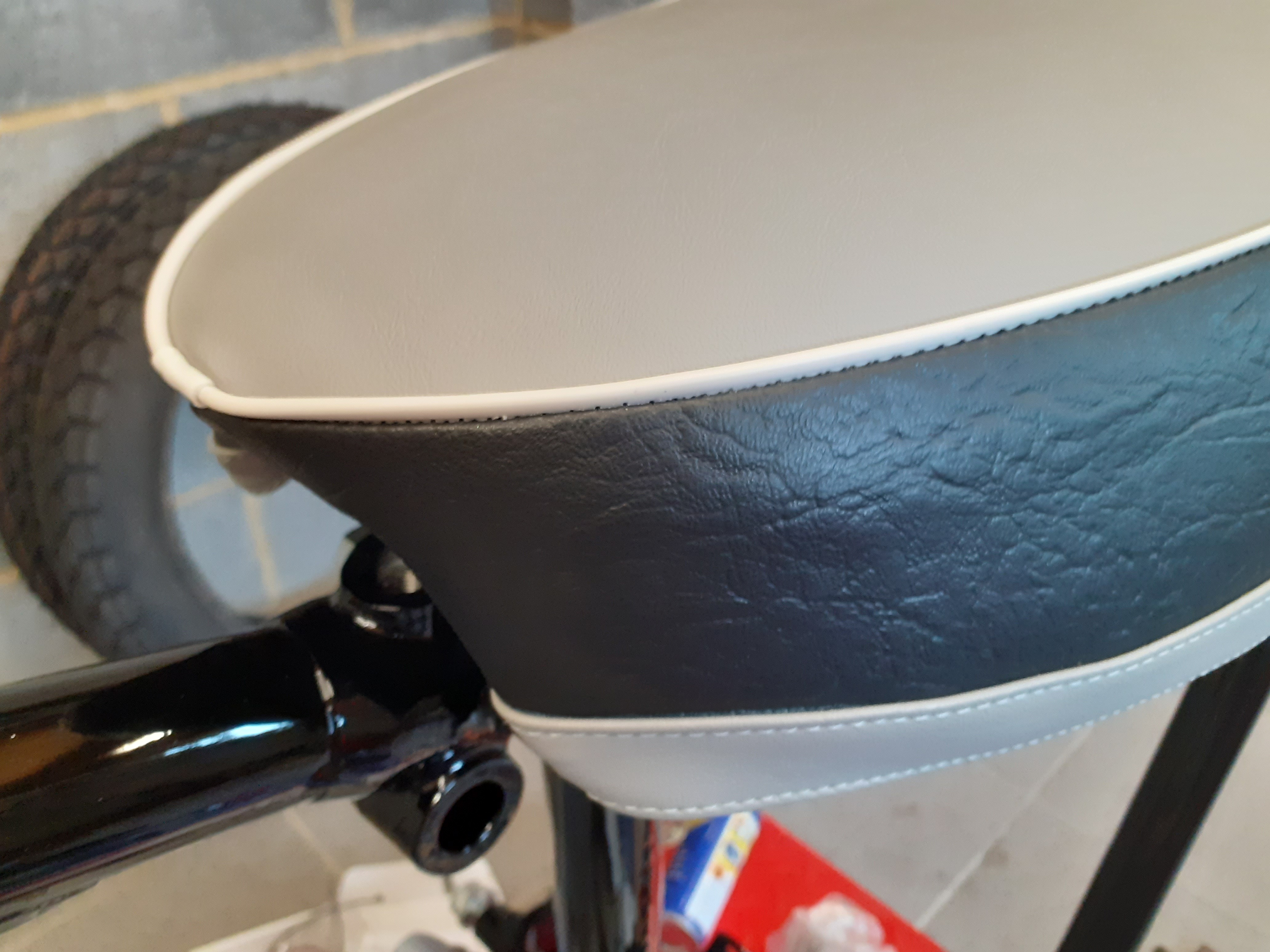

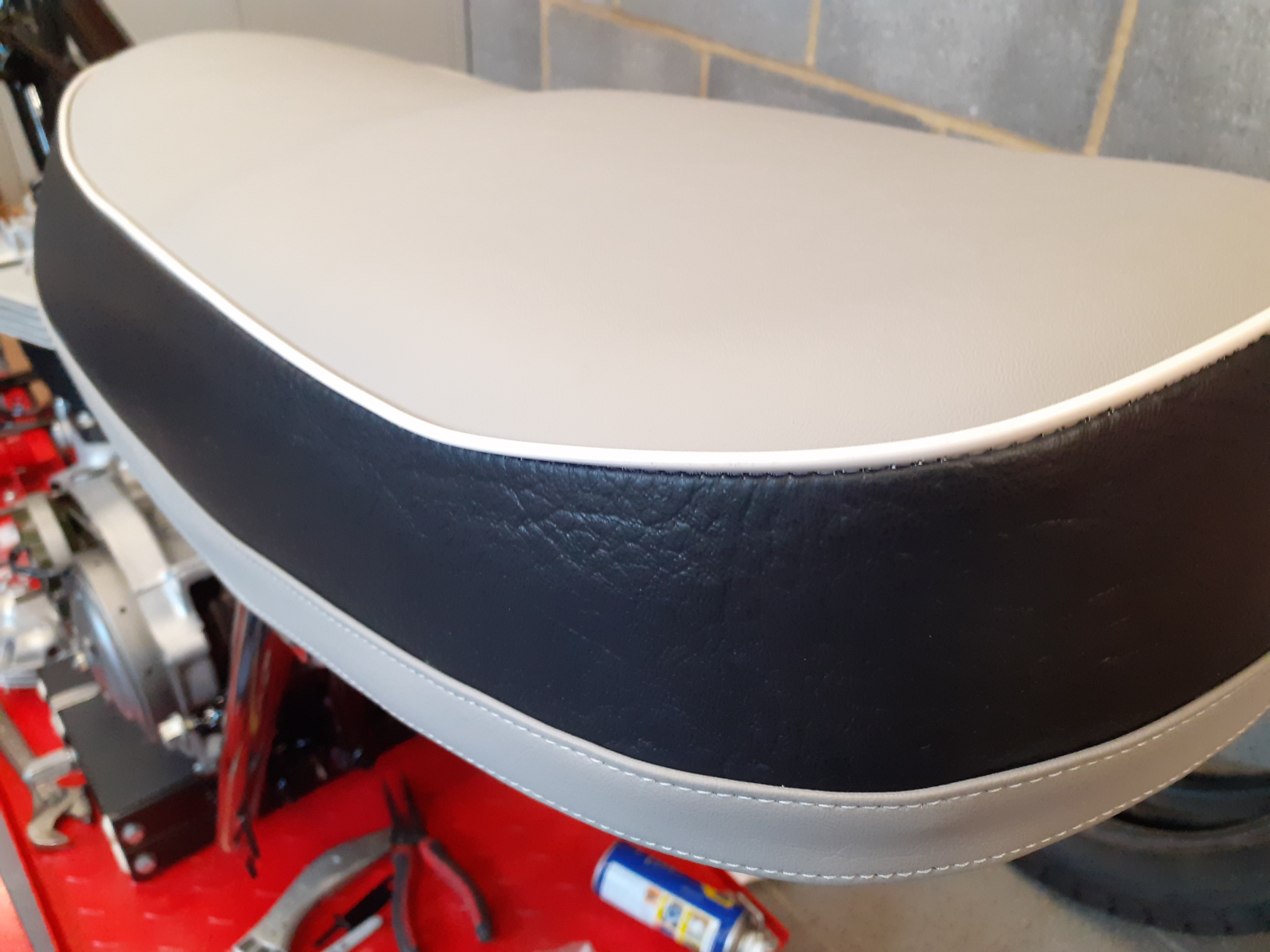

    Seat pan painted and posted off to R K Leighton for the correct cover to made n fitted.

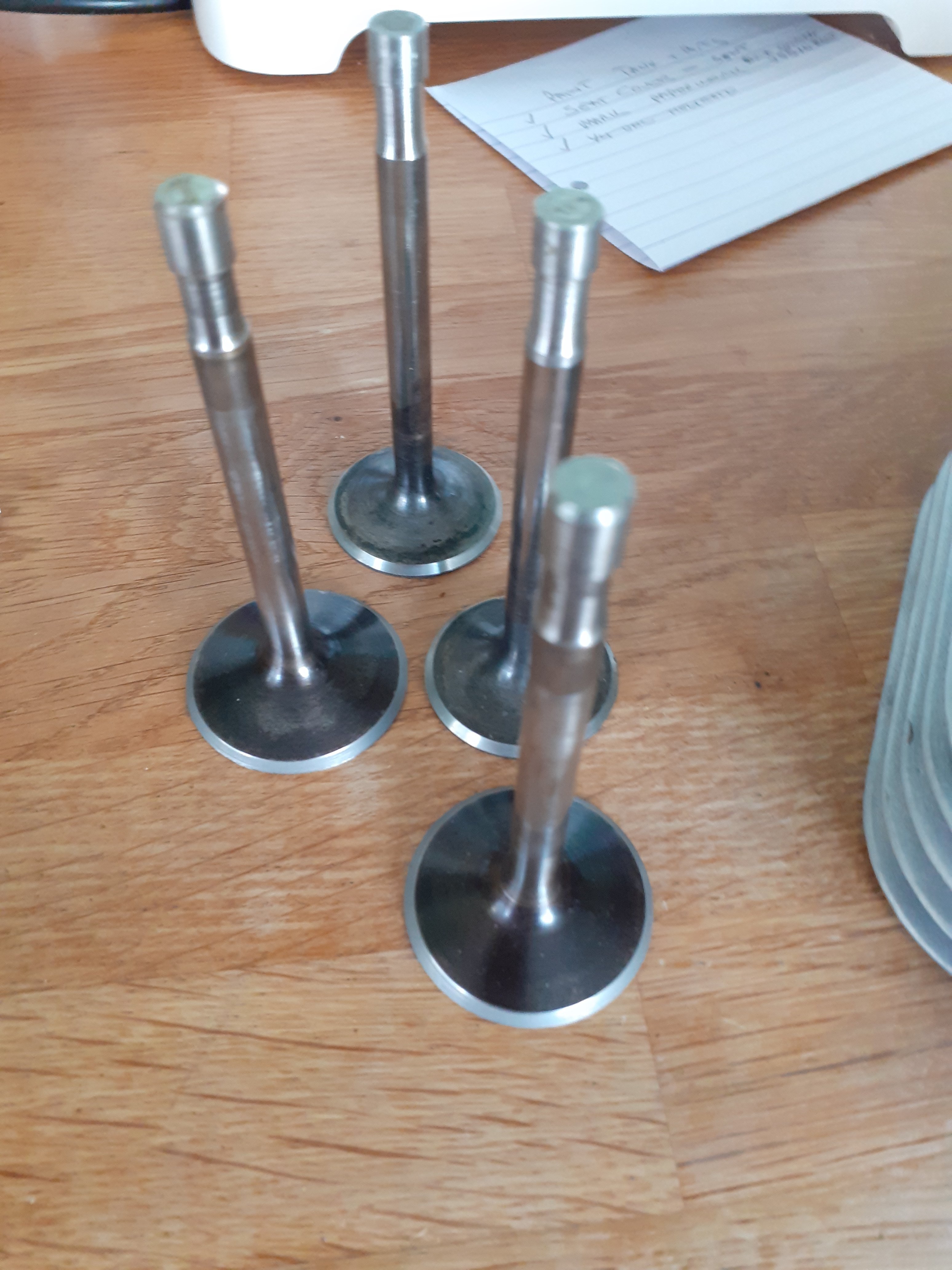

    7,639

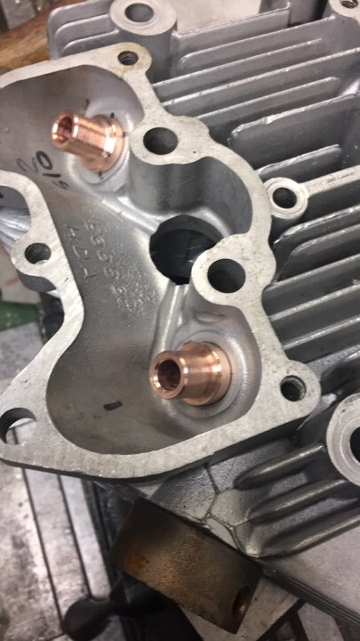

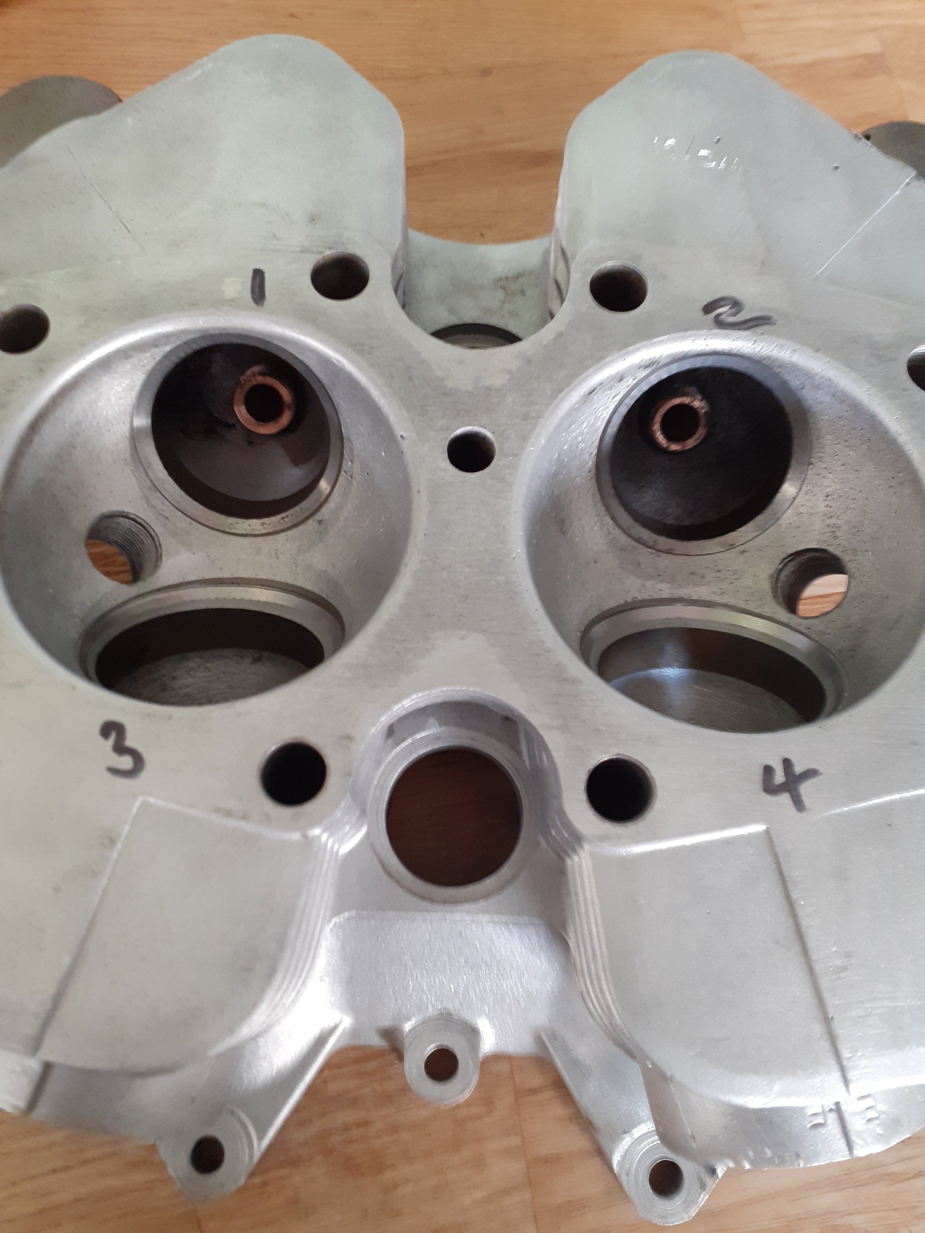

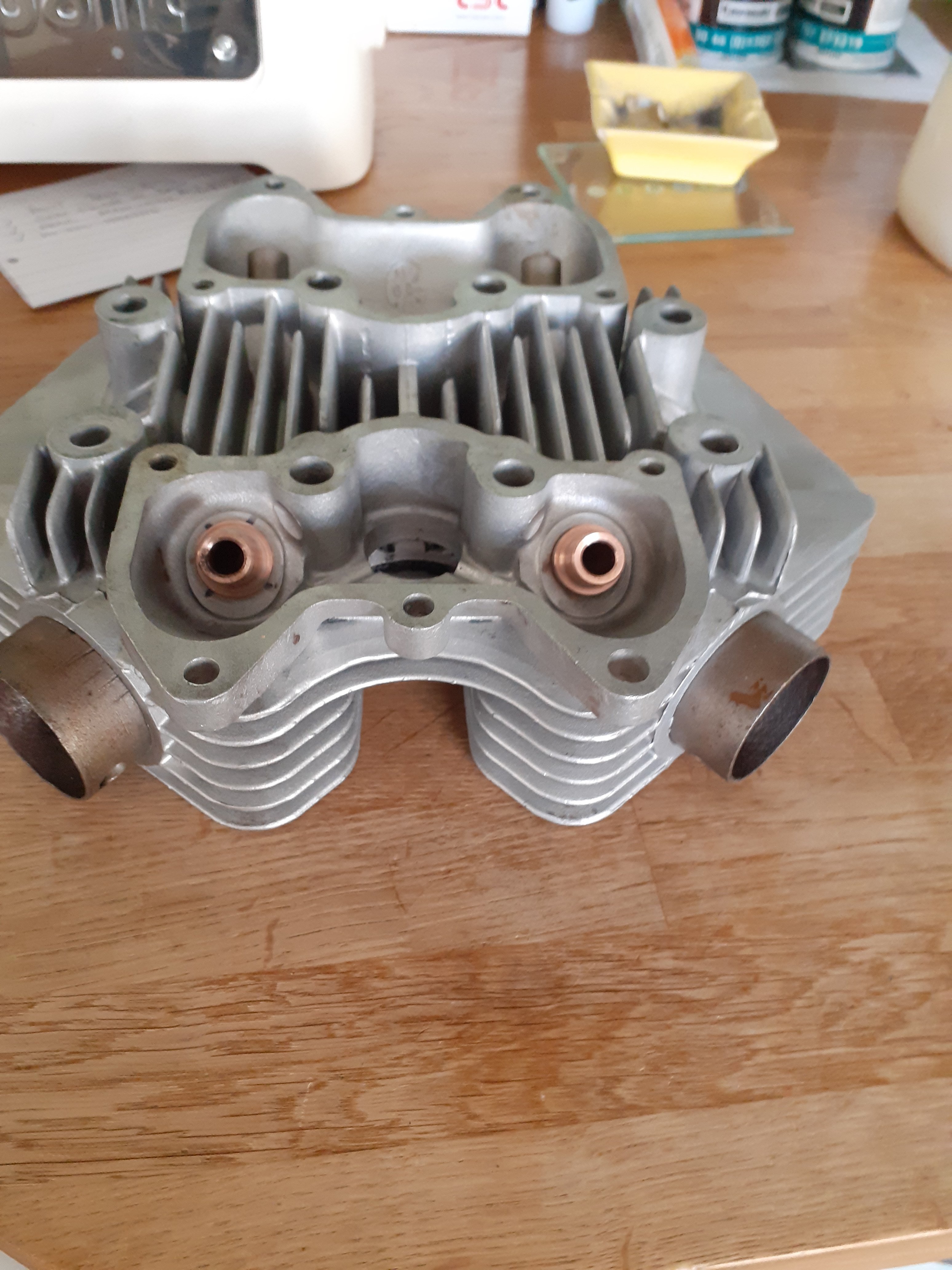

    One exhaust guide was cracked and my mate sold his valve cutting machine so Dave Waddy is doing the work for me as it needed an oversize guide as well.

    Sorting out some nice shiny parts for the build today :)
  7. darkman
    7,639
    Cyl head back and all done along with cutting seats n valves :)

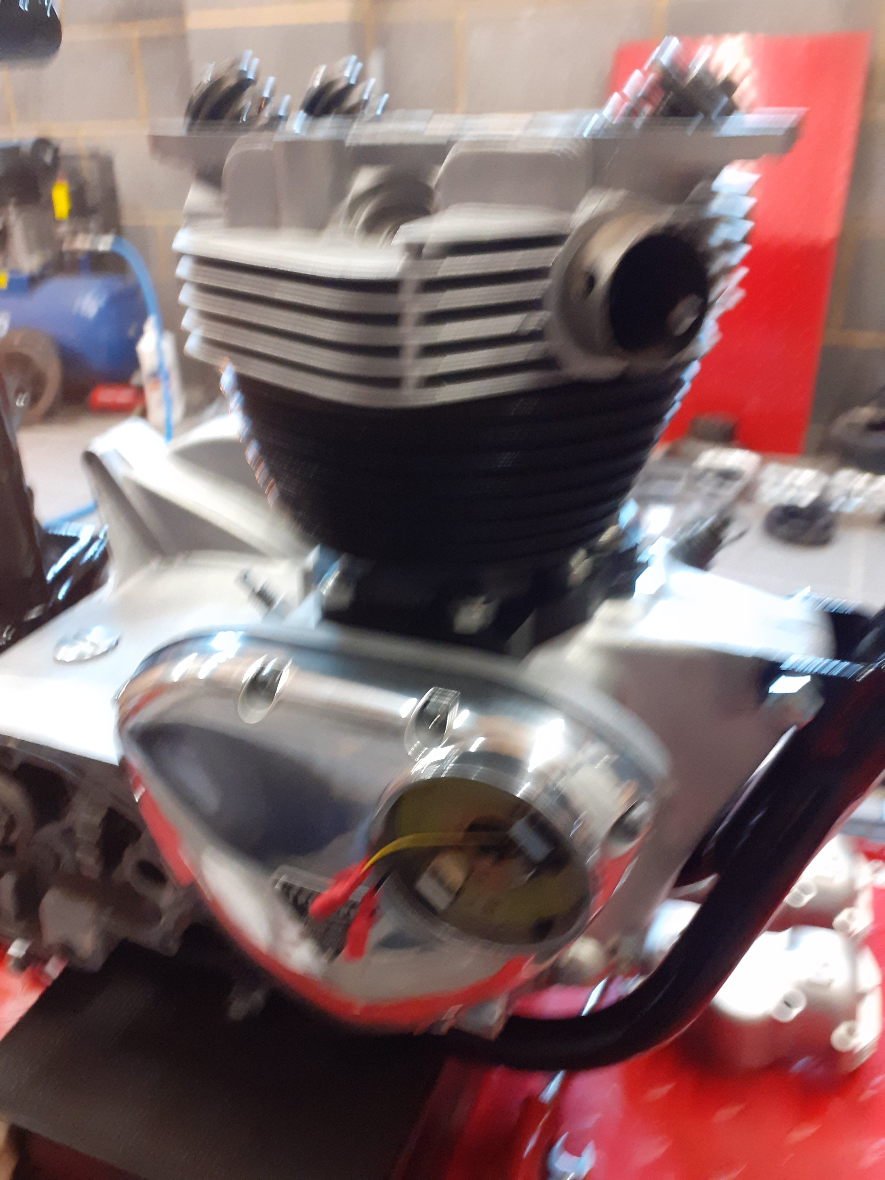

    7,639

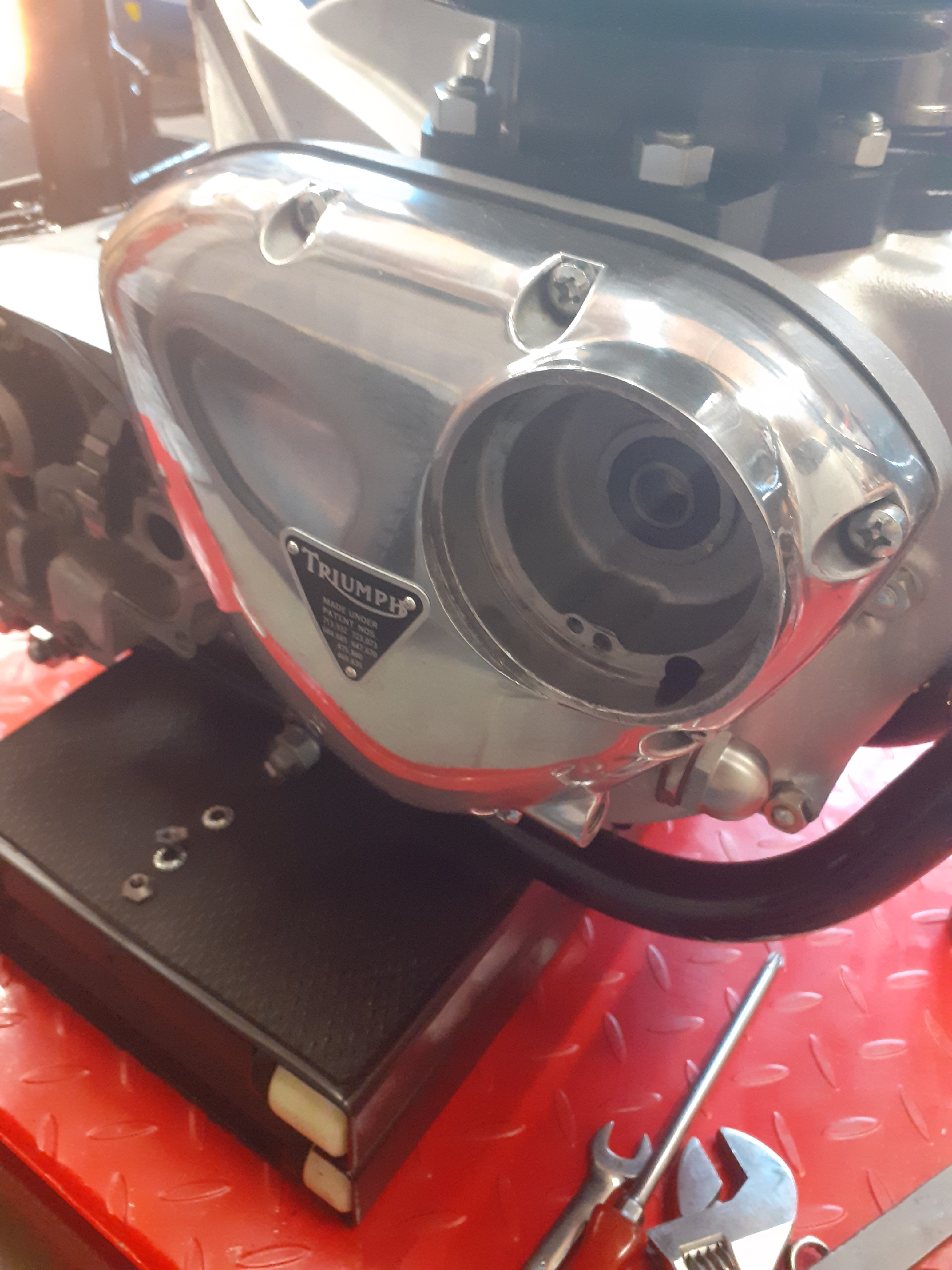

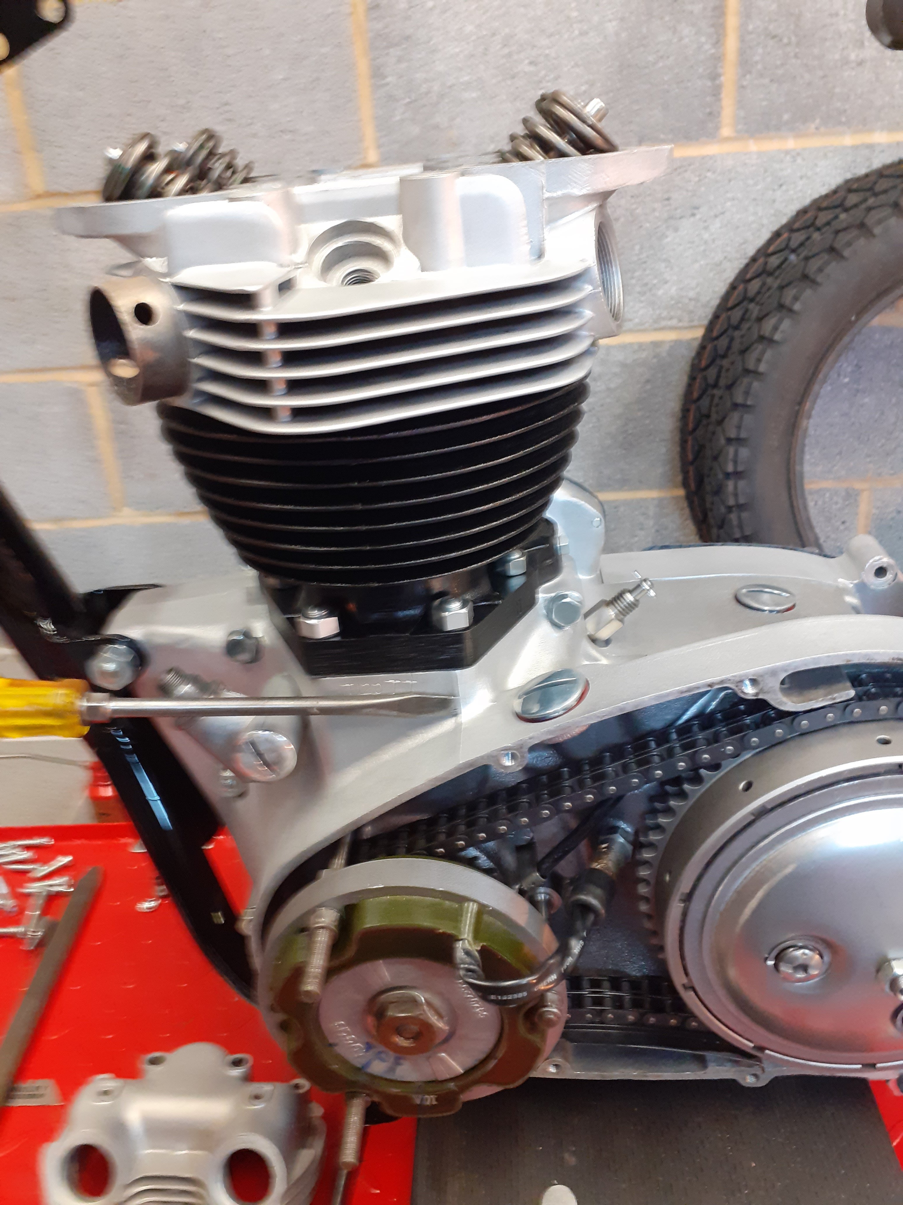

    A bit more progres today, fitted the newly cut valves with new springs to the cyl head and timed the new electronic ignition trigger unit so i can fit all the outer covers next ready to bolt the head on and engine is finished then.

    One good bit of news the seat pan i refurbed n painted is back from Andrew at R K Leighton recovered in the correct material unlike all the repro covers available online and it's a beauty :).

    R.K Leighton, been in the business of seat recovering for donkey's years, and it shows, I'm feeling better already Darkman, thanks!

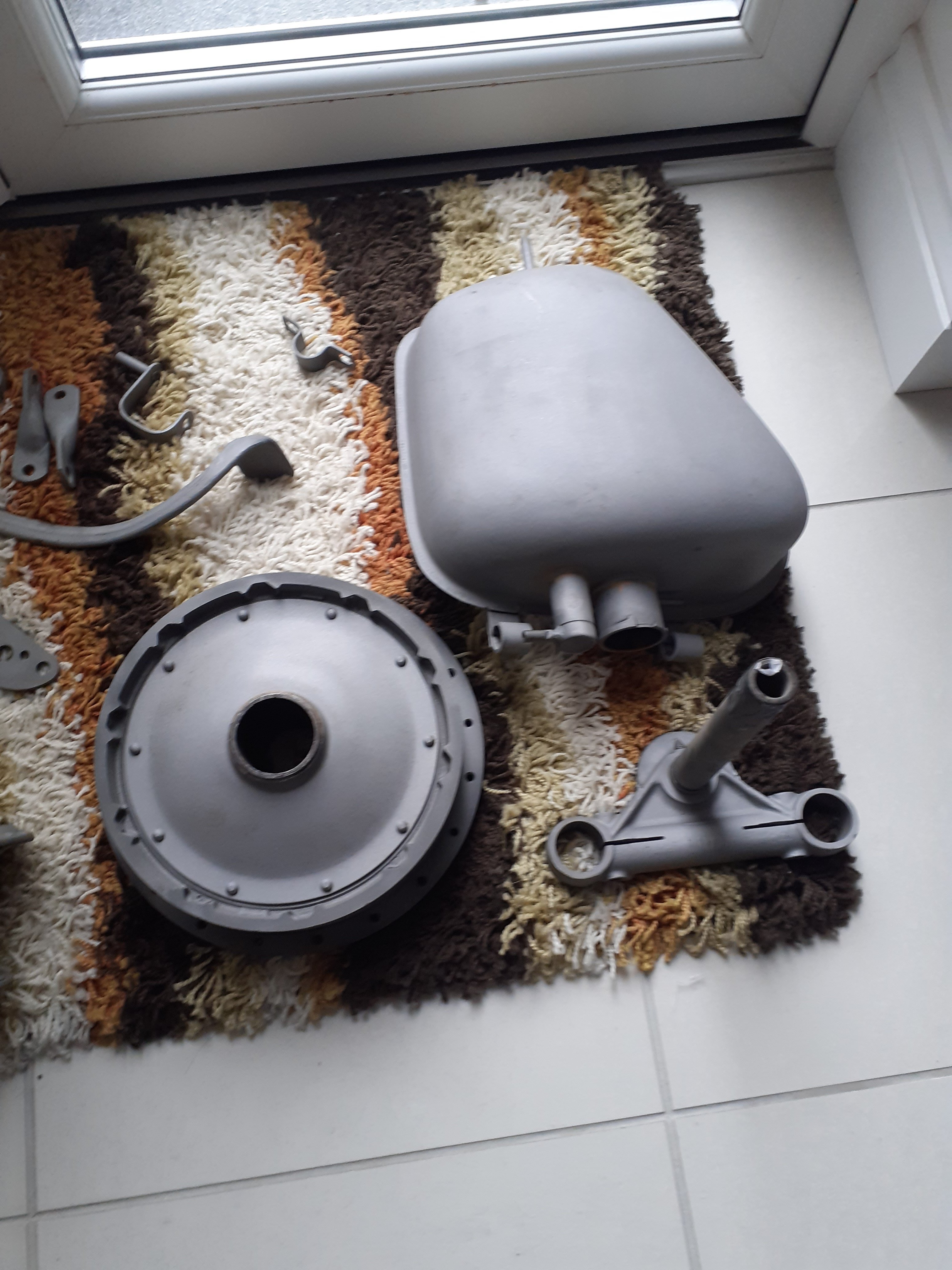

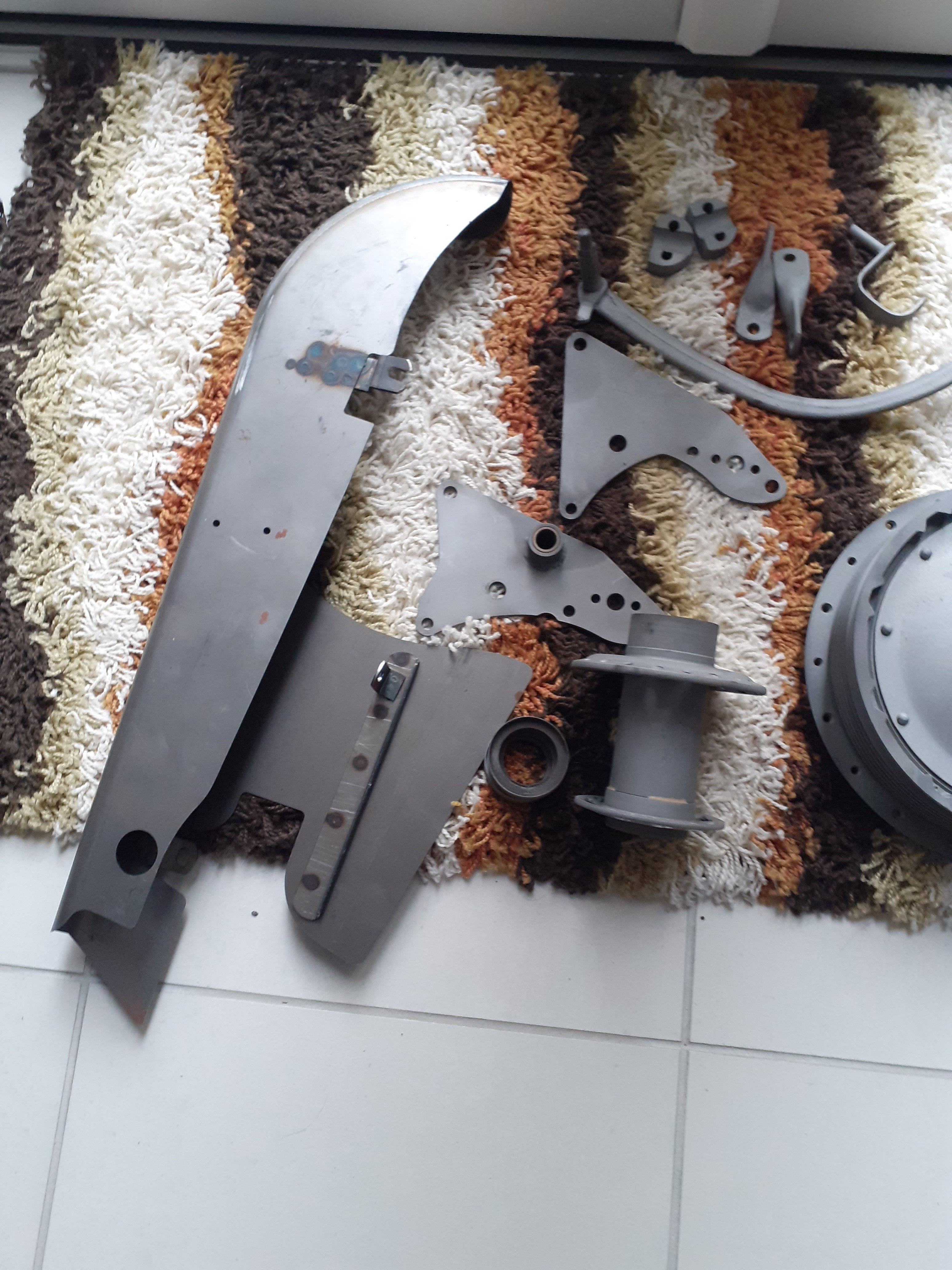

  15. darkman
    7,639

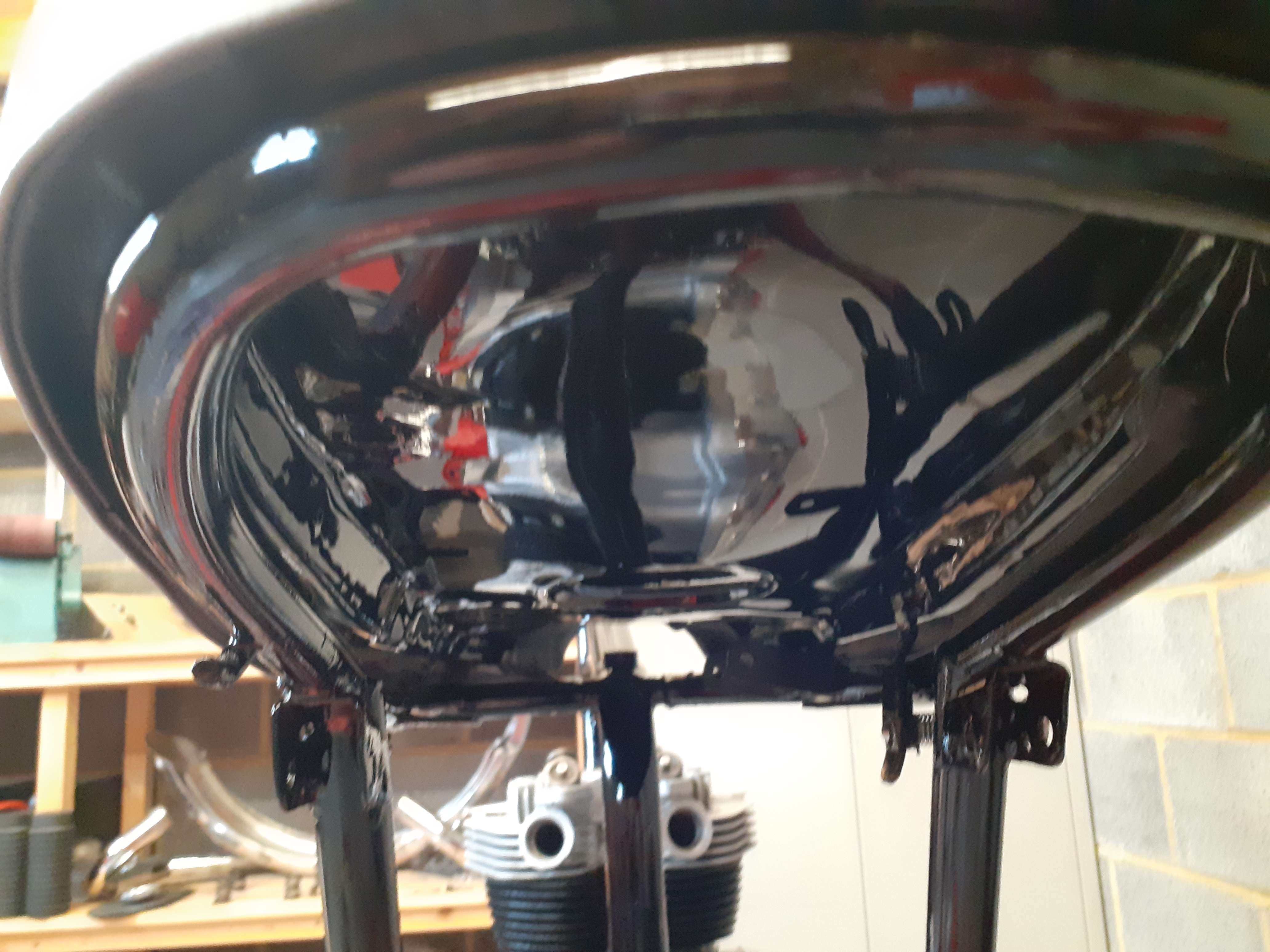

    Still have some paint to do but hope to do this next week.

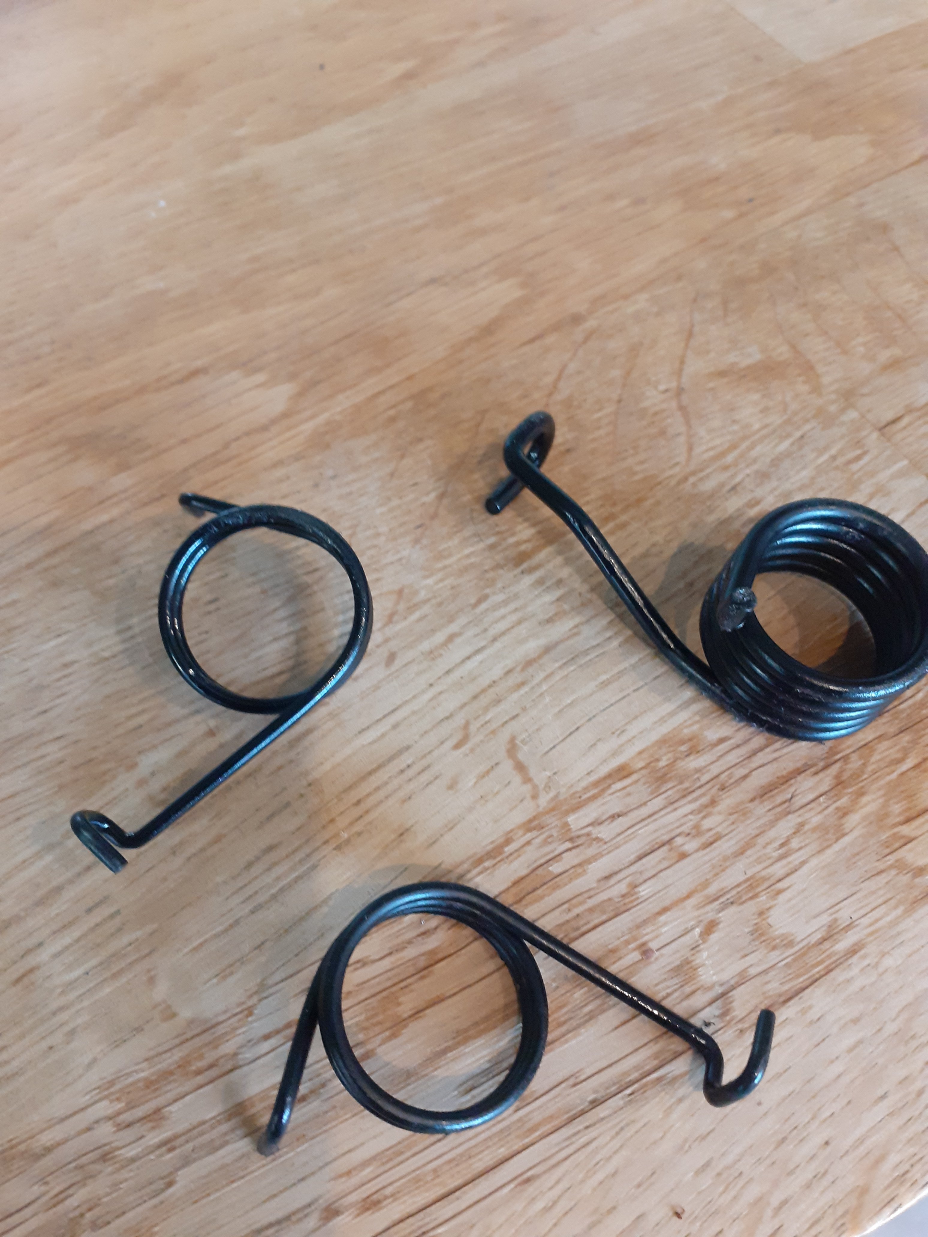

    On the later bikes the return springs are mostly in cadmium, not sure of the years yet but on early bikes they are black so i had these plated black for that original look :)

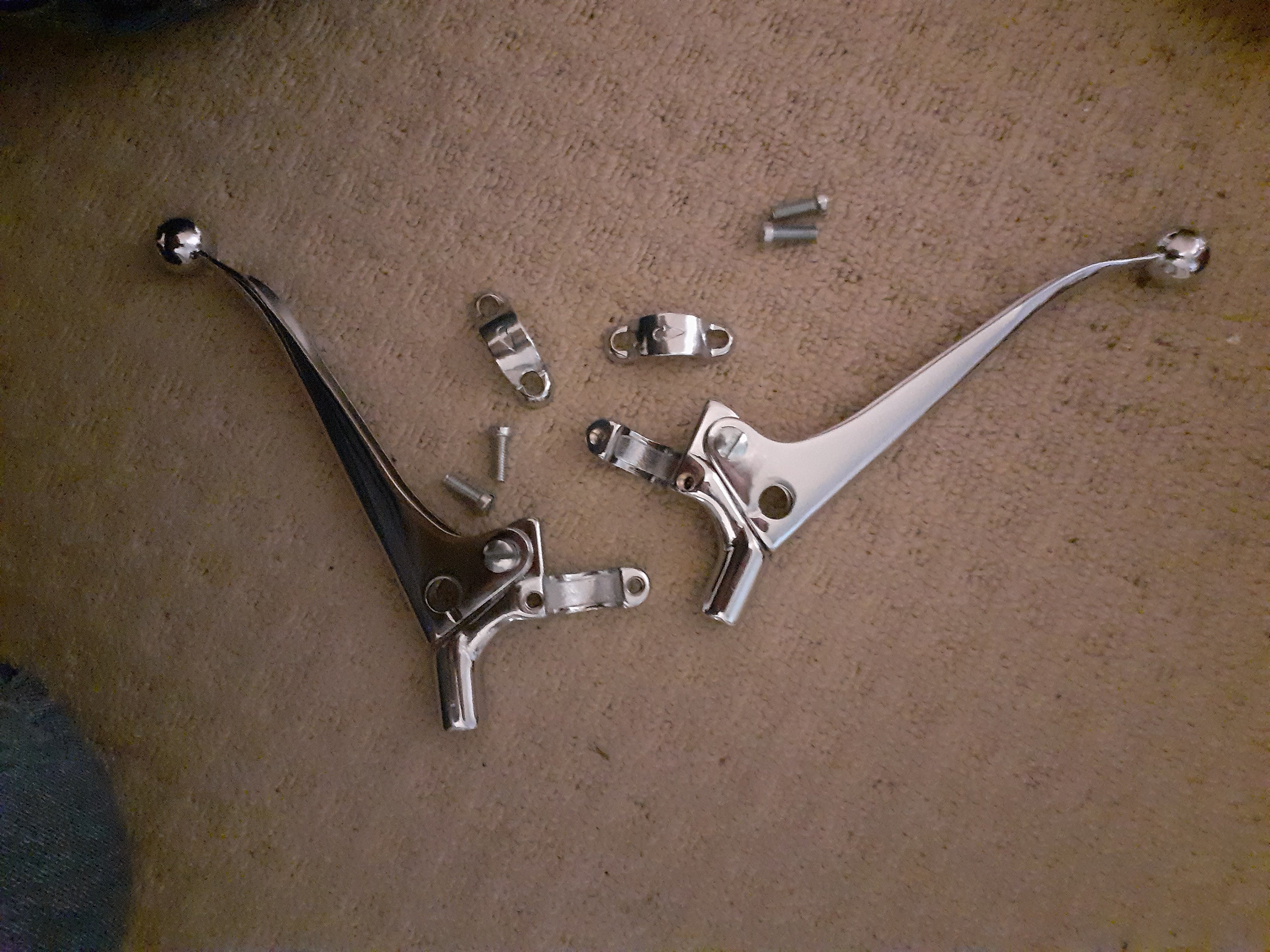

    Although in a queue its a further projects one, it's a MB10 rear Dunlop that i picked up at an auto jumble :) Hopefully all chrome parts will be back from the platers soon so i can post pics :)
