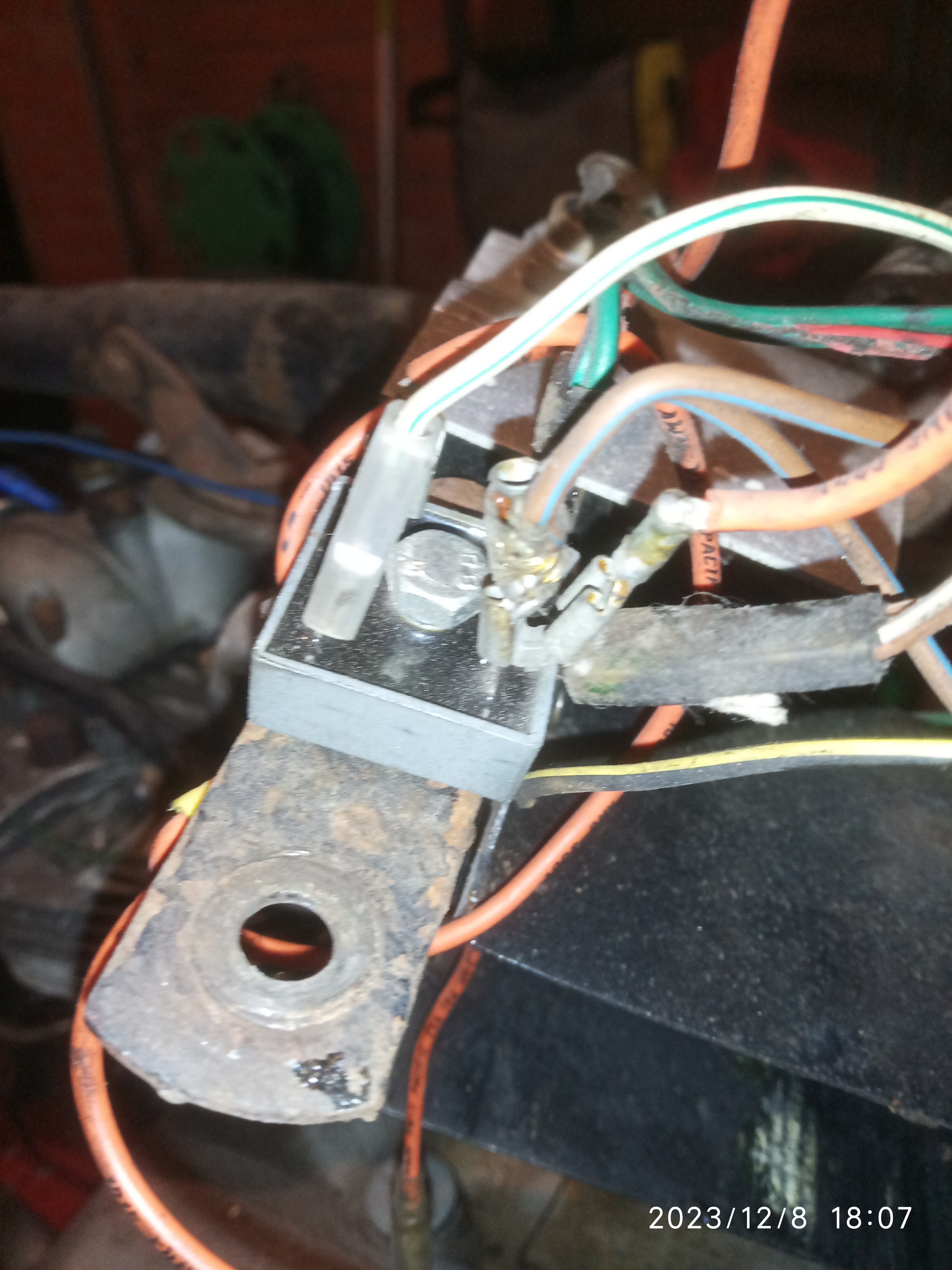

    Back in the day I converter it to 12 volts using this rectifier module. The wiring will need a lot of work and hopefully this photo might help get the wires to where they need to go...

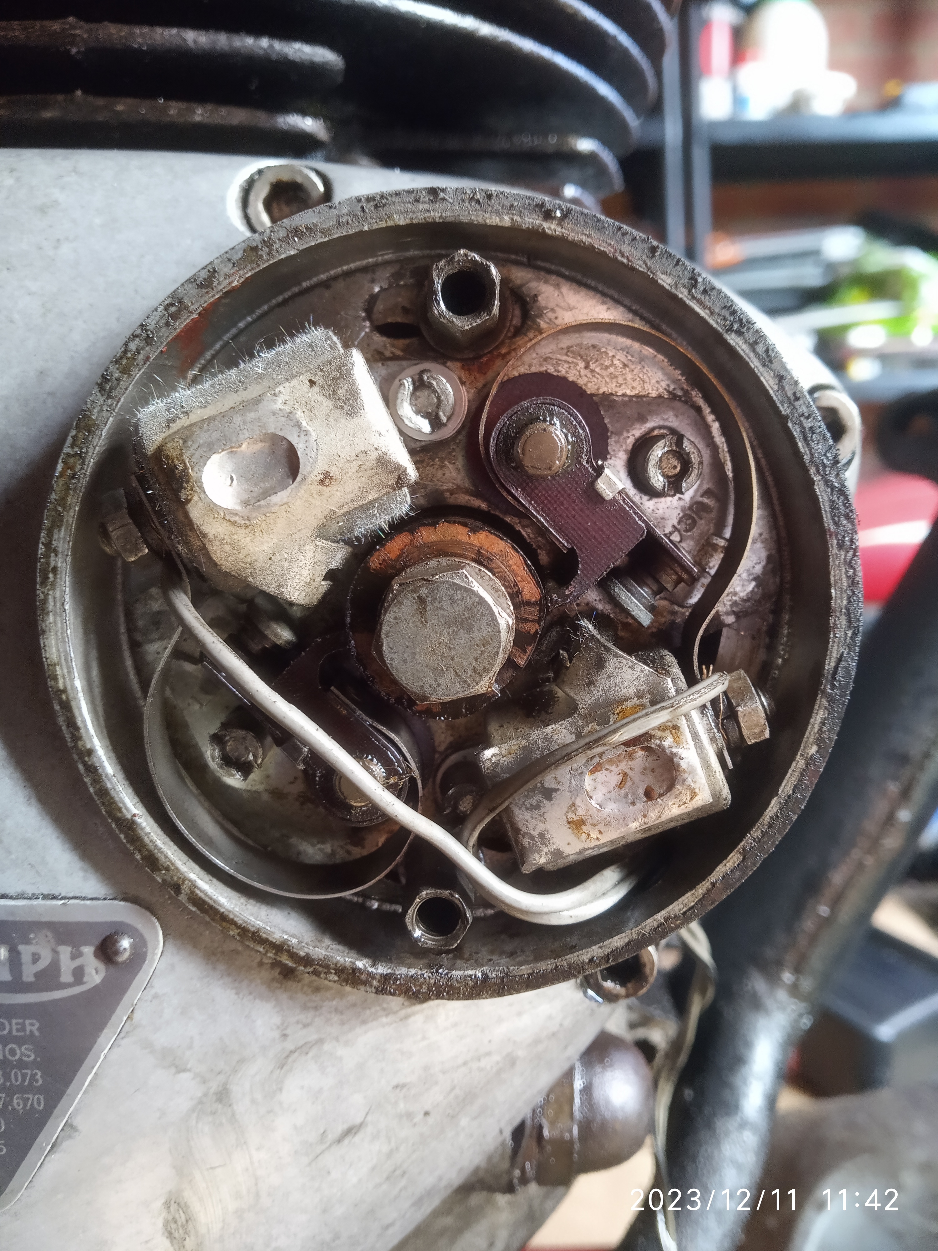

    Thought I should take a photo of the points at TDC before taking them off. I can't remember if the cam has a key or it is just on a taper...

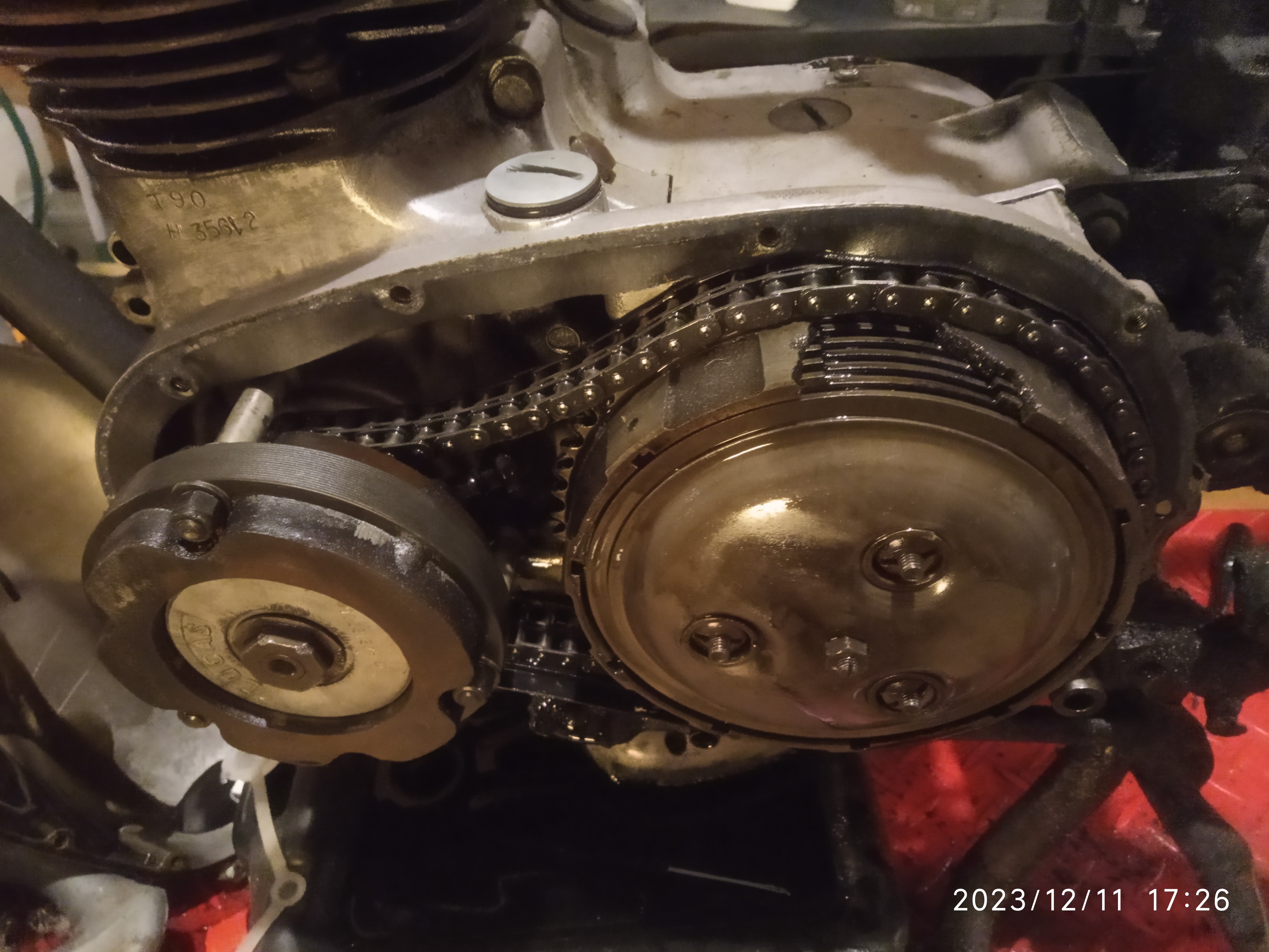

    Took the head off today and the primary drive cover. 40 years ago my brother and I managed to break a segment and some teeth off the clutch basket as you can see in the photo. It's been running like that all this time!

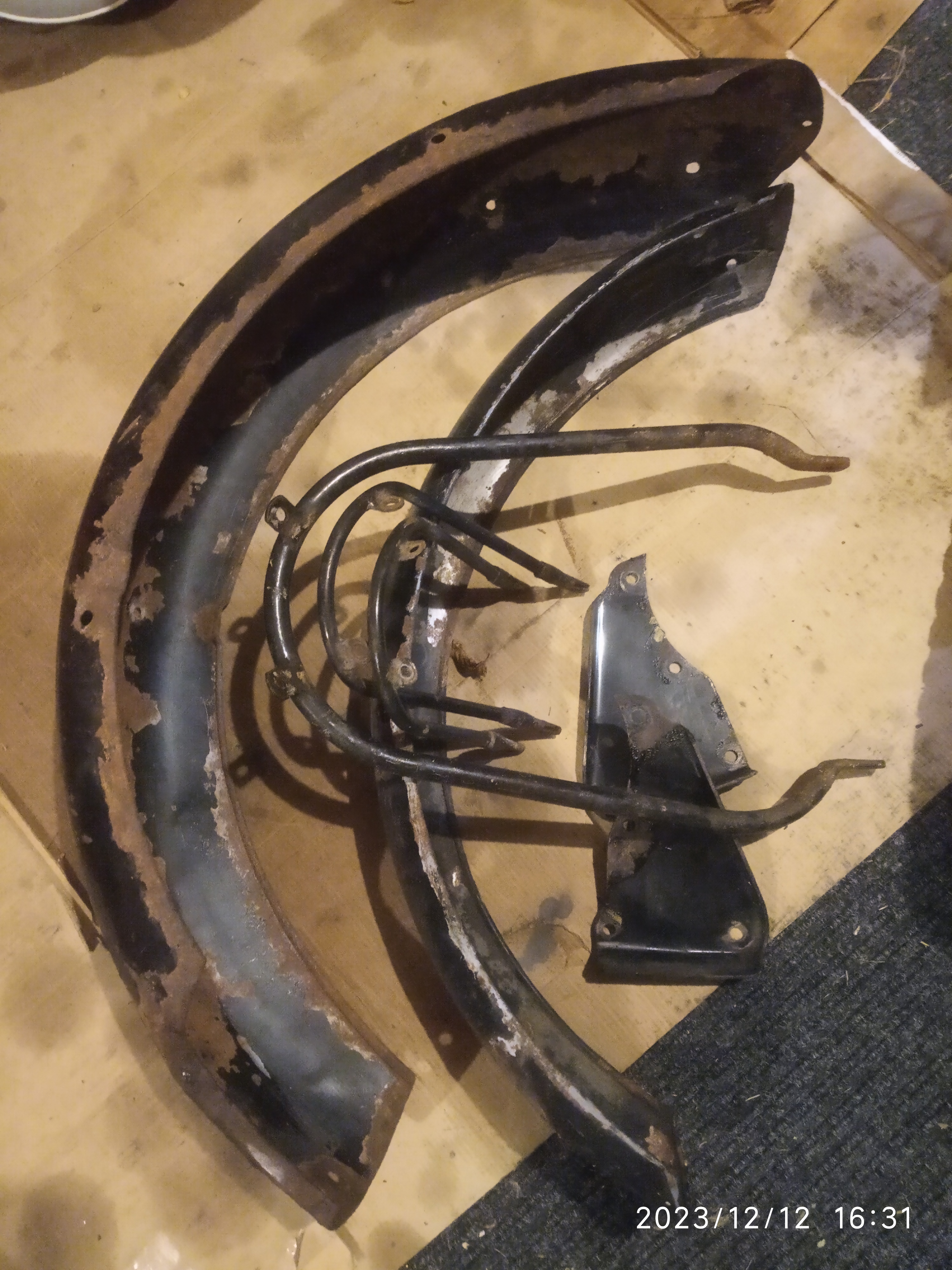

    Odane came round to do some cleaning but after much talking didn't actually do anything. I had piled up the rusty parts to go for shot blasting but he thinks he can sand them. He took the rear mudguard away to do in his garage. Good luck with that!

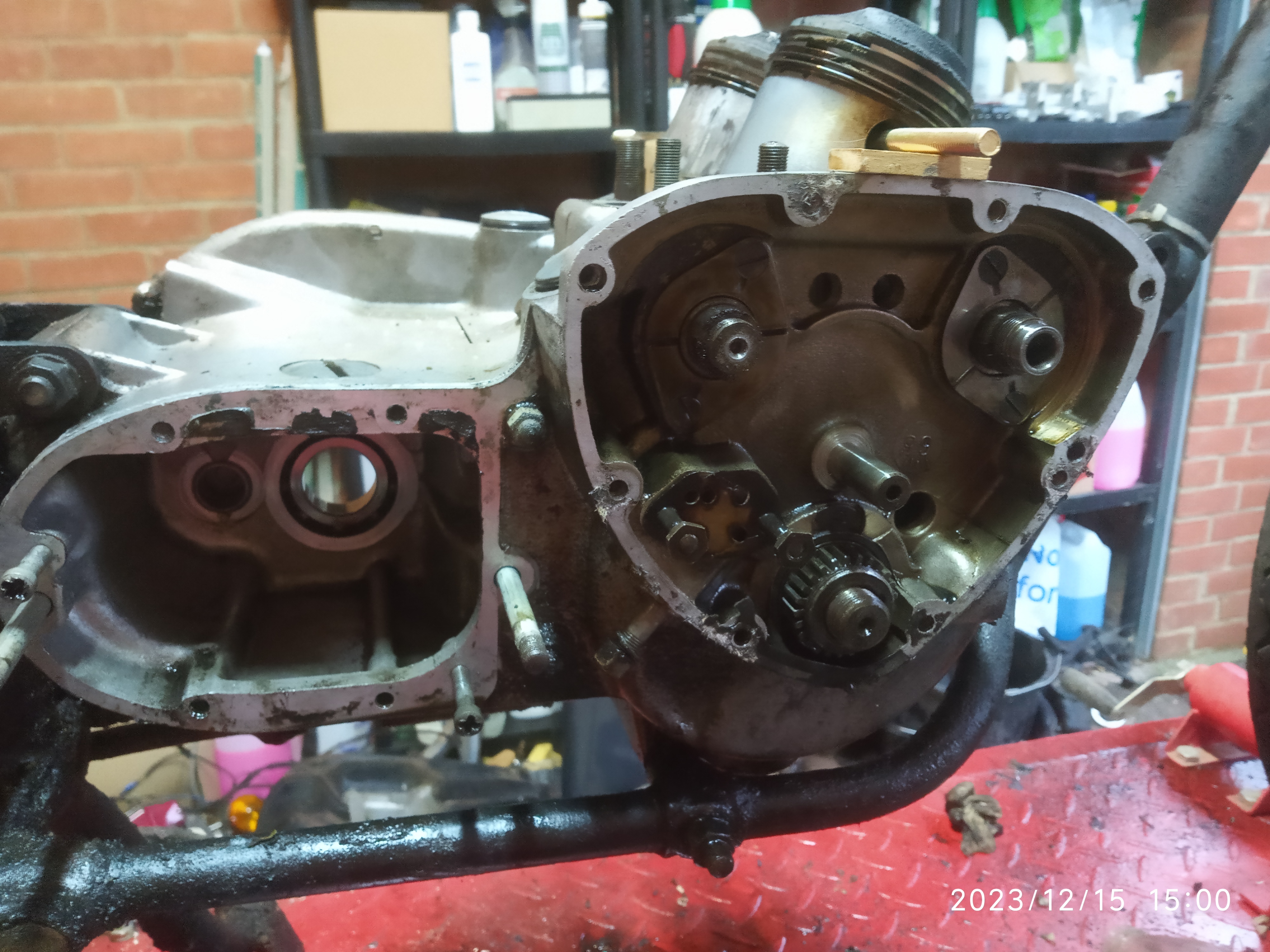

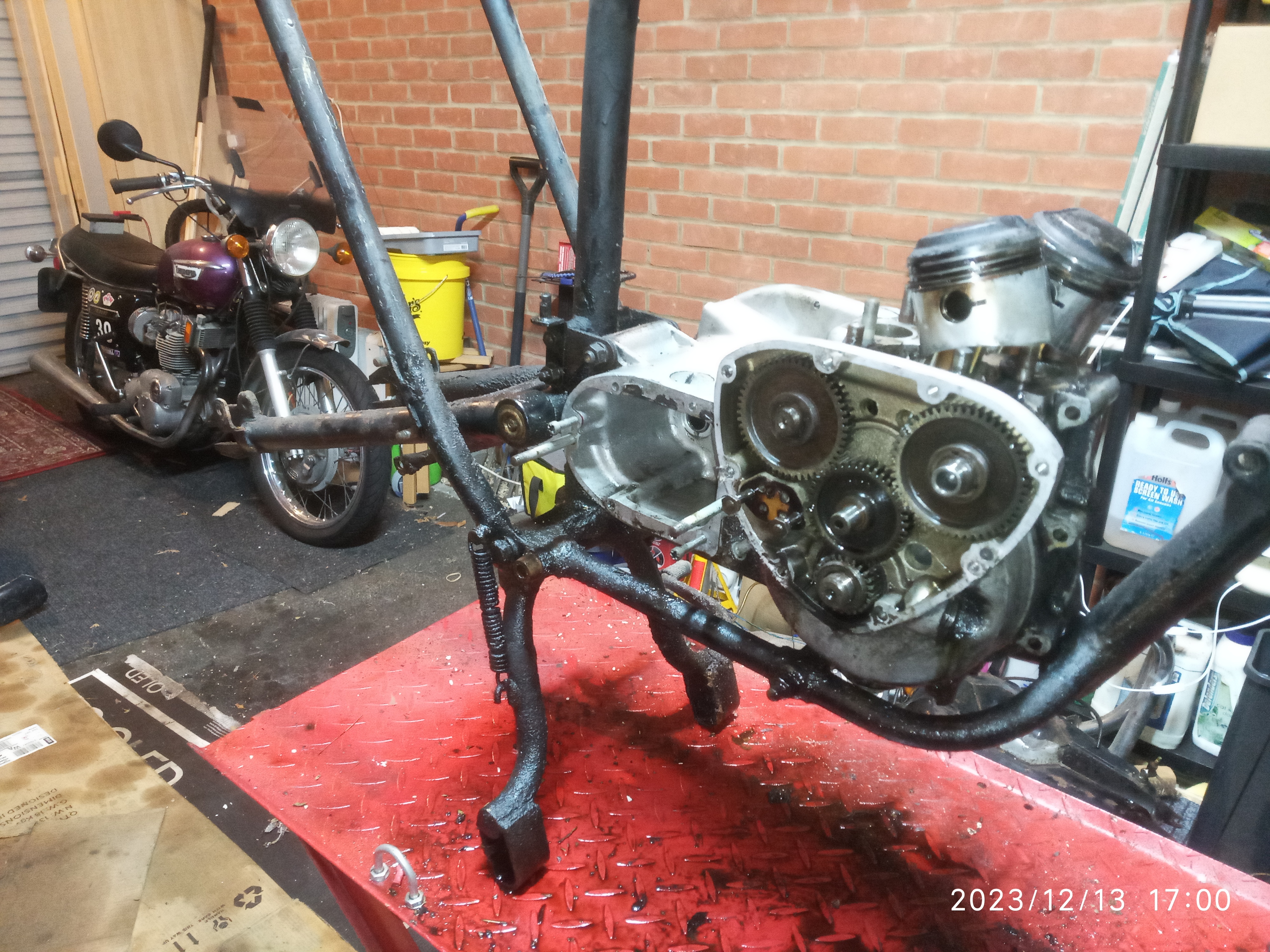

    Made good progress today. Got the head, barrels, primary drive and gearbox out.
    It's been such a long time since I last used my favourite 1/4 Whitworth spanner. I'm stuck now as I don't have a camshaft pinnion extractor so that's on order from Feked along with a gasket set, oil seal set and new clutch spring nuts that get mangled when you undo them.

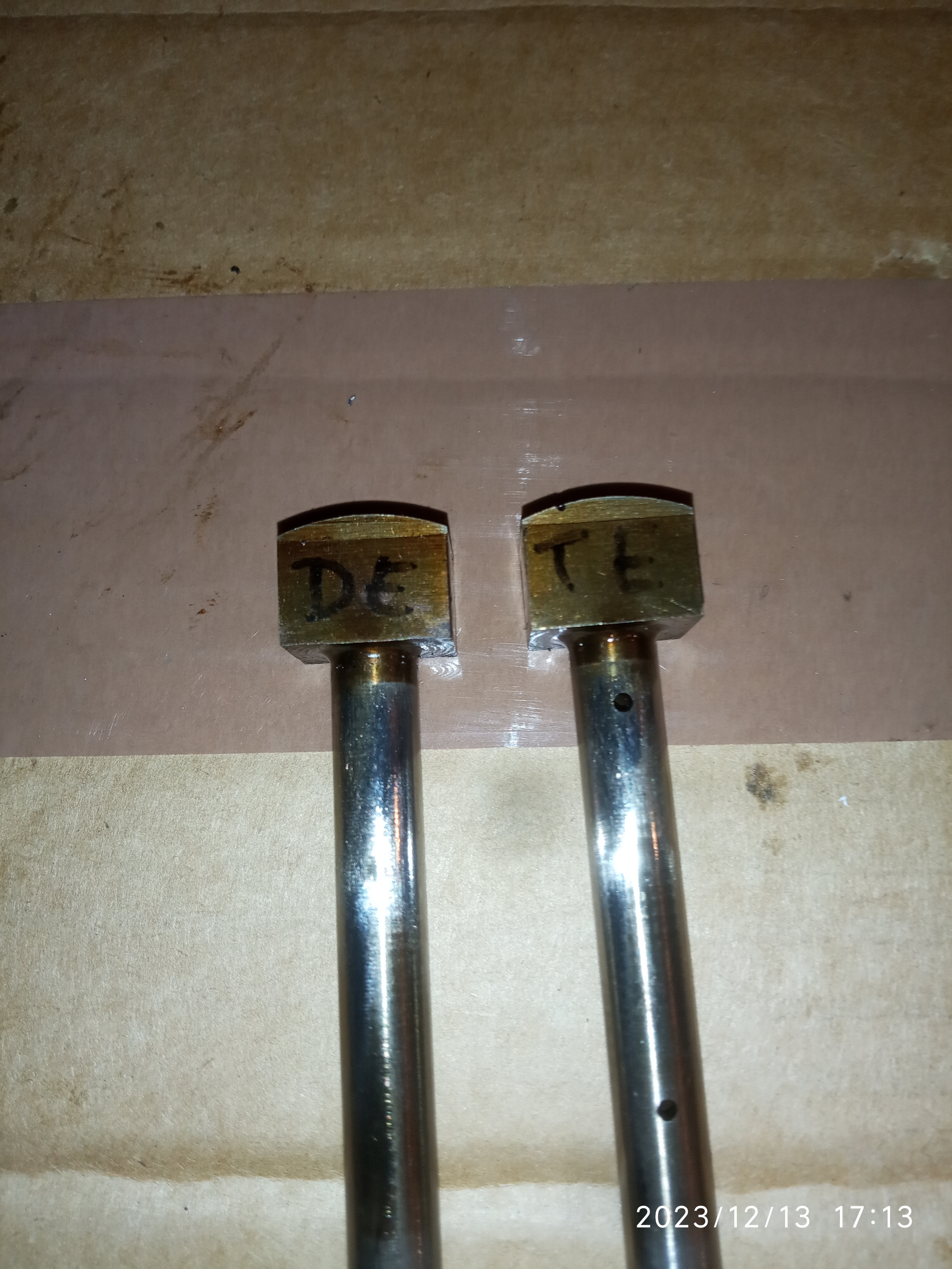

    Here's a thing. When I lifted the barrels the exhaust cam followers fell out. When I examined them I'd written on them years ago in Sharpie and the writing is still there!!

    take your old 4CA ignition points and ash-can them. they were marginal when new.
    you can replace them with 6CA points that get the condensors out of the points box and also allow you to time each cylinder on its own.
    better, dump them and install an electronic ignition. it will replace the points, AAU, and condensors, and is set-and-forget.
    the 4CA points were famous for bouncing and producing stray sparks earlier than needed. this led to pre-ignition and holed pistons. thats the main reason they were abandoned.

    Good advice. I had Boyer Brandsden on it for a while then had a bad misfire along the Uxbridge Road, Hayes, NW London 20+ years ago. Got home then put the points back on. I suspect it was just a loose connection somewhere and I kept the Boyer in the garage - until my ex wife had a clear out and threw it away along with my Haynes manuals and all the expensive receipts and documentation for my '72 T150V Trident...
    The Trident has TriSpark ignition and so does my T25T Trail Blazer. Expensive but good.
