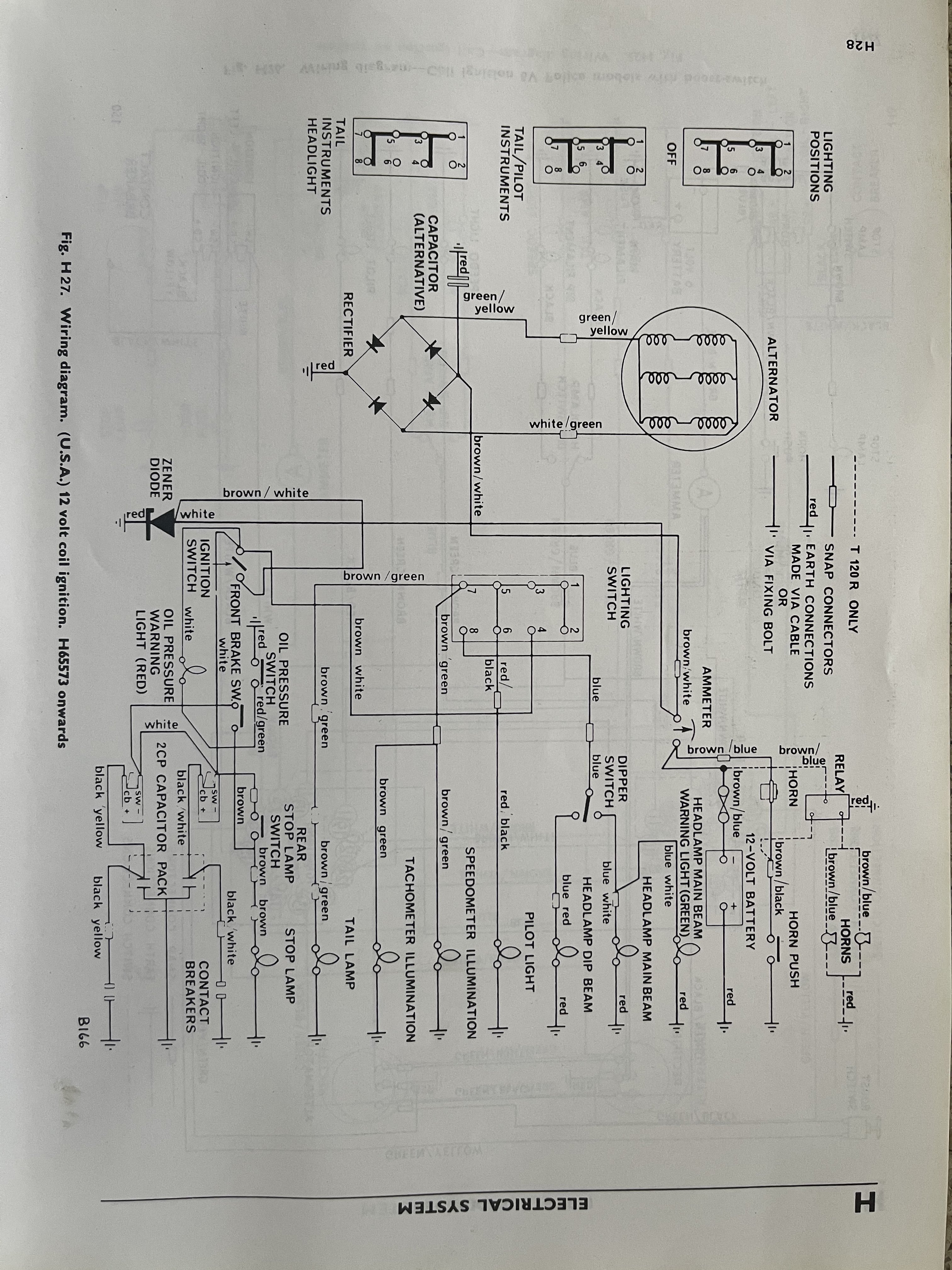

  15. Abirnie
    Abirnie Well-Known Member
    Oct 31, 2020
    155
    Ontario, Canada
    This is a schematic from a Unit T100 manual which lists T120R options. May help a bit for factory wiring. Most of these bikes are far from “factory” wiring/electronics unless you’re the original owner. I have a T120 manual around here somewhere also. These were ordered from British Cycle Supply quite a few years ago. They’re actual Triumph manuals, not Haynes. Definitely a valuable source of info when tearing down a motorcycle!

  18. Abirnie
    Oct 31, 2020
    155
    Ontario, Canada
    They go to your rectifier from stator, although the colours sound off. Possibly redone by someone.
  19. Cliff a
    Cliff a New Member
    Feb 7, 2021
    6
    Hampshire
    I’ve just found them on the wiring diagram abirnie sent me ,thanks for all your help
