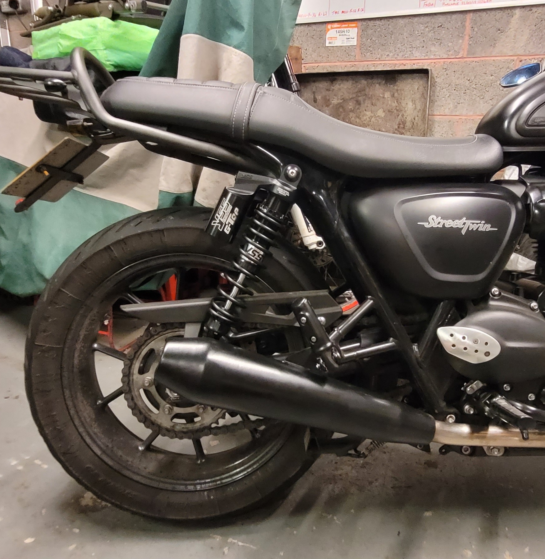

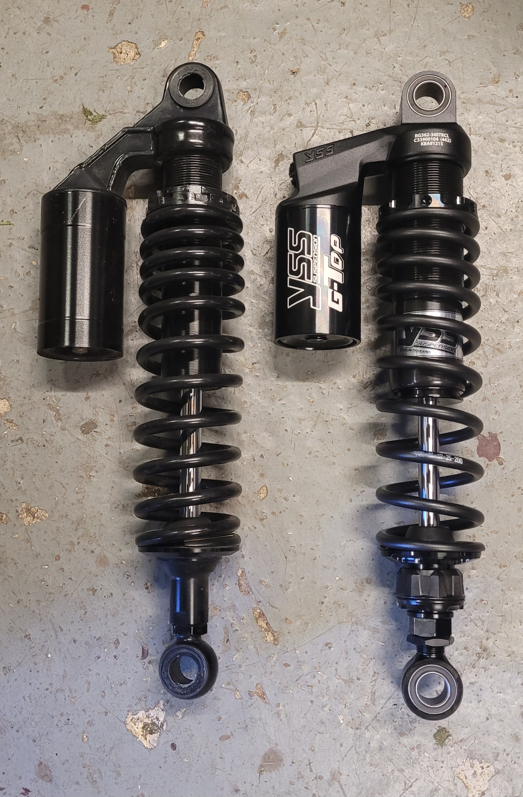

    Personally I chose and have the YSS on my 900 for the separate compression and rebound adjustment.
    I'm not sure cheaper options have both functions, so it depends how important that is to you?
    You might want to factor into your budget a front end upgrade?
    I have YSS springs, emulators and 10w oil in mine.
    Handles well with a significant gain in the suspension department, not perfect, but then only a thousand quid and definitely worthwhile.
