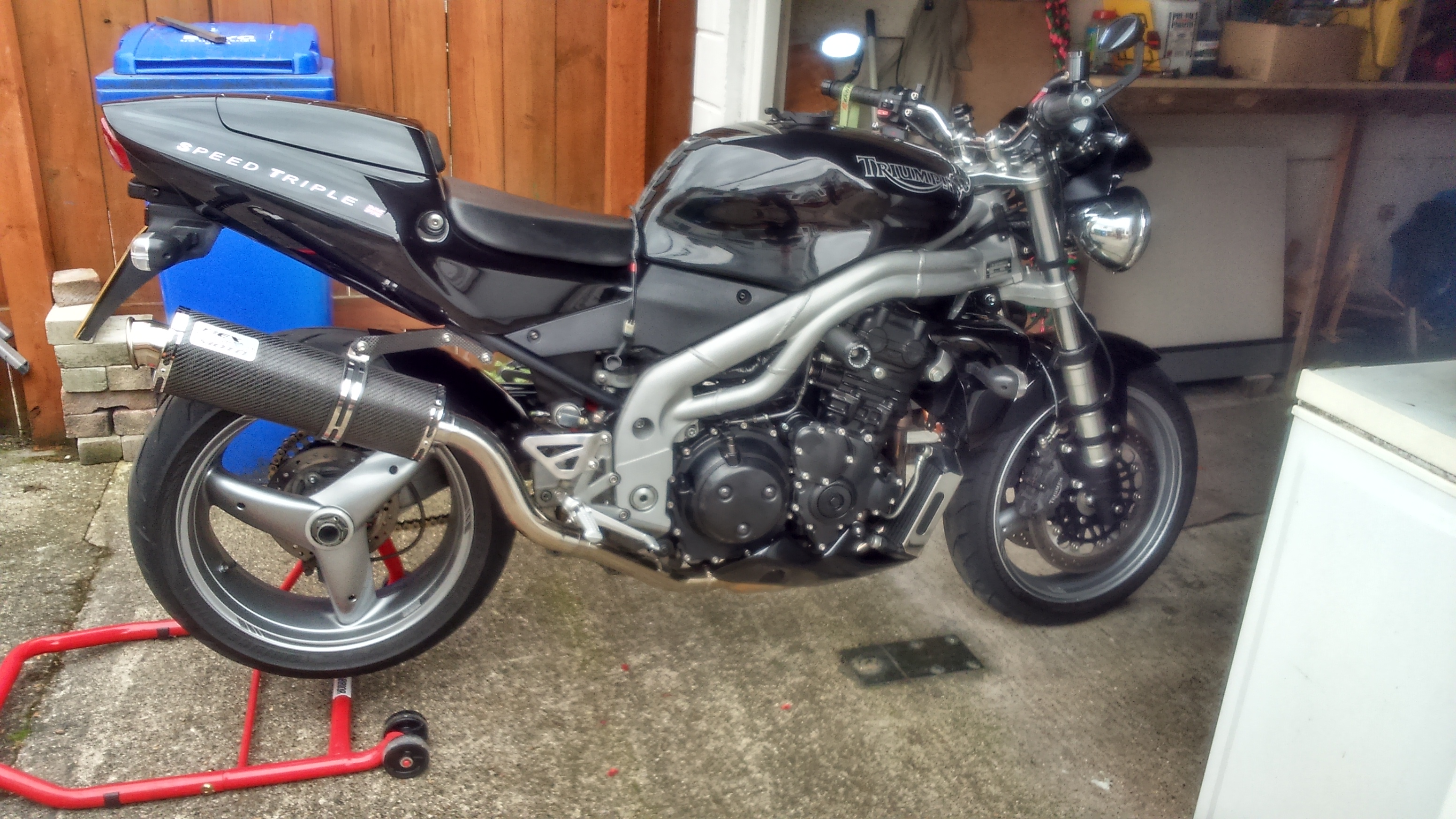

    I got my '03 S3 a couple of months ago for £2.4k with 6k on the clock. If your patient and willing to travel and haggle they are out there. DSC_0153.JPG
