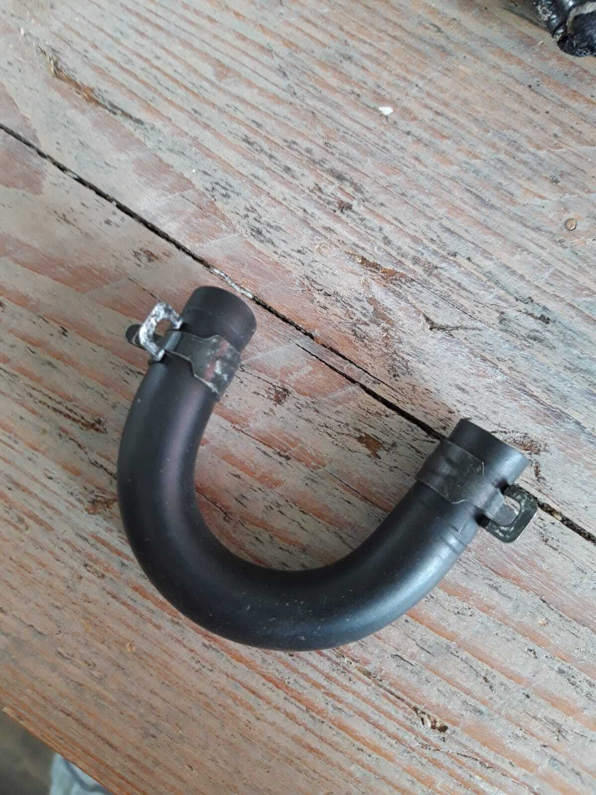

    Hello all!
    The brake line from reservoir to master brake cylinder is cut. I have a hard time to find a new one. Triumph dont sell those separate.
    Is their something else I can use? Like fuel line? Their is no pressure on this line.
    Any other suggestions?
    Thanks!
    Bastiaan

    Fuel line should be ok, I’ve used it before with no ill effects. Just go for the thick walled stuff.

    Thank you for the reply's.
    I prefer replacement above glue. The brake fluid already destroyed the paint on the top yoke. I dont want to risk a new leak.
    The Ebay link Sprinter posted is perfect. I just ordered 1 Meter of hose.
    Thanks!

    Its not cheap I admit that!
    But a lot cheaper than driving store to store or ordering the whole machined aluminium reservoir!
    Im a happy camper...
