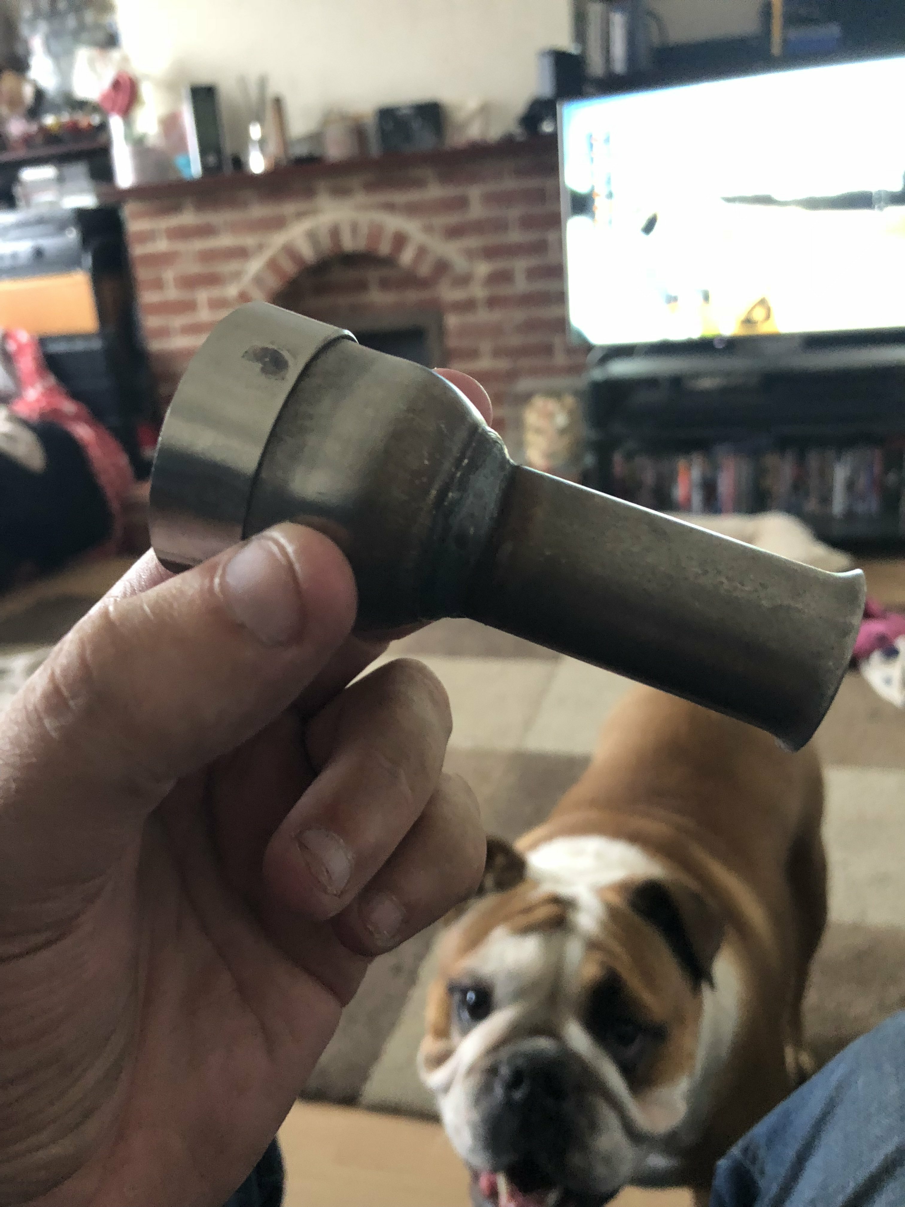

    I’ve got my circlips in the garage. I’ll dig them out tomorrow and measure for you.mine are Thruxton 1200. This is the baffle does it look the same?
  7. Ashtons99
    Ashtons99 Well-Known Member
    Nov 11, 2018
    Doncaster
    That looks right Glyn. My mate says they were just ordinary type circlips but had a blob of weld so he knackered them getting them out then lost them !

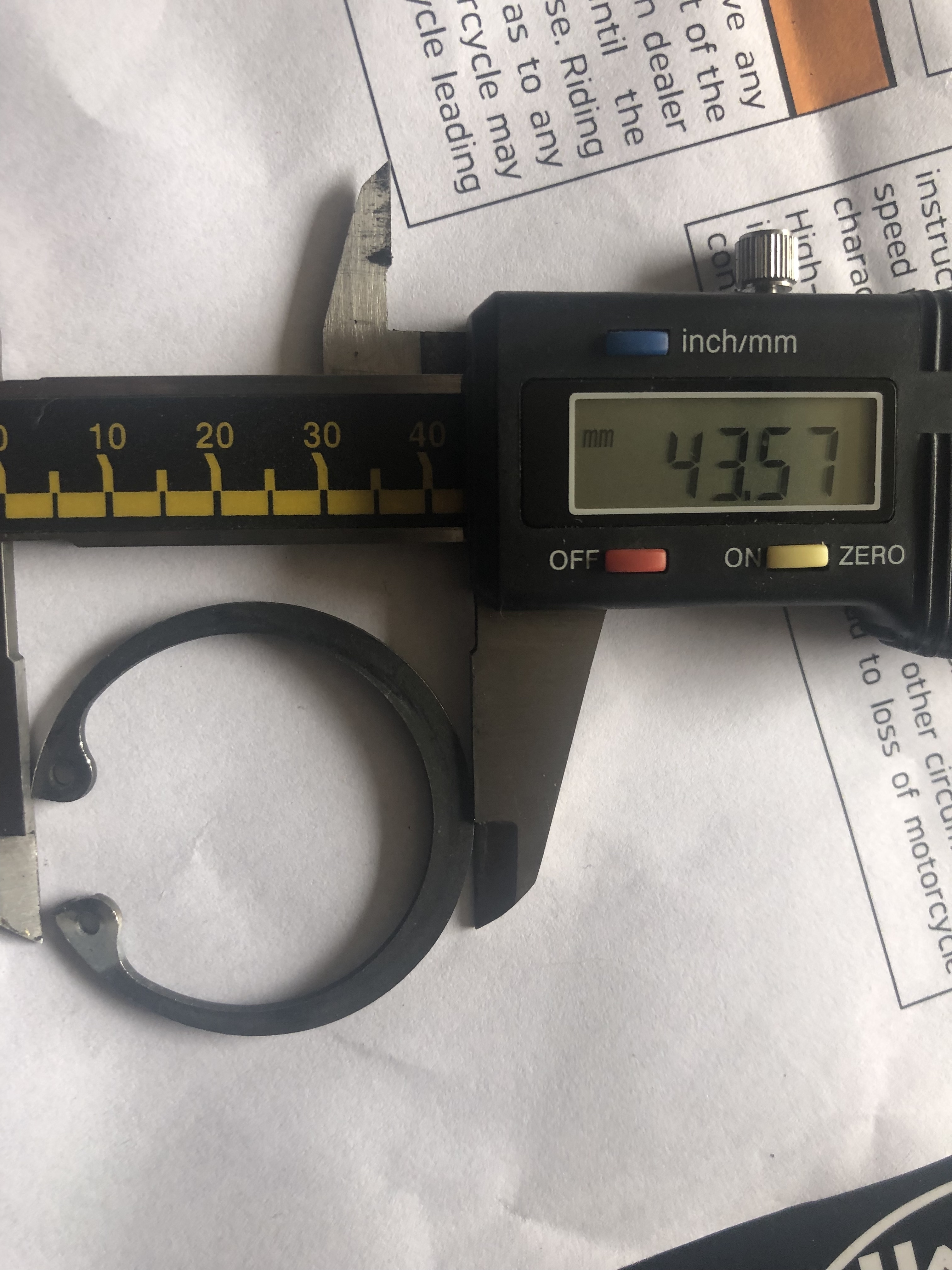

    Glyn.
    It seems that circlips are measured from outside of one side to inside of other. Any chance you can get verniers out again. Could you also measure thickness just to be on safe side. Sorry to be a pain [​IMG]

    I can find it on there but can’t find that measuring system on eBay circlips. They all seem to be measured as my previous post.
    If you get 5 mins some time. Thanks again

    That’s as close as I can hold it as it’s in and out

    That’s great Glyn. Thanks so much for your time and effort on this. Much appreciated
