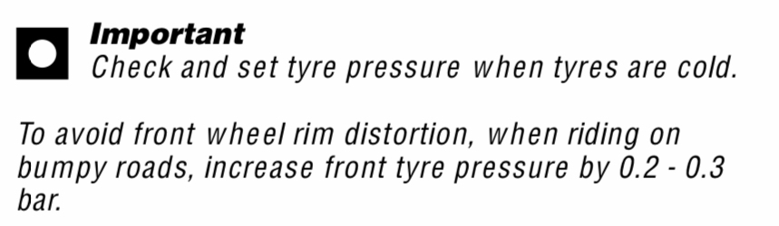

    I hear what you say about the advancements made, particularly this century, in the compounds now used in both car and bike tyres, but every car I have ever owned has advised increased pressures for carrying more than two people or an increased load. Even my current car which has run flat tyres with their stiffer sidewalls shows higher pressures for carrying more people/load. My Ducati does in fact recommend a higher pressure for one circumstance, see photo:joy:

    There will always be occasions where tyre pressures require adjustment for optimum performance. Those who drive/ride off road will be familiar with the necessity to drop the pressures to increase the footprint. I run the dirt bike knobblies at 12-15psi which certainly makes them squirm around on tarmac but increases grip substantially in the soft wet stuff while still giving some resilience to pinch punctures. 4 x 4 drivers will probably do the same. As for the " one pressure suits all" given in owner's manuals it will suit 99% of riders 99% of the time. In fact I've always run the ZZR tyres at the stated 42/42 psi through different tyre makes and types, solo high speed riding and loaded up with luggage and never had any issues, wet or dry or felt the need to try different pressures..
  9. Baza
    Baza Elite Member
    Jul 25, 2020
    5,103
    Amazing Grace
    Is that 42 front and 42 rear, wow. I’m not disagreeing with anything you’ve said. What I do urge other riders to do is not treat the handbook pressures as cast in stone, be prepared to experiment, like you do with your dirt bike.
