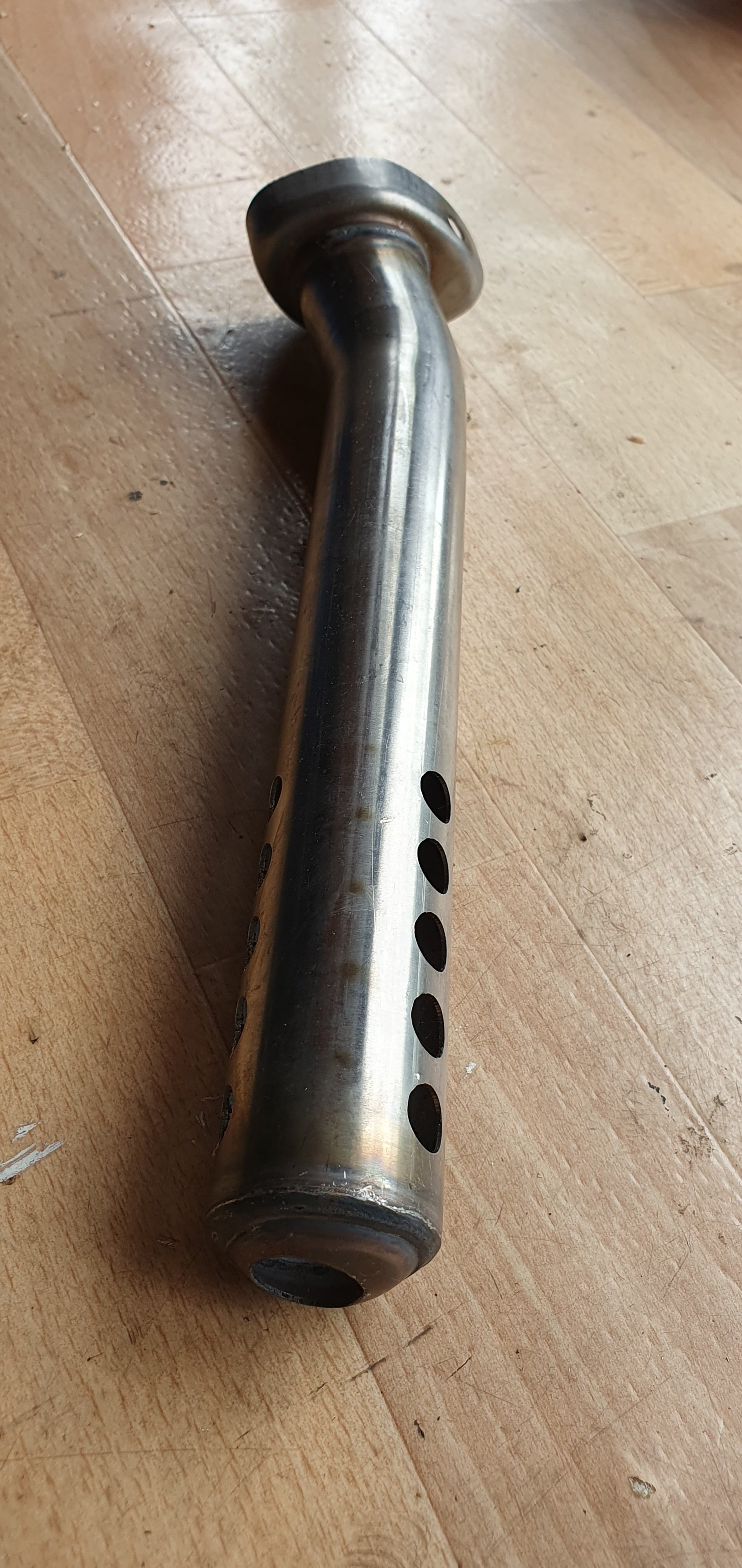

  7. Col_C
    Col_C I can't re...Member
    Aug 5, 2015
    1,431
    Likewise, I've run twin Arrows without baffles more or less from new on my 2015, now been through 5 MOT's without a mention.
    I have the baffles (but not for sale), the diamond shape flange required to fit them will limit your options.

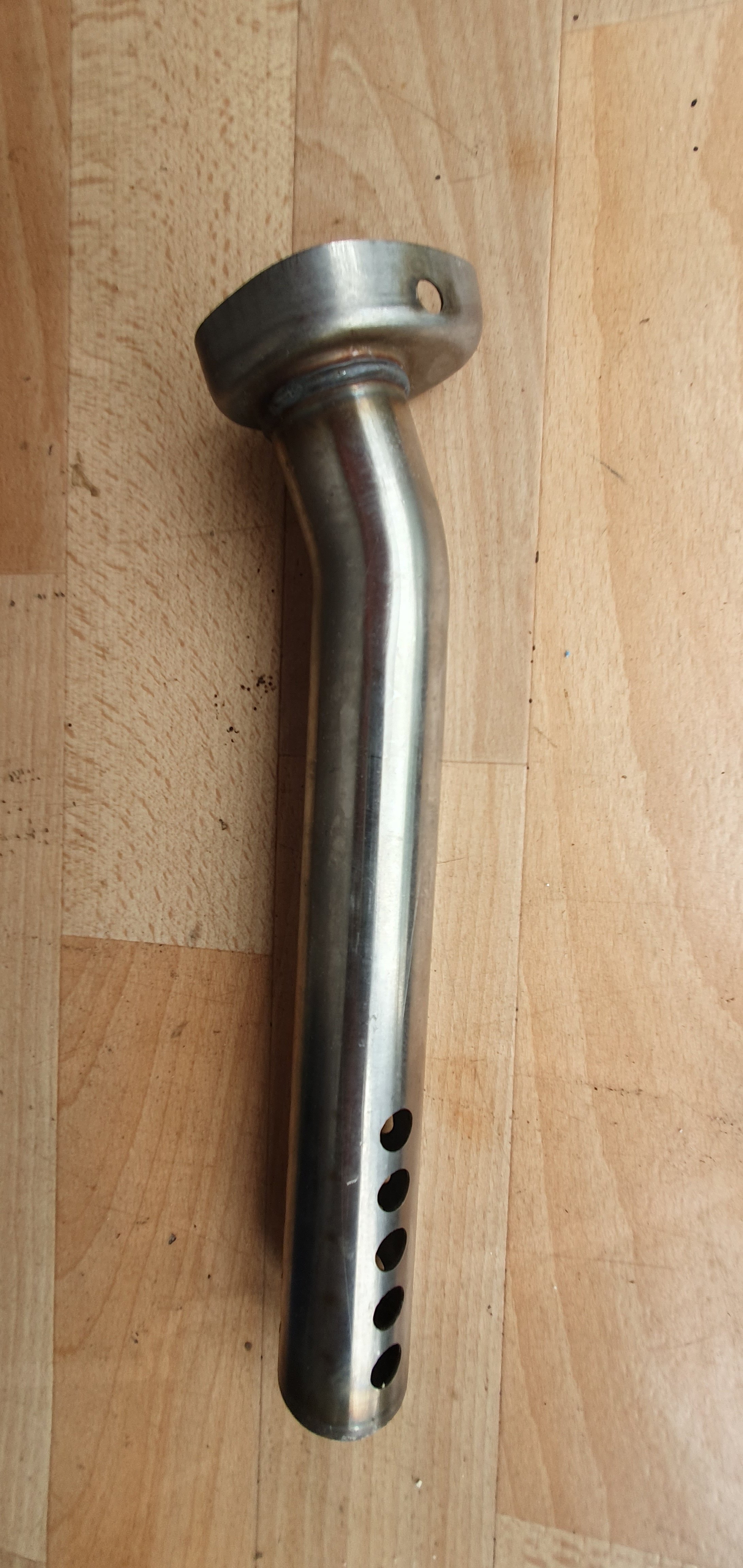

  8. Eldon
    Eldon Elite Member
    6,037
    I'll have a look tonight.
    On a 675 street they have a lovely overrun pop on deceleration when baffle less but, the drone at constant speeds around 50 mph does my head in hence I run with them in.

  14. Eldon
    Eldon Elite Member
    6,037
    Just to add to my previous post;
    The 675 street Arrow baffles are fastened in by a circlip so it sounds like a totally different arrangement.
  15. Col_C
    Aug 5, 2015
    1,431
    This is what you're looking for...
