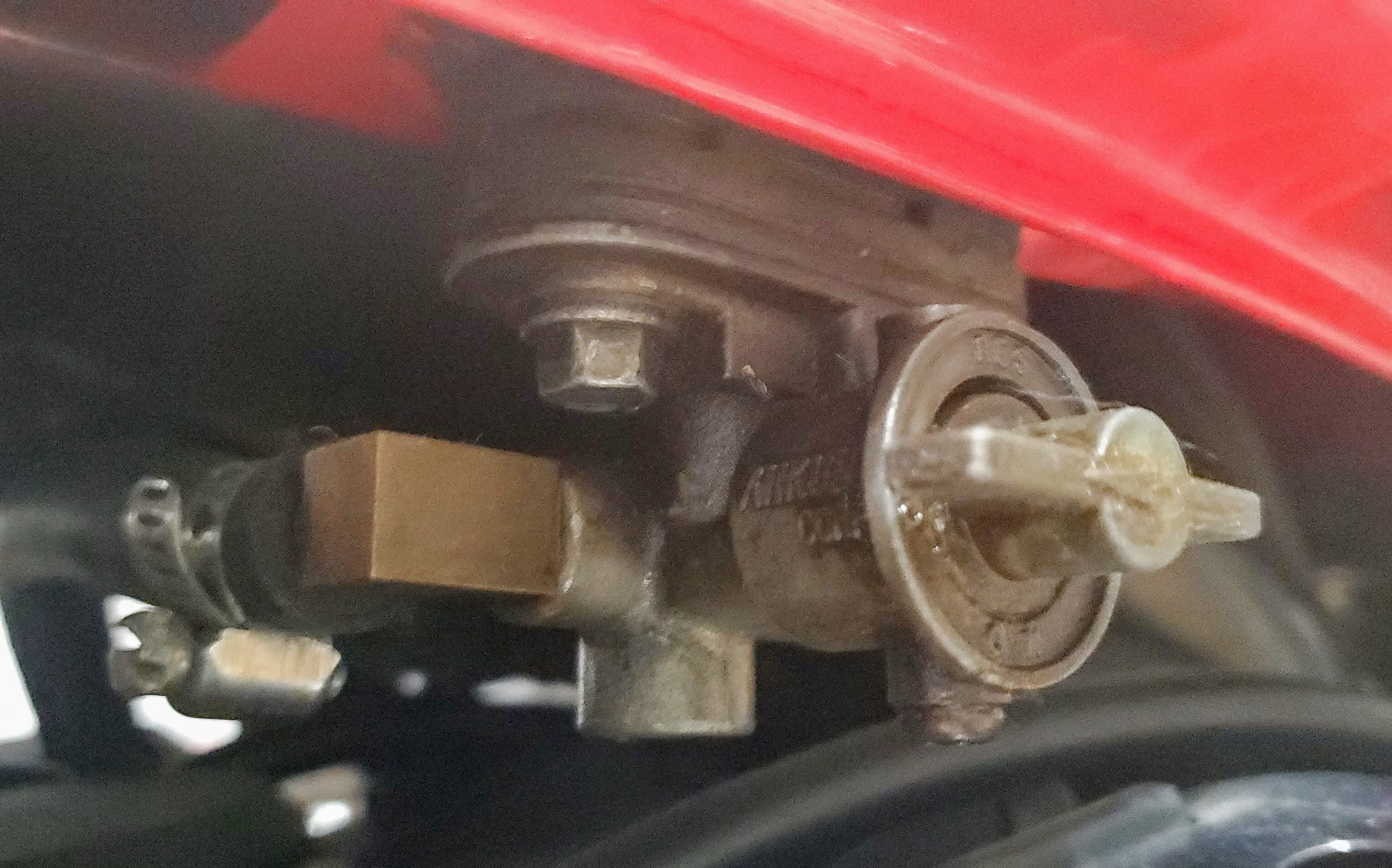

    I have a 1998 Thunderbird Sport which I've owned for about 10 years, but for the last couple of years I haven't found time to ride, but now that has changed! :)
    One problem I have is that the fuel tap/petcock leaks from the tap lever part, it doesn't seem to be from the joint to the tank - where can I get a replacement from in the USA?
    I have looked at Pingel, but all the different part numbers and type got confusing, any help there would be appreciated.

    Do show us a picture. I think I may have a spare tap in my garage somewhere and if it looks the same i will drop it in the post to you.

    Couple of pics.

    I see its the same part number for early carbed Bonnie's and Thruxton too .
    I know you're in the USA bit I looked on fowlers UK site to check but its on back order anyway.

    Yes I got a tap just checked it to your pictures. Use the private message and let me have your address and I will post it to you.

    I did read that you can sometimes repair a leaking fuel tap by taking it apart and use a piece of rubber inner tube to make a new seal.

    I was looking through my notes, and found this note I made.
    Suzuki RGV250, outlet might have to be re-orientated, Kawasaki Zephy 750/GT750 should fit as well.
