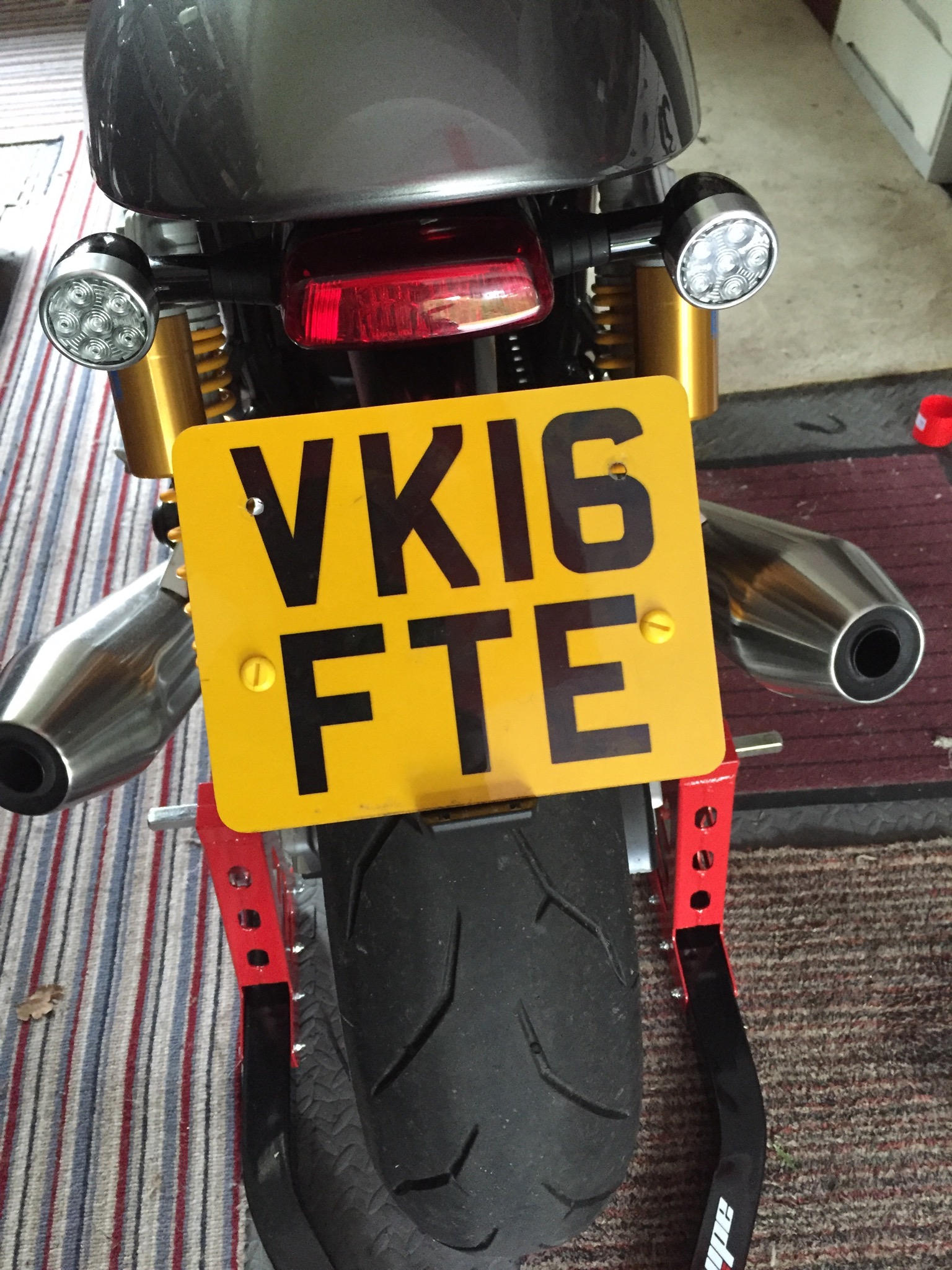

    image.jpeg image.jpeg Its easy to fit, you use the centre sction but have to file/cut a knick out the centre of one of the mounting plate edges. I'm on hols till Saturday but could do it for you if you struggle when I get back as I live in Newbury. Its a piece of piss to fit though. Ignore the holes in the number plate, just fitted the original small plate from the standard tail tidy which had the holes in different places.
  13. drinky
    drinky Member
    Jun 14, 2016
    26
    Newbury
    Oh and before you get a tig welder/ angle grinder/ hammerite or anything else out Dont, theres no need to cut anything.

    Nice one thanks Drinky. I'll take a look at the weekend if I have time. If I do struggle I'll come back to you. I also need to get a 7x5 number plate too! Really must sort out my to-do list, it's huge.

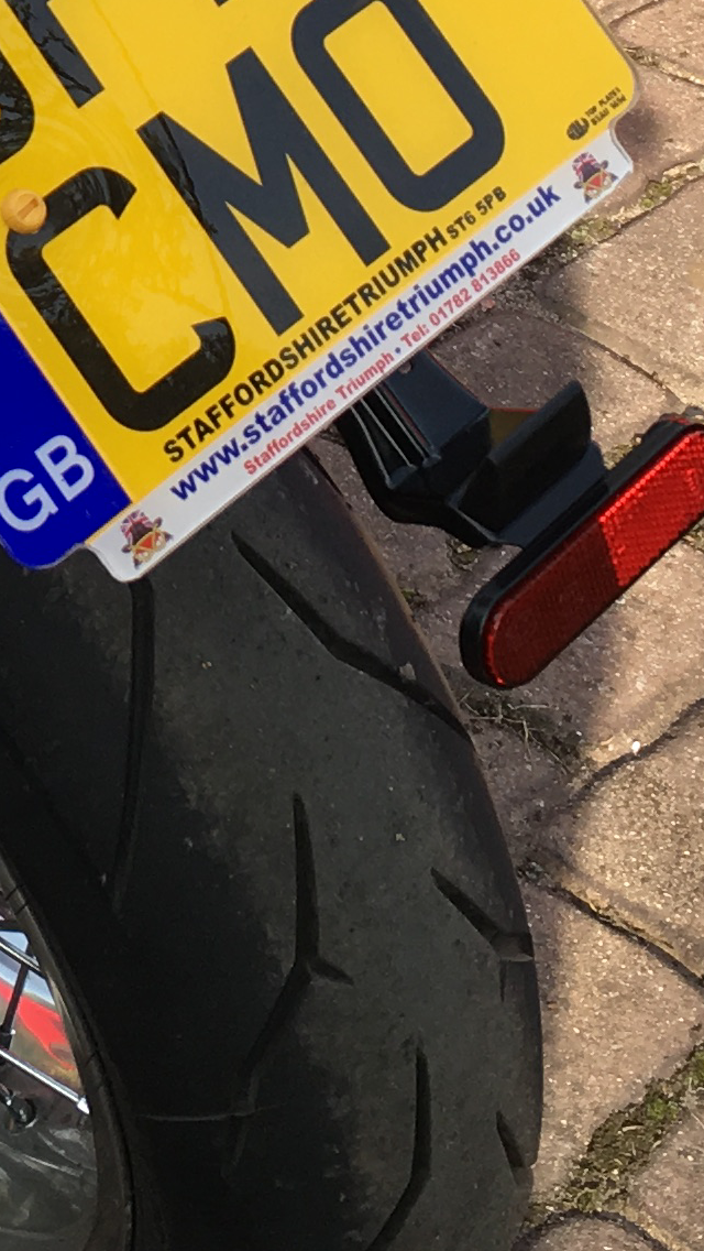

    Drinky. BTW. If you have time, can you share a photo of how it looks under the rear wheel arch. Would this photo show where the small nick is?
