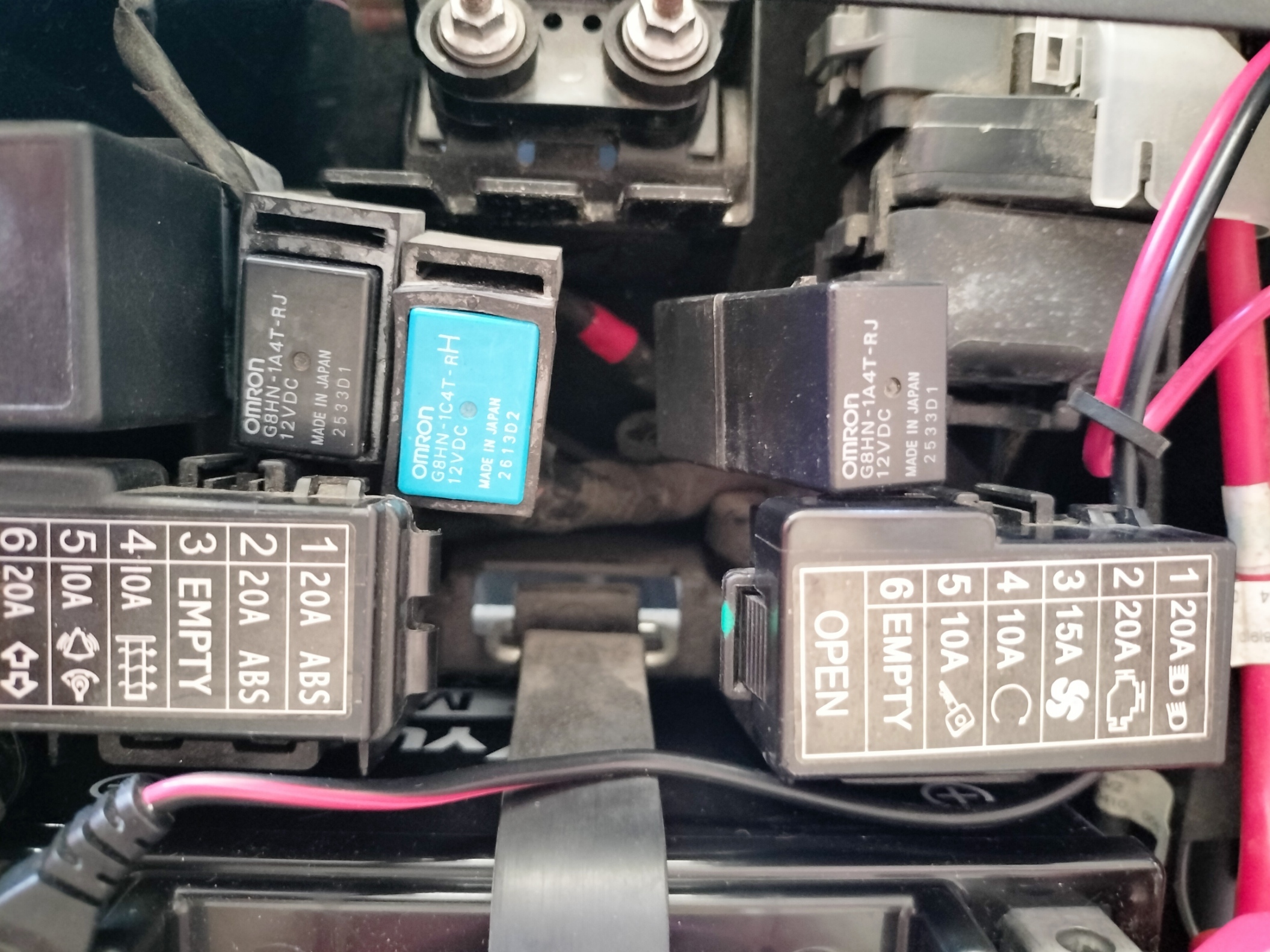

    I have a Triumph 1050 GT SE Sports Tourer 2013 (purchased new) - I am in Sydney Australia BTW.
    I have had problems with my bike just stopping, no power after about 40 minutes of riding. It is like the immobiliser is kicking when riding; however, when I cruise to a stop and try to restart, it doesn't, and there is only power to the headlights.
    A fiddle around, and it seems to get going again.
    Fast forward to now:
    1. I changed the battery in it a week ago.
    2. Out for a ride today and after about 40 minutes it just stopped again. No matter what there was no power to the bike except the headlights.
    3. I fiddled around with what looked like the relays. The only way I could get the bike to start and get me home was to leave them unseated, as per Bike_image 1.
    4. When I got home, I reseated them, and the bike again would not start.
    So my question(s) are:
    a. Are these relays?
    b. Are they easy to replace?
    c. Do relays "die"
    Otherwise the bike is running like a dream.
    Thank you :)

    @Pat59 Chances are you have a loose or broken connection there somewhere usually around the headstock or ignition. Make sure all joints and plugs are free from corrosion and dirt. Keep us in the know

    I have ordered new relays. Fingers crossed it is not a wire issue. I have checked for corrosion and it is pretty clean but it is also very tightly packed so it is hard to see.
