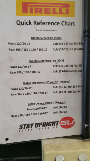

    I spoke to the resident tire guy about suitable tire pressures for these tires / bike / conditions etc and he directed me to his wall chart – see picture.
    NOTE the tire pressures for slicks are not that different!
    I let the tires down to reach 31F and 24R.
