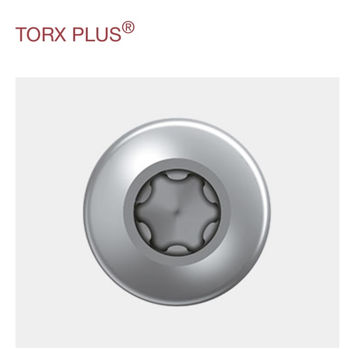

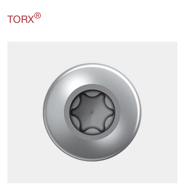

  5. StuarT595
    StuarT595 Active Member
    Nov 19, 2020
    204
    South West UK
    It’s a slightly chunkier version of the standard Torx as best as I can explain it...same sizes though. Here’s a couple of pictures for clarification.
