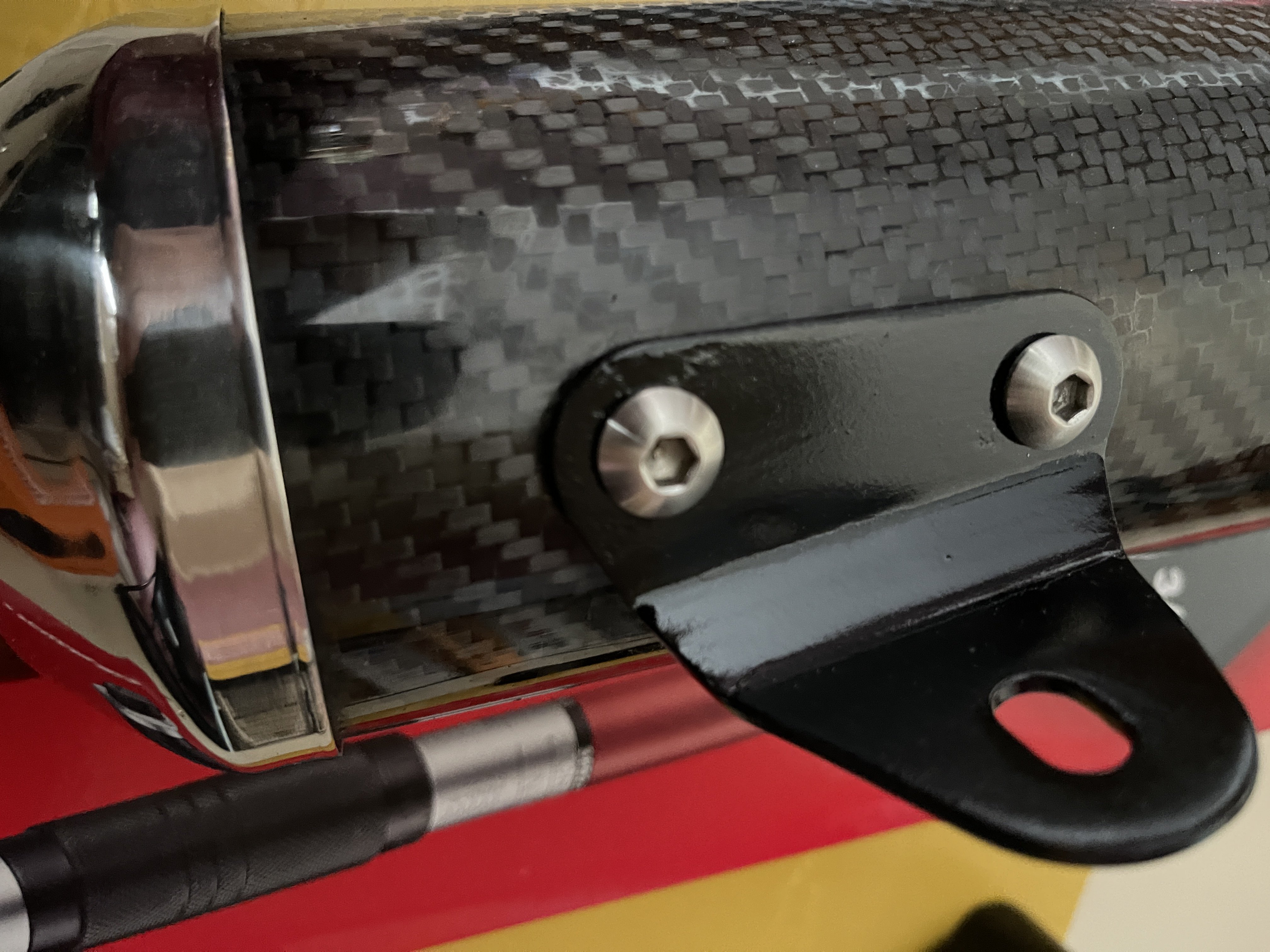

    Hi all, as above. I was trying to remove the two button head bolts which hold the bracket on to the can and the head snapped clean off of one of the bolts with hardly any force leading me to believe it may have been glued in place previously. The idea behind removing the bracket was to clean it up as there are rust marks on the carbon coming from underneath said bracket.
    Has anyone here had the same experience and drilled out the remains of one of the bolts ? Any tips gratefully received as I really don’t want to mess this up as these cans are like hens teeth

    Hi mate, if it was mine I would be tempted to remove the other two bolts, remove the muffler bracket and get plenty of WD40 or similar on the broken stud and let it soak in for a few days, you may have enough stud sticking out to get some grips on !!!!. If all else fails start drilling out till you can get an 'easy out' stud extractor on the job. Good luck and let us know how you go. Mini

    Start with some left handed drill bits, going up in size until you can get a decent extractor in. You may find the remainder of the bolt unscrews itself while you're drilling it.

    Thanks Mini and Pegscraper, all sorted now. I work next to an engineering company so asked if they could help, they said no problem. They got the old screws out which were pretty tight, re tapped the holes and even sandblasted and repainted the bracket, all for nowt, wouldn’t take anything. Well chuffed !
